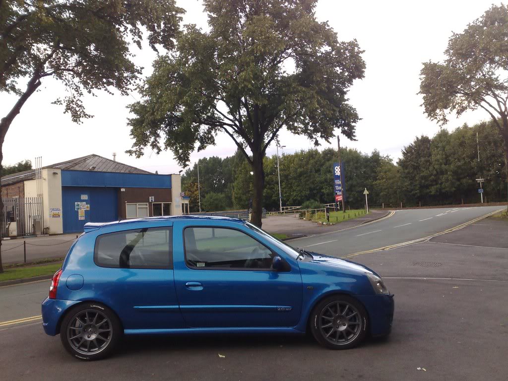

When i first had my H&R's fitted it was slightly to low at the front as it used to scrub on hard corners/roundabouts. Now i have raised the front a little keeping a slight nose down stance she performs much better. The back does feel a little light when pushing hard but doesnt take much to counter.
So i would raise the front slightly ensuring the stance is slightly nose down. Similar ride height to the trophy !

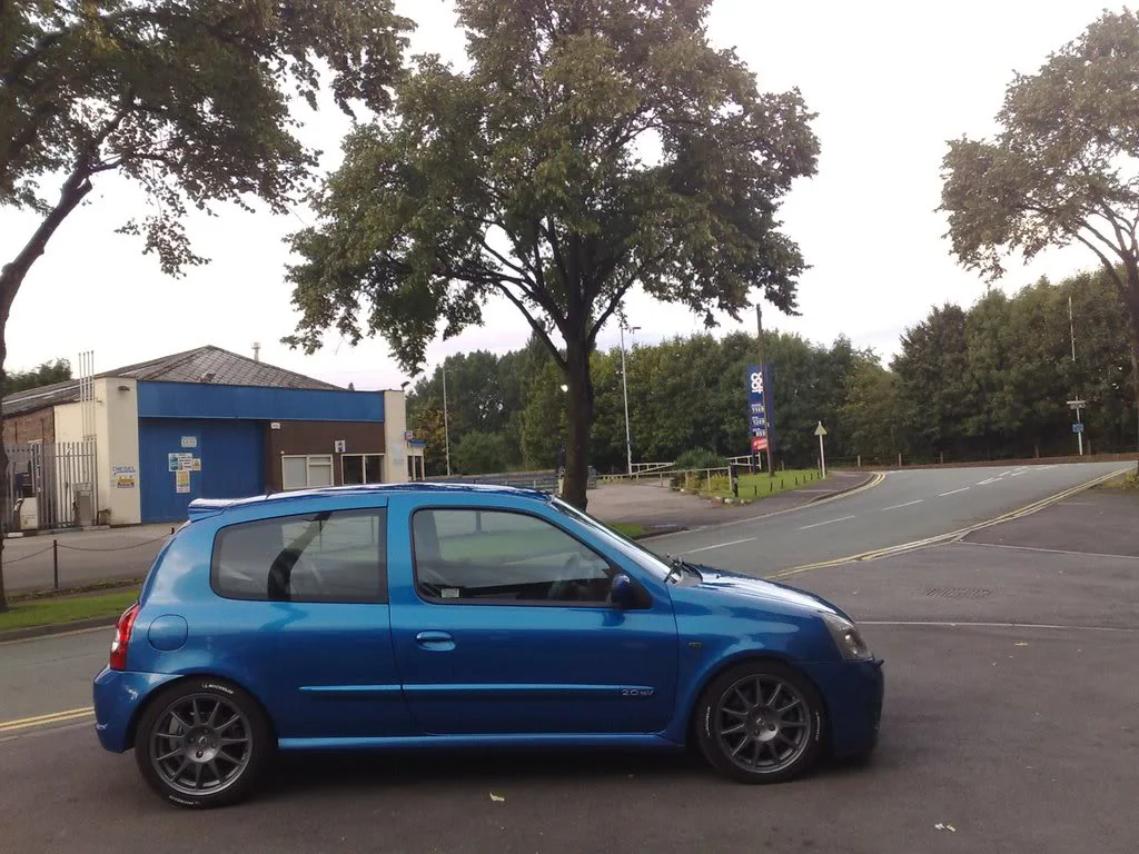

Mine is slightly nose down... You got a picture side on of your's.. Here's mine.
