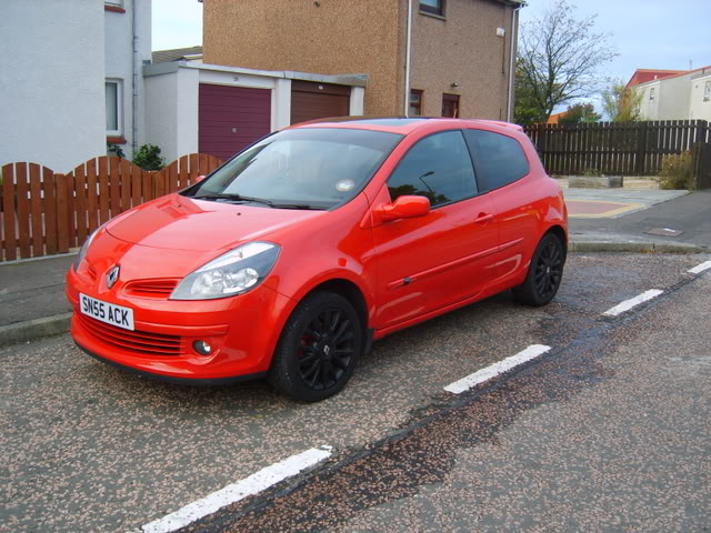

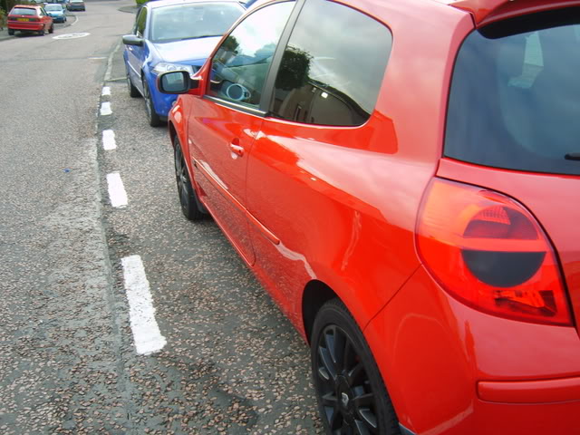

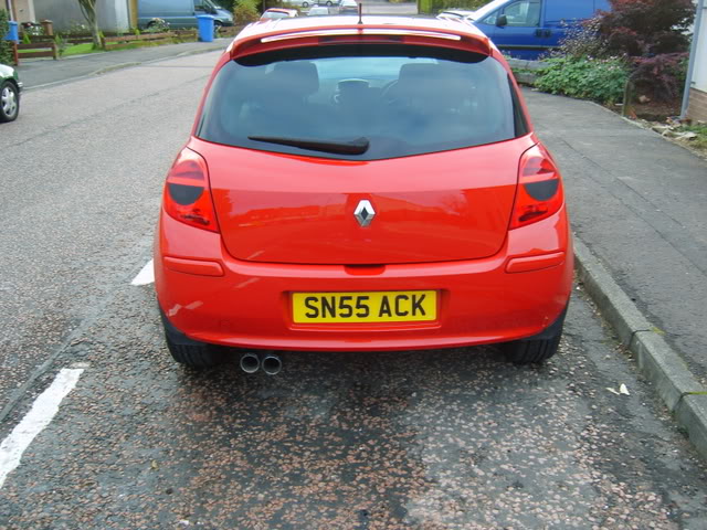

Thanks to all who replied, susanamck that looks exactly like the back end of my car even down to the colour!!! so that gave me a great idea of what it will be like so thanks for that.
gonna do it tomorrow so will let you know how i get on!
it looks class all clear, alougth my badges are now black, ill try and get some up when/once ave cleaned him lol, good luck to moro

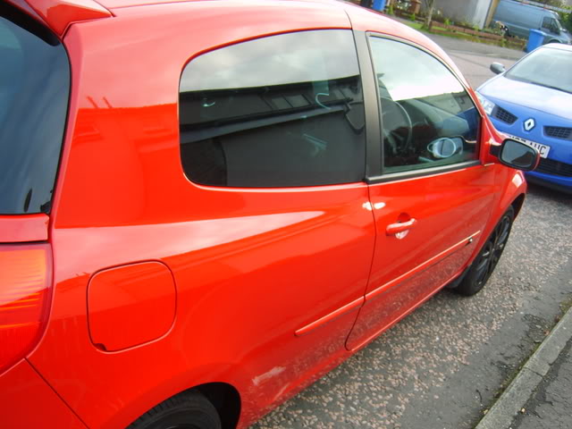

and here are the other pics, before i blacked the badges out
next on my list, lowerin!! and the 197 front splitter, nope no kit on it, i like the sides and bk the way they are just fancy the splitter to add some black bk to the front.
smart motor mate, really like the colour code how much it cost if you don't mind me askin, I would only really wanna do the black bumpstrips tho
i got the car to come with the spoiler so it was already done, but to get a dent in the drivers door removed, a key scrap taken out and the rest colour coded was £250. Got a steal tho because the car was kinda dirty when they quoted me and never noticed the paint was pearled haha so the paint alone cost that, obviously it was mates rates tho but i havent seen a better job yet.
Was done my truck tec in carluke, glasgow they are the guys that do the pictures on the trucks of mostly naked ladies so this was a easy job for them, or so i was told lol. i love the finish and look, and like i say apart from maybe some engine tweeks the only thing i want to do is lower it about 40 all round and the front splitter added.
