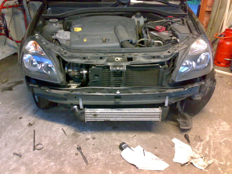

todays bargain!!
yeah realised that when i went to fit it today didnt have the pipe coming from the turbo, but went back up and got it for £2 lol
only thing thats looking like a bit of bother is the radiator on my 65 is different from the one on the 80 it came from, mine doesnt have the brackets to mount the intercooler so ill need to either make something up or sell my radiator and get an 80 one, mine is nearly brand new right enough!
if you can mate, i'd try and see if you can find any points you could screw some brackets to like i did:
I didn't get any brackets with it either, just made some up and bent them to shape, it fits rather well lol.
different IC though so might be abit of a b**ch with 80 one.
how do you like all the pipes in the bay now then lol? can't get my hands in now, there god damn everywhere!
you won't be seeing 110bhp, but 100 is doable at a push, my initial map was about 92bhp but i got paul to play with it abit more and inject abit more fuel, ended up being 99bhp. torque is one of the biggest improvements though, feels amazing low down.
awesome man wish i could have found a dci100 intercooler :( im assuming the pipework is the same apart from you seem to have another pipe going from the top jubilee clip at the top of the radiator (drivers side) down to the intercooler, my hose connects to the intercooler at the top where the clip is.
fitted it tonight, and as pikey as it is the cooler is held on to the radiator very securely with some cable ties haha, doesnt budge either!!

yeah well the guy i got it off had the 80 pipes and modified them to fit the 100 (added another pipe into the game) thats why there are about a million jubilee clips everywhere.
