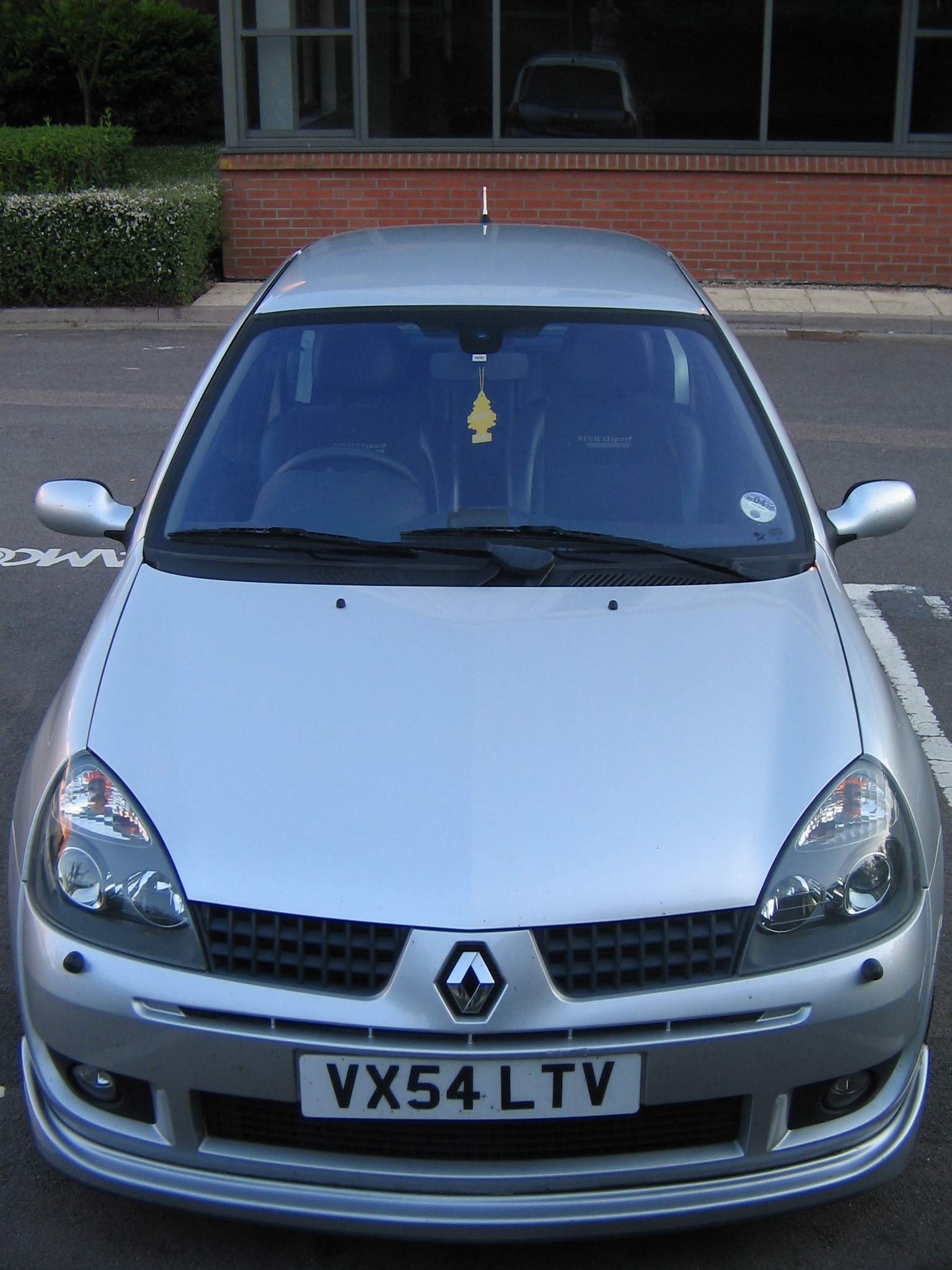

J4mes, im in the Abbeymead area, always lived in Glos, and had car 2.5 years, it's got a front splitter on it, now im really back into my car im trying to go to some meets etc, do you know where a lot of people in Glos go with their cars etc? Just incase as it looks different from the front, now you might have seen it?
