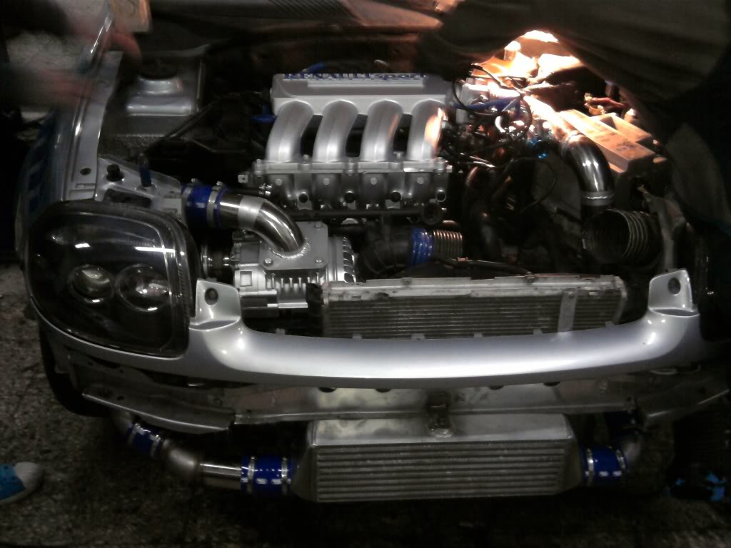

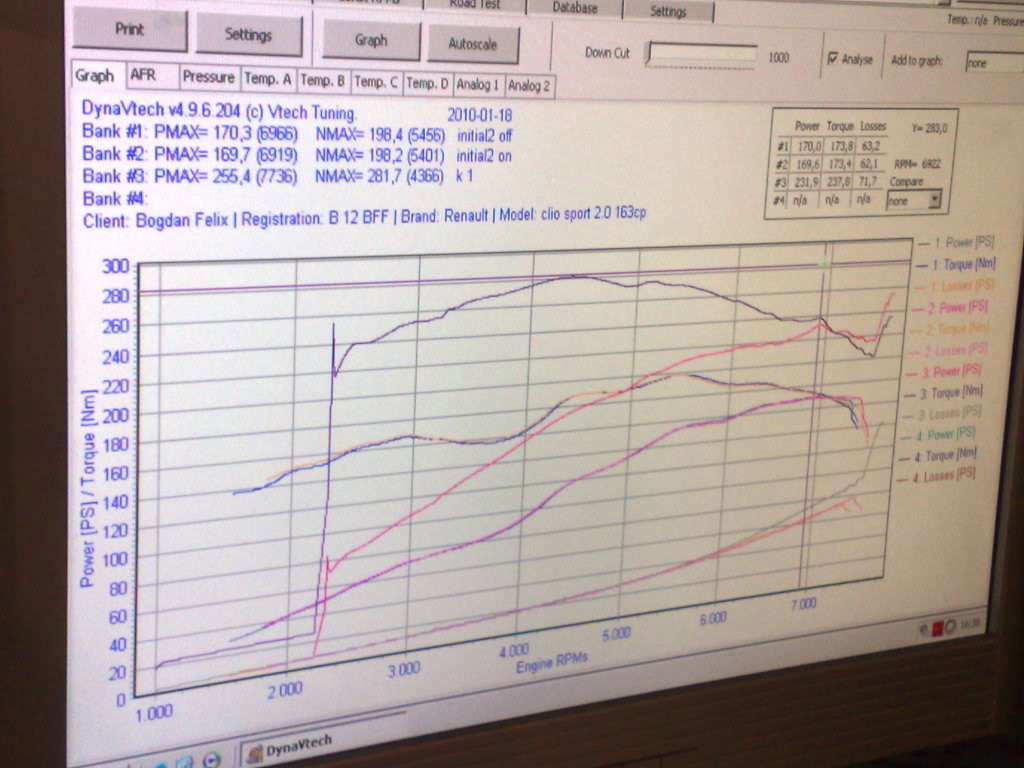

a friend of mine has a supercharged 172 ph1 still being tested and wondered if the torque you see in the graph isn't too much for just 0,3 bar
he has an eaton m62, cat cams 421 and 182 manifold
here's the graph:
he is afraid to go higher than that (torque wise), the gbox could blow up..
although there are some clios runnin higher values with the std gbox
is that at flywheel?
280Nm = 206lb
assuming it really has 0.3bar at that rpm...
206/1.3 = ~158 lb Normaly aspirated
does that sound high?
if you put it that way it sounds good! but the fear of blowing the gearbox is still there.. I think he should take the brave pill and give the thing some stick!
