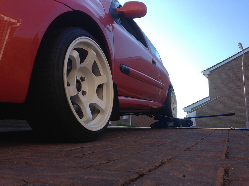

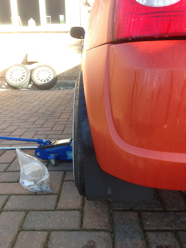

As a few of you know I've just gone and bought some Rota Grid's. Came to fit them the other morning and I think the rear ones stick out a little too far.
Here's a few quick photos -
What's everyone else's opinion on them? Is there anything I can do to get the back wheels in a bit more?
Im obviously going to wind the coilovers down and I'm planning to refurb them a gunmetal grey colour (open to suggestions though).

I did think about that but if I got camber shims, wouldn't they stick out more as well?
They are very thin, I'm no expert but on my old Golf i was running 1.5 degrees of camber on the rear and it made the top part of the wheel sit much better under the arch. Having had a second look its going to take a fair bit of work to get them to sit better!!

I'd be looking at camber shims as it doesn't need spacers! I believe you can get them in -0.5 and -1.0 degree off camskill and ktec's website.

When i had 1.5 degrees the wear was a little uneven! As for the shims I'm pretty sure you can just double them up. Best check before but they are quite simple to fit.

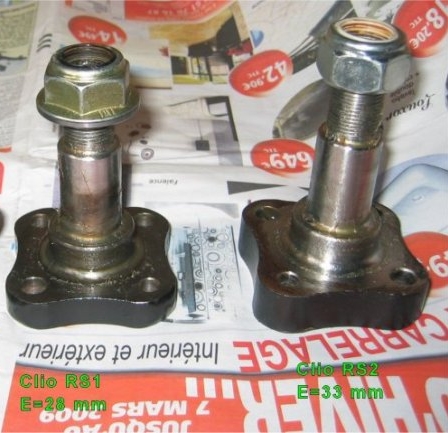

Very nice wheels mate, maybe you could change the rear stub axles to 172 ones as they are 5mm shorter.
RS1 all 172 models
RS2 all 182 models

they look nice. defo need more lows and the front fit fine just rears arches need rolling. running any spacers?

the ph1 they were on before you picked them up on Friday had the rear arches rolled so the didn't stick out
RS1 all 172 models
RS2 all 182 models
Ooh that sounds like a good idea. How would I go about doing that?
Yeah I'll wind the coilovers down once they're fitted properly :) not got any spacers on. They're just really wide wheels! :p

Yeah but if you look on his progress thread, they seem to fit a lot better before he had the arches flared. I'll pm him.

Just order a set off ebay or here mate and fit them/get them fitted, make sure you order the shorter ones.
http://www.ebay.co.uk/sch/i.html?_t...s&_nkw=clio+172+stub+axles&_sacat=0&_from=R40
Are the 172 and 172 cup ones the same mate?
Those tyres and camber shims are just asking for a write off! Contact patch will be minimal!
I'll go for the 172 stub axels first, hopefully they'll make enough difference. After that I think camber shims will be the only option apart from rolling the arches.

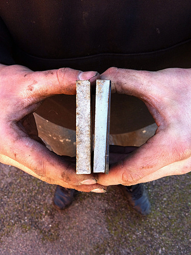

@-Danman- I believe the MAD ones are actual spacers ranging from 5mm - 15mm wide from -0.5 camber to -3.0 where as the link I mentioned are just shims that add camber but don't space it out as they are only 1mm think (approximately)
Heres a pic of MAD spacers and the shims I had on mine. Imo you don't need spacers with camber as your wheels are wide enough.

Ah right okay, I assumed that they were the same thing. Didn't realise you could get the camber separate to spacers. They will be a lot better! Thanks for your help :)
