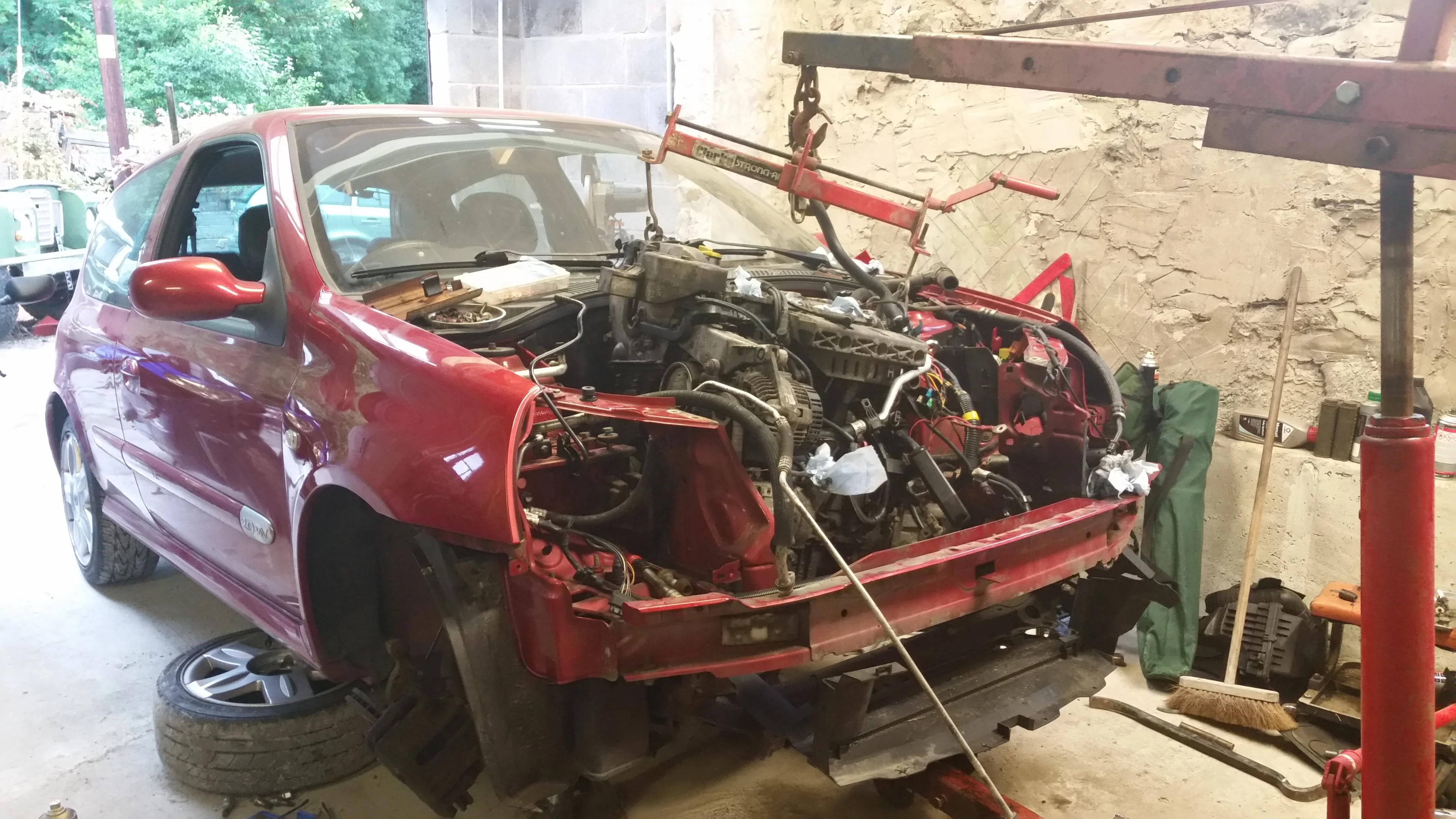

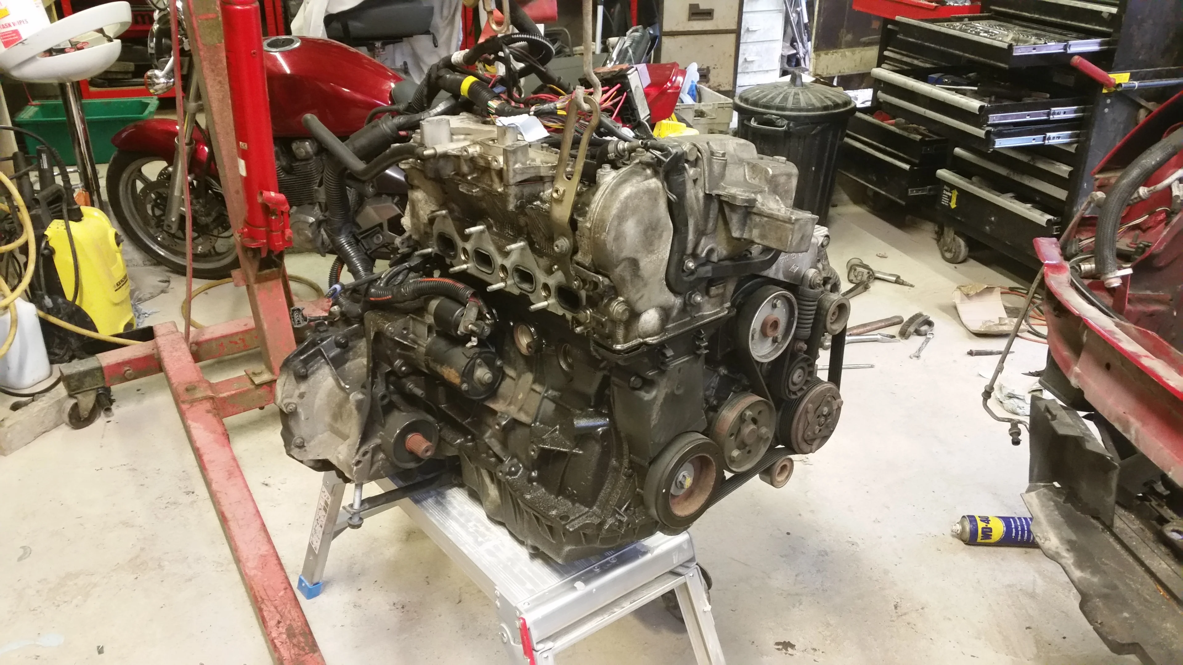

Took my engine out, things don't look good.
  Clio 172
Thought I'd stick a few pictures up as I'm getting pretty depressed with the 172 I've bought, it's rapidly becoming more and more lemon like!
I'm in the unfortunate position of having very little time to work on the car, and I'm also in too much debt to spend much more on it, it was meant to be a cheap fix to get me a little fun runaround. The car set me back £580 with what I thought was just a rattly dephaser, and the current parts bill must be more than that by now!
Anyway I'm hoping some advice/consolation or encouragement from fellow CS members might make me feel better, so any comments will be appreciated!

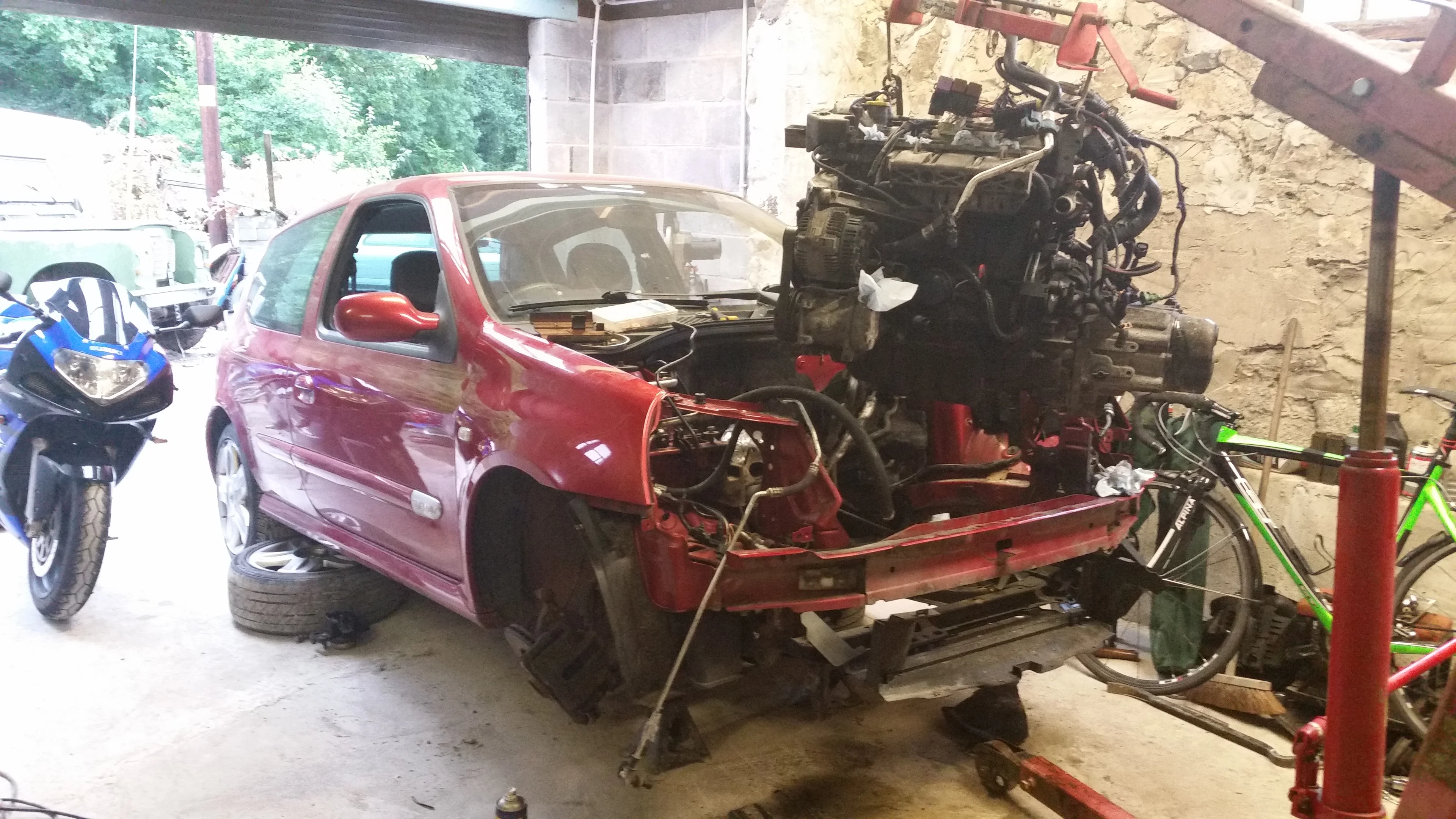

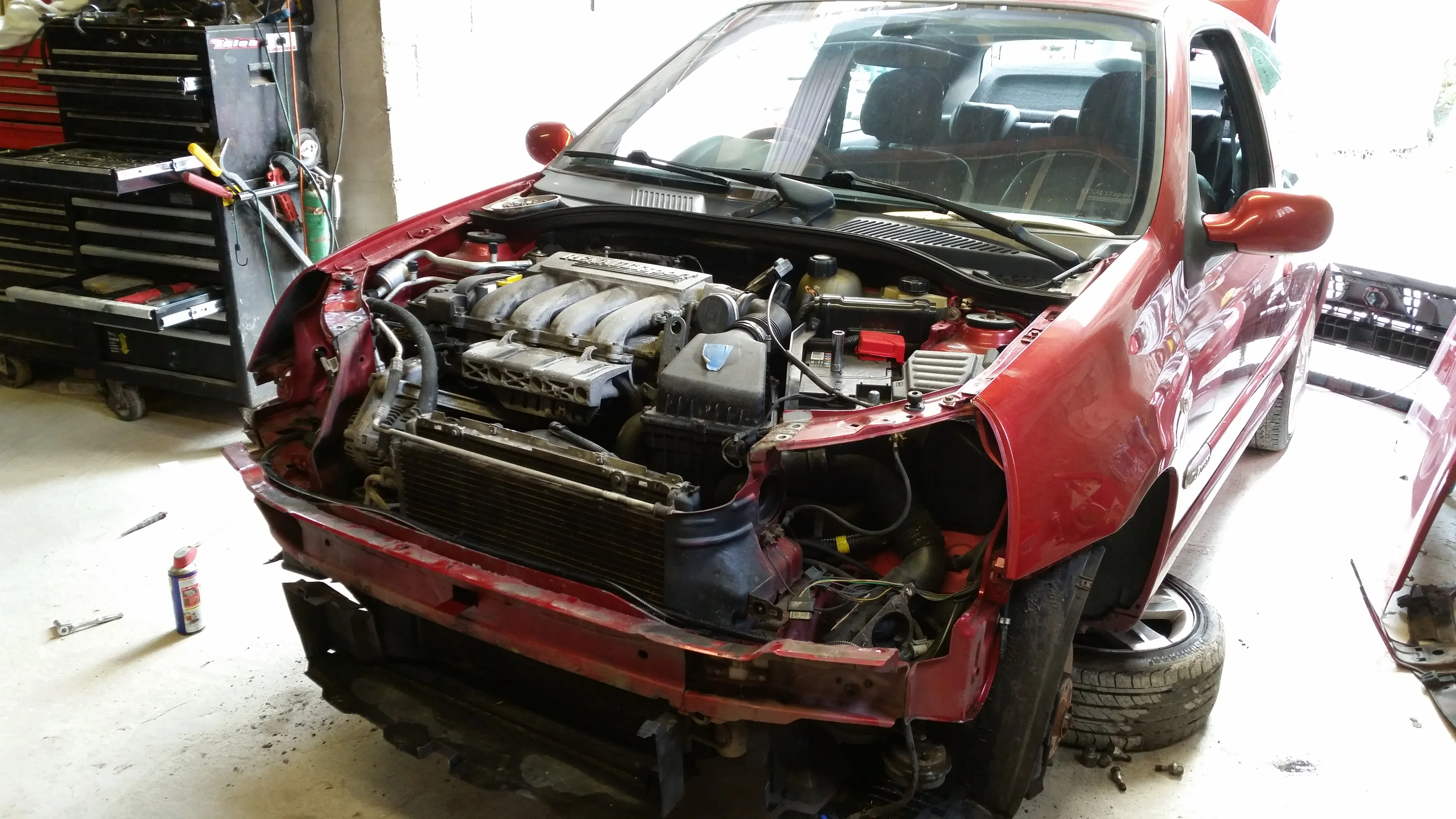

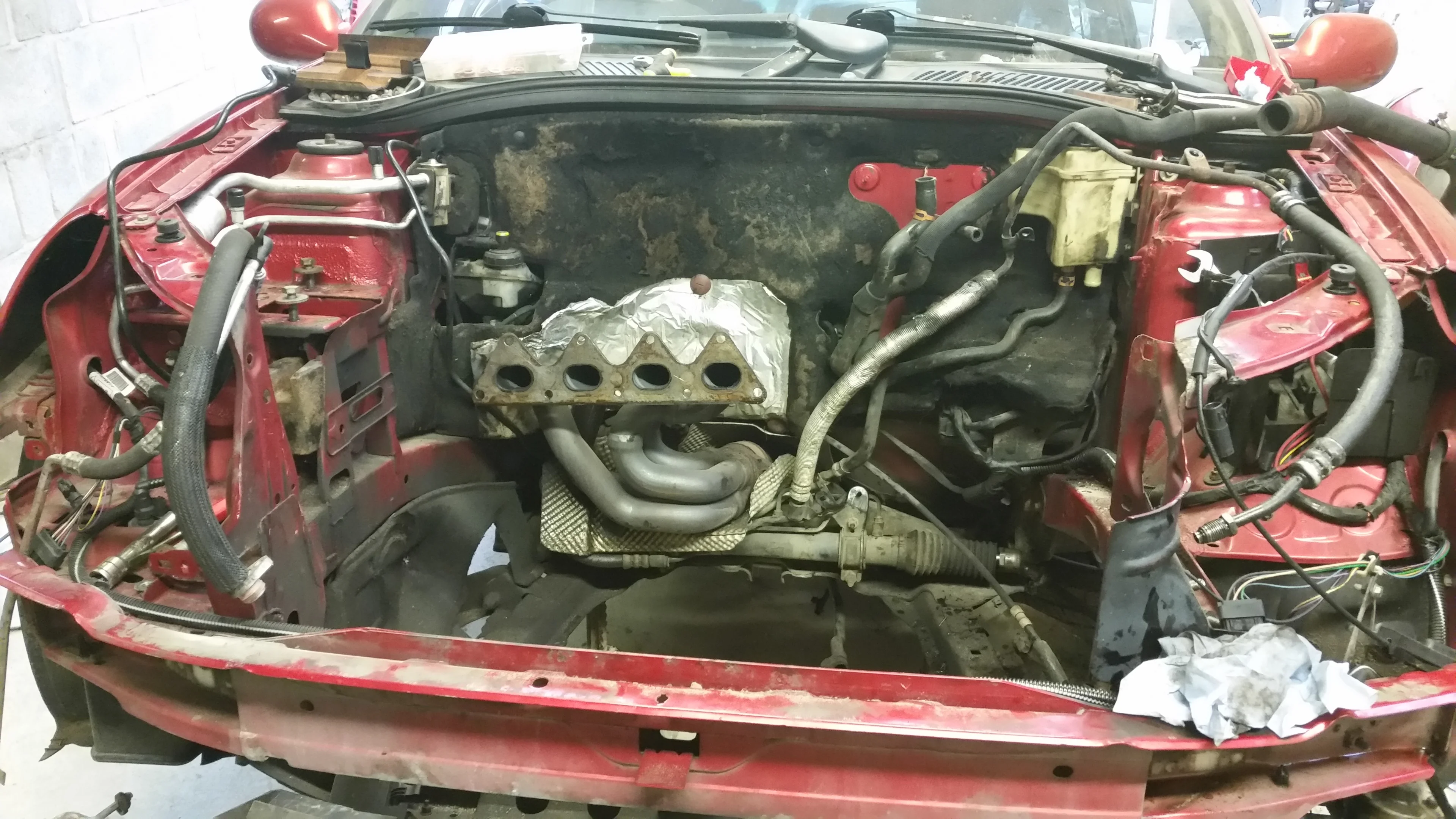

Got the car in and started taking stuff off:
Going...
Going...
Gone! (Pulling apart a lambda sensor plug I'd forgotten to disconnect in the process :( )

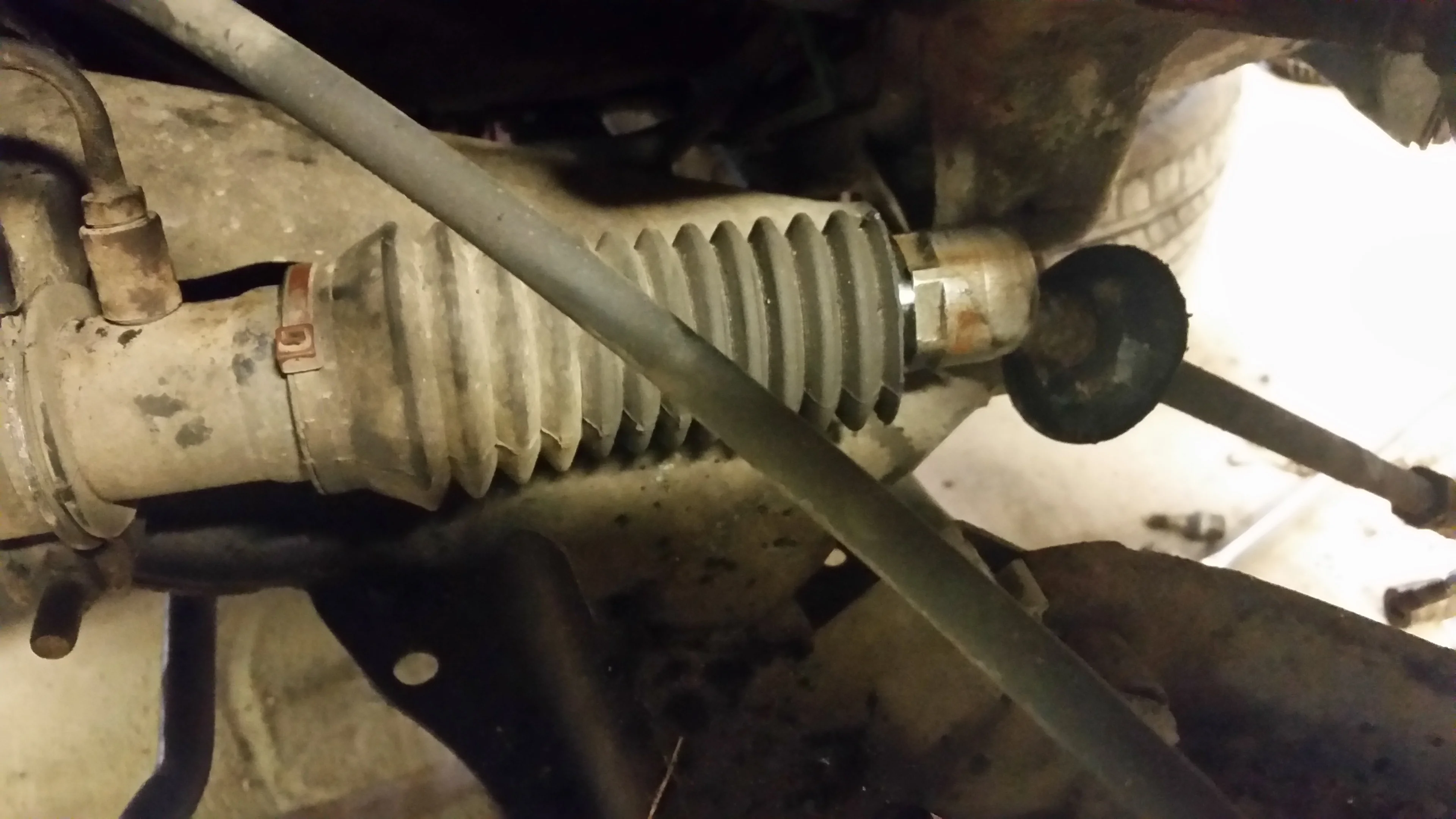

Found both inner track rods and gaiters are knackered, another £80 gone :(

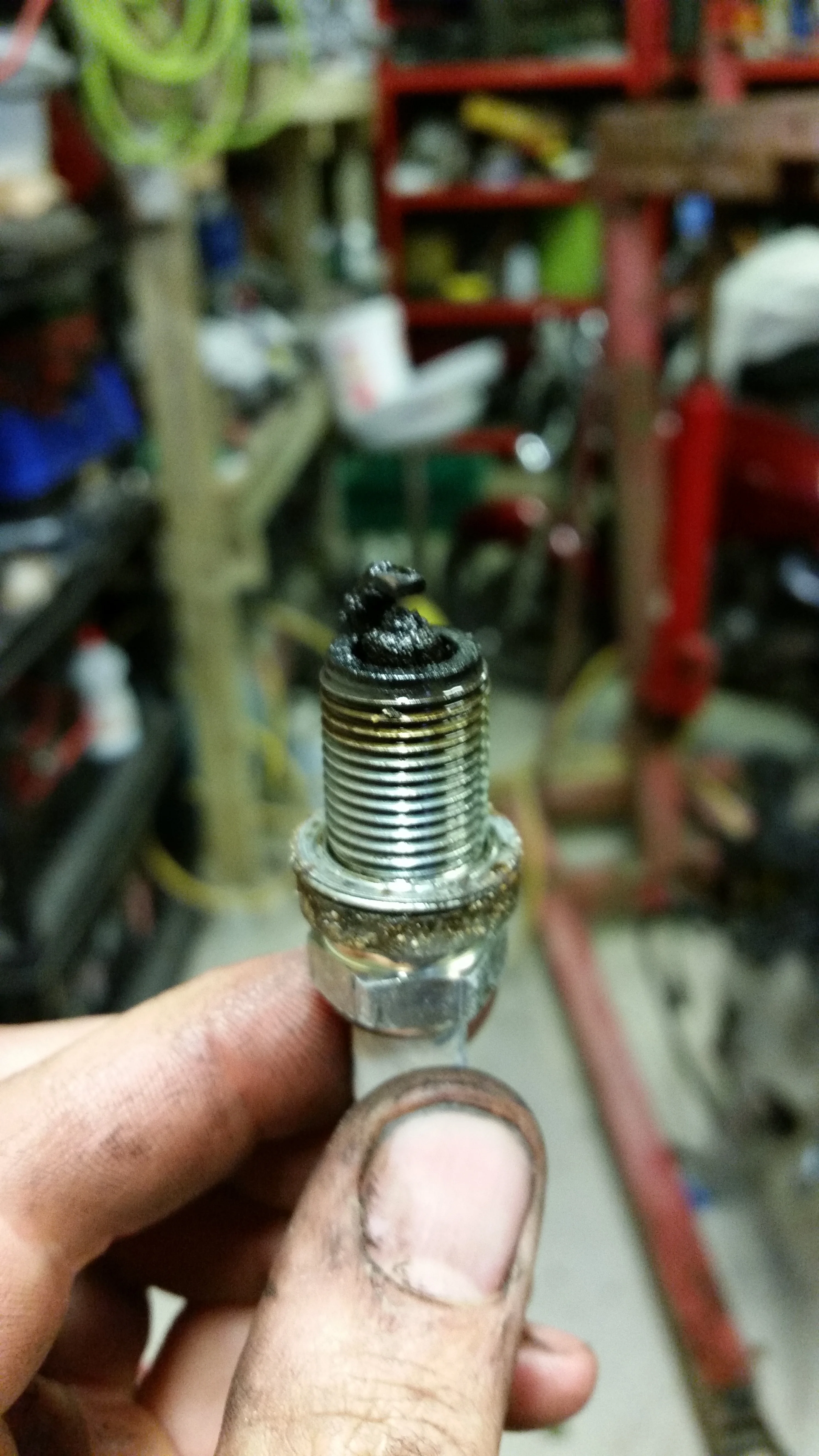

I thought I saw a puff of blue smoke a couple of times starting the car in the morning, but couldn't get any out of it on the overrun so thought I could probably leave it. However the state of the plugs and what I can see of the exhaust valves doesn't look good :(
Any comments on renewing the valve stem seals on one of these?

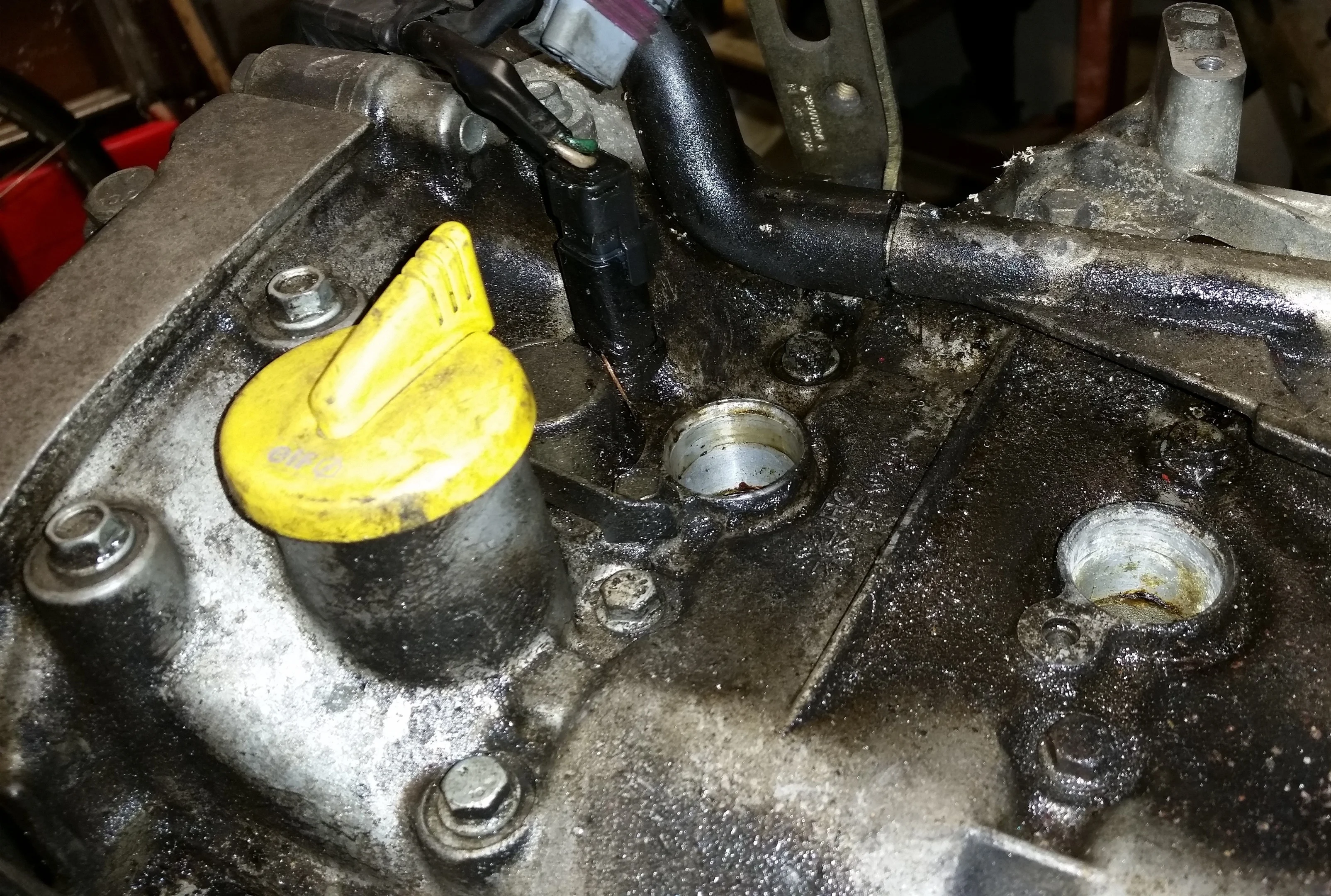

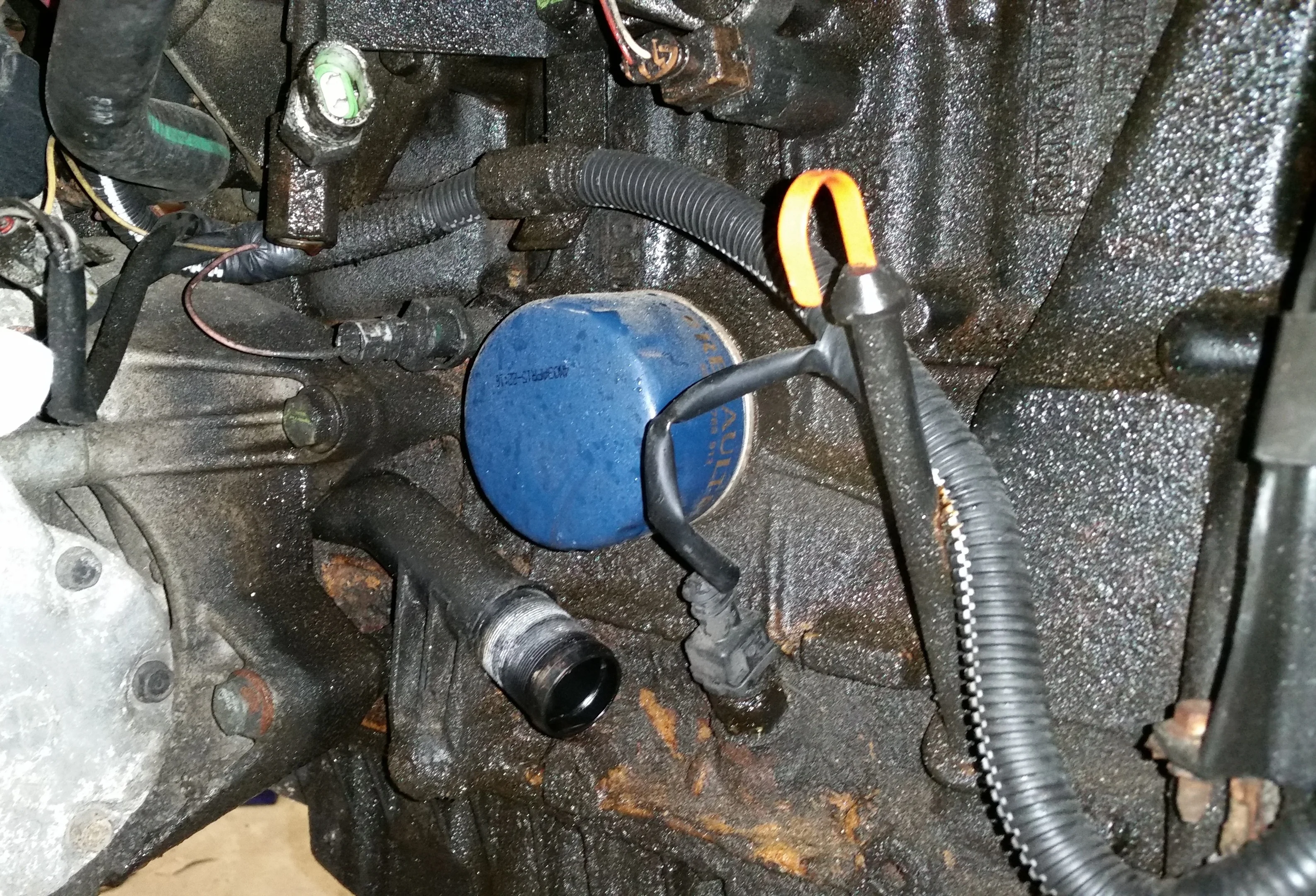

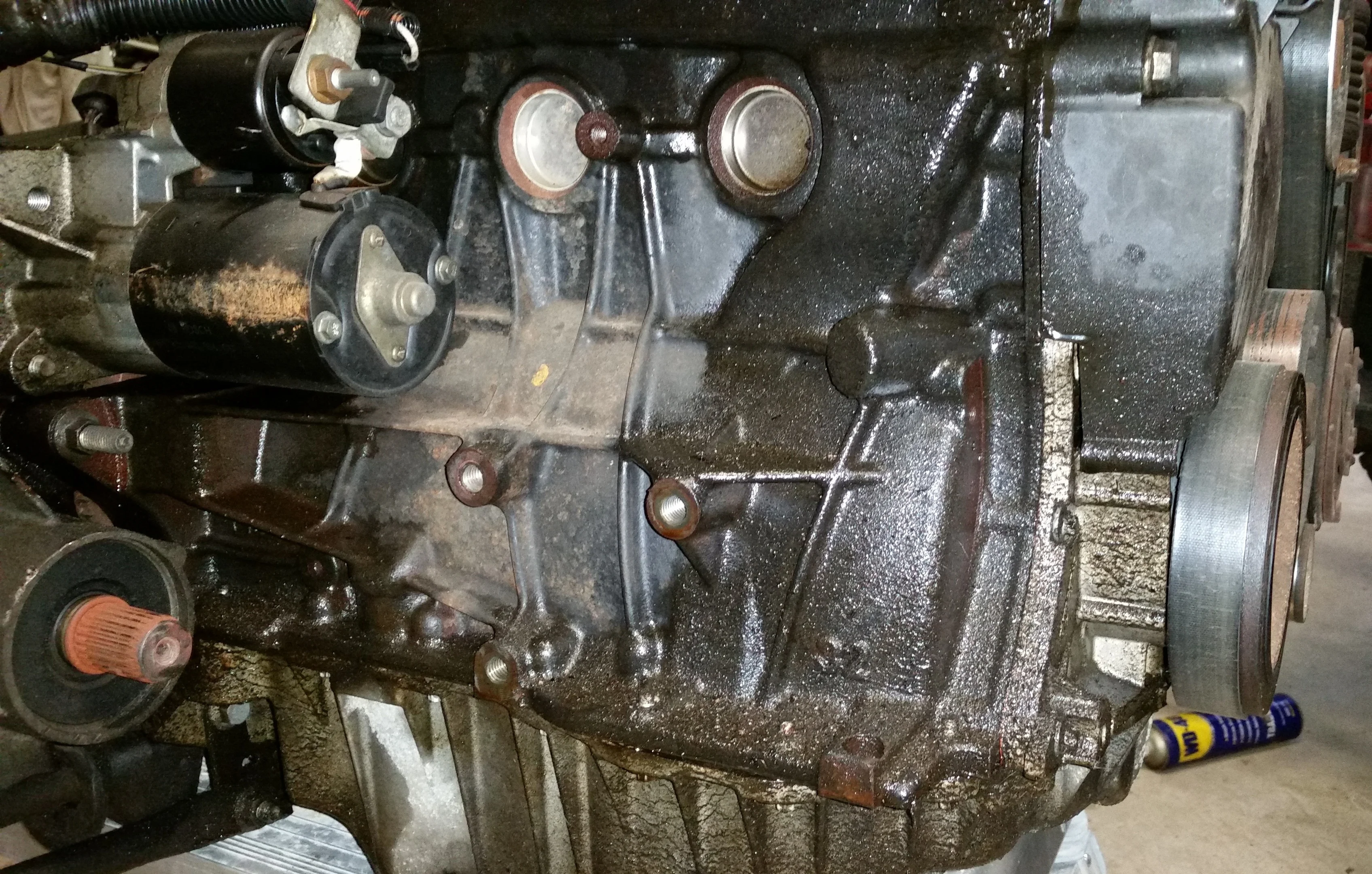

The rest of the engine is very oily, so much so I can't really pinpoint a specific leak. all over the cam covers and down the front and back of the block is soaked. The only definite leak I can say I've got is from the gear selector :(

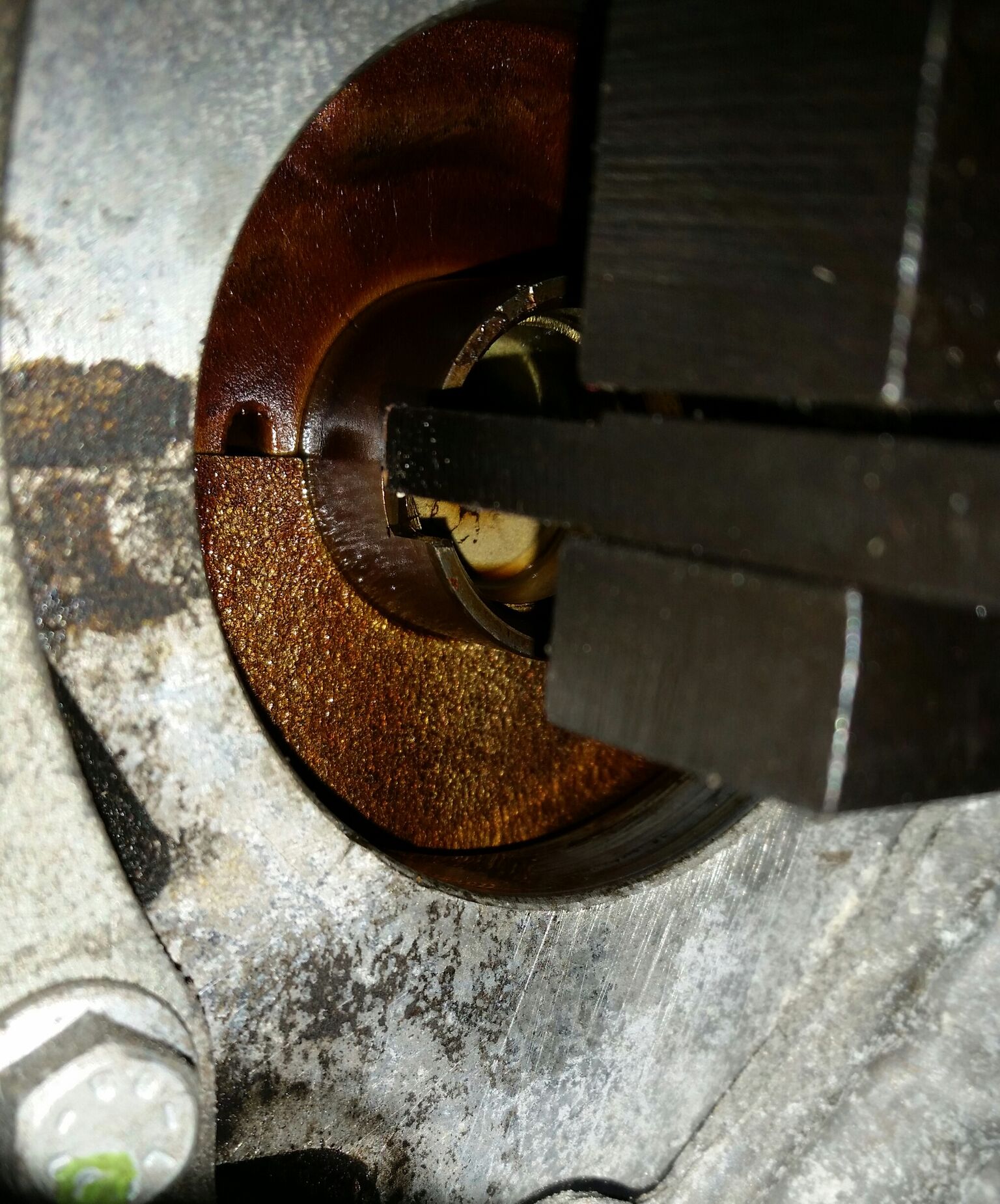

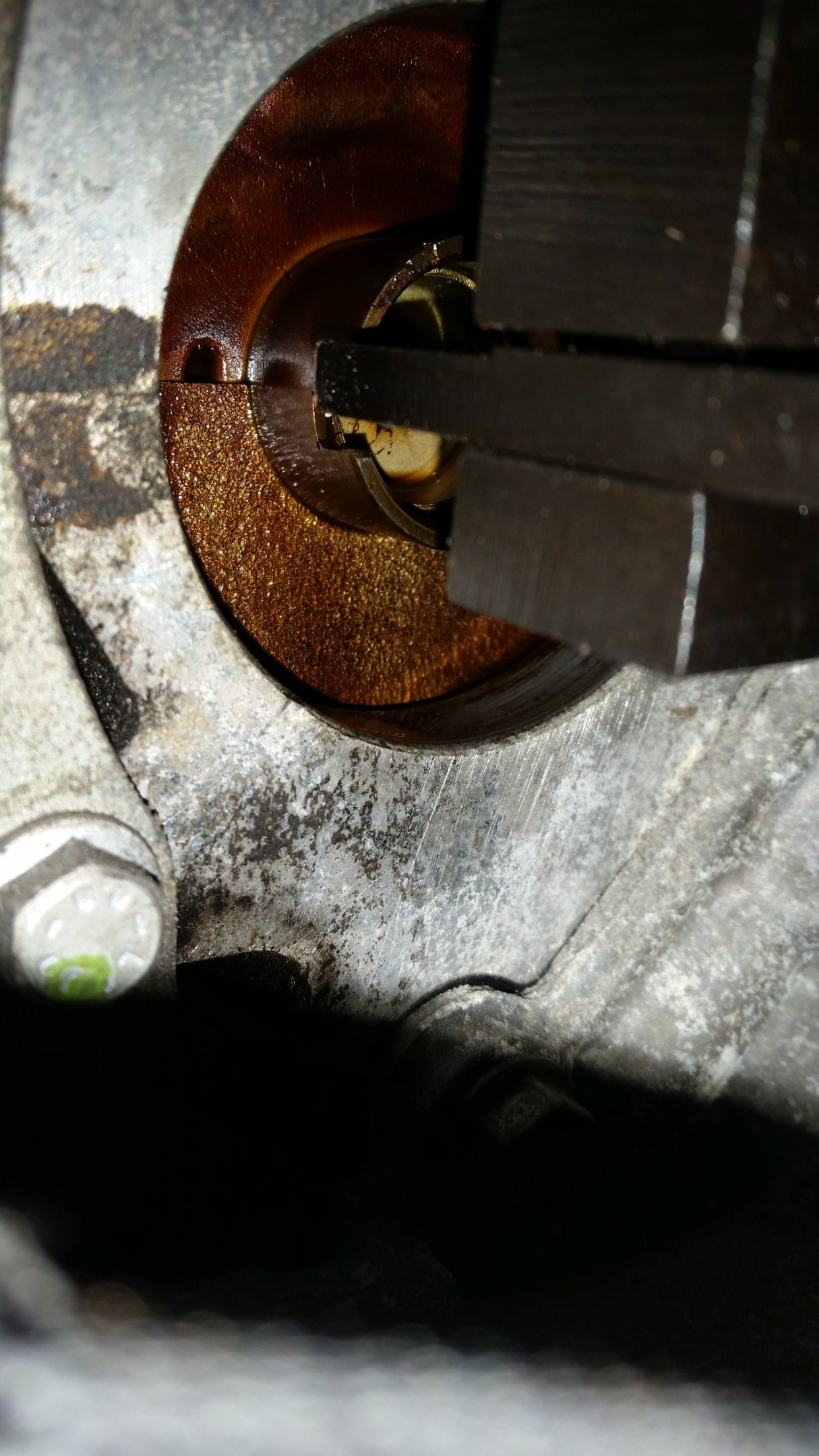

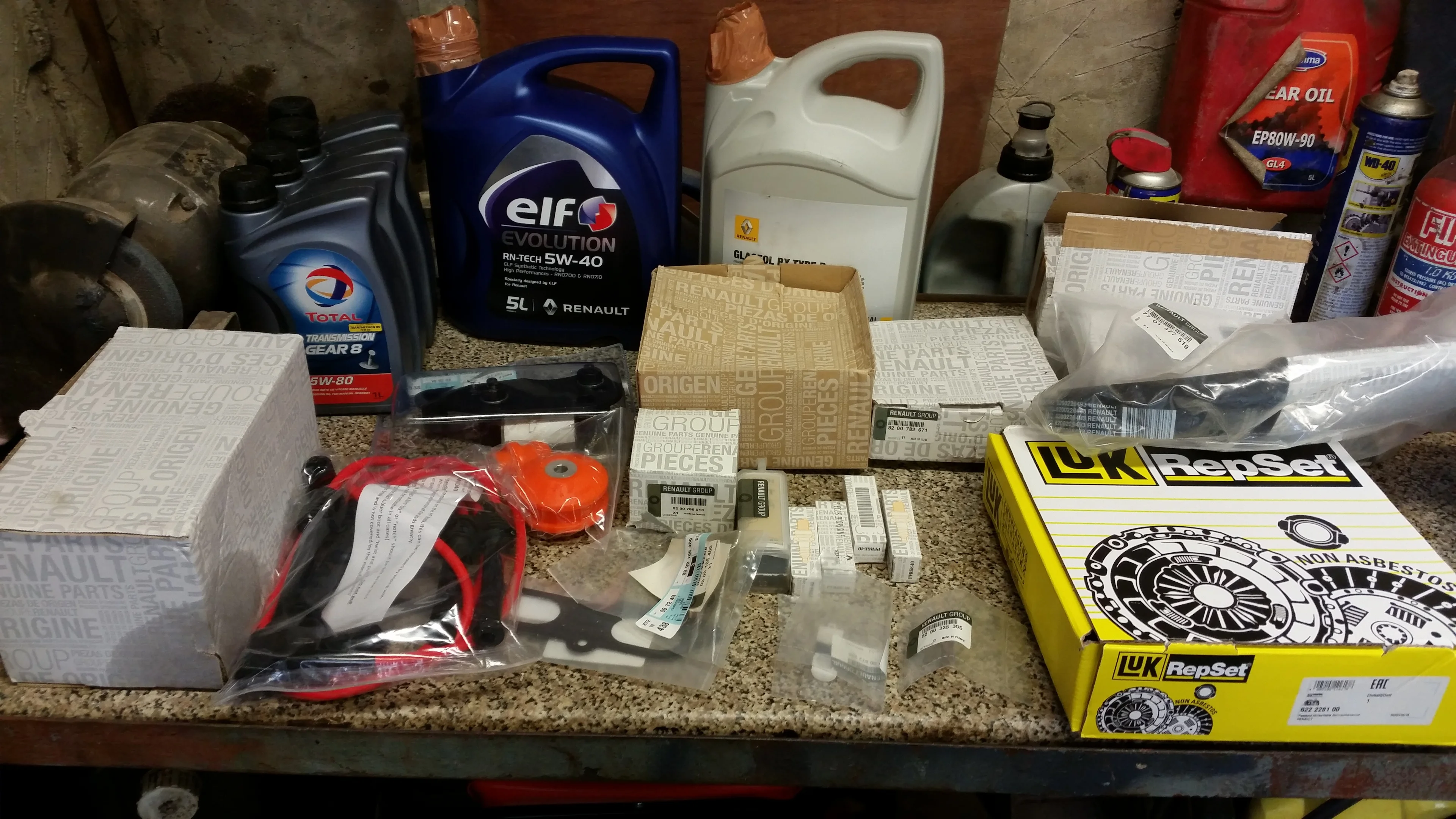

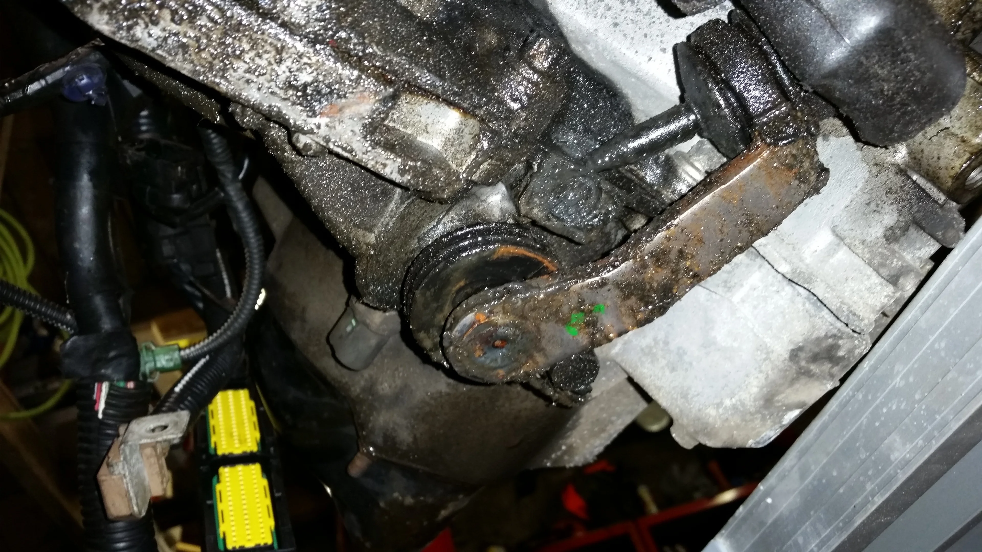

I'd love to send the box off to northloop to get fixed properly, but I just can't afford it. Have ordered a TND kit in the hope that it will at least slow the leaking down to an acceptable level. The car had a slight crunch into 3rd before I took it apart as well, however I'm hopeful this was because all the gearbox oil had leaked out and what little was left in came out black and sludgy!
Any thoughts on the rest of the oil? I can't see anywhere on the cam covers where one bolt or section of seal is obviously leaking, and the breather hose looks to be on tight (I can't get it off) If my valve seals are gone do you think the cam cover might be pressurising slightly and just blowing oil out everywhere?

I'd run a Valeo clutch personally, although LUK is a decent brand.
Get a heatshield for that starter motor too otherwise it won't last long.
  Clio 172
Went with Luk for the clutch as it was the cheapest decent brand I'd heard of. There is a heat shield for the starter too it just came off whilst removing the engine.

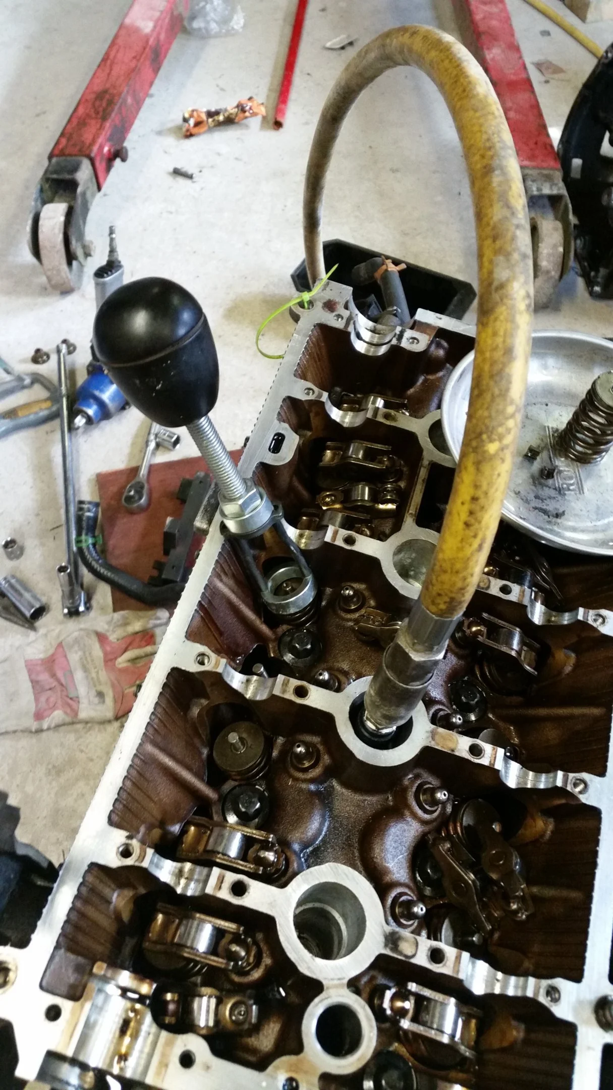

So has anyone had any success changing stem seals without removing the head on one of these? Or am I going to have to do a headgasket on it as well?

Was hoping I could do the rope in the cylinder trick to stop any valves dropping while I changed the seals, and yeah no indication why the headgasket had to be done it was ages ago though I'll double check when but I'm sure the car has done 50k since. I should have done a compression check before I took it out really just for peace of mind
R3k1355

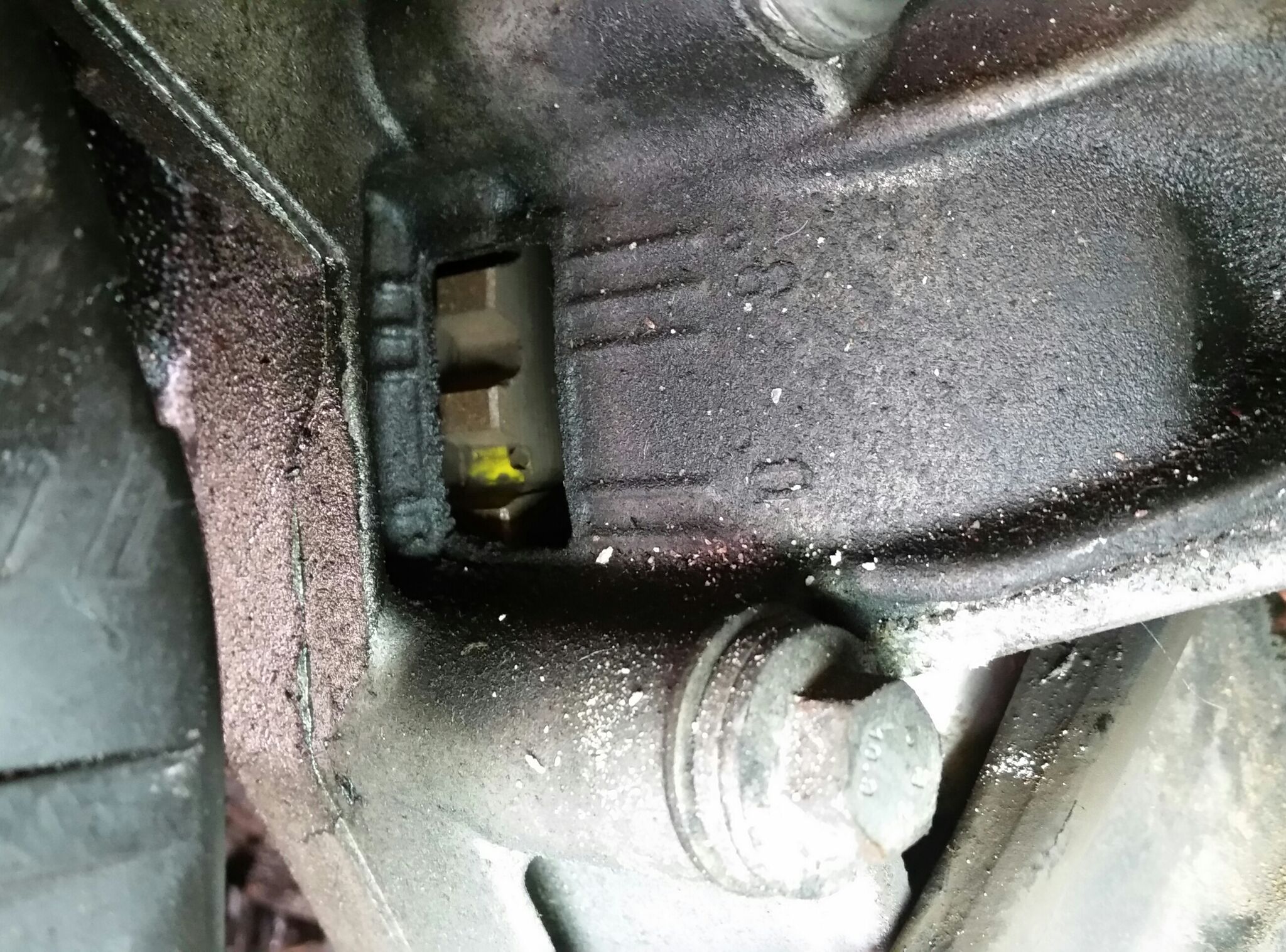

They all leak from the selector, i wouldn't worry about that for now unless its pissing out.
This, they all leak and they all look really bad when you first see it.
but they've been leaking for years and chances are you're the first person to do anything about it.

That's positive about the selector seal, at least even if I can only improve it a little it'll be worth it.
As far as I'm aware the valves, head and everything else are all ok it's just seals that have gone, so at about two quid each it won't break the bank to replace them all.

Won't be removing the head just to change stem seals, however if the compression test comes back bad it does look like a new engine is going to be the way forward ill keep the thread updated as soon as I've got any news to report!

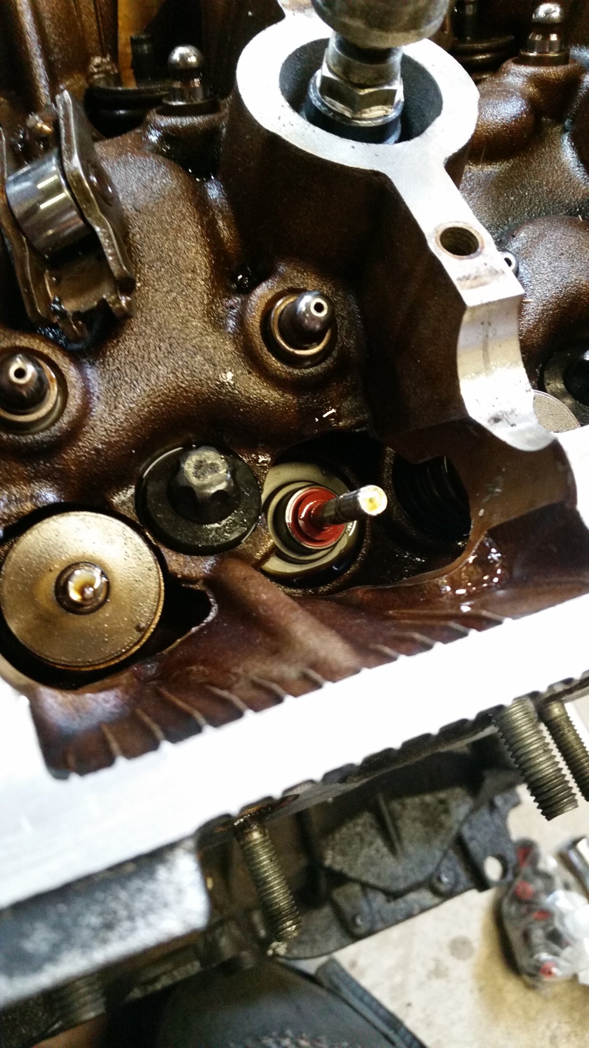

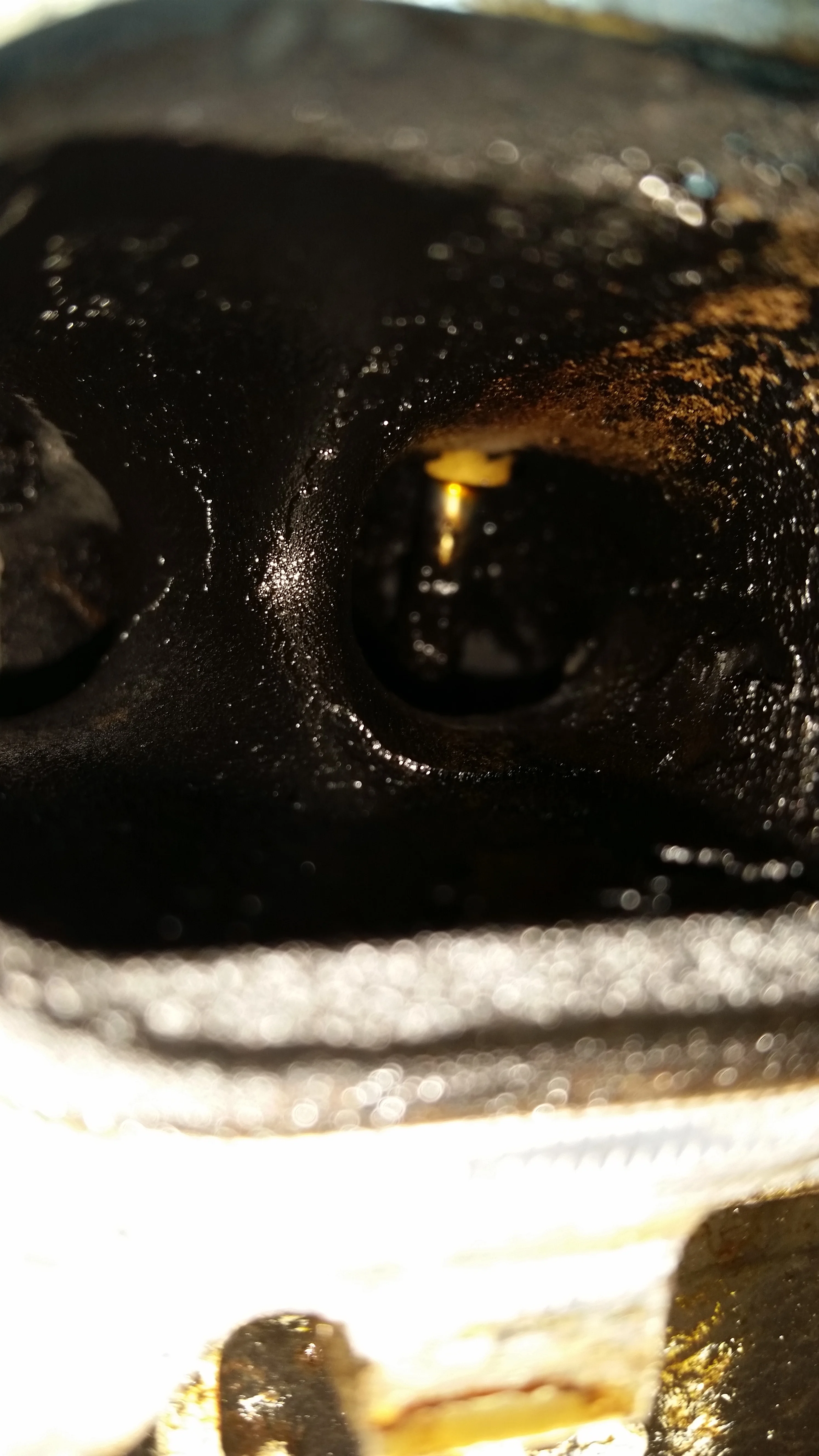

Thought I'd update this as I realised I never got round to it! As the compression check results were good I decided to go ahead and sort this engine out. A good look over it and I replaced all the belts and pulleys, water pump, resealed the cam cover and fitted a new sump gasket, new cam seals both ends, new spark plugs and HT leads, and replaced all the valve stem seals which was a right pain in the arse!
Checked the timing before I started, it was way off! The car used to cut out straight after starting occasionally, think this was probably the cause.

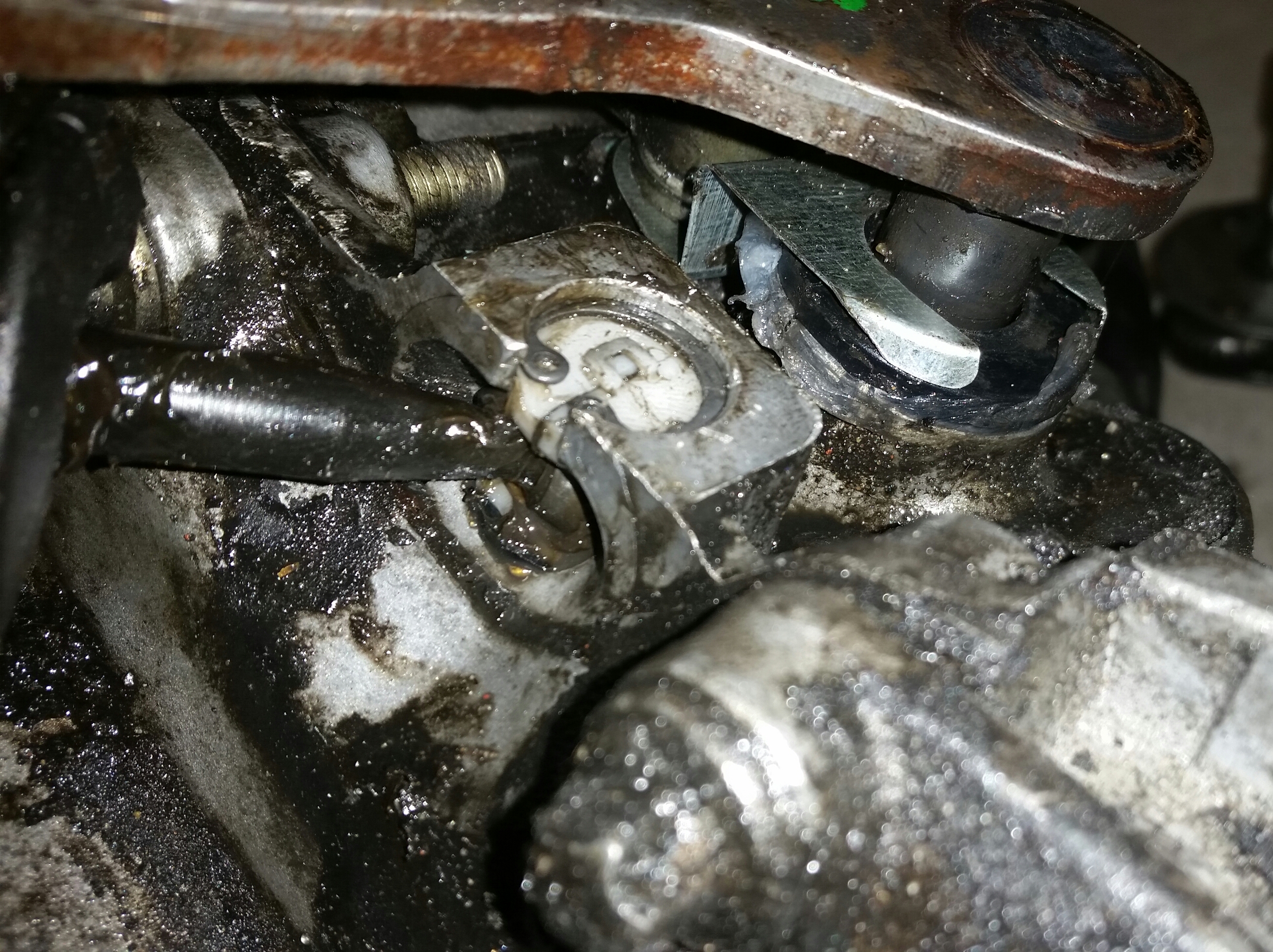

Tnd seal kit and new selector bush fitted in the gearbox.

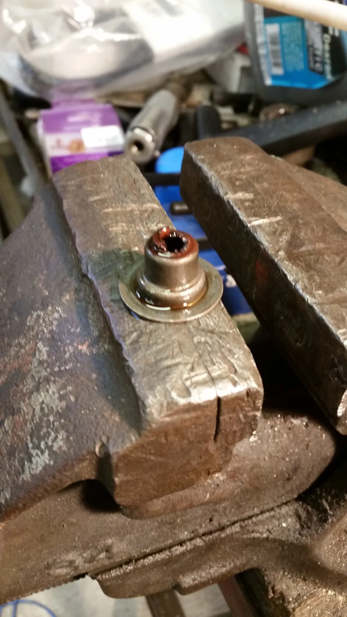

My modified sealey valve spring compressor setup. Had to take it to bits as the valve stem seals are recessed in the head so the hooks can't grip the bottom of the springs, instead I have to push down as hard as I could on the gear knob and use a mixture of magnets and screw drivers to remove and refit the collets. Very fiddly!
New seals in
old knackered seal, there were quite a few in this state in the end surprised I didn't get a lot more oil burn than I was suffering!
So, got the car all back together, and other than a dodgy crank sensor plug that had me scratching my head for a day or two it fired right up and is running as sweet as a nut!
Gear change is much improved, haven't had any crunching in any gears yet, I think the poly bushed dog bone mount, new selector bush and actually having some oil in it has helped there. Also sorted out the steering, had power flex rack mount bushes and new inner tie rods, gaiters and track rod ends, but I didn't get the alignment quite right so it feels a bit odd and won't hold a straight line, the wheel keeps wanting to flop left or right hopefully a four wheel alignment setup will cure this and then I can start giving it a proper seeing too!
https://www.dropbox.com/s/0lofm2dev6k3fda/20170820_104957-1.jpg?dl=0
https://www.dropbox.com/s/2ky8qu1abv84ghi/20170820_185407-1.jpg?dl=0

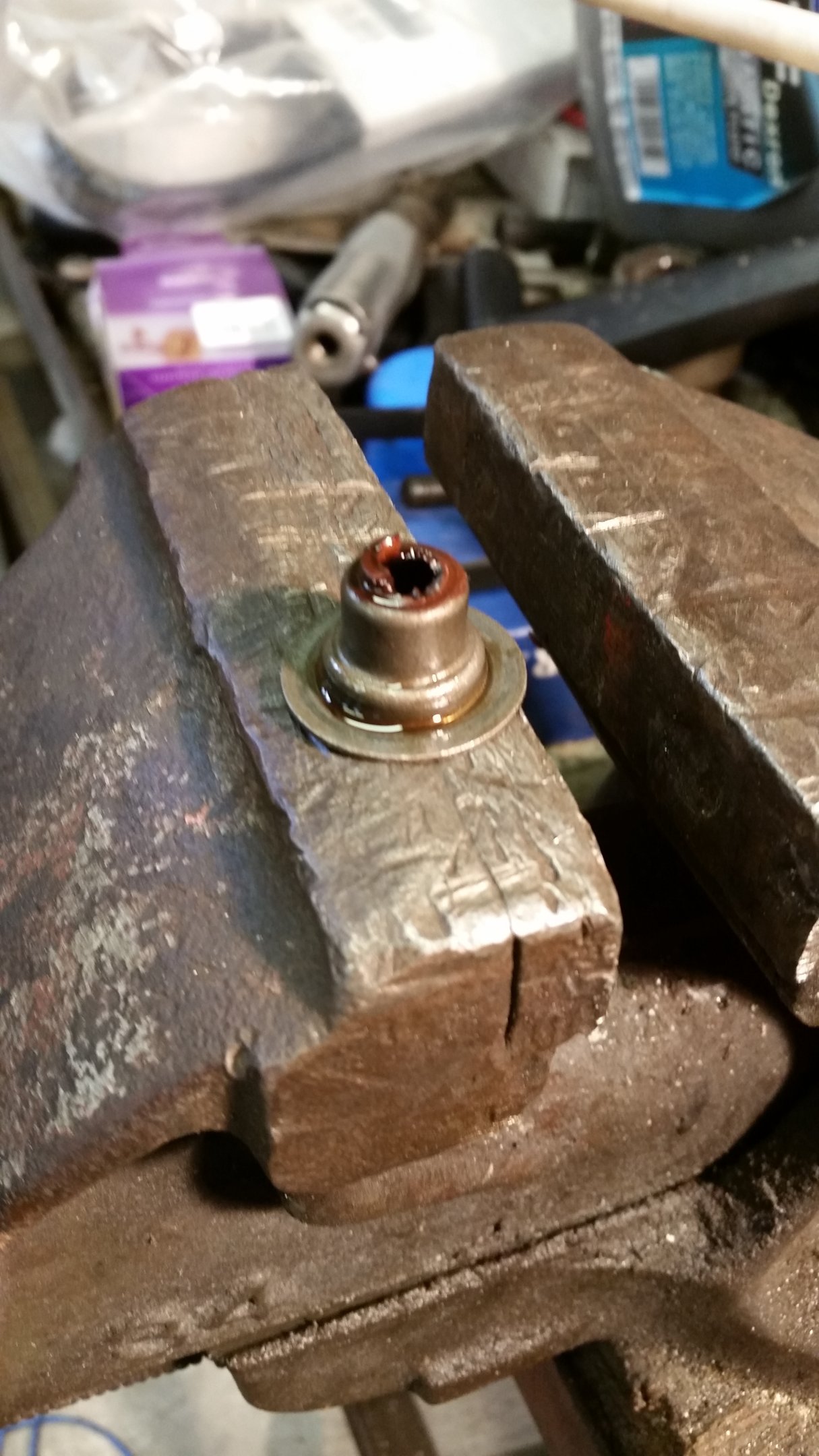

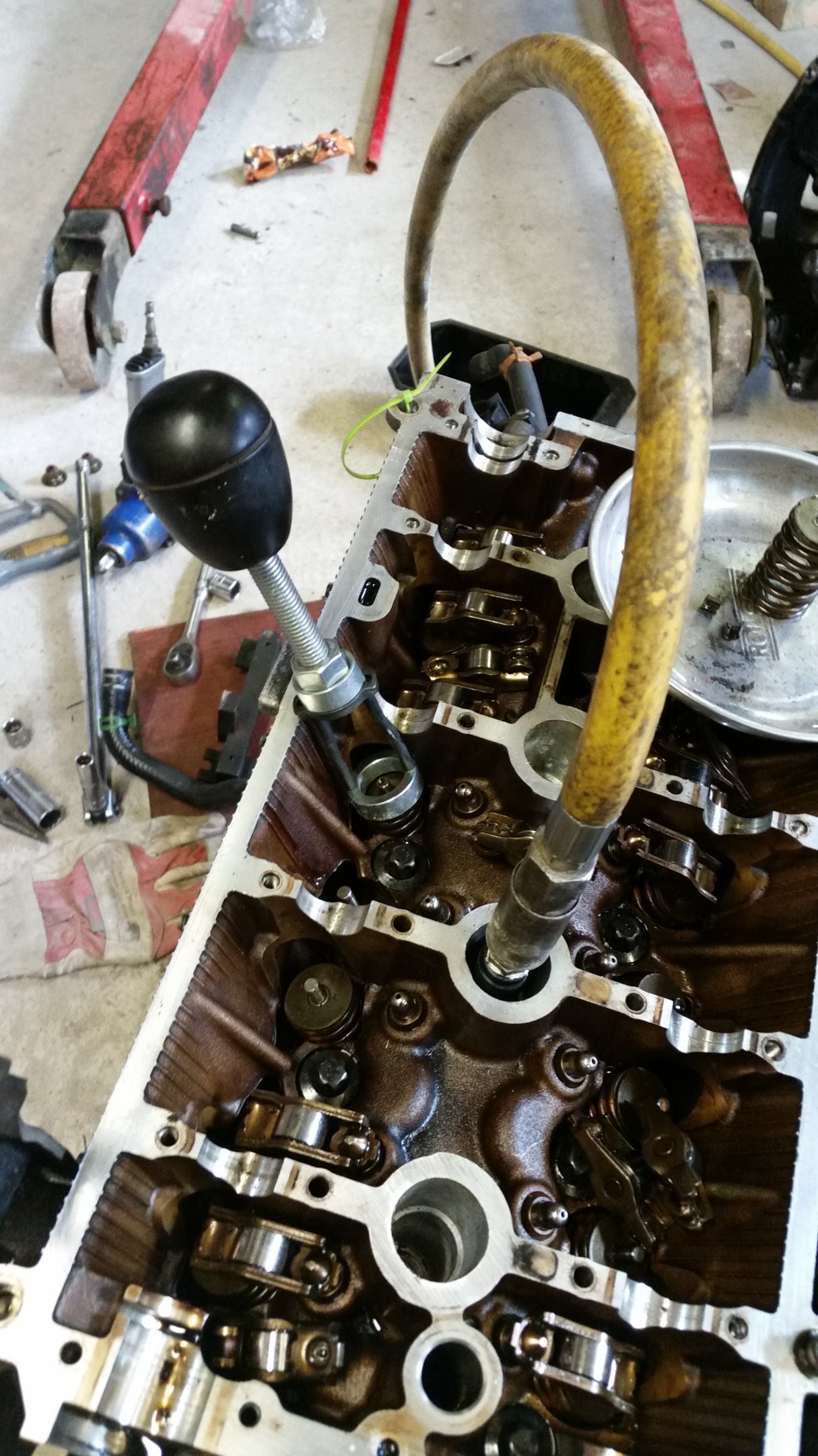

https://www.dropbox.com/s/h4mnkzffe2cynt6/20170916_120029.jpg?dl=0
New seals in
https://www.dropbox.com/s/3vqi32c1gzgjo16/20170916_120008.jpg?dl=0
https://www.dropbox.com/s/z1niz21bcnqyx4b/20170916_133746.jpg?dl=0
