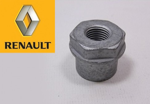

So I hate to revive an old thread but it seems there have been many, many,many conflicting fixes.
My issue
Genuine Renault strut top kit fitted last year, awful handling with original bush.
Thought I would rectify with modified spacer nut/bush with the above strut top kit. Worse than before. Slop on the top rubber mount but thought to myself well it may be a "loss motion" type fit.
Now I have ordered Febi 37597 strut top mount repair kit. But only have the modified nut/bush 8200867250.
Do I fit and forget or should I remove some thread from the bottom of the modified spacer nut to allow it to secure the bearing to the top side of the spring platform?
I am at my wit's end truly 😭
Clio 182 FF with standard cup dampers (new) and cooksport springs.
