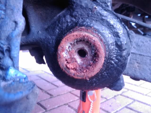

Had a quick look at my torsion bar today and just wanted to know what i could use to remove it? Gave it a load of WD40 today too.
Cheers guys.
does it just screw in the whole?
And where can i buy one from? hope there not too expensive
I made my own at college, works a treat everytime
and the thread inside which the sliding hammer screws into, M10
As for where to buy one from, no idea sorry mate
Edit: Try and Wd40 it as much as possible now to clean/loosen it up for when you do lower it
Take the weight off it. WD40 it so its dripping like a virgin.
Then use either a slide hammer. Or a long M10 bolt with a socket + a nut to tighten the socket onto the outer caseing.
I think i'll keep spraying WD40 on it everday until i get a sliding hammer :D
