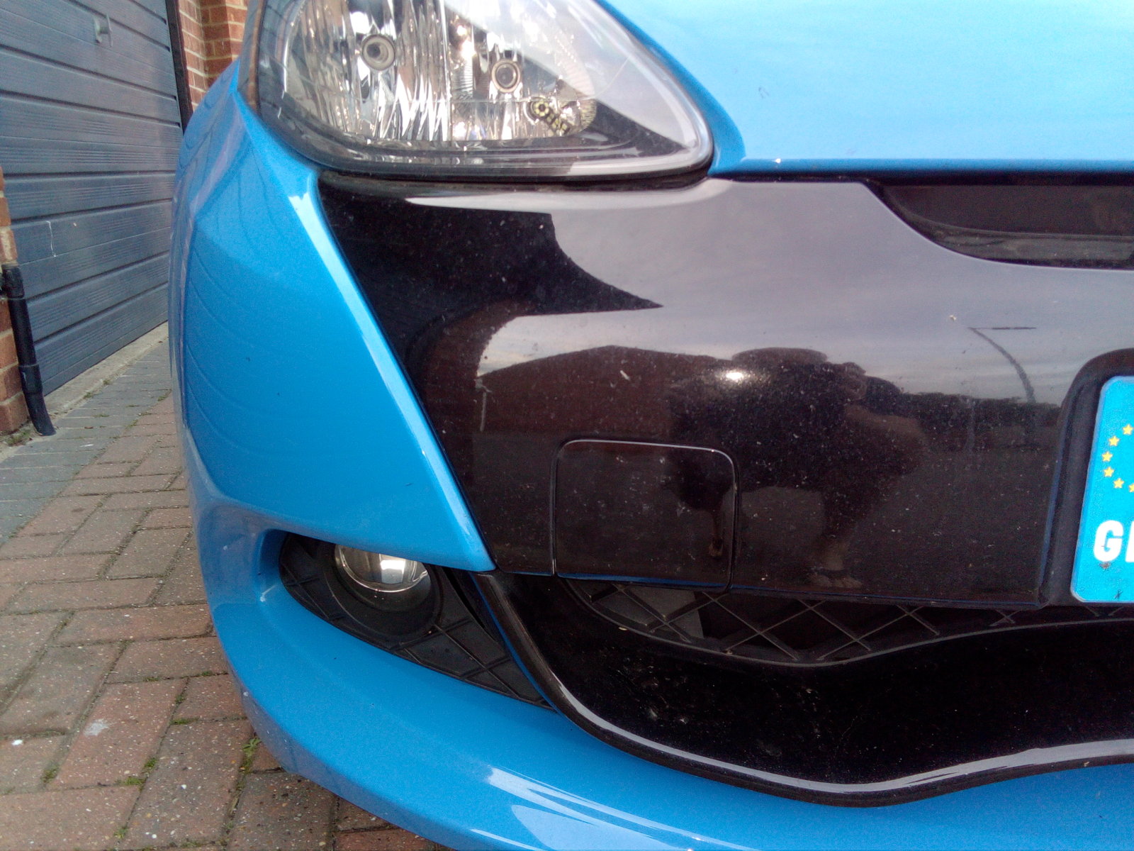

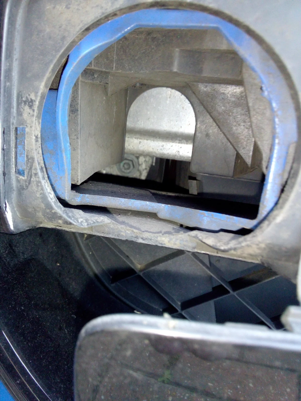

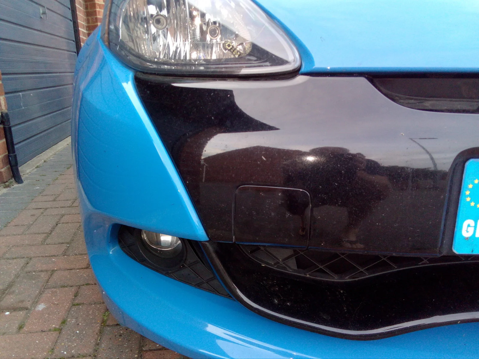

My son is sorting his Clio 3 RS for a trackday and one thing required is obviously a towing eye. Whilst he has the eye from the boot when you remove the towing eye cover from the front bumper there is no hole in the cross member. Before removing the whole bumper assembly I just wondered if this is a common problem and a very simple explanation.
On the other hand is it something weird like we have a French chassis and an English bumper so the hole is on the other side where there is no cover??!!
Any help appreciated.

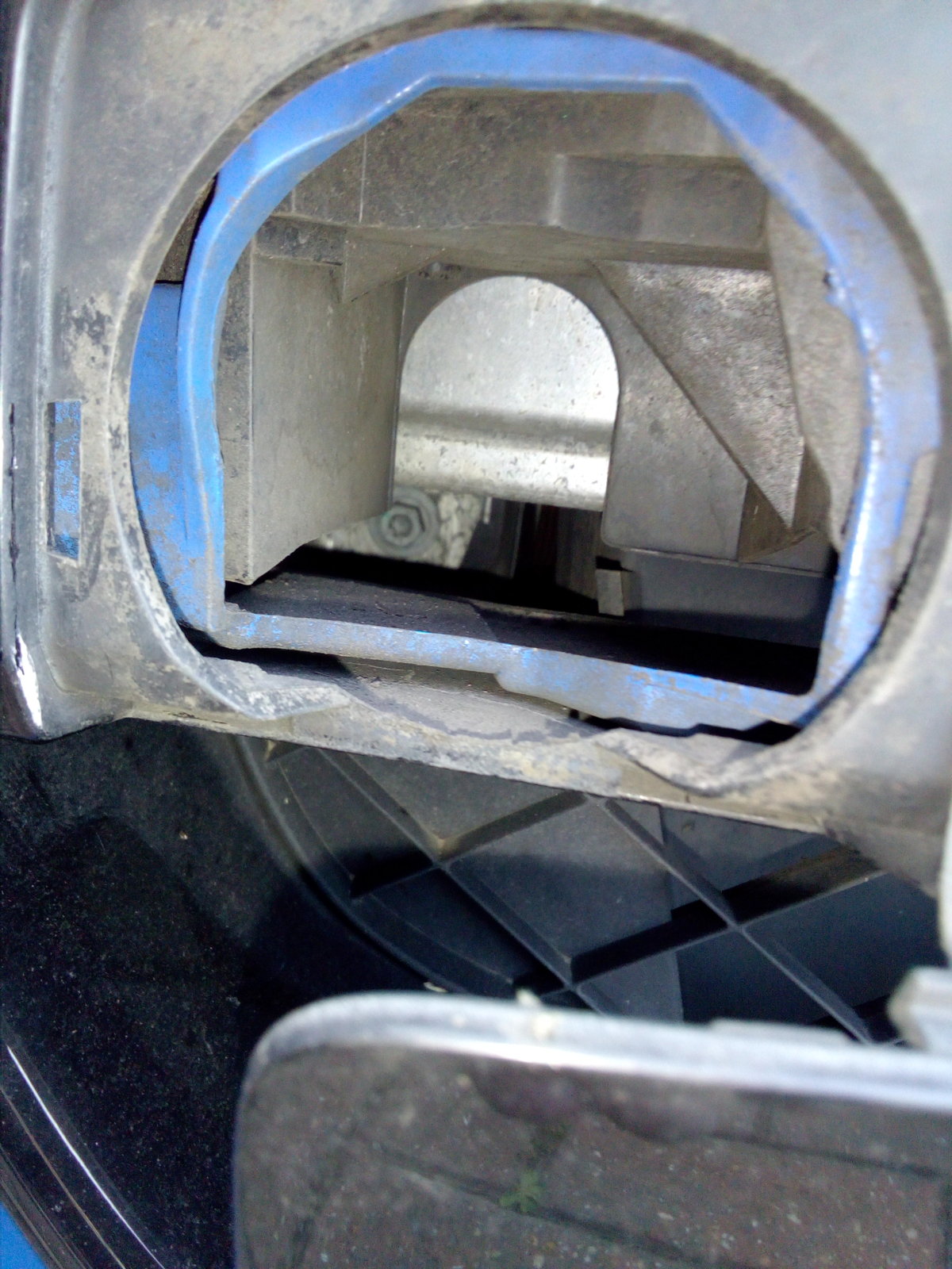

Yes it is a bit odd. We expected this to be straight forward. Problem is you can't see this cross member from in the engine bay so the only way I can see is for a bumper removal. Then depending on what is found either drill the bumper of the cross member.

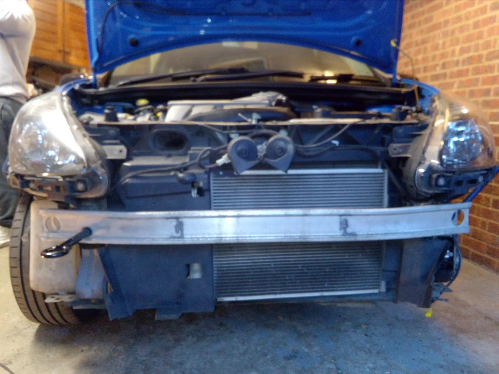

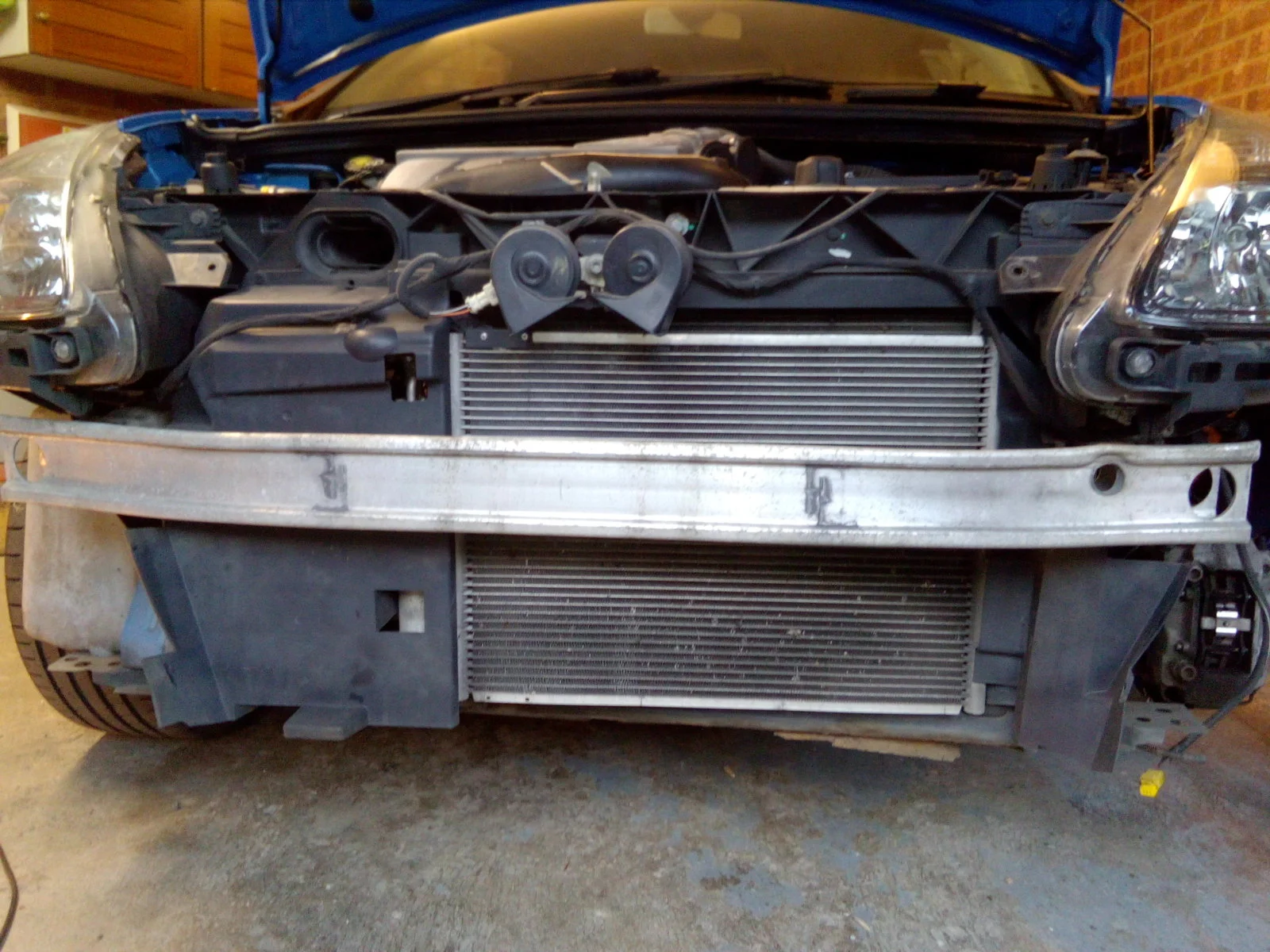

The answer to various questions is as follows;-

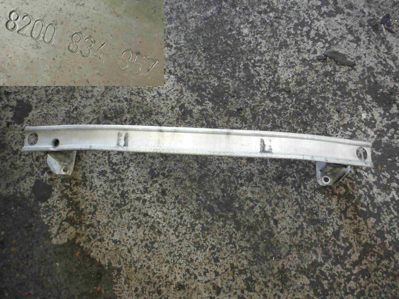

Yes the collision bar does sit further forward on the passenger side than the driver side.
Yes it will fit either way round.
The brackets are what makes the difference in position from driver to passenger side.
To remove collision bar you only need to undo two bolts and remove, then turn bar round the right way and re-bolt.

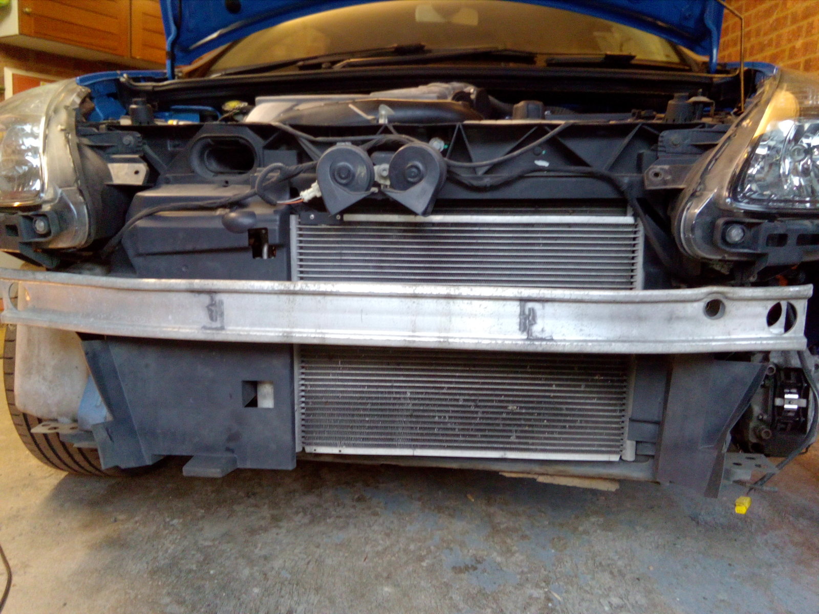

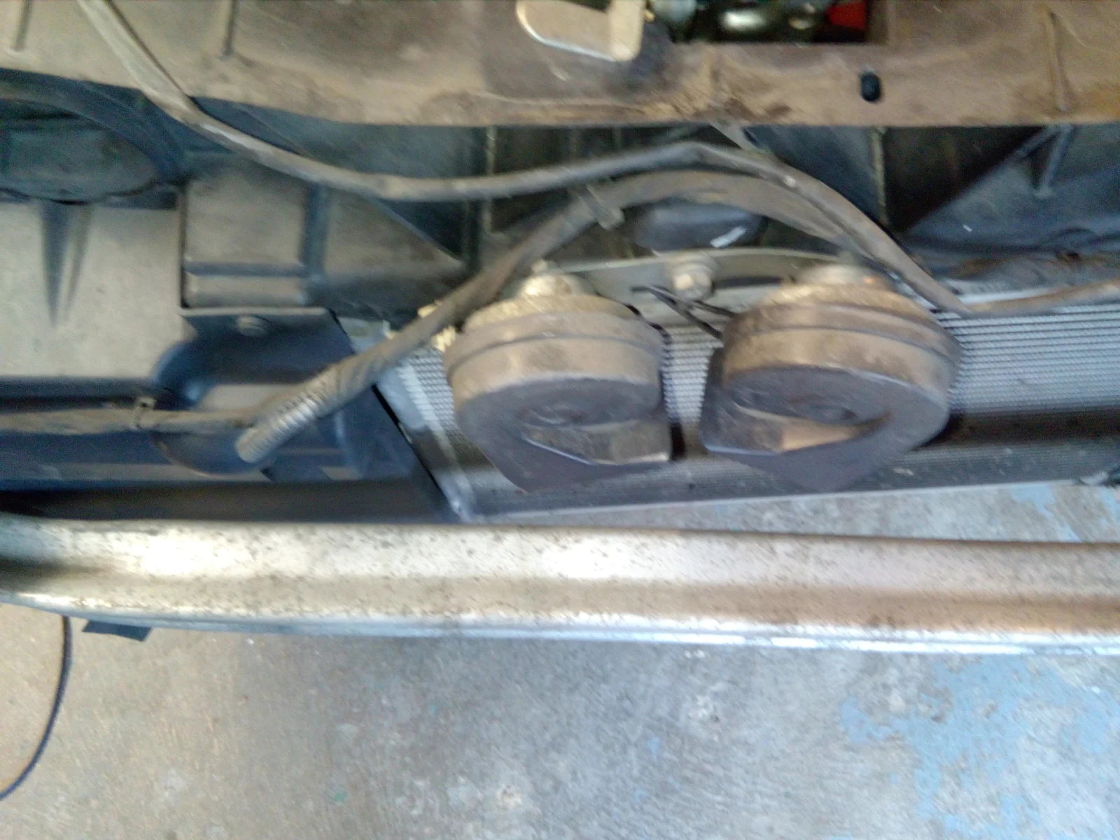

PROBLEM: Whoever had taken the bar off in the first place had put the bolts in differently at each end. You cannot remove the bolt if the head of the bolt is on the top such that the length needs to come through the bar and bracket which means the headlight is in the way. This needs removing to get the bolt out. The bolt at the other end had the head at the bottom and hence would drop out ok.

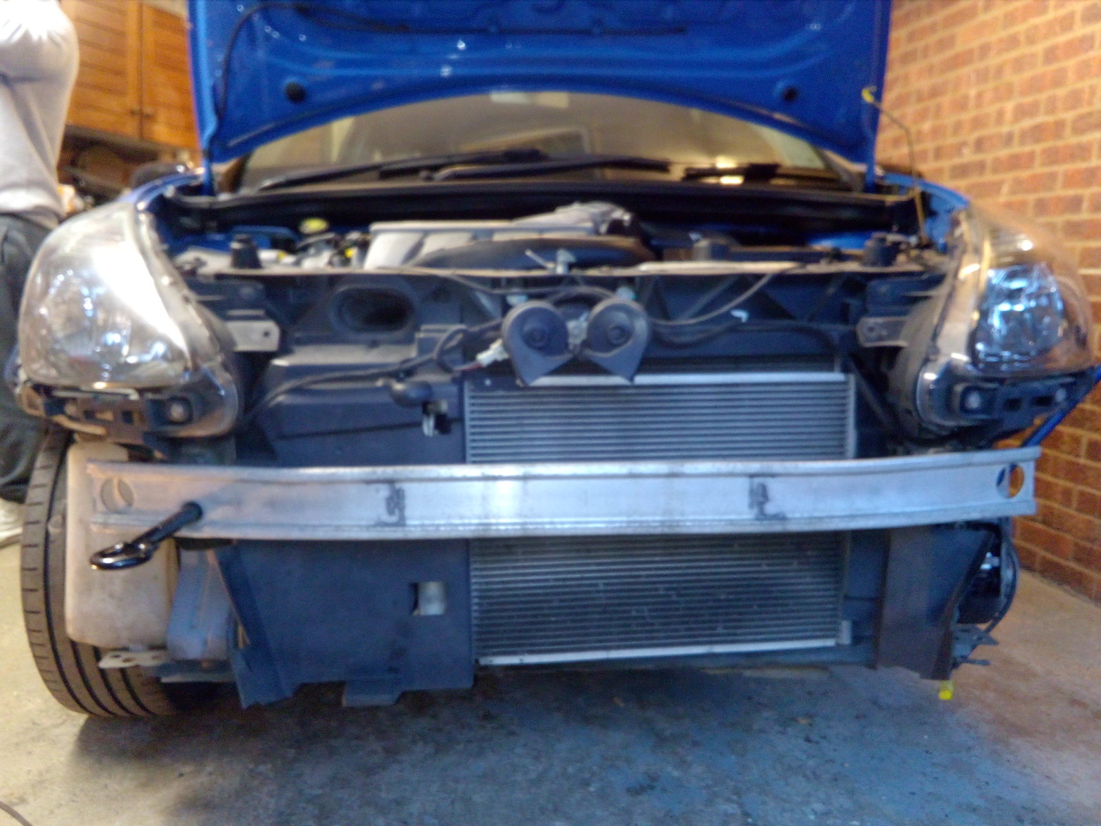

ISSUE: Not sure which way they should have gone back (normal method is head at top so if nut comes off the bolt stays in situ) but I put them head at bottom and applied some threadlock. At least you can get the bar out without removing the headlights now. I'm sure I will be told if that is a major no no.
I've attached some photos to help clarify. First one shows angle from driver to passenger and the gap difference. Second and third are as the bar was and as it is now.
Result is eyebolt now fits where it should.
