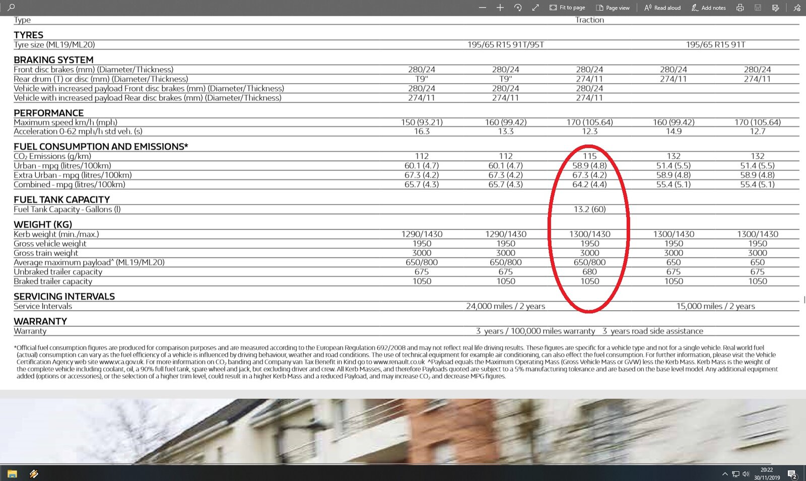

Can someone confirm this then, or rather @massivewangers can you break the above down again in plain English for me 🙉😂
So in theory I could tow a small car and trailer that’s under that 3500kg workout doing the B+E?
Is the licence only for over 3500Kg?
Edit: all I’ll really be doing is towing a medium type trailer to the tip etc. Couple of building materials etc.
