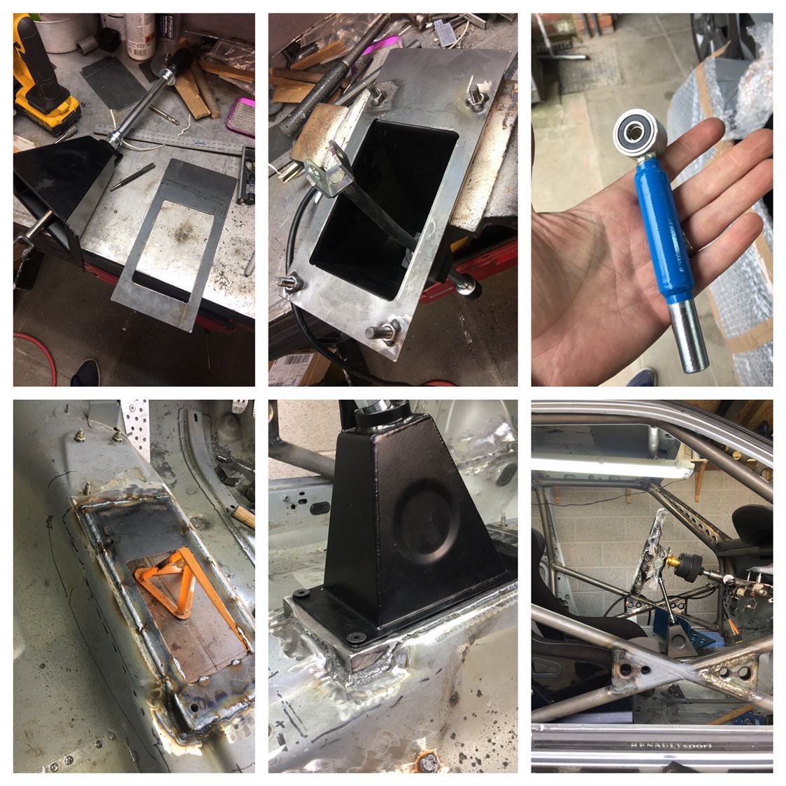

I can’t remember who is was but there is a build on here where that they have fitted the shifter further back and made the linkage longer. Anything is possible ?

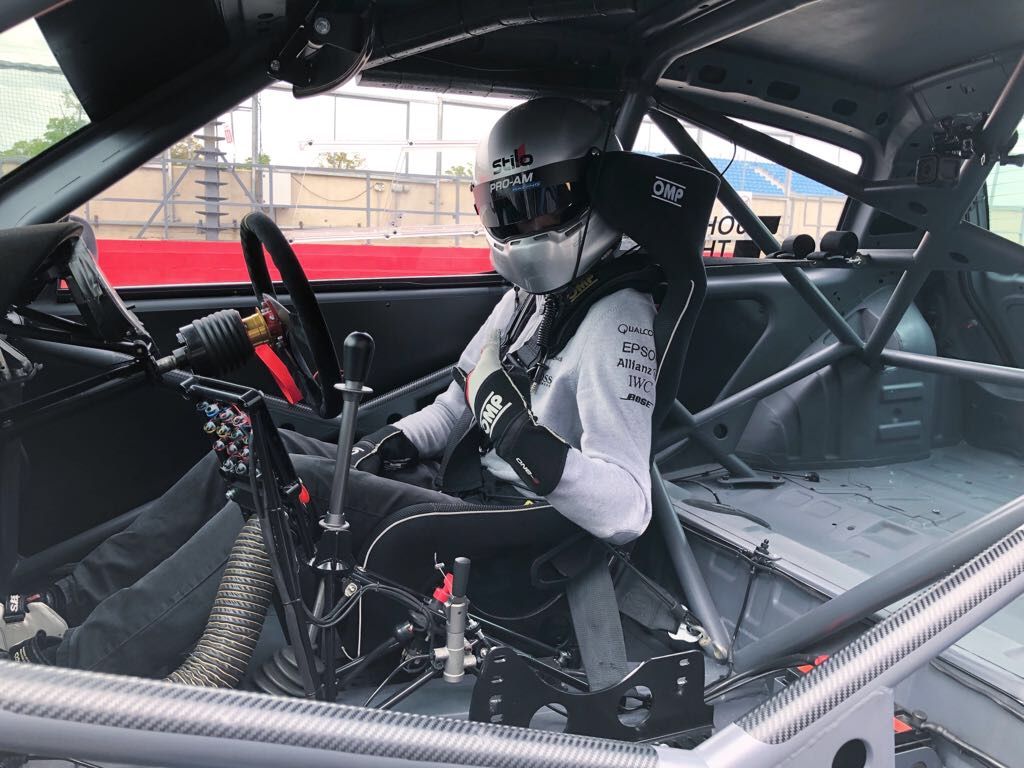

It will all depend on where you position the seat.. our seat is as far back as possible for CG purposes.. So I had to move the gear lever back about 20cm
I moved mine about 5cm inwards. Surprisingly makes all the difference. I am 6’4” by the way. Seat is as far back as physically possible. More details in my build.
