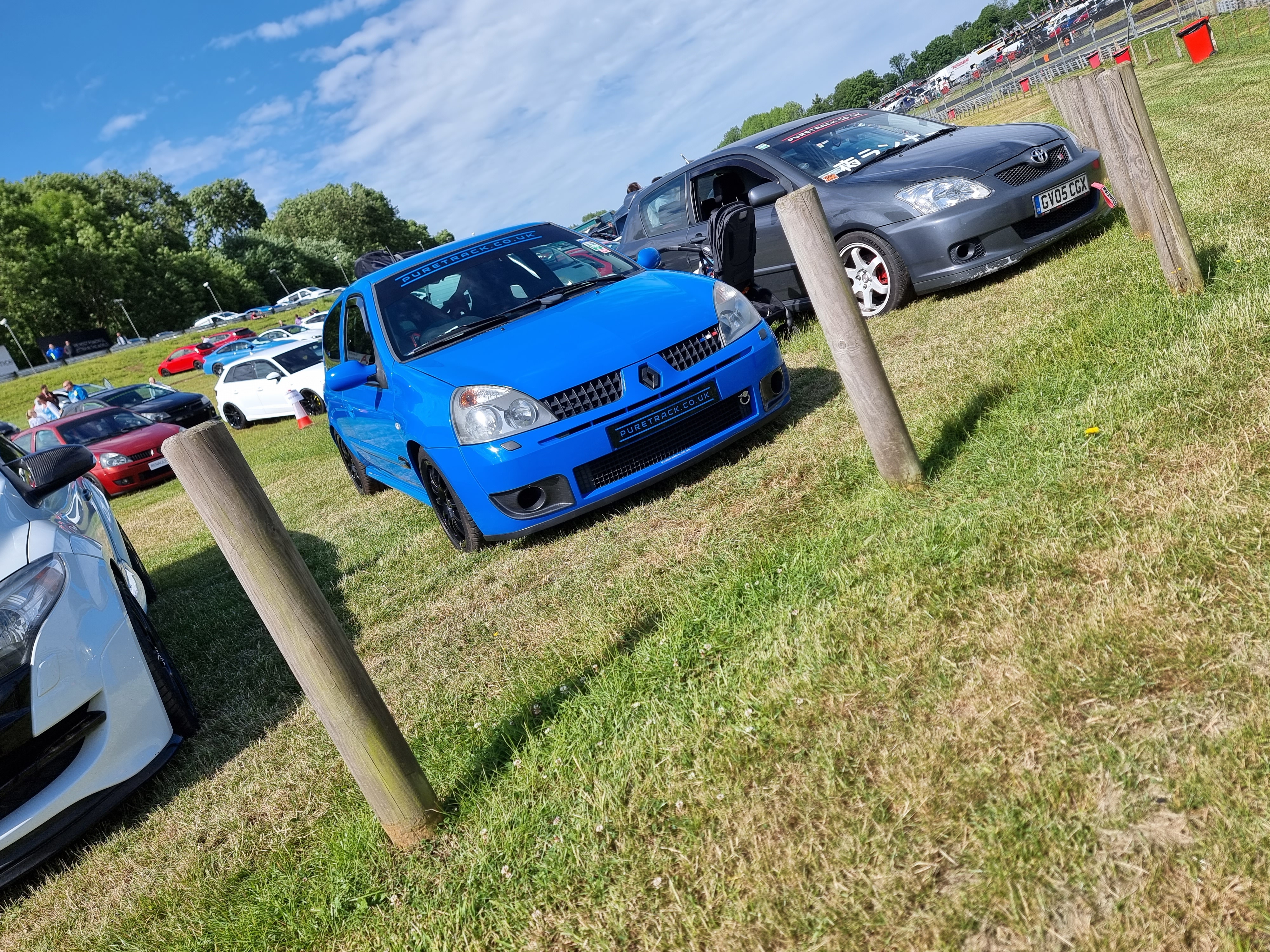

Hi all,
no doubt it’s been discussed previously on this group.
what Coilovers are everyone running for track only clios. Our track day got cut short today with a blown front strut so time for a change.
Just looking to see what everyone is running?
pic for attention

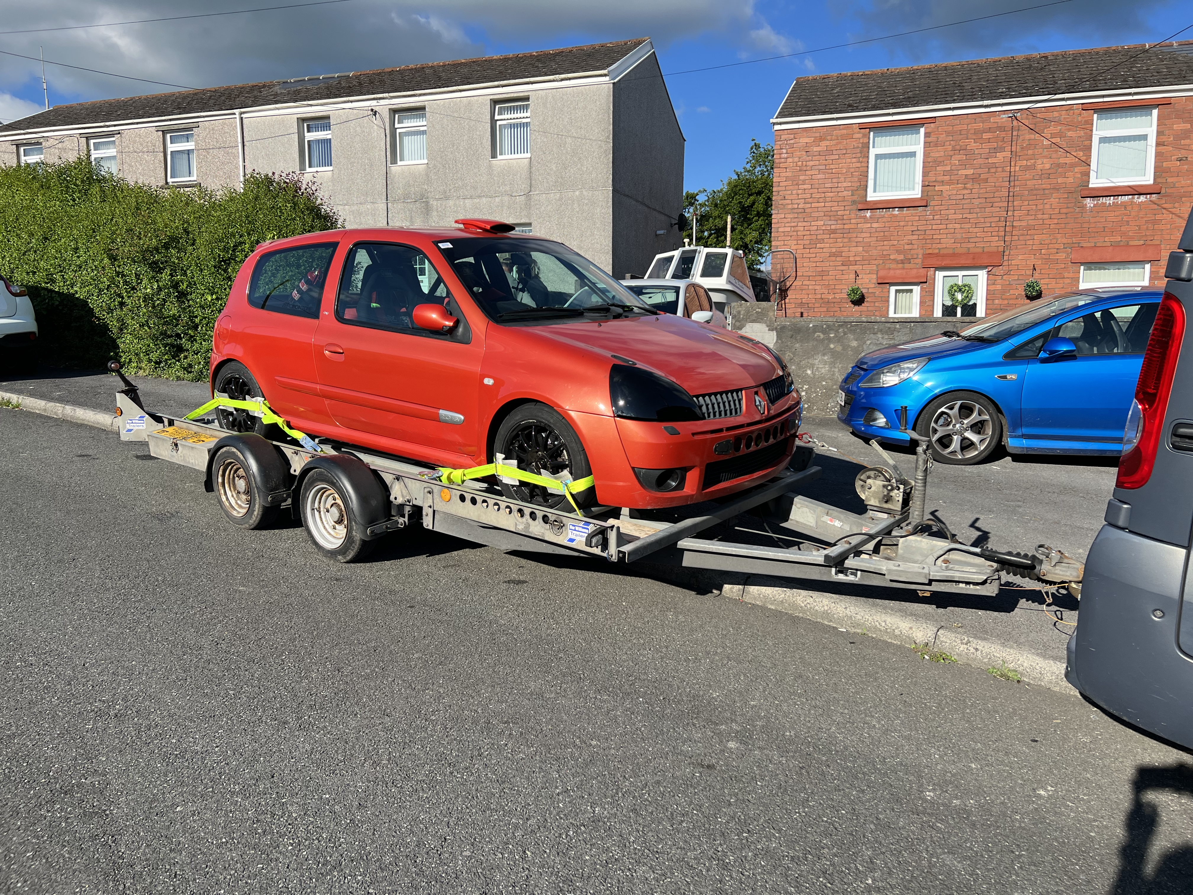

I’ve currently got Gaz GHA on my track only (trailer everywhere) 182 with 450lb rear springs full coil over & 600lb fronts, looking to upgrade these over the weekend winter, I’m very tempted to go for the ktec 750mc set up, any more feed back on these would be greatly appreciated.
