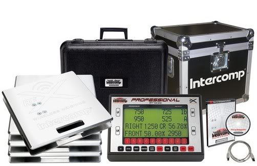

Somewhere like Jameswatt? ;)
I'm applying for a job there, tea-boy and entertainer of female clients. I'm cheaper than a courtesy car.
"the Twig" got new a new toy yesterday :D
