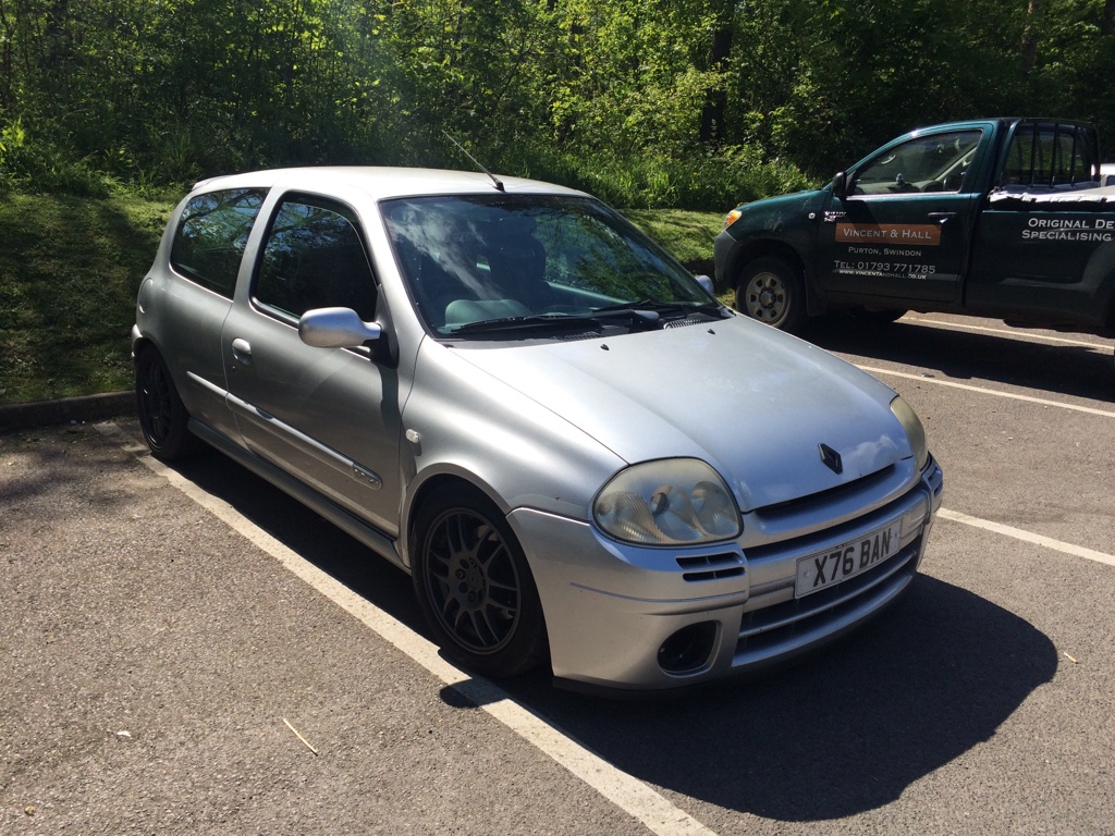

After a long day yesterday I've finally collected my track car. The car has great history on the forum, having been owned by 3 or 4 different guys on here.

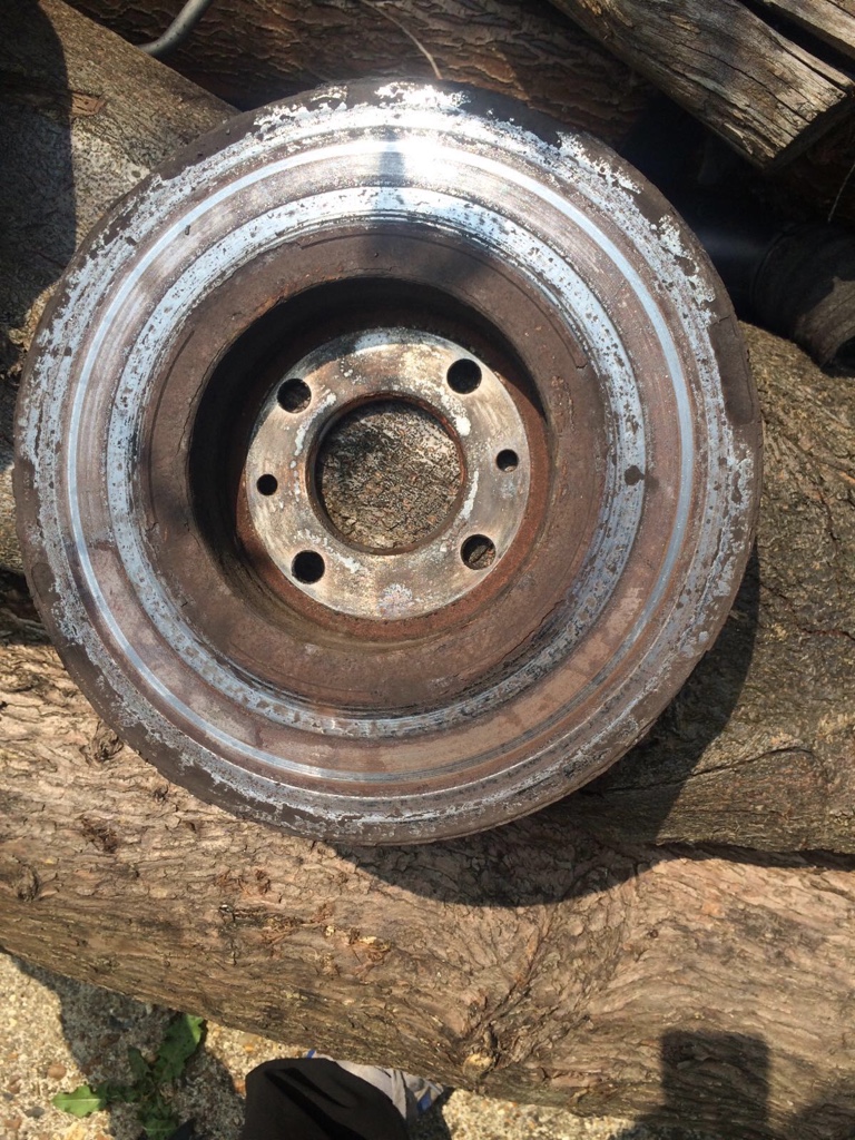

The car was sold with a problem with the front end shaking from about 50/60mph under load. So I dropped the car straight off at Magic Mikes for him to have a little look over, change a few fluids etc then I'll get Brands booked for next month.

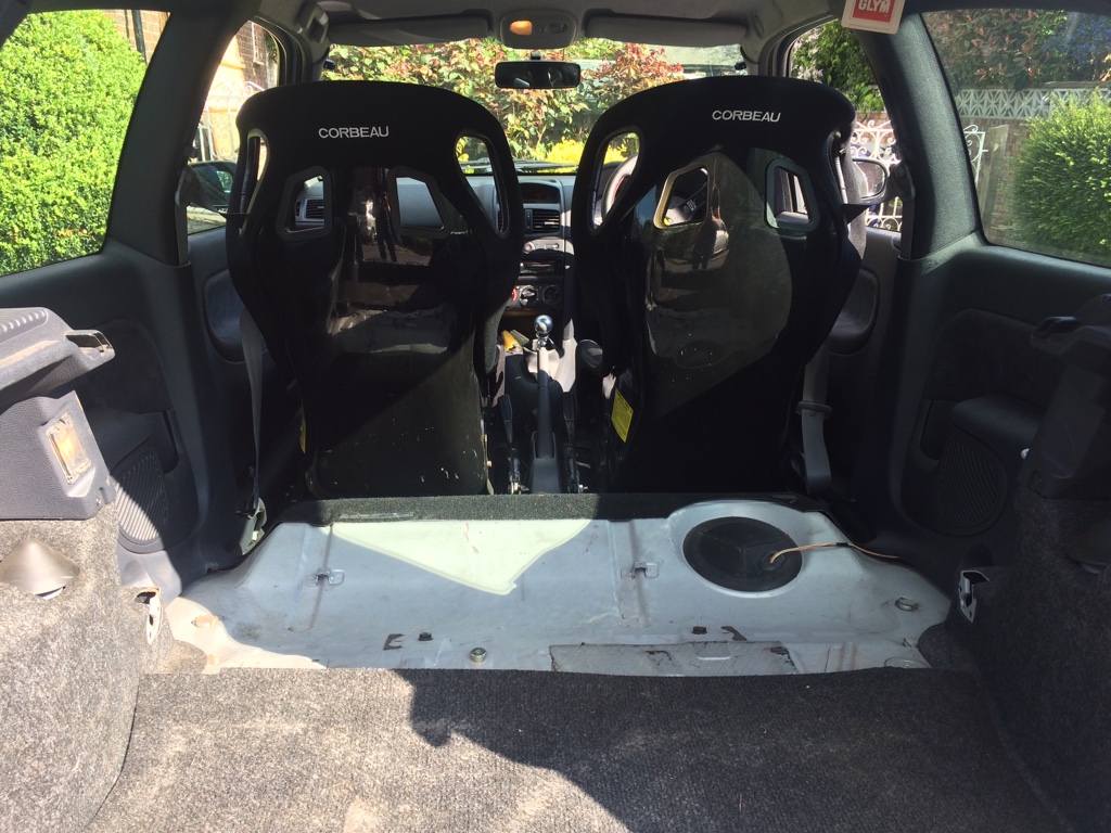

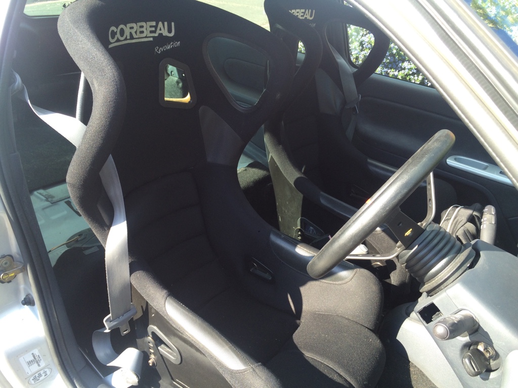

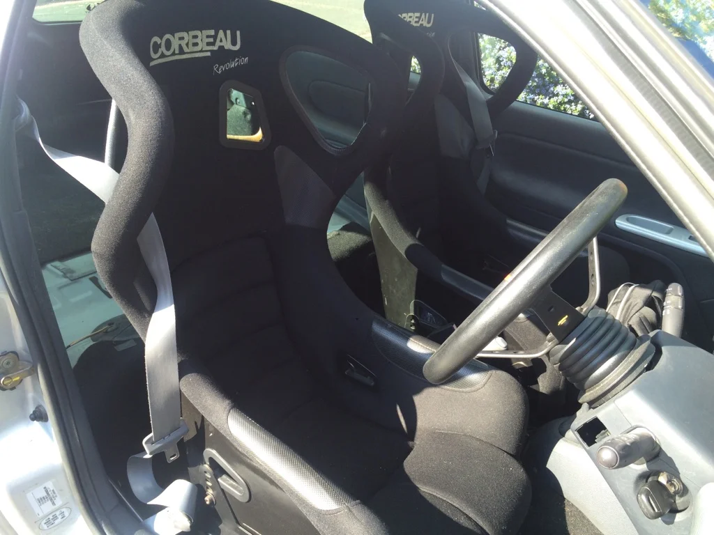

- Corbeau Revolution wrap around bucket seats
- OMP Corsica wheel

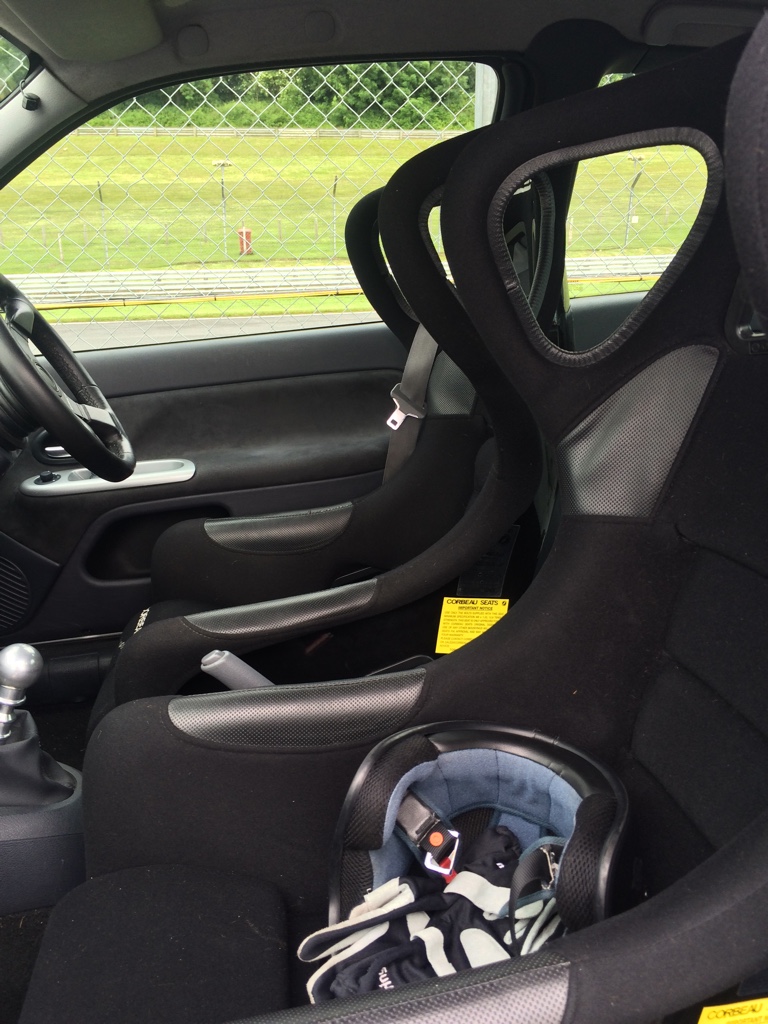

If anyone sees me at Brands or anywhere and fancies a laugh, come over and watch me try to get in or out of the car. It's near impossible with the seats bolted to the floor and dished wheel! Plus the fact I'm as flexible as a corpse with rigor mortis, makes for an entertaining spectacle.
Oh and if anyone could recommend me a good helmet for track days! Not sure what's best, closed/open faced?

Was the vibration a collapsed tripod on the driveshaft?
  330i. E30 Touring.
What an absolute steal you got there! I'll be at brands somepoint over the summer so will let you know when I'll be there.
I'm not sure whether it was the old discs or the driveshaft tbh, but one of the two sorted it.
Both shafts that came off it looked absolutely fine to me, but swapping those and the discs fixed it! :)

Discs were definitely a bit past it!

Did about 60 or so laps of Brands split over 4 sessions, 3 cars managed to crash or break down (3 BMWs iirc!) but luckily I wasn't one of them! Also had the 1 session of tuition which made a massive difference to my driving style and lines. For the £25 it cost me I can't think of any mod which would be as effective! Going to get tuition every time I go for the time being, the car is definitely more capable than myself.
