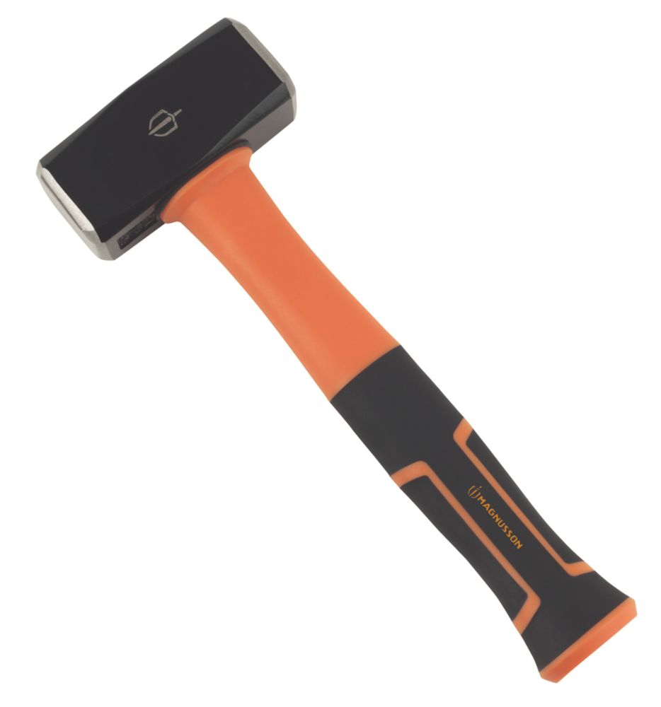

One of these is good if you're not going to reuse it.

I have literally beat the s**t out of it with that exact hammer, the 4 kilo one all afternoon worried in case I've broke other stuff now. Do you think the shock being off will affect it?

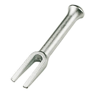

Will try a fork then, if that doesn't work will just use a grinder and cut the f****r up

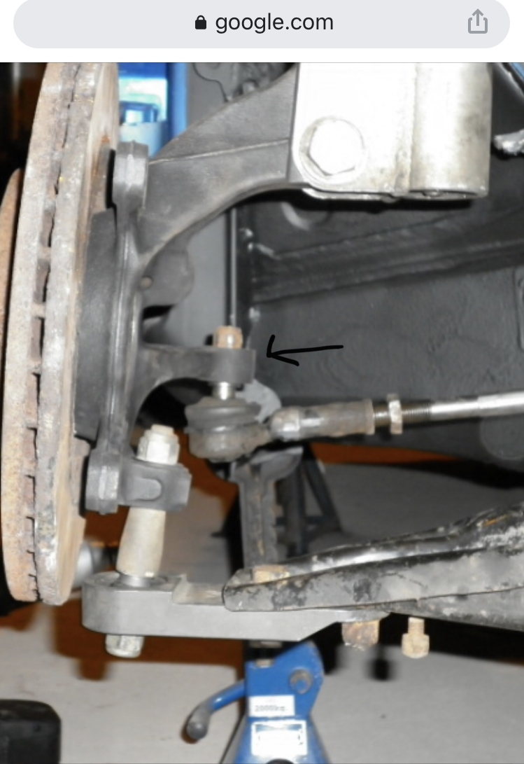

And as @dann2707 said, you need to be mostly hitting the hub from the side on to free it. Not the actual thread itself. But even hours of that didn't work for me, hence the splitter method. Robbed this photo from Google

I have spent hours before hitting the bolt, genuinely on the brink of tears wondering why the hell it wasn't coming off until realising you need to hit where @James172C has pointed to.
If you can put some downwards tension on it with a pry bar and hit it there I will happily bet you £5 that it comes off with the first or second hit.

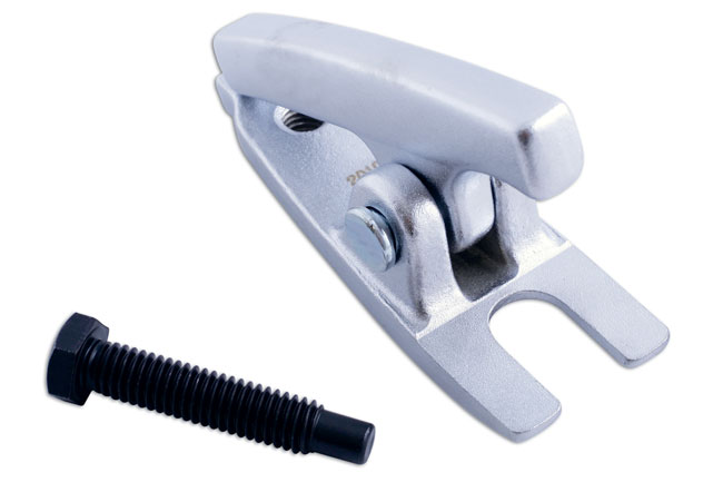

  T.Turbo
