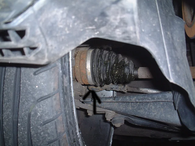

is that the track rod end marked in the pic?
if so how the f**k do you remove the nut off the top???

you gotta wizzit off with an air gun you can get the drive shaft off without getting the rod off just undo the 2 16mm bolts that hold the ball joint to the wishbone
