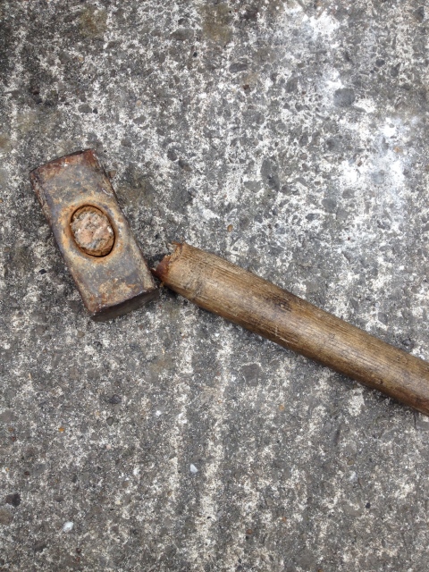

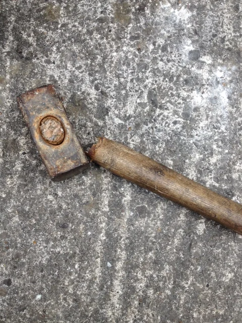

Just wind the nut onto the end a bit grab some wood and a hammer, hold the wood against the nut and bash the crap out of it till it jolts loose then remove nut and pop the rod out. Never fails, been doing it that way for last 10 years.
cheers i'll give this a try but first i might need a new lump hammer :o
MicKPM i don't trust myself with a grinder not to take the inner tie rod out as well.
Lol yeah I think you might bud. Also since you don't need to reuse the track rod, if you want you can bypass the wood and nut and bash the track rod directly with the hammer as it won't matter if you knacker the threads. When reusing always use nut and wood.
Lol, the hammer failed through rot I would imagine mate, was just saying if you are still struggling after all this time, replace both.
oh yeah the hammer was old so yeah i'd say rot was the case, i've not had chance yet to get some heat on it probably wont be able to until next week now
