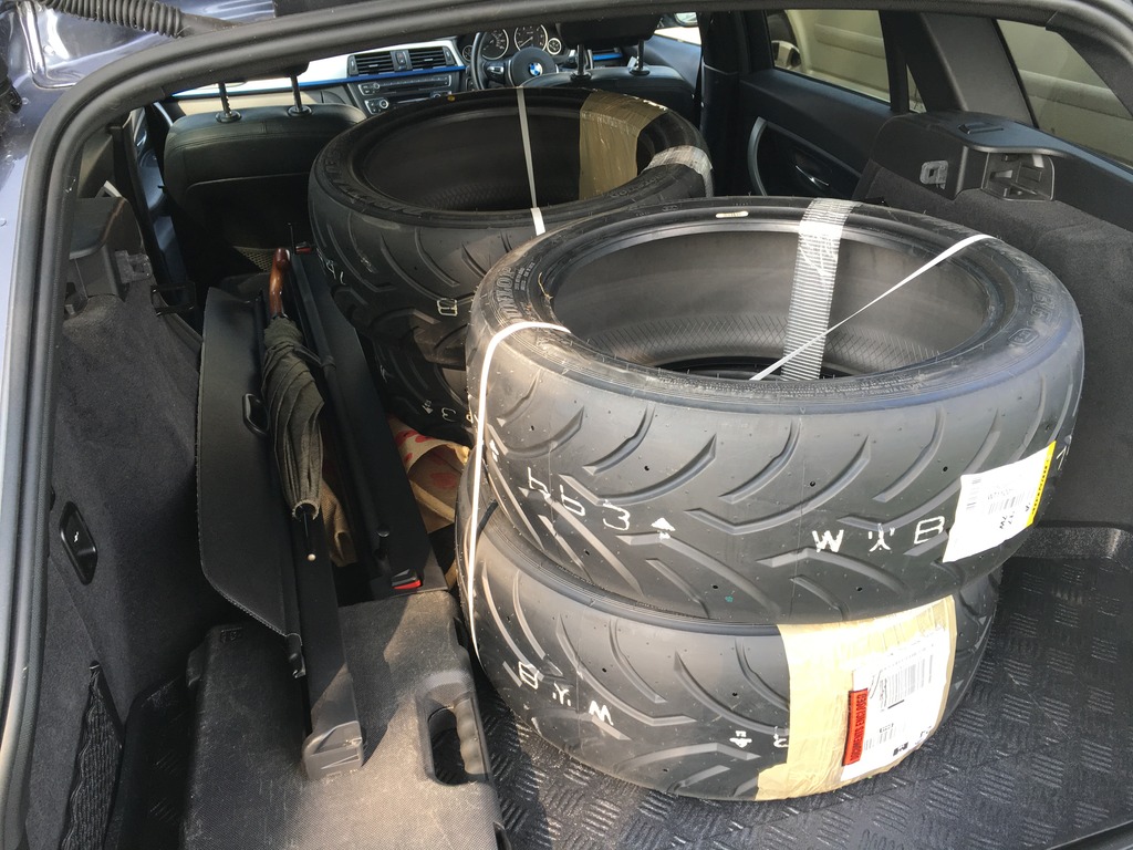

It already has KW Clubsports fitted with adjustable top mounts so not planning on doing too much there. I've ordered Dunlop DZ03G tyres too which are supposed to be good. I had planned on fitting a LSD diff to it but it was going to cause a big delay on getting it so instead I'm planning on fitting one over xmas.

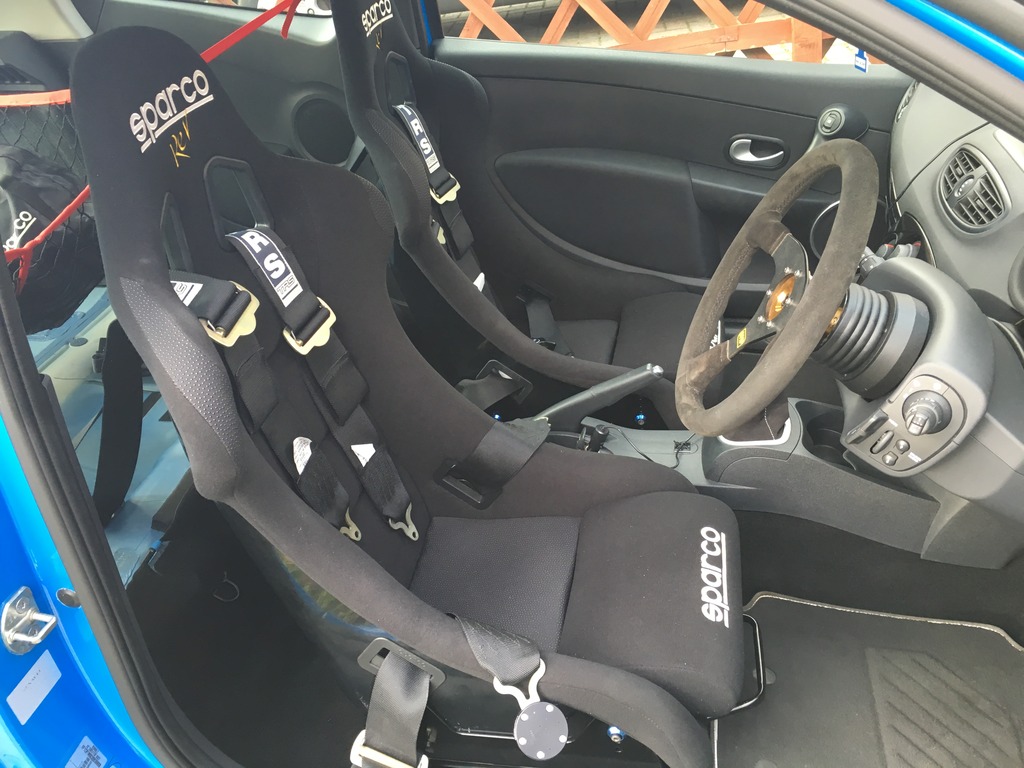

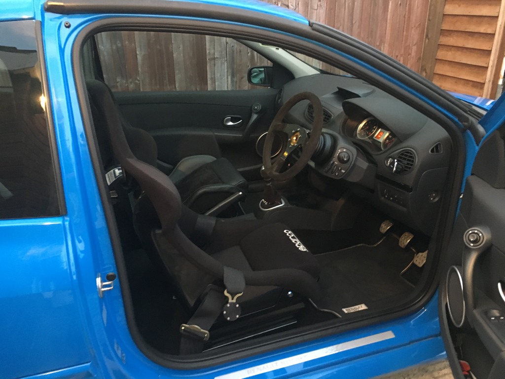

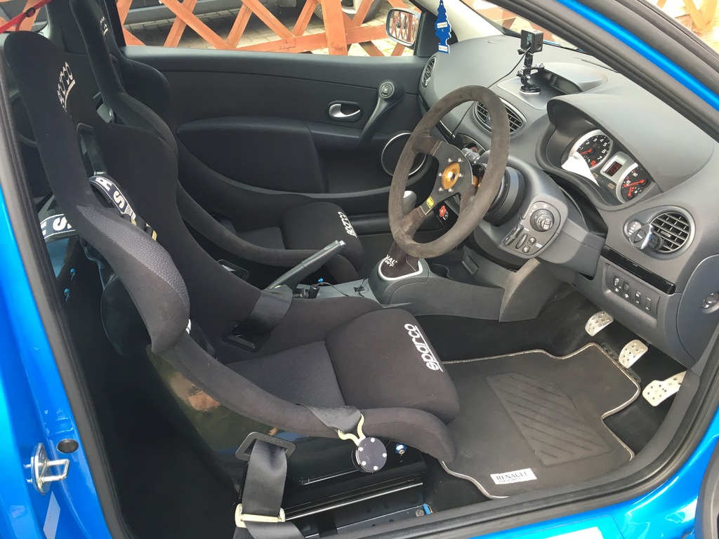

Removed the Recaros last night and almost gave myself a hernia in the process! Lol. Damn those things are heavy.
I have a fitted an adjuster to the drivers seat but have fixed the passenger seat. In all honesty it feels so much better already and has a much lower seating position compared to the Recaros which feel very high in the car. This will probably help with improving the handling too.
That's about it in terms of weight reduction for now as I don't want to wreck the looks of the car and make it look too stripped. It has much more of a R26R feel to it inside now.
We found when dropping the drivers seat that the steering wheel was too high and there was insufficient adjustment, therefore we lowered the column using washers on the mounting bolts to get it to a more reasonable position.

Yeah I know what you mean. It's positioned just right now. The passenger seat is slightly lower since it doesn't have the sliding adjustment.

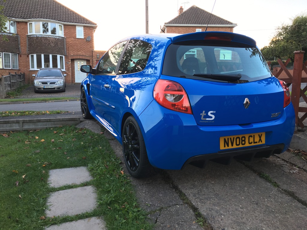

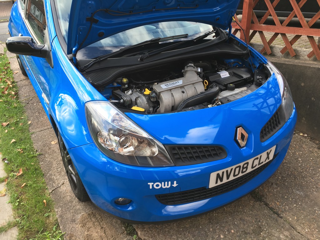

A couple of photos from the weekend
Just ordered a 4-1 stainless manifold and sports cat. Then it's off for mapping. I have a track day booked in Abingdon on the 14th of October. Looking forward to driving it properly.

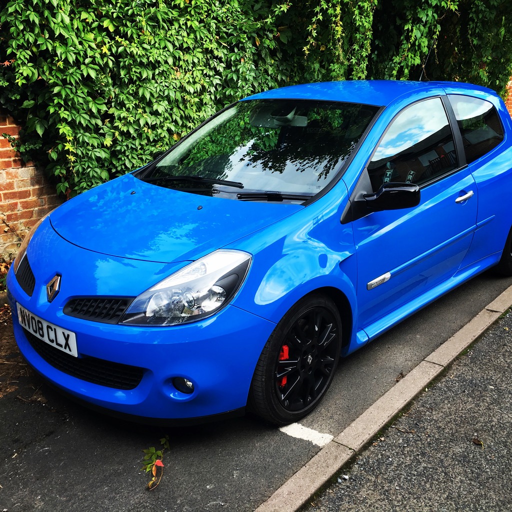

Few pics from today.
God I love this colour!

New seats in and all the stripping of the inside done.
Camera mounted ready!

Fitted a stud and nut conversion this evening. I'd like to find a set of spare wheels but not sure what to go for. Ideally second hand as I'm going to use them for track use only, any recommendations?

What subframes did you use with the buckets? I'd like to fit some to mine so any help is greatly appreciated!
  Clio 197 BMW Msport
The subframes are Sparco ones with Sparco side mounts and an OMP seat adjuster on the drivers side. The seats are so much lower than standard items. I couldn't be happier with new position.

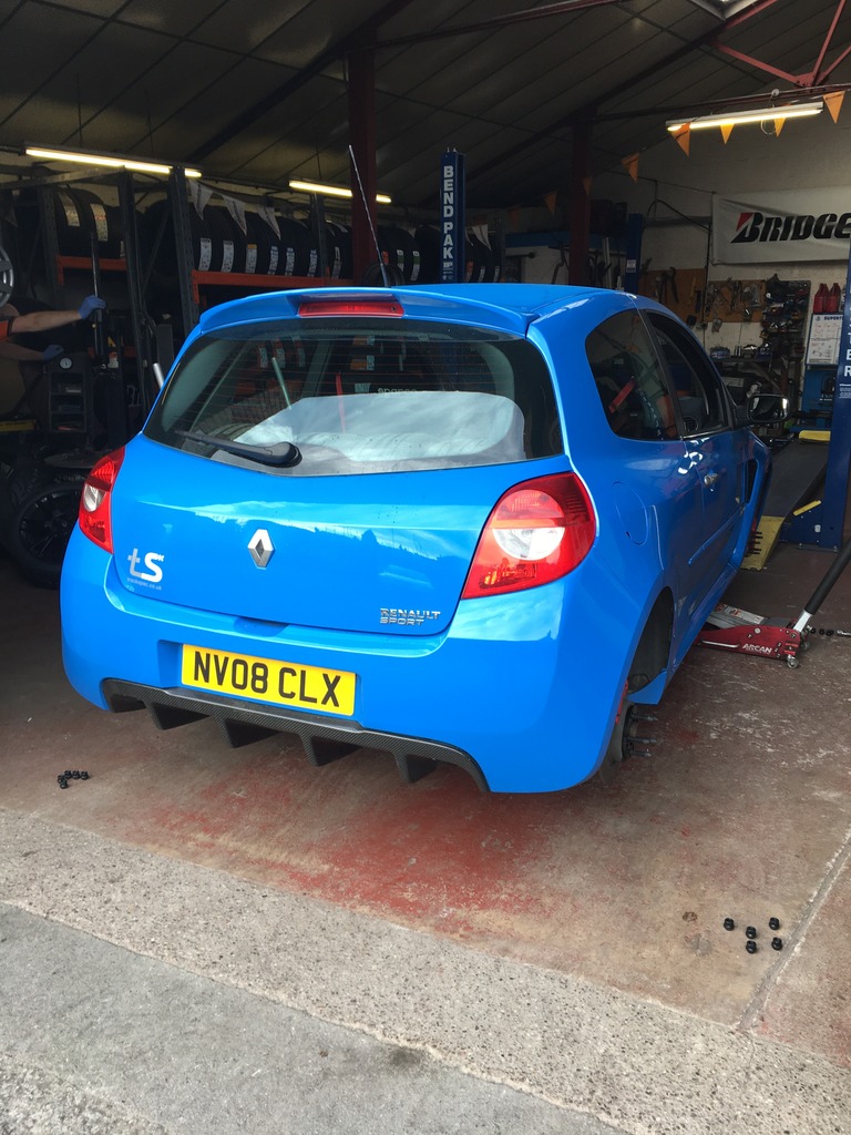

Some photos from the weekend. Tyre fitting.

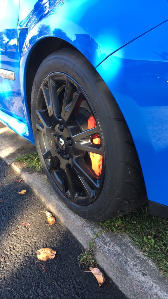

New tyres fitted and new wheel stud conversion. I also pressure washed under all arches as it was pretty dirty underneath.
Nice and clean! I ended up removing the rear carbon diffuser to see if I could fit the tow strap some how and in the process broke one of the mounting studs. So removed the two heavy mounting brackets and re welded a new stud then took the hole saw to the brackets to lighten them.
Also gave the front pads a quick check over to find that it has Ferodo DS3000 pads fitted which have had a fair bit of use by the looks so will look to change them for CL RC6 pads after Abingdon. In the process of removing the pads one of the R clips on the brembo pins broke. Does anyone know if you can buy those separate?

You must have the special brembo pins. Think the guy who does them is on 197.net might be Mr pink? I'm not sure don't quote me haha. I'm sure he'll sort you out. The brembos normally have pins that need thumping out and are a right pain haha.
  Clio 197 BMW Msport
Oh right, I hadn't realised there were different types. It's no wonder I couldn't find any. These need a good thump to get them in but had the addition of r-clips too. Thanks for the info!
Knuckles
ClioSport Admin
Yeah, the ones with the r clips were designed and made by a 197.net member as the OEM ones are notorious for seizing in.
Any similar r Clip will do, go to b&q or similar and pick one up
