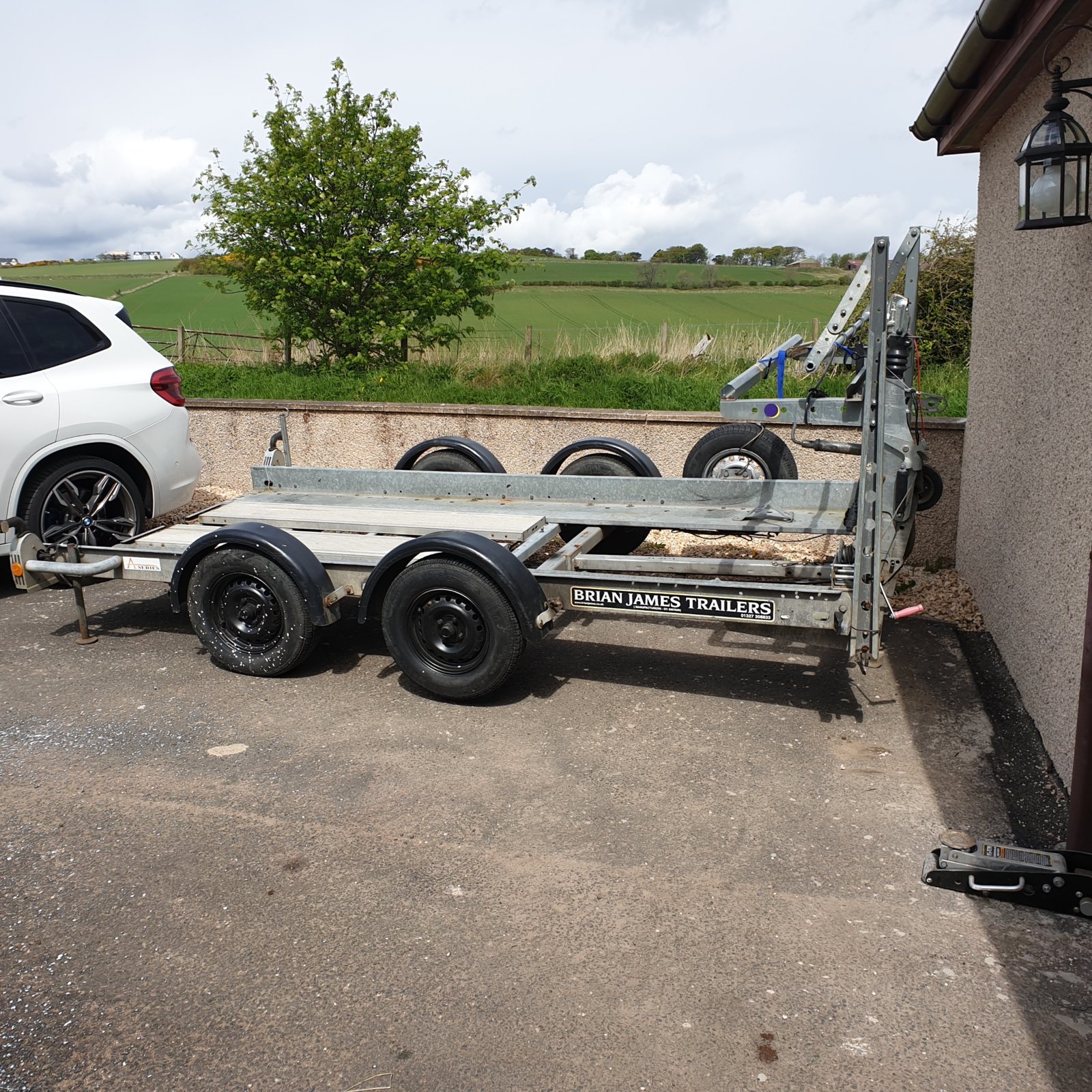

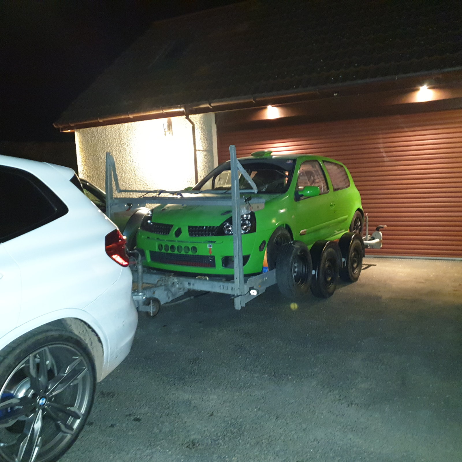

neil a
It will fit but very tight width wise at the front depending on wheel offset , my tyres basically touch at both sides. If your lucky you can also get them with a folding hitch which saves more space when its in storage.
It tows behind my X3 brilliantly even with spare wheels in the rack.

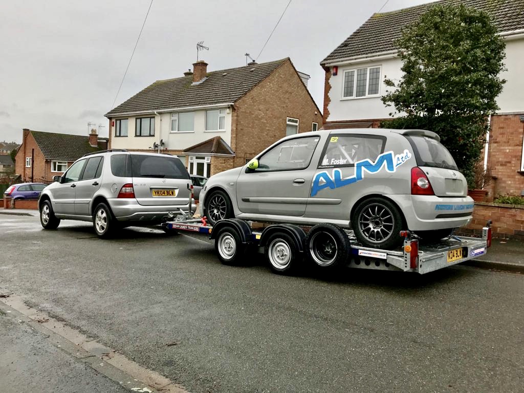

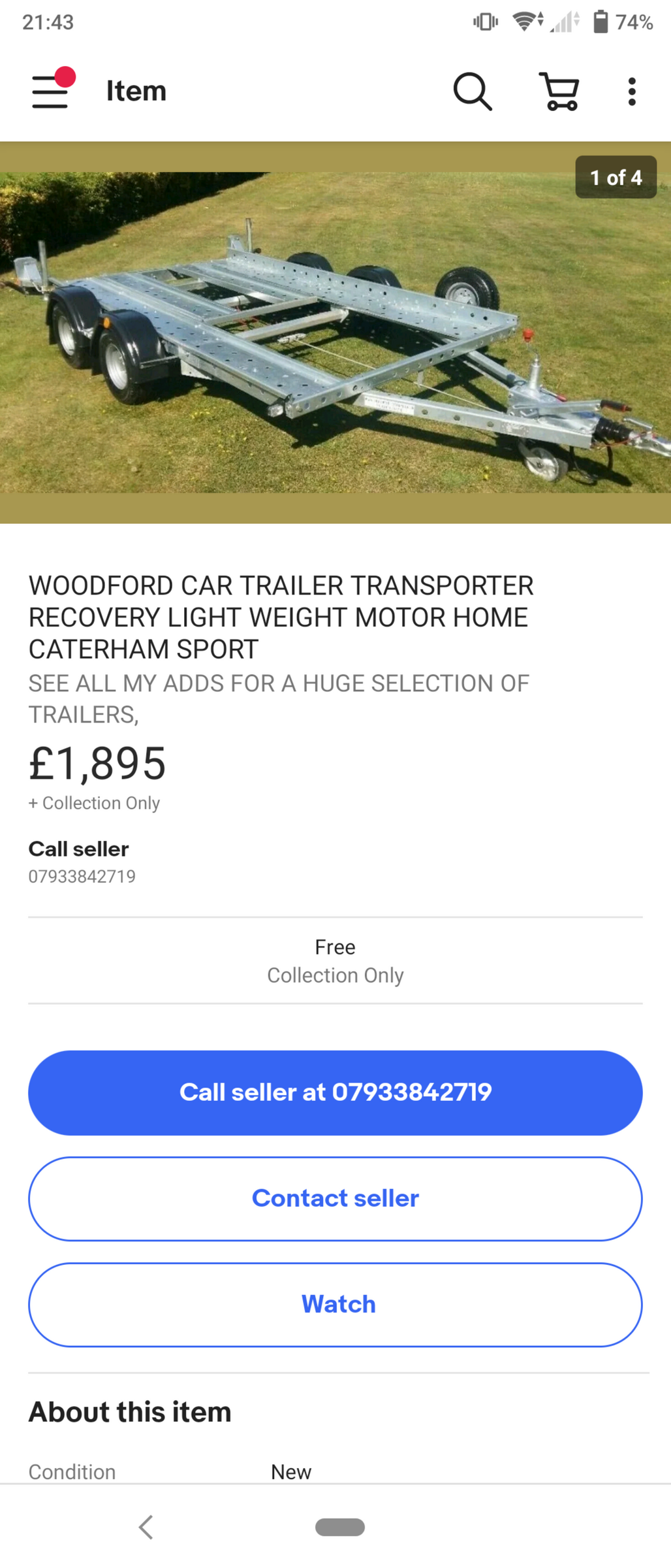

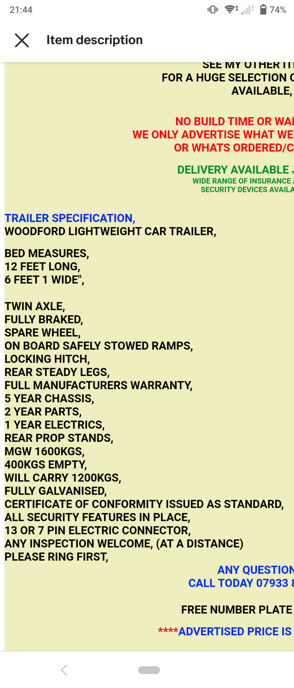

Of you can find one a twin wheel trailer will tow better. Woodford make a twin axle small trailer . Something like this

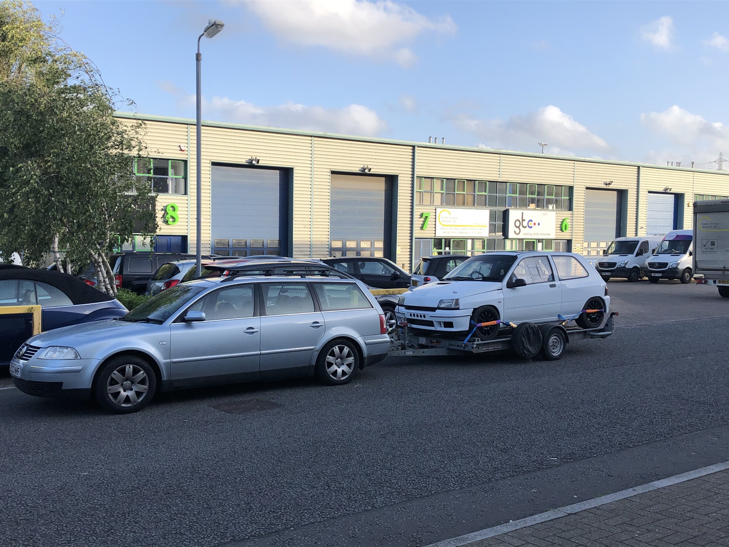

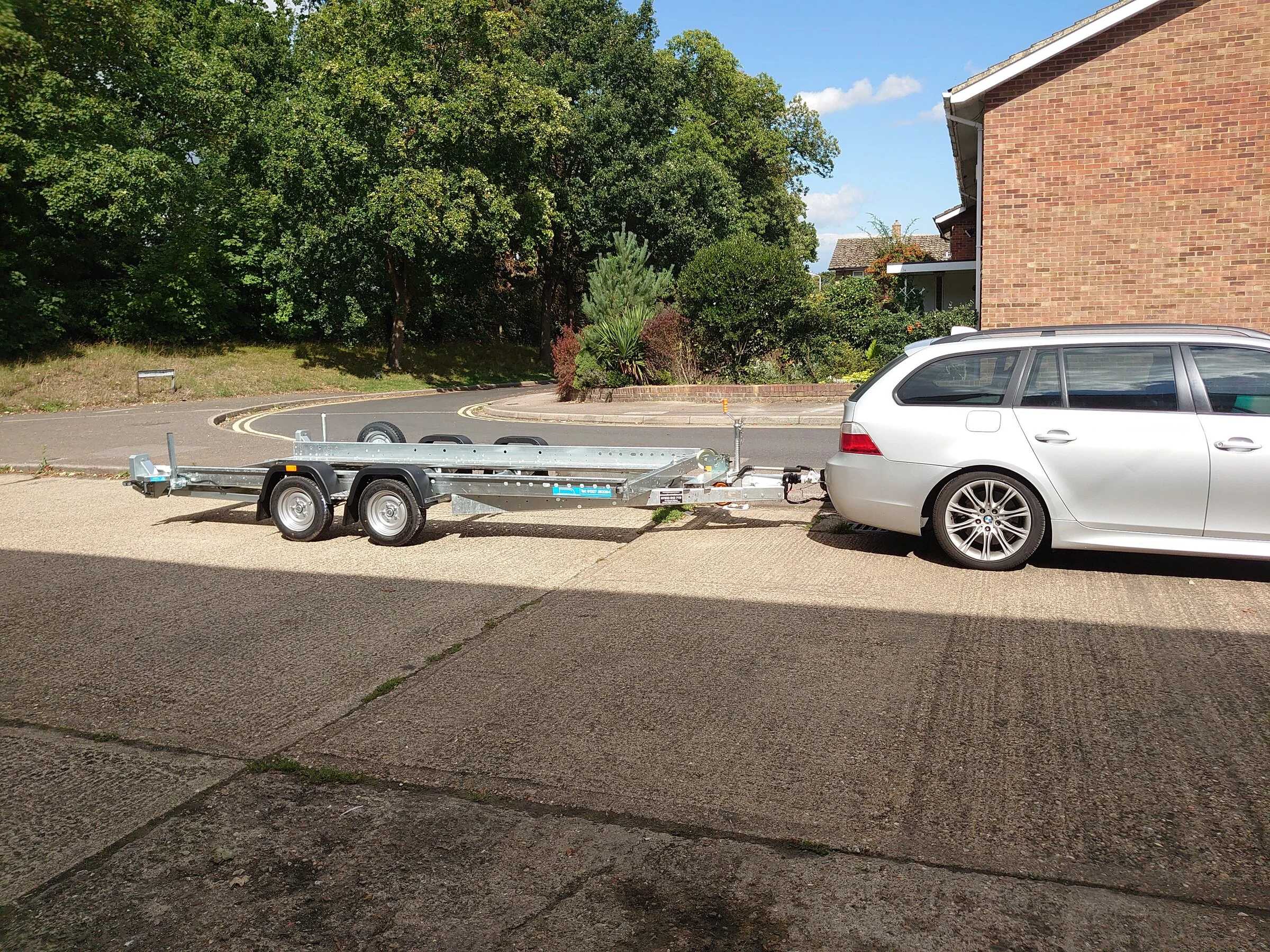

I’m on this BJT
My Clio weighs 850kg but that’s fully stripped fibreglass Bonnet, doors, boot and spoiler with plastic windows etc
Think you’d be looking more 900-1000kg for a regular track car type stripping

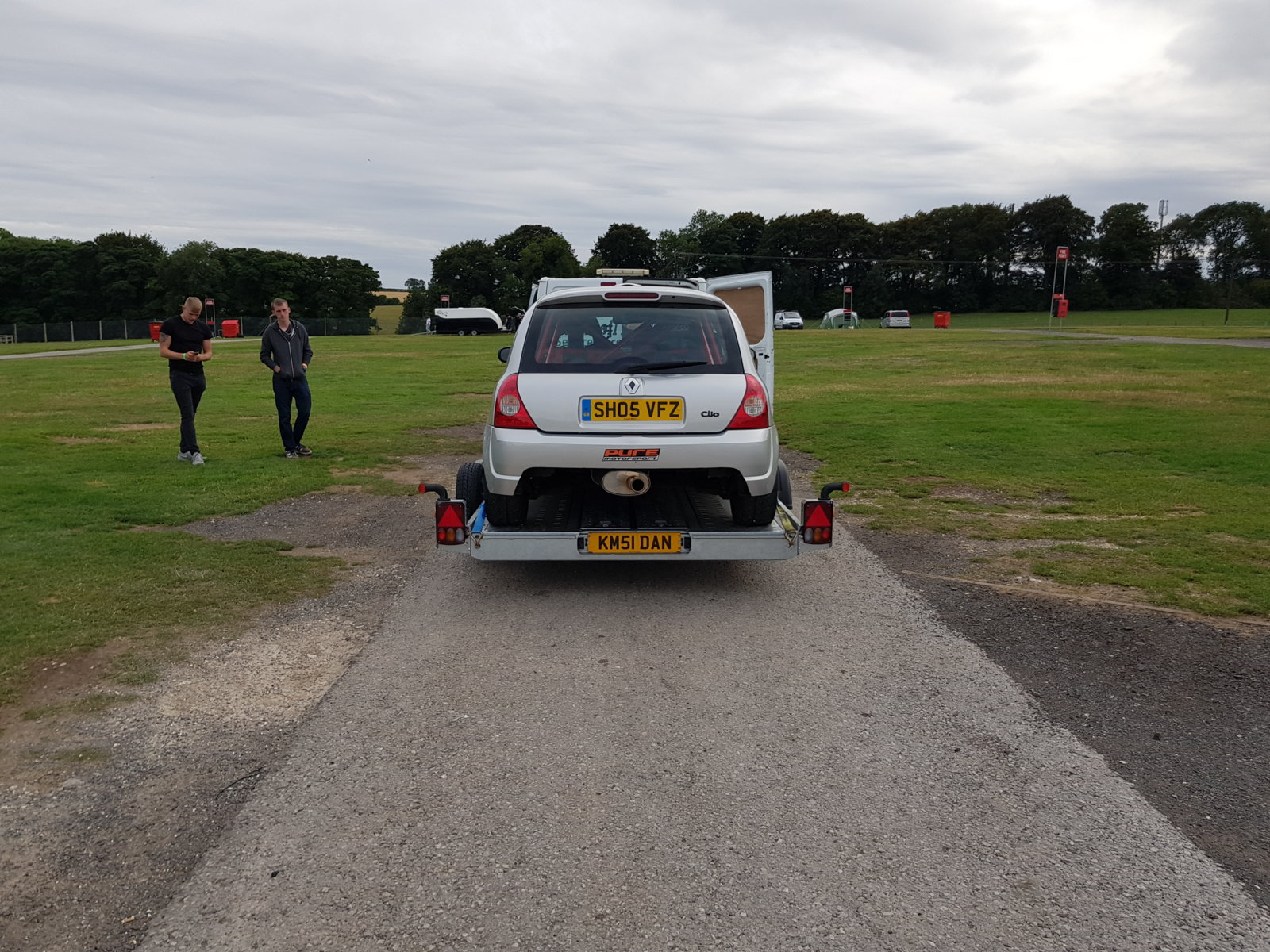

@neil a what wheel offset are you running in this photo. I’ve just gotten myself a BJT Minno and tried getting the car on and it seems very tight or too wide and this is before I put 3mm spacers on each side for running Brembos.
I tried driving it up but think I’m better off winching it up due to the tightness. It does seem tight on entry as if there is a taper but seems wider further up the trailer, perhaps I can tickle the sides at the entry Point of the trailer?

Same as mine, et35 and roll centre kit fitted. I think I just need to go back and give it a little tickle at entry as it looks pinched and just winch it onto the trailer and let the car find its way on. Once over the threshold it should be fine as that's the only part that looks tight.

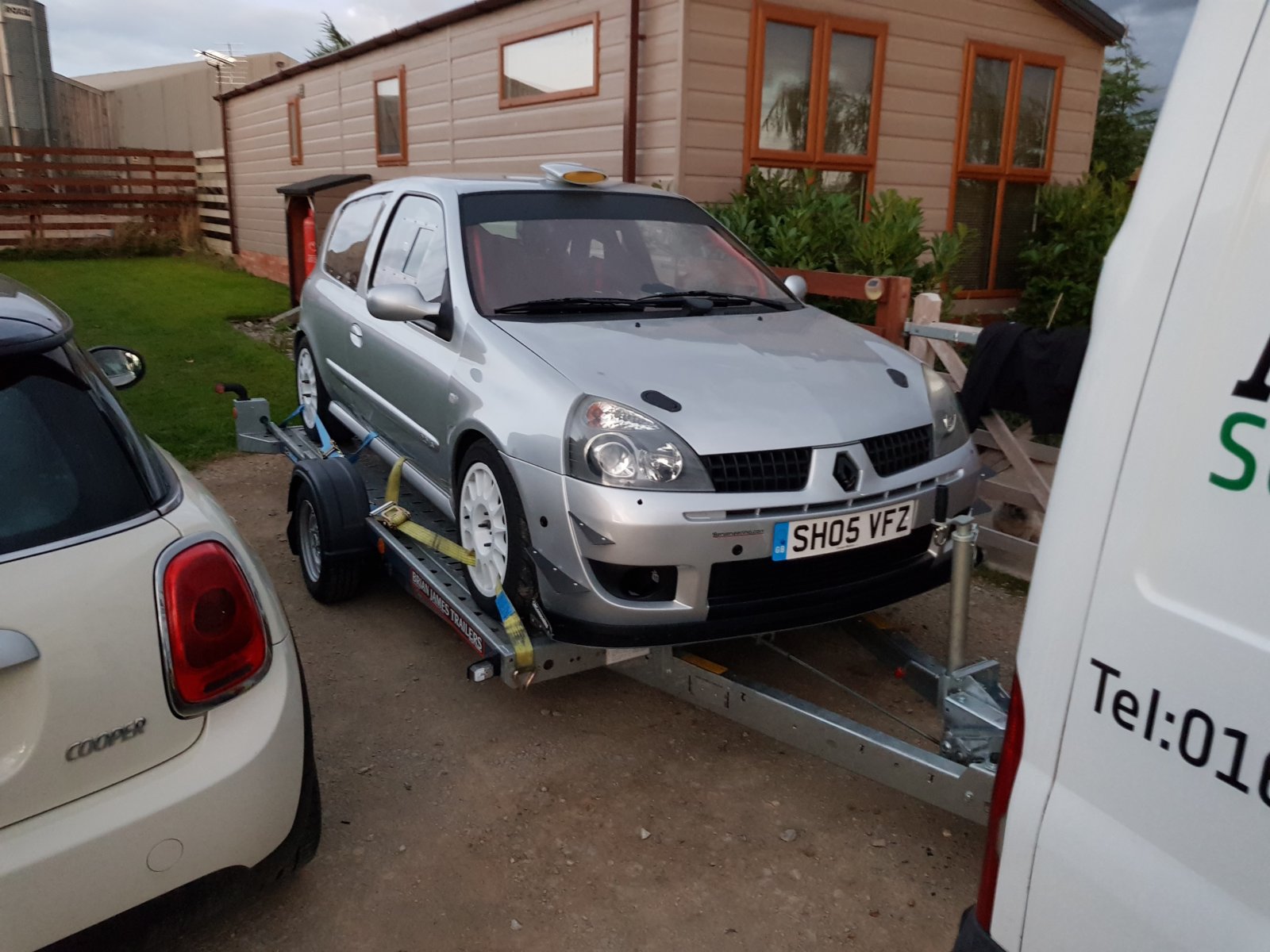

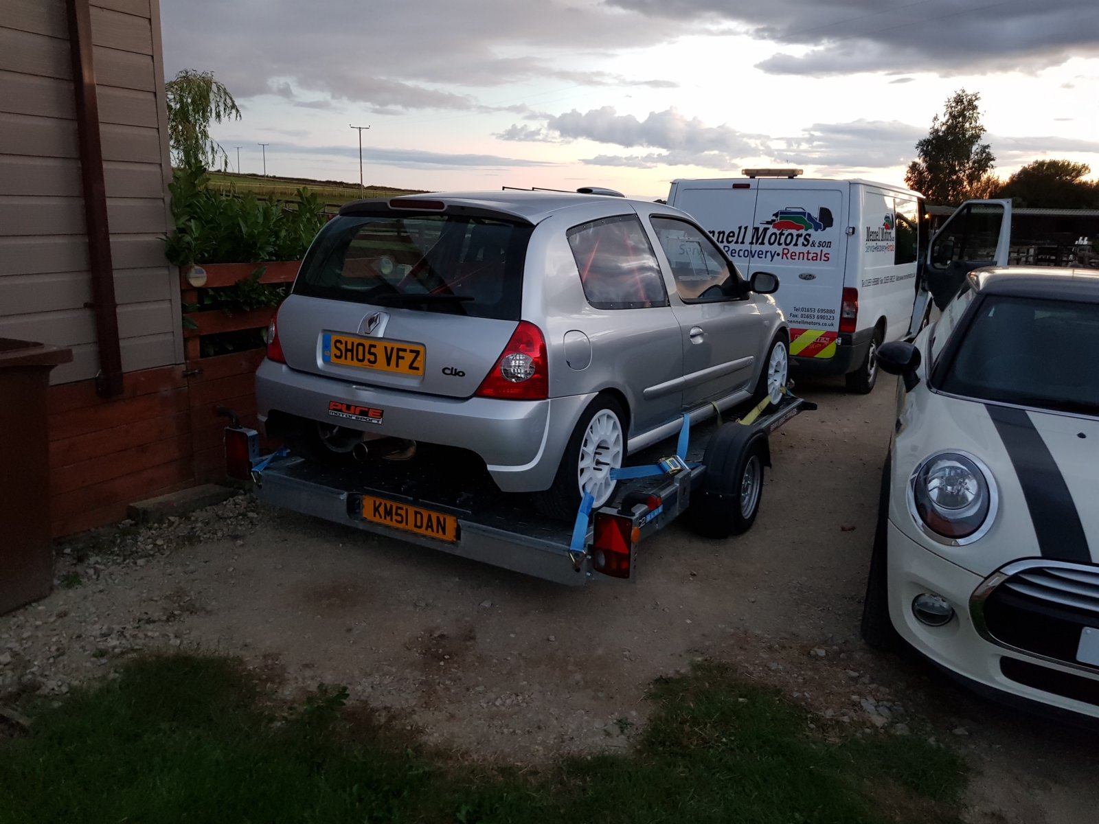

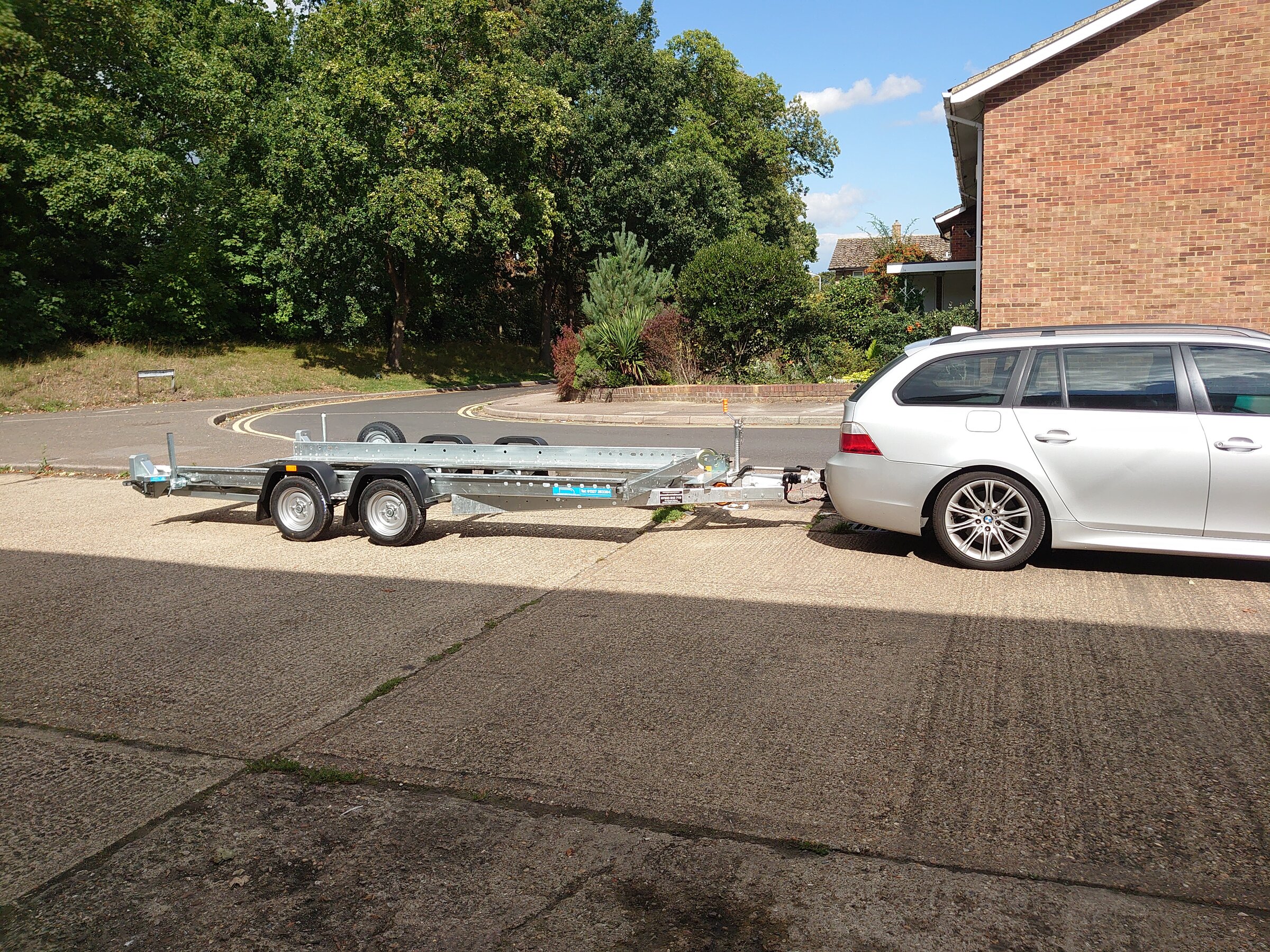

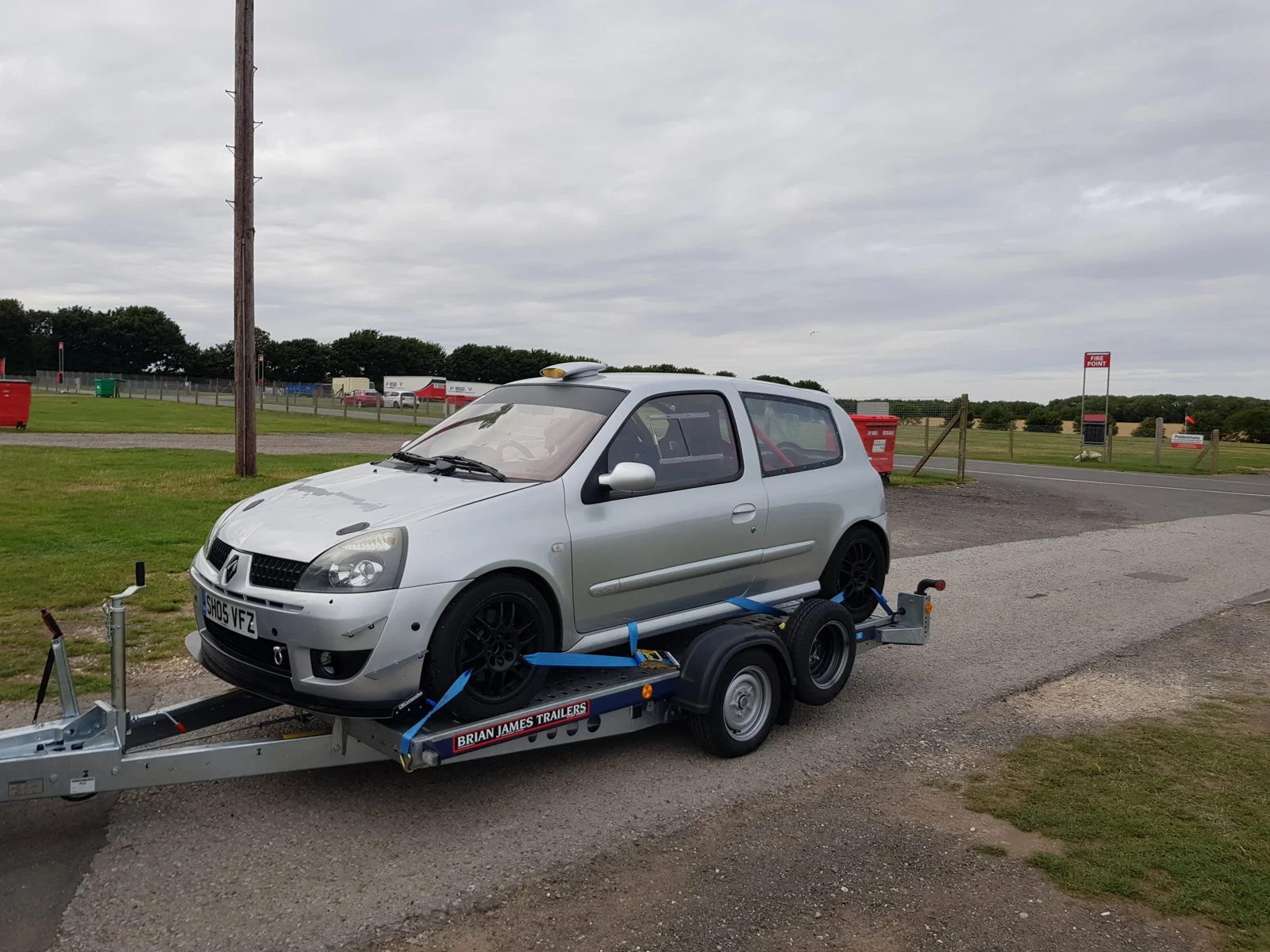

Haven't loaded my Clio on yet but should be loads of room on mine.

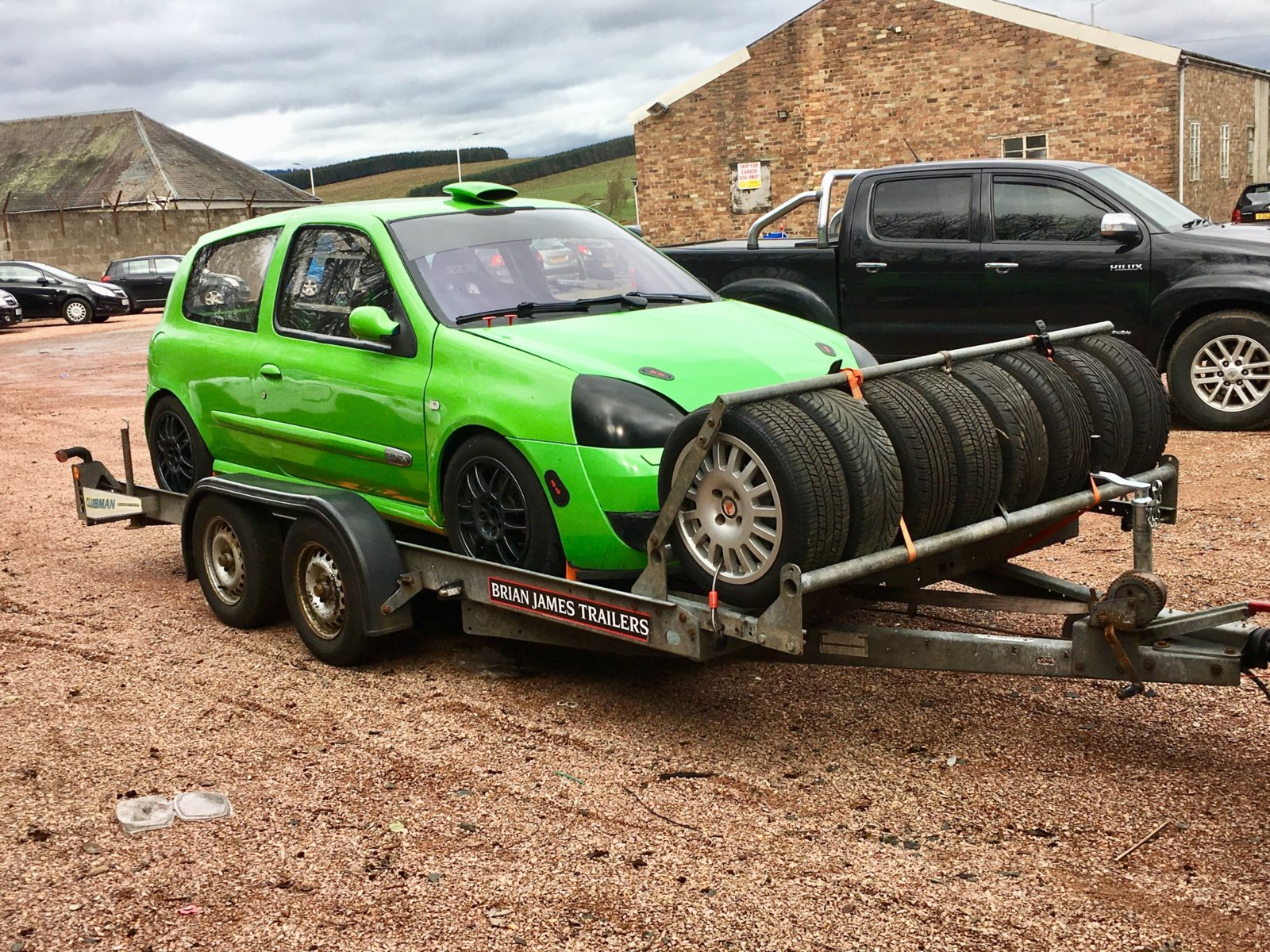

I made the mistake of buying a BJT Minno trailer based on Clio stats i googled only to find my car was just a little too wide. Fortunately I sold it at a small profit and then bought another BJT that it would fit on. So my advice would be the measure your own car very carefully before diving in.
BTW there are a few different types/sizes of Minno (Minno Max) trailer out there as BJT have made them for many years.
Another one with a Minno Max trailer and a 182 weighing about 960kg
I've had no problems driving the car on, you have to splay the ramps out a bit, but on the trailer there are couple of inches clearance each side which should be all you need.
Winching it on is fairly easy too. (I have standard 16" wheels.)
Very happy with the trailer, but lucky my tow vehicle is a transit custom so tows easily and plenty of room for spare wheels etc in the van.
