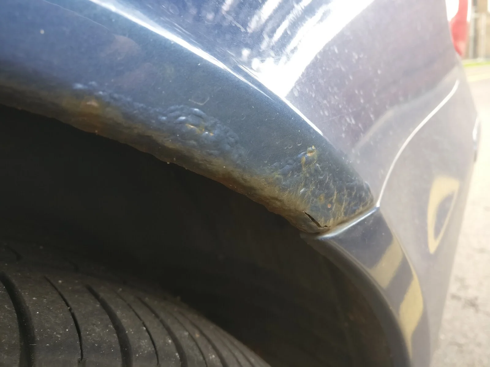

Hello guys,
So I am wondering if you can help me with this.. My Mercedes SL has the well known rear arch rust issues and it needs work. The photo below shows the damage. From an inspection, that bubbling is mainly just the paint and surface rust, not deep rust. I can pull at the lip and the structure doesn't come away (yet!!).
Anyway the inside is the main affected area and I am wondering about how to go about treating it.. my options seem to be:
a) "Convert it" with chemicals.
b) "Remove" it with chemicals.
What would you guys recommend? I would need a gel as opposed to liquid.. Once the inner bits are treated I would seal the area up and seal the entire lip so no more sludge can settle.
Does anybody have a playbook/guide for this kind of job?
* For the outside and accessible areas, I will just use a Dremel with flapwheel / wire brush / whatever is needed.. and level off with filler, before priming and attempting to colour match etc.. If the painting goes all tits up I can outsource it lol.
Thanks a lot!

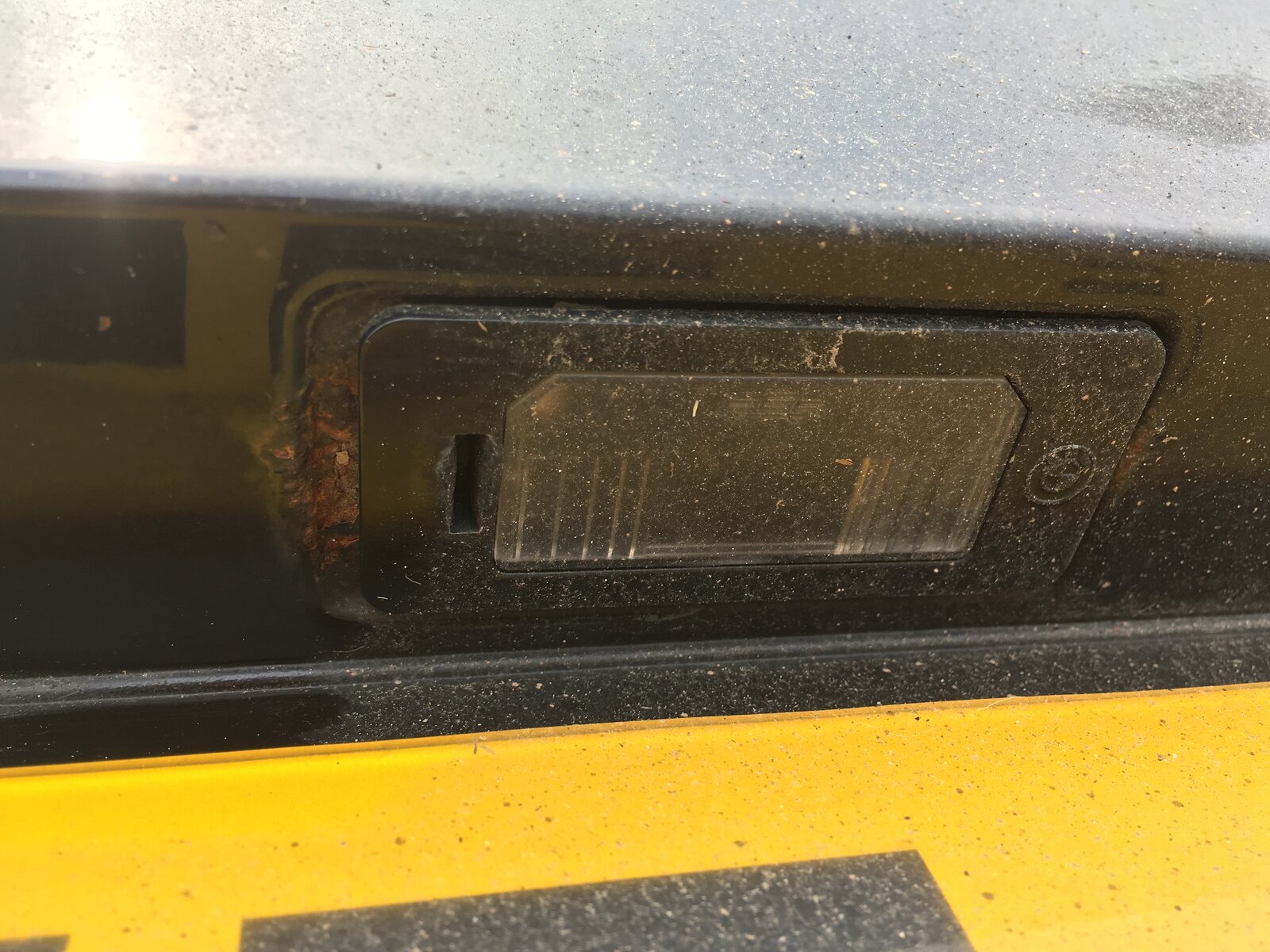

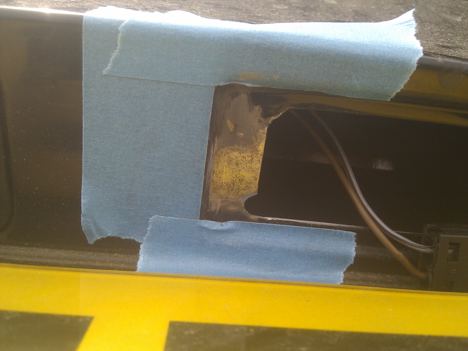

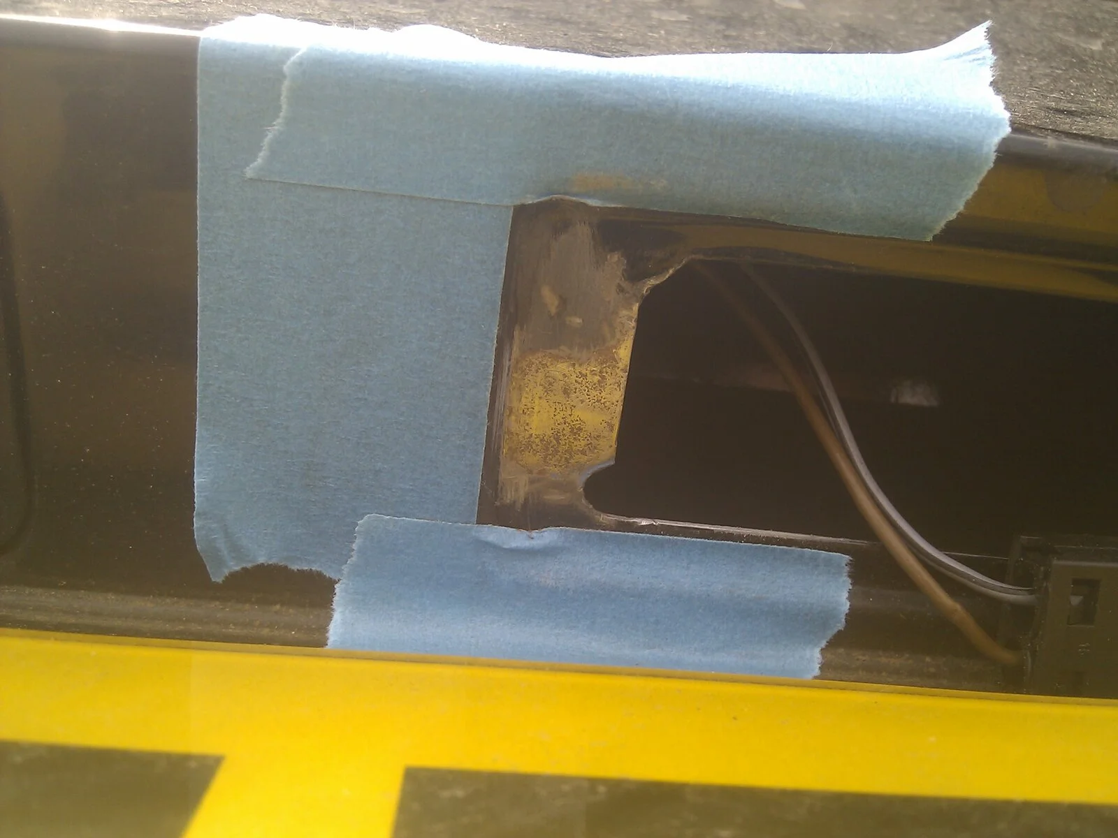

I would advise buffing off all the rust thoroughly and then using the gel to give yourself the best chance of longevity. It's good stuff but it has limits.
I've touched up small areas (see attached picture) before, getting the worst of the rust off thinking that'll do and then relying on the gel to remove the last of it but it didn't last long. That was using the electrox primer too.
Would also be as well going with a Bilt Hamber wax rather than cheap waxoyl. I reckon if a good bodyshop were to thoroughly prep something like that correctly then use the Bilt Hamber products you've described it might have a fighting chance of lasting a decent while.
I say this as someone who's had 3 different bodyshops remove rust on different cars by just buffing it away, came back every time before too long.

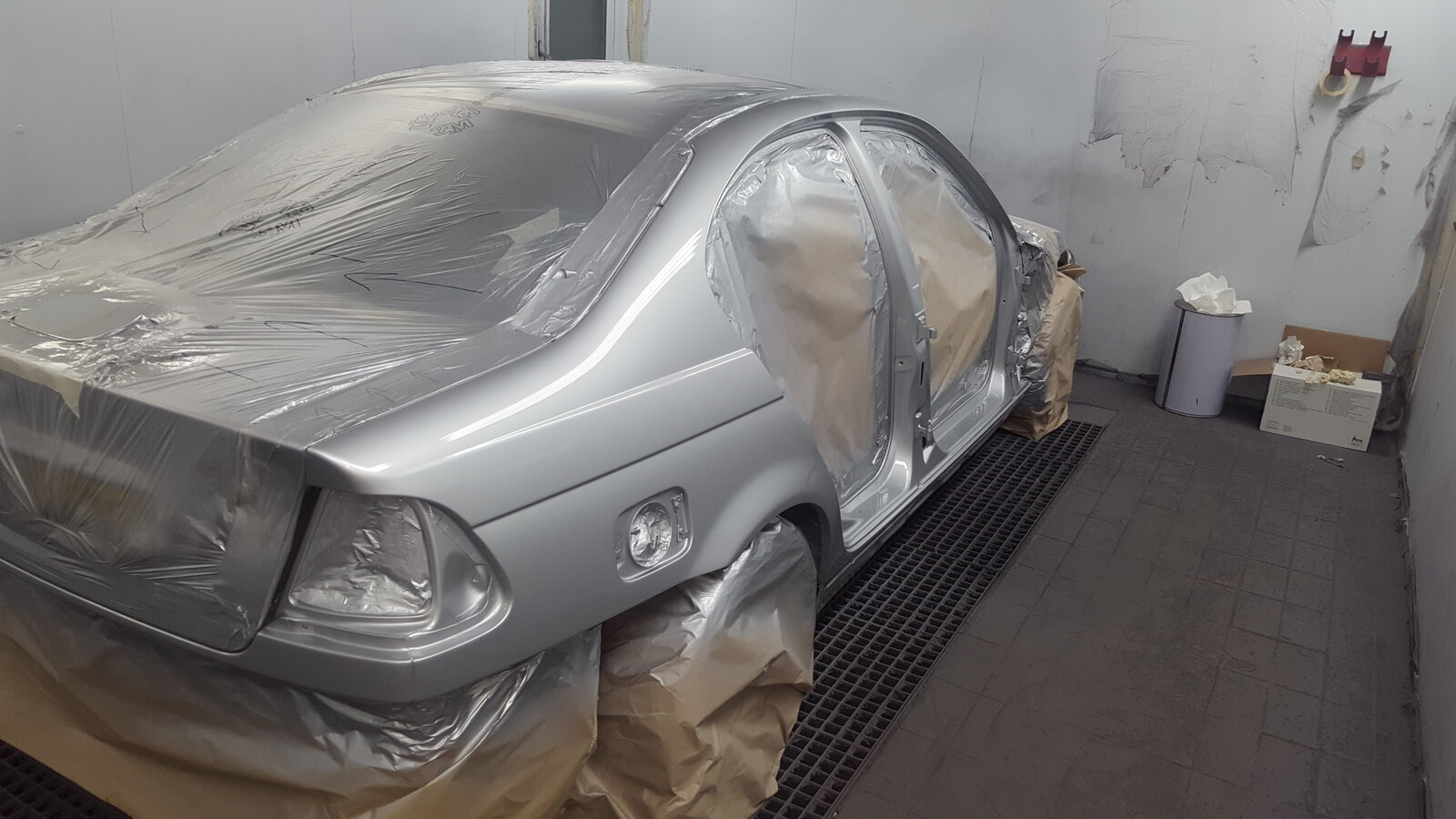

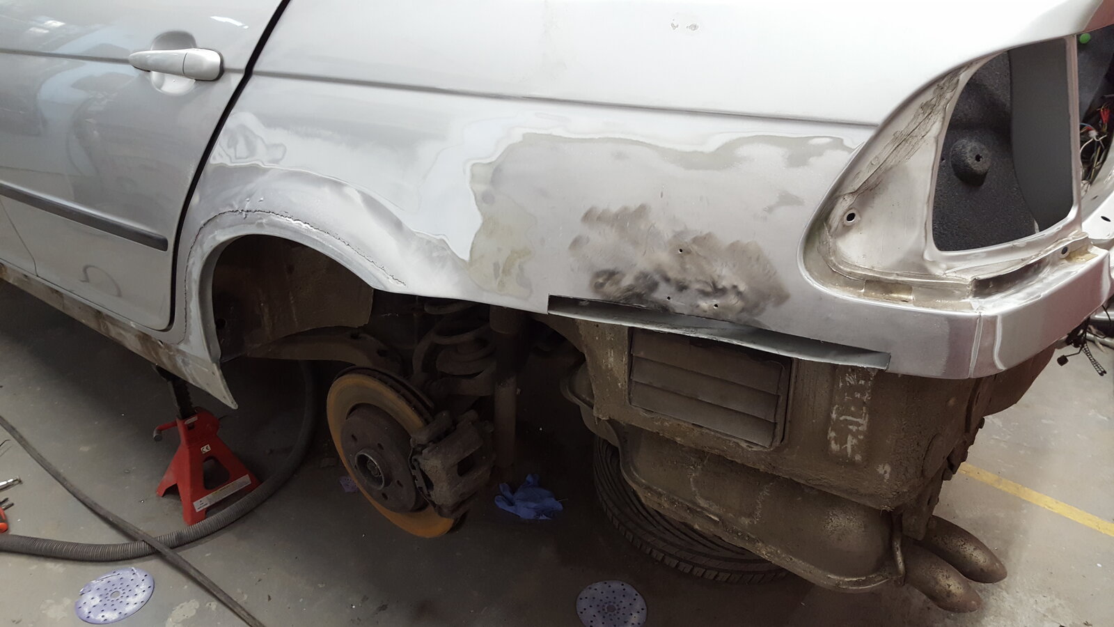

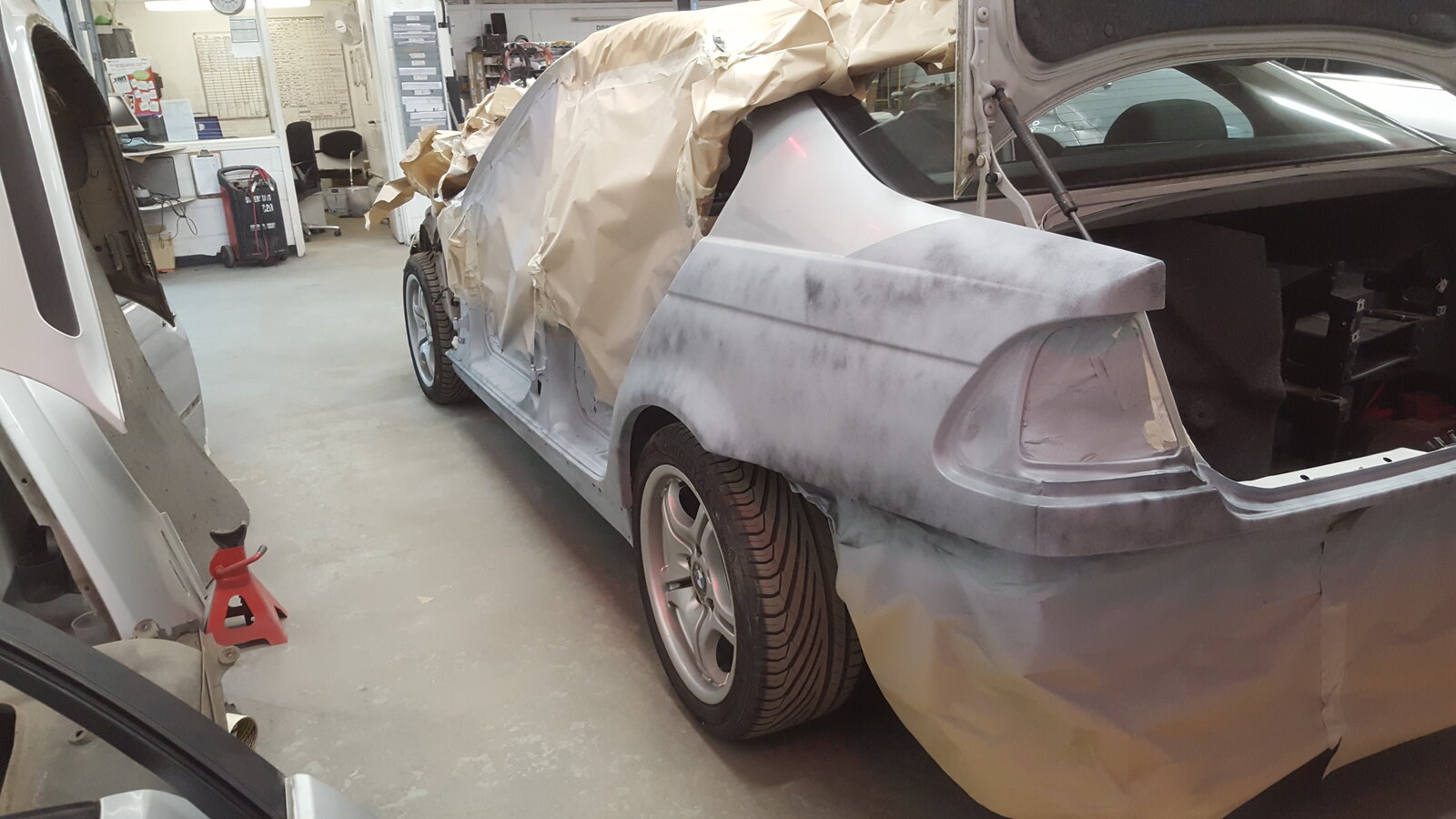

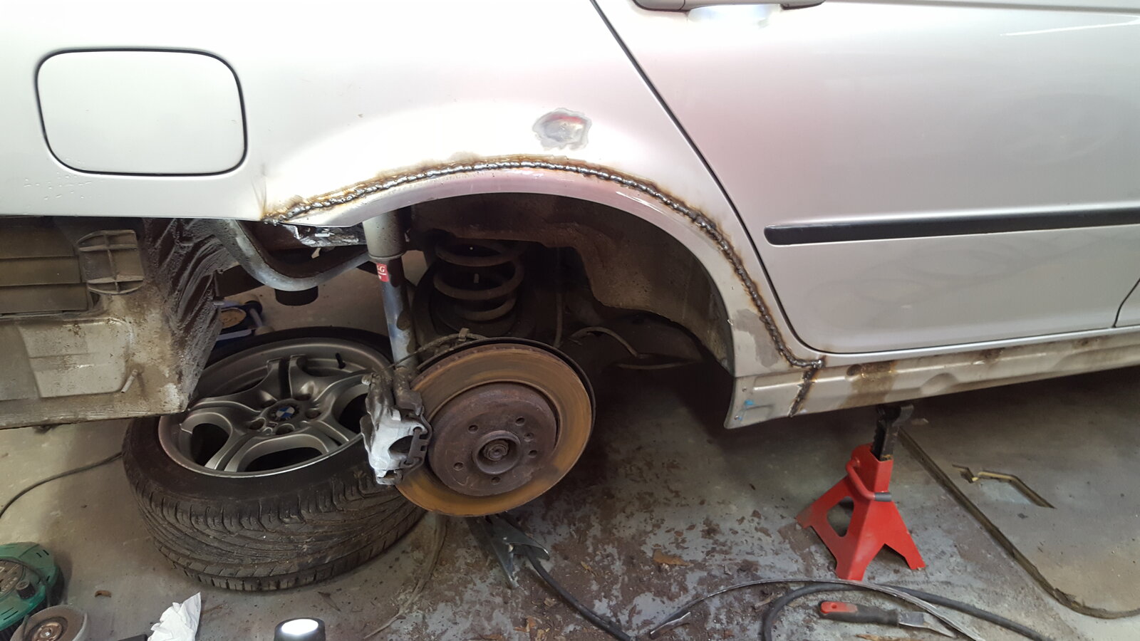

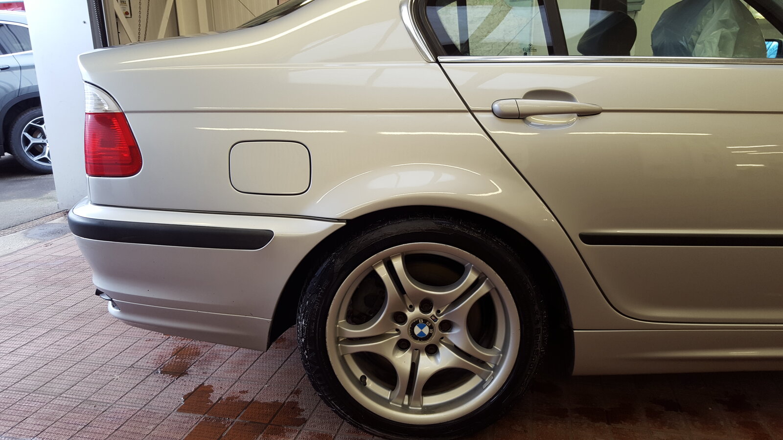

Quick answer, weld new metal in. Mercs are shite for rust in these areas. 100% will be rusting inside the flange where the inner and outer are spot welded together. You won't stop no matter how clean you get the outside. Looking at how heavily corroded it already is theres going to be holes when you grind the top off. You should be able to get repair panels rather than a full new 1/4. I did this on an e46 330d I bought to sell. It only had 50000 miles on but was cover in rust. Interior was immaculate. Bought it for £200 spent around £700 doing it up sold it for £2500. Maybe had 20 man hours in it.
If your asking yourself how does this jobs worth know, senior ATA BMW panel technician 🤓

Biggest issue I've found are bodyshops who are actually willing to cut out and replace sections of metal.

That e46, the repairs I did are not following any manufacturer methods or thatcham methods but the steel used in the older stuff it's not going to make any difference in a collision. Let's face it new fresh steel will react better than rotten on crap! I would be more than happy to put my family in it and be confident in the structure.

That looks like an awesome job you did there!
View attachment 1454703View attachment 1454704View attachment 1454705View attachment 1454706View attachment 1454707View attachment 1454708View attachment 1454709View attachment 1454710

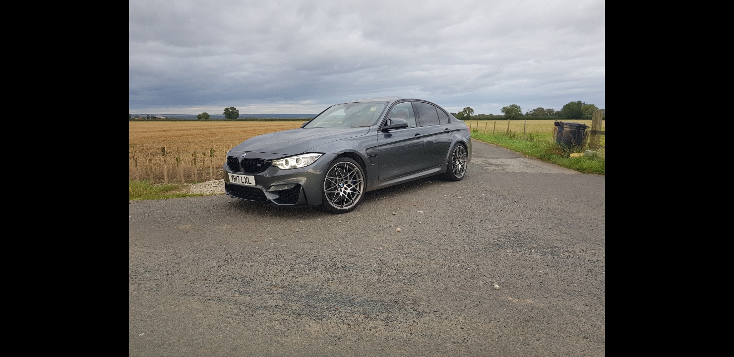

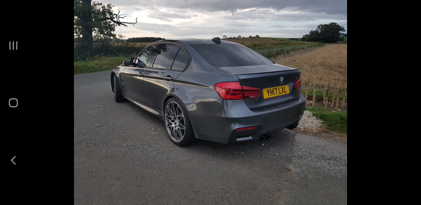

I work at a main BMW dealer. Theres a staff car scheme where you can have any car you want for 6months at a time. I sold the e46 to pay for the M3 for 6months. Think it was £418 per month. That included road tax, so all i needed to do was insure it and put fuel in. I also had an X120d through winter then a 140i the next summer then a mini countryman all4 2.0d. Now I've bought an X3 30d to tow the clio with. Came in at the right price with an electric tow bar fitted from factory
Nice perks, getting to try out loads of cars. Do you need to pay BMW at all or was the sale of the e46 to for fuel/insurance?
So the £418 came out of my wage before I was paid so the money from the e46 replaced it each month. Basically worked out I had the M3 for free. Was the summer I got married so had it for our wedding aswell.
