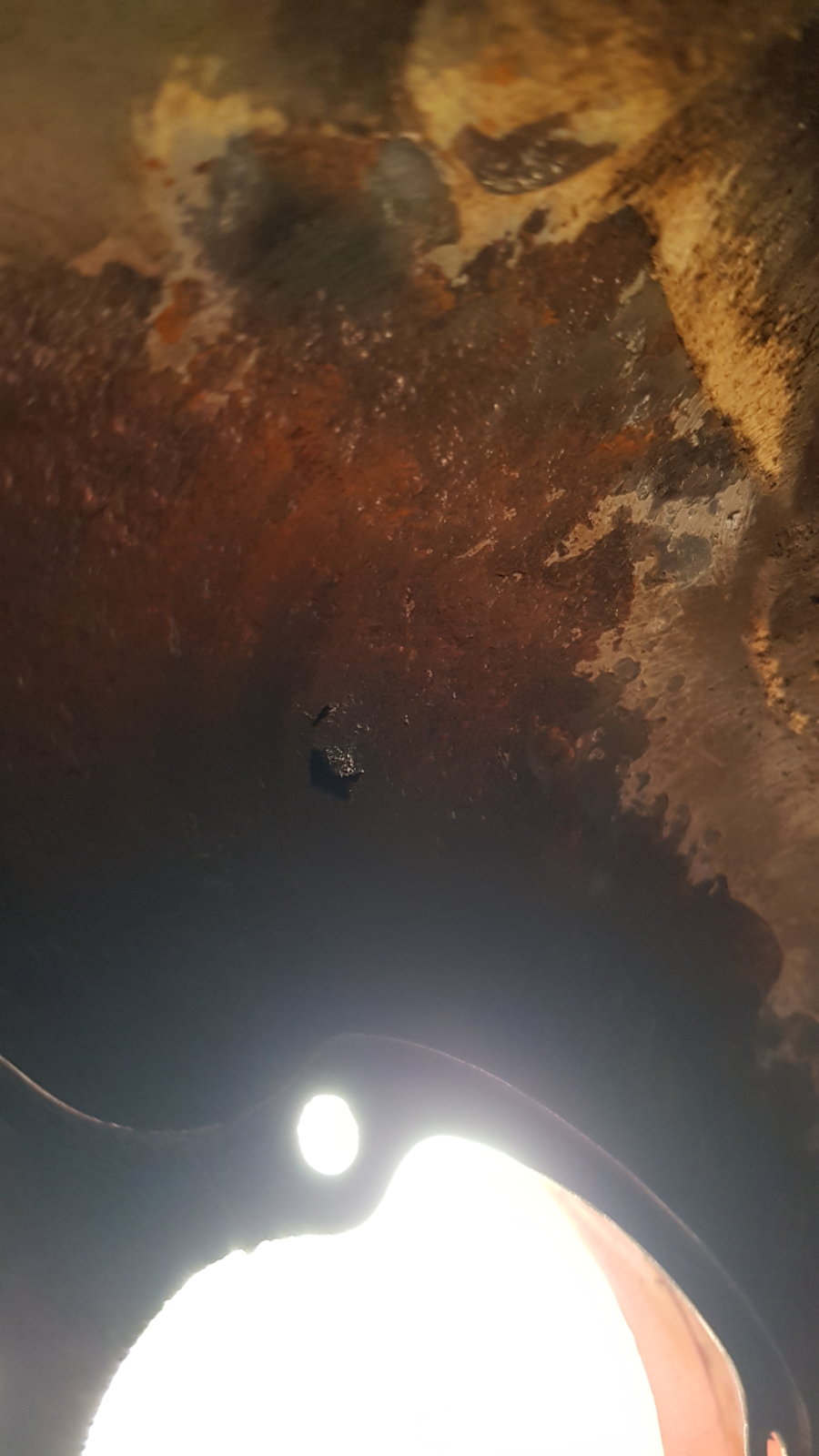

I think mine was definitely from dirt build up from behind, not a pretty sight now I've mostly cleaned it up!
Not sure what to do about the hole, get a patch welded in or a layer of filler

Isopon P40 will span that size of hole no problem. I used a zinc mesh the Mrs had in her crafting room along with P40 but the holes were worse on mine. The zinc mesh was from hobby craft but I think aluminium mesh is more regularly used for this purpose.
Probably as it does with motorbikes especially with road salt but much less so with my downhill bikes with the absence of salt. I think the idea is that the mesh is sacrificial to prevent further damage to the body panels but someone will be able to say better than me.
Would body filler absorb water in that area and create more rust?
Once I've got it back to metal with Deox gel I was going to cover it in Electrox after filling then Dynax UB. That should be ok shouldn't it?
