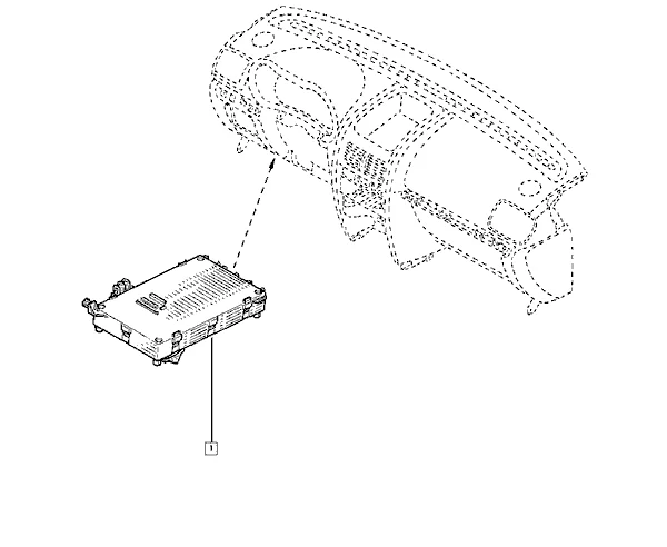

No - this is on the passenger side above the bonnet release handle ( up behind inside of dash ) Its a sealed unit and you cant repair them. Unplug it - leave it for 5 minutes and reconnect it. The problem may go away. If not a new one is £197.19 + vat part number 8200621763. You cant fit a used one as there coded to the key and ECU.
Do not take this as a definite diagnosis but its a very common fault. Always have an auto elec check things over before you commit to buy anything.
