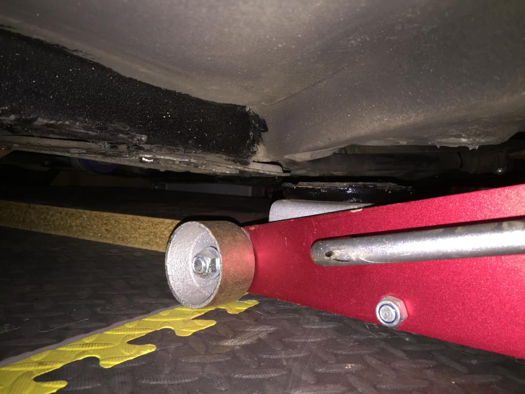

Why won't it reach the chassis rail or the triangle bracket? Because the saddle is to high or because the jack its self is not long enough to reach?
Its the angle of the sides of the jack, it will go so far but not quite far enough

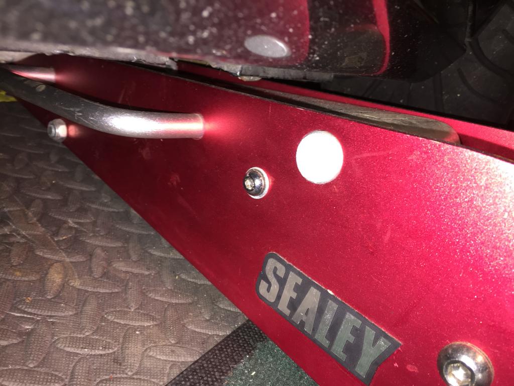

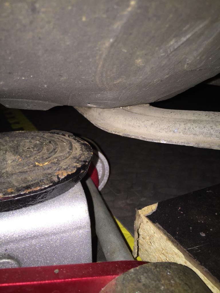

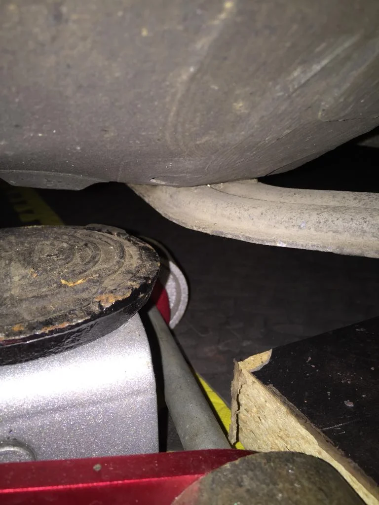

heres a couple of pictures as you can see it needs to go about 5 inches further in.
Thanks for the pictures, Looks like it would however reach the D shaped frame?
