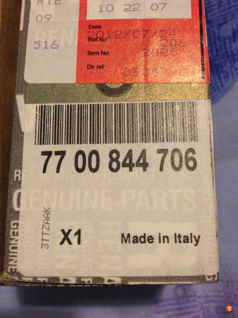

I bouht a trophy spoiler from renault... and the stop light doesn't fit ...
i ordered this
Spoiler: 6020012727
High-level stop light: 7700844706
is that a good part number?
...the stop light i was sold seems to be the same as on a non cup 172/182

Hey
i ordered this
Spoiler: 6020012727

The part number seems ok for brake light, can't comment on spoiler though http://www.ebay.co.uk/itm/NEW-GENUI...rParts_SM&fits=Model:Clio&hash=item3a8a907d2d havent got my spare one to hand to double check though. Get photo up of the spoiler and brake light.
The spoiler is ok, I fitted it ...but the stoplight doesn't fit in... Stoplight came in a box with this part number i wrote... Maybe they packed in the wrong light into right box... That's why i wanted a confirmation of stoplight part number.
