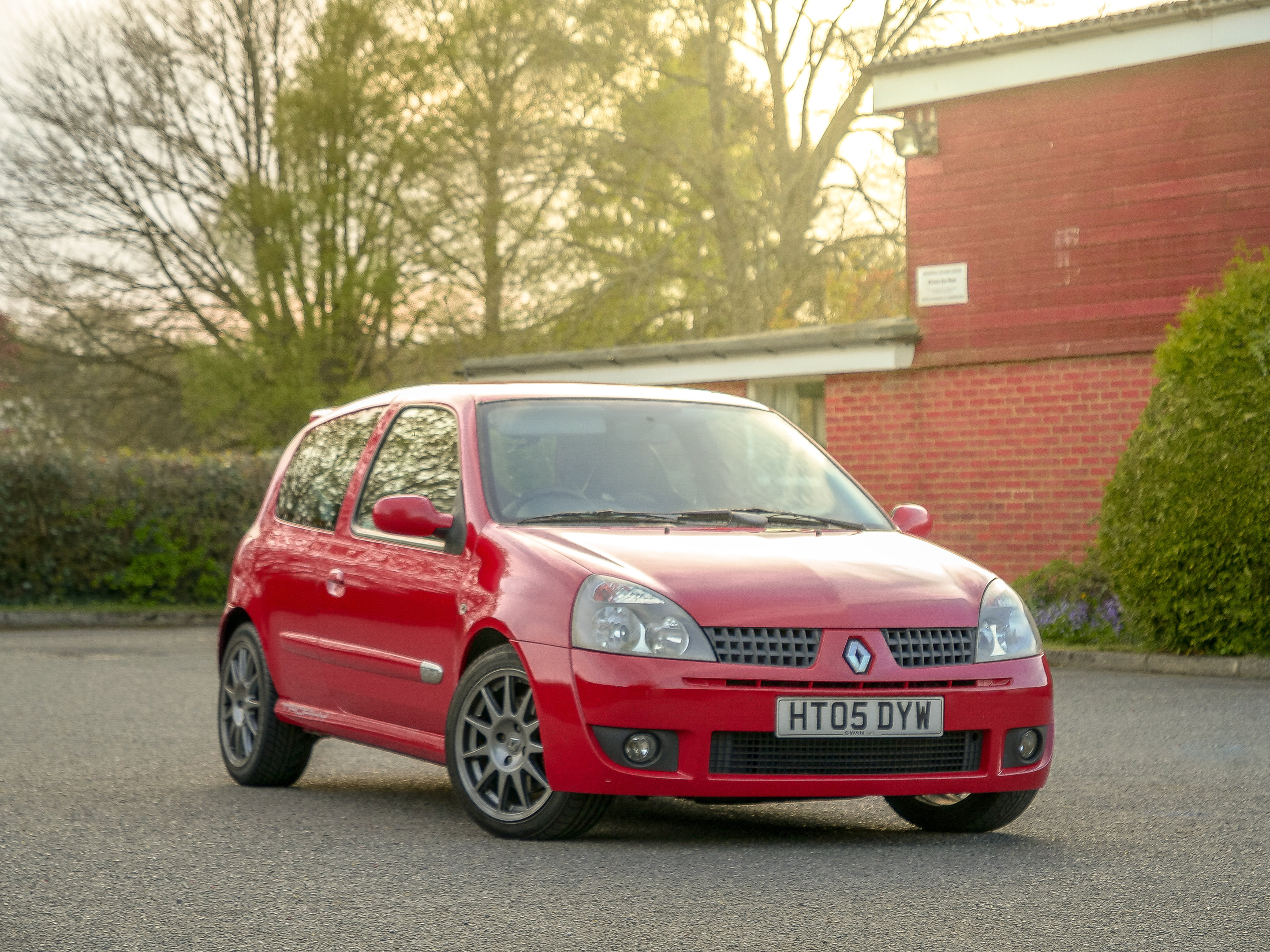

So here it is, I bought the cheapest Trophy I could find today.

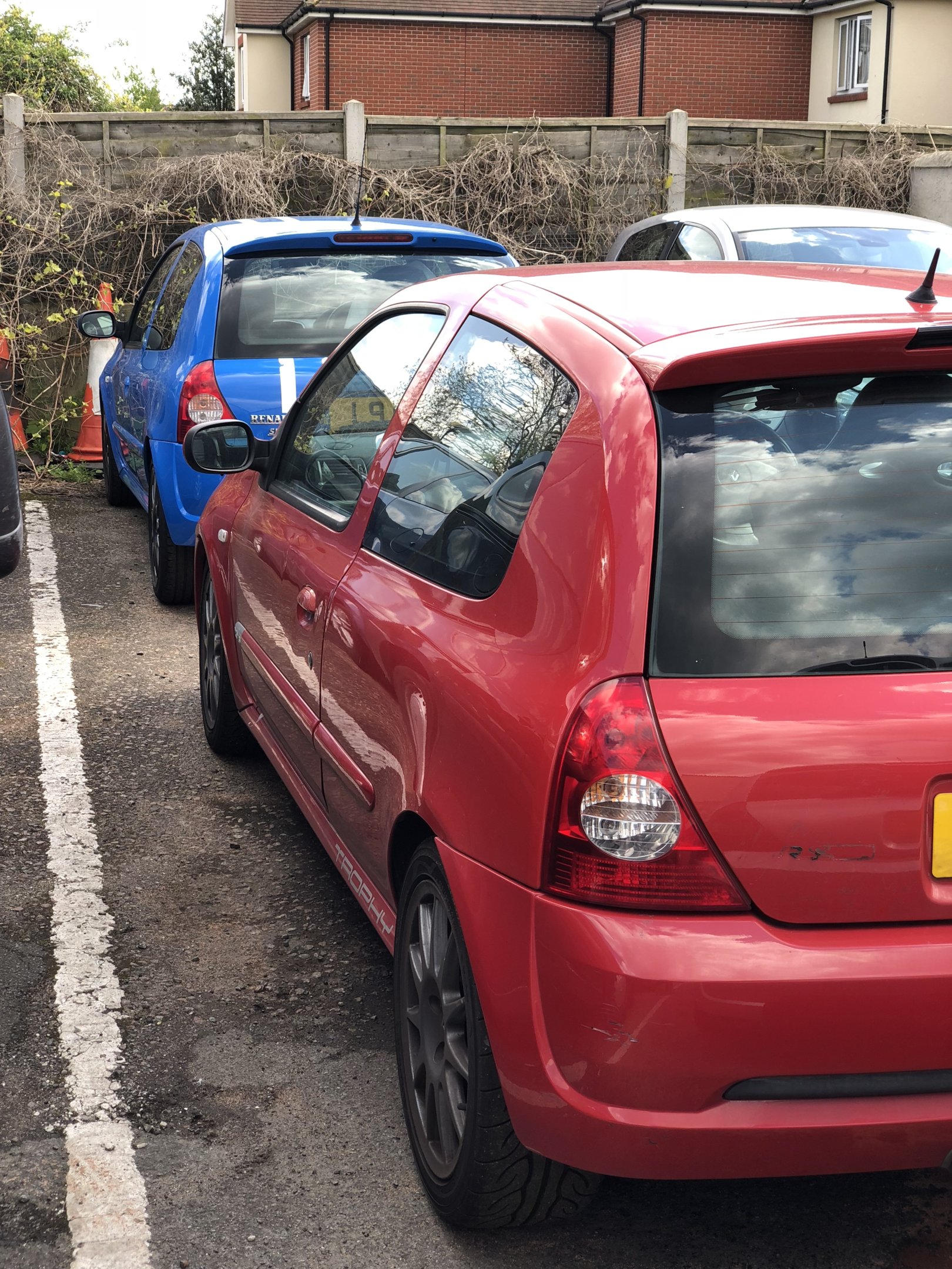

It may look nice in the photo, but there's quite a bit of bits wrong with the 115,000 mile No.12 Trophy. Namely:
  • Big hole in driver's-side carpet
  • Slight tear in one of the Recaros
  • Paint various colours
  • Front grilles faded
  • No black blanks on the front bumper
  • Broken boot struts
  • Melted steering wheel
  • Air con controls peeling
  • Radio needs a code, so doesn't work
  • Trophy stickers peeling
  • Three different brands of tyre
  • Smells of dog
But, it does have freshly rebuilt dampers, a recent cambelt and the wheels have been refurbished.
So my plan is to keep much of the 'patina' being a track day toy. Instead, I'll focus on modifications to make it more track biased. Could you guys refresh my memory with the essentials?

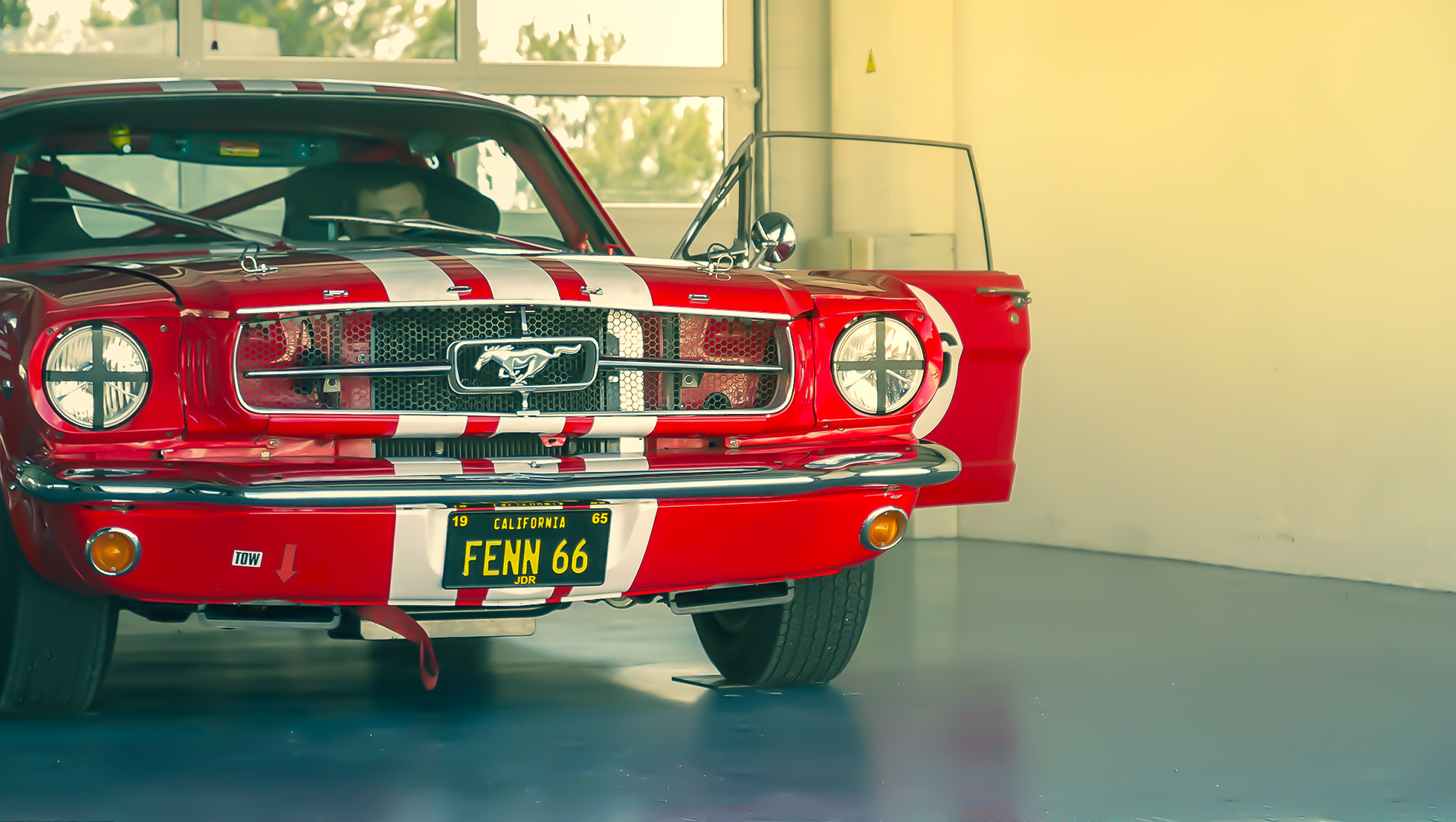

We still have the NSX but don't really race it any more. A few years back my dad bought this lovely Mustang that I've been racing. I absolutely adore it!

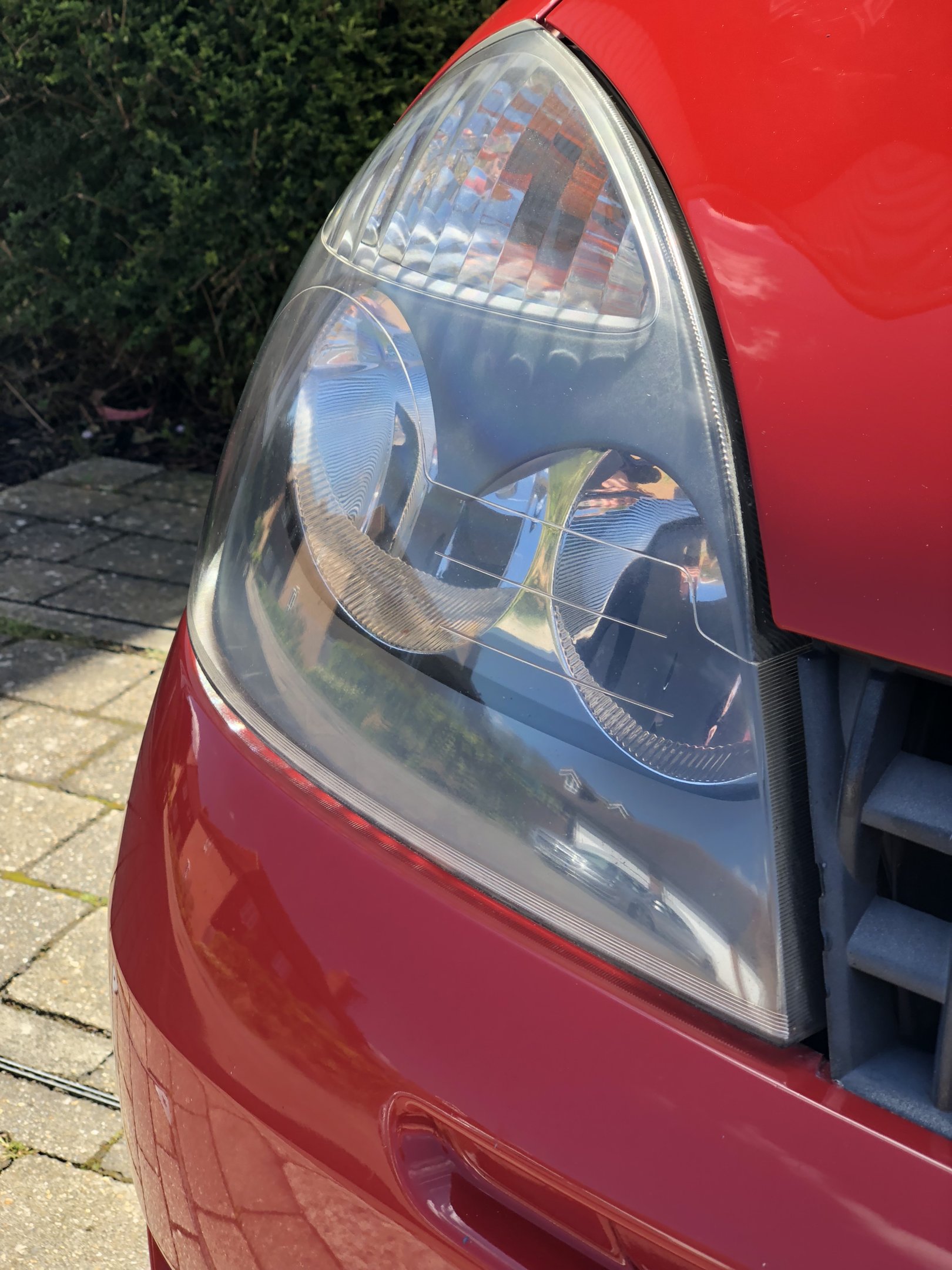

So first thing I have got done is a bit of a detail. I wasn't that bothered about the outside, as it's already a shed, but it was nice to see the headlights returned to their former glory! The main thing now is there is no dog hair in the interior...

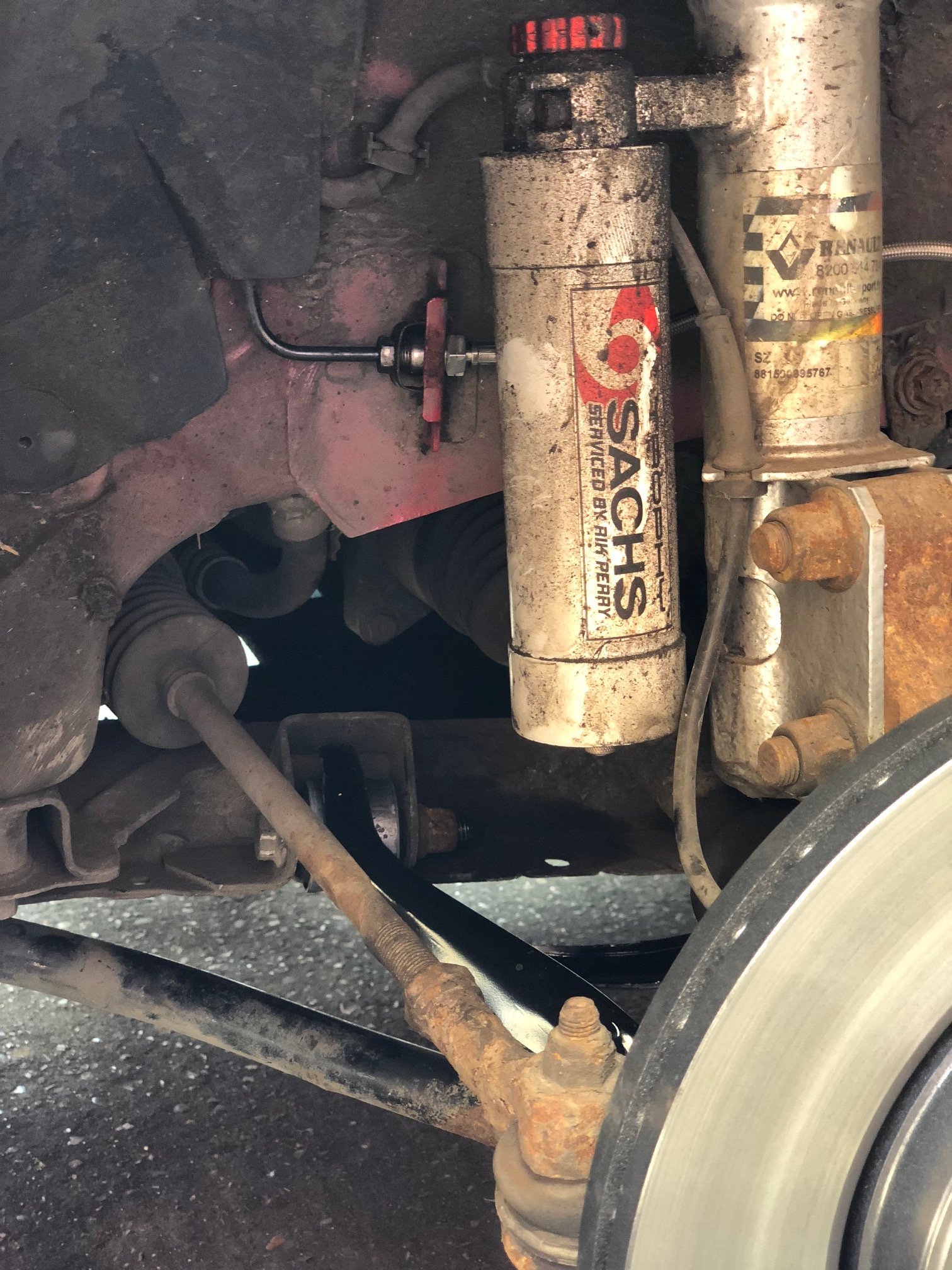

The car is now with Two Techs in Dartford, Kent. Unfortunately I've been told the front dampers are leaking! This is an issue as it's meant to be on track next Wednesday. Particularly frustrating as they were supposedly rebuilt last Jan and the car has done a mere 1,000 miles since - basically the only reason why I went for the Trophy was for this ?

If you're wanting to get them refurbed and put back on then just get some standard 182 shocks with the 60mm spacing and run them until the sachs are back. Otherwise, go big, get BC or AST coilovers.

Track day now done! After picking up the car from Two Techs, I went to get new tyres fitted. You can see how obvious the leaking is...

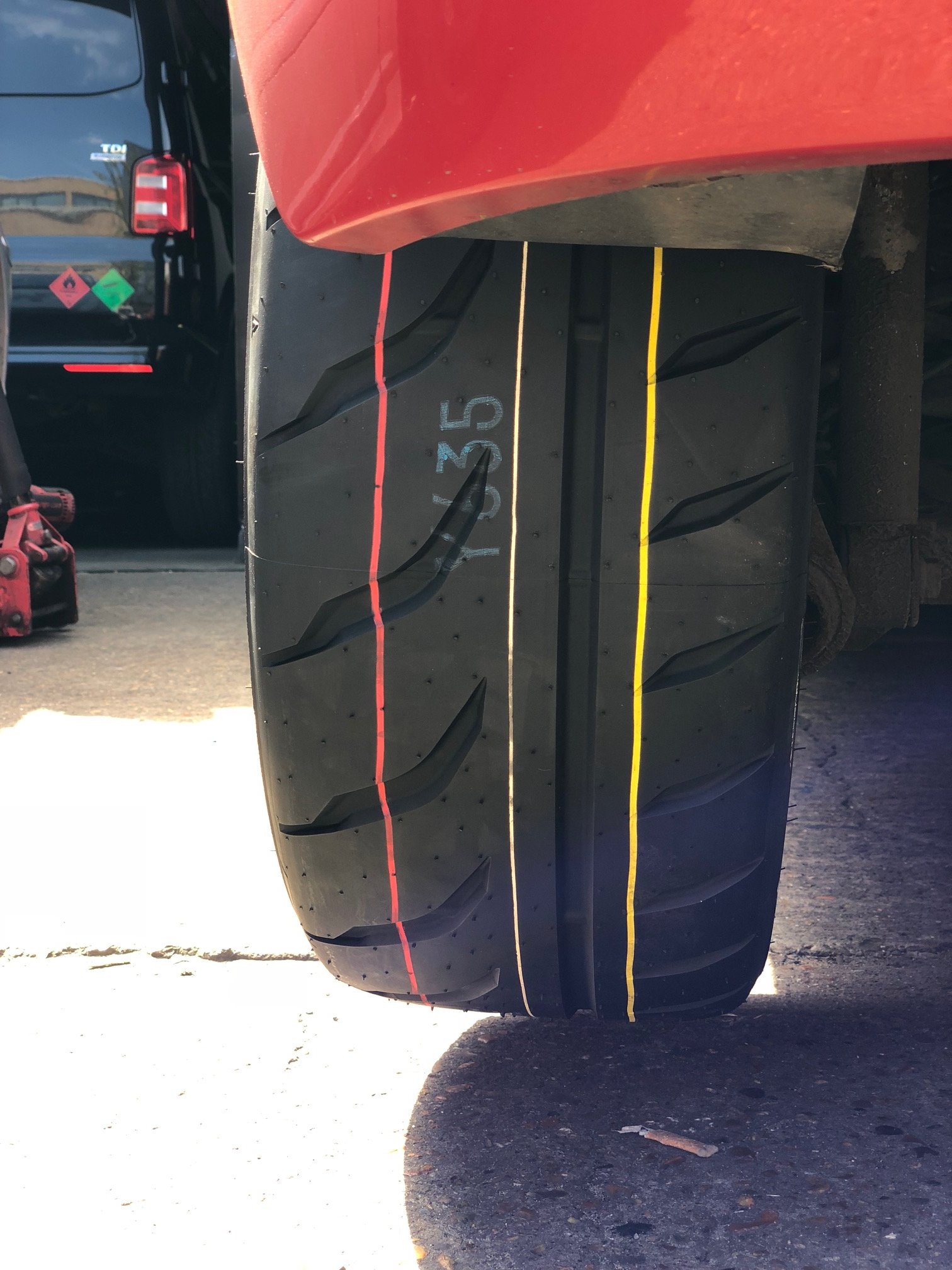

Nevertheless, with the track day booked I decided to crack on. Here's a photo of those nice tyres!
On the track day itself, all was well until the last half hour where there was a noticeable vibration and clunk from the left front corner. We did a couple more laps then called it a day. A shame because otherwise the car seemed solid - the PBS pads are incredibly, embarrassingly noisy on the road but we experienced no fade. Temperatures also seemed fine and the tyres were easily better than the previous 3 different economy brands I had on the car!
I took the car back to Two Techs the following day and their view was the LHS Sachs had completed failed. Given I'm out next Weds again, I couldn't get any coilovers so instead have two 182 Cup dampers coming as a temporary measure. Probably for the best; i'm trying to be strict on the budget and they were less than £60 new.

Sachs just in need of a refurb or are they dead? Can they be fully killed? I sure I read that bmw 1 series struts stop the spoiler fouling on the trophy.
