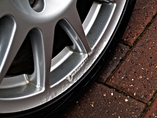

The turinis on it now have seen better days tbh; the two on the front have some light curbing done by a previous owner.
The two on the rear are corroding though! I knew they'd need sorting when I bought the car a couple of months ago, just didn't quite expect bits of paint to be flaking off yet! lol! :dapprove:

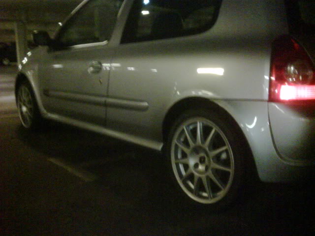

only this really bad one off my phone....

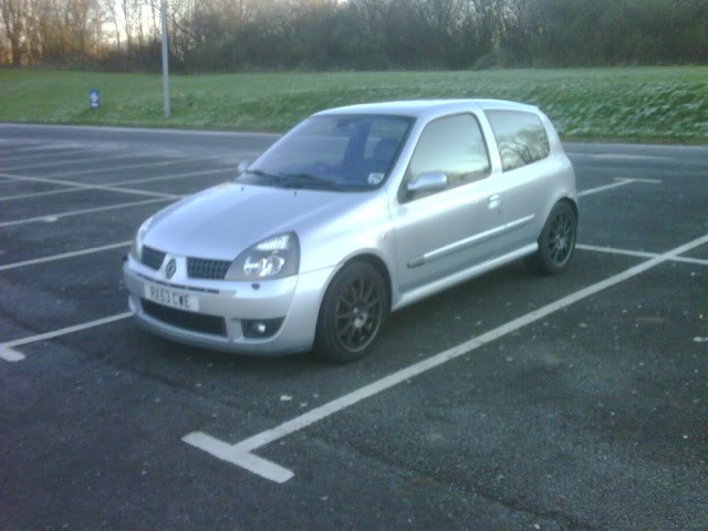

and what it looked like earlier today....
