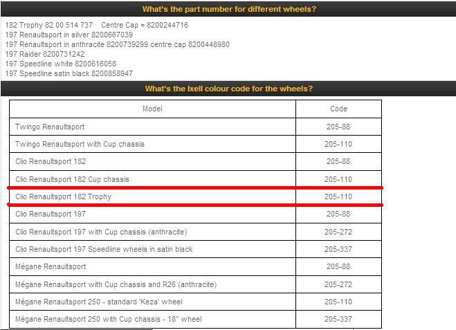

Part Numbers and Paint Codes .
You will never get an exact match via powder coating as you can't mix powder.
