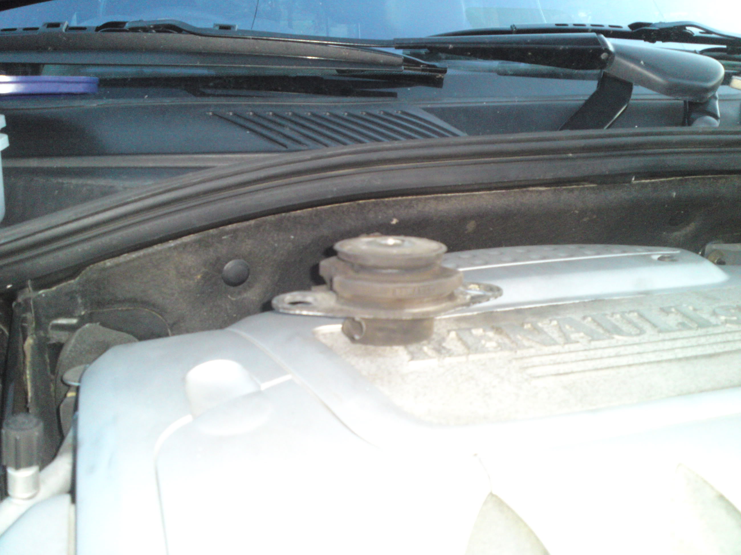

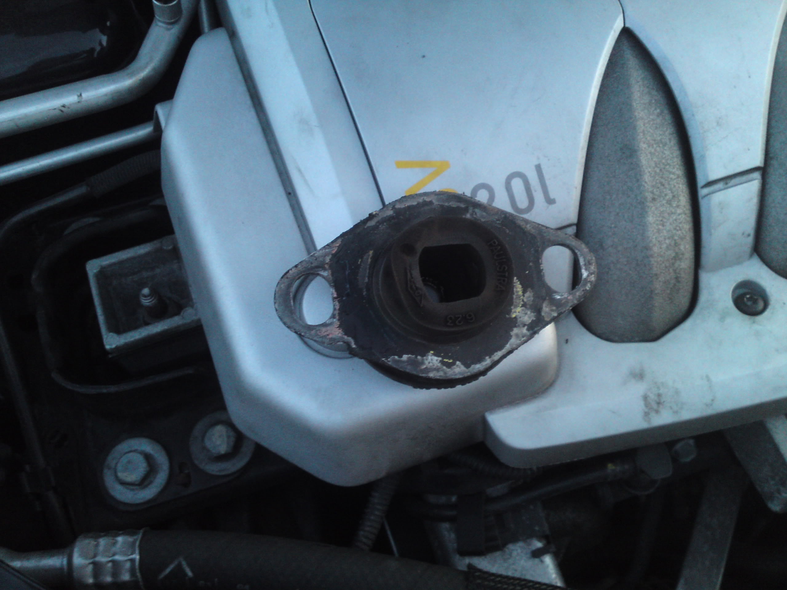

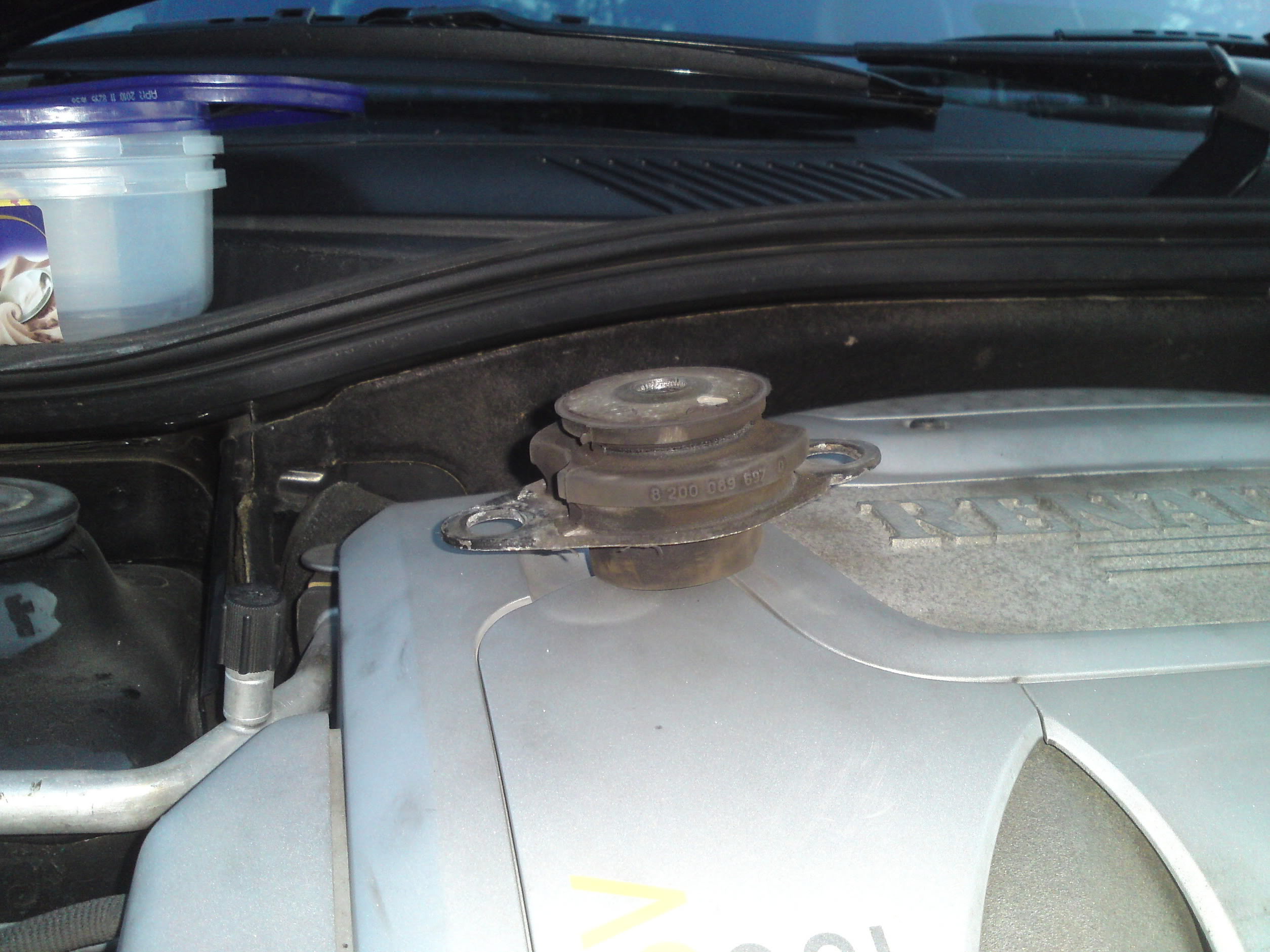

Well i took the upper gearbox mount out all the screws were fine and it looks like this...............

that's defo had it - you can see it's deformed in the first pic. they're about £20ish from ECP/GSF

I know it looks deformed there but i wouldn't of though that would of caused the problem. :eek:
So whats the point in these uprated ones then? cause aren't they made of rubber?

i'd replace that mount; it's visibly deformed and you do appear to be getting quite a bit of movement out of it in-situ
if you've a EuroCarParts near-by, the part number's 338745140 and they are/were £13ea (just checked a receipt)
