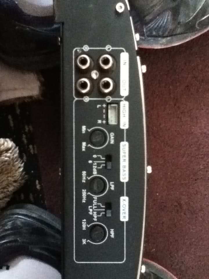

dont know what hpf means but on the amp it goes from 120h to 3k ive got it on full and same with lpf and gain. x-over is switched onto hpf and super bass is on 12db
You can't just guess and plug stuff in wherever.
You don't want the x-over on HPF for a start.
The gain is not 'volume', you don't just put it on full, set it to about a 1/3 to 1/2 as I'm guessing you dont have a volt meter?
You also don't want your low pass filter set to the highest setting.

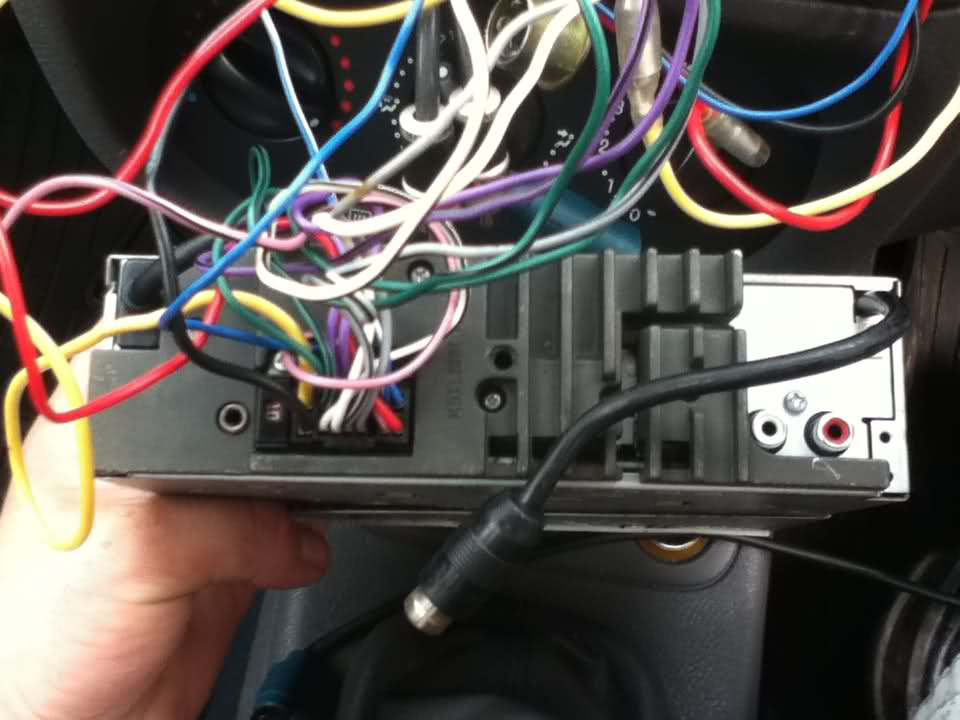

this is the back of the headunit as you can see in the bottom right the are 2 sockets 1 red and 1 white this is where i plugged my cables (it says sw/f at the side of the sockets)
just about see it theres a blue and white cable thats what ive attached my rem cable to

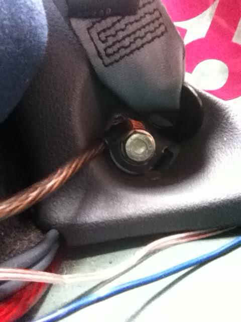

this is where ive attacted the earth cable

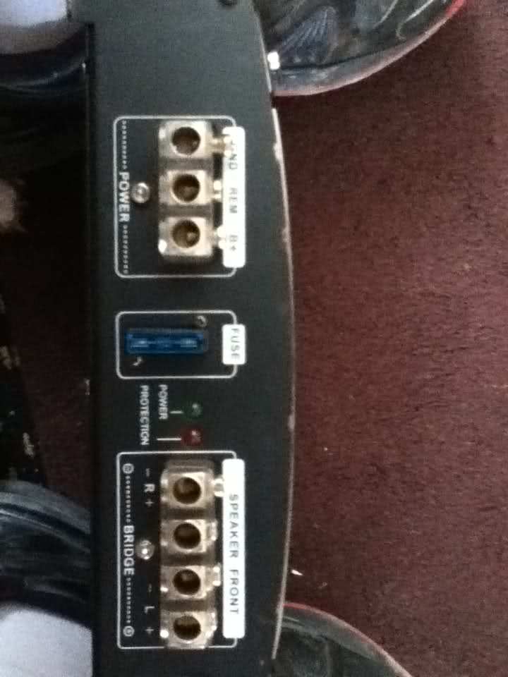

this is the amp, ive put the power cable in the b+ , the rem in the rem and the earth in the gnd
put the wires in the out and in sockets tried all combos
the headunit ive got is a alpine cde-9850ri
this is the user manual
http://safemanuals.com/user-guide-instructions-owner-manual/ALPINE/CDE-9850RI-_E
page 18 and 19 are about setting up the sub and amp, followed the instructions and made sure the sub was swithed on and that it was turned up full

you need to set it to lpf (low pass filter)
then point the lpf knob to the a of super bass
set super bass to 0
turn the gain down to min
then plug it all in play some music at the level where it starts to sound bad then knock it back (e.g sounds bad at 24 then set it to 22)
turn off any bass boost, eq etc on the hu (apart from sub level iirc on alpines set this too max)
then turn the gain up to where it starts to sound bad then turn it back a bit so it sounds ok then a little more
How do you have the sub wired? It should be from the positive of one channel, to the negative of the other channel... Assuming your amp is bridgeable?

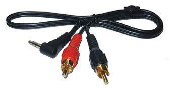

if the amp is defo on, you could always try plugging in an ipod/mp3 player via a headphone jack to phono socket lead (maplin will do em) then see if you get sub comning out, then you at least know thats all good. then work your way back from there

If the light is coming on on the amp, then it is being turned on by the headunit. this doesn't mean it's getting power to it to drive it. check the fuses again on the amp and the main live feed from the battery. double check all connections. as if it's not a perfect connection then it'l go into protection mode. I'm sure I used the earth on the rear lights, but to be honest in your pic of the earth, it doesn't look great.
i had a good look around for a earth and thats the only one i found really . i was going to use the bolt thats holds the back part of the rear seats in place but couldnt get the flaming thing undone. thought about the rear lights but cant see how such a small bolt can hold a thick wire in like that. do you know of any other good earthing points
Take the boot carpet up and use the bolt holding the rear bench in place. That earth does look fairly weak. Start at the battery and check every connection until you reach the subs. No doubt it will be something silly you ve forgot.
ive tried that earth mate as mentioned above but cant get the bolt undone

earth cable goes from the amp to the bolt that holds the seatbelt in

well at a guess, after what you have been going through, i would have a stab at faulty head unit. Dont suppose you have an old one lying around? or just borrow off a mate for 2 mins, to double check if the RCA ports on your headunit are bad
or just get one of those leads from above an plug it into an mp3 player

thanks everyone for making what I suggested with mp3 player clearer!!! usin gphono leads, this will rule out the rca cables or head unit preout.
however looks like you have done that already.
