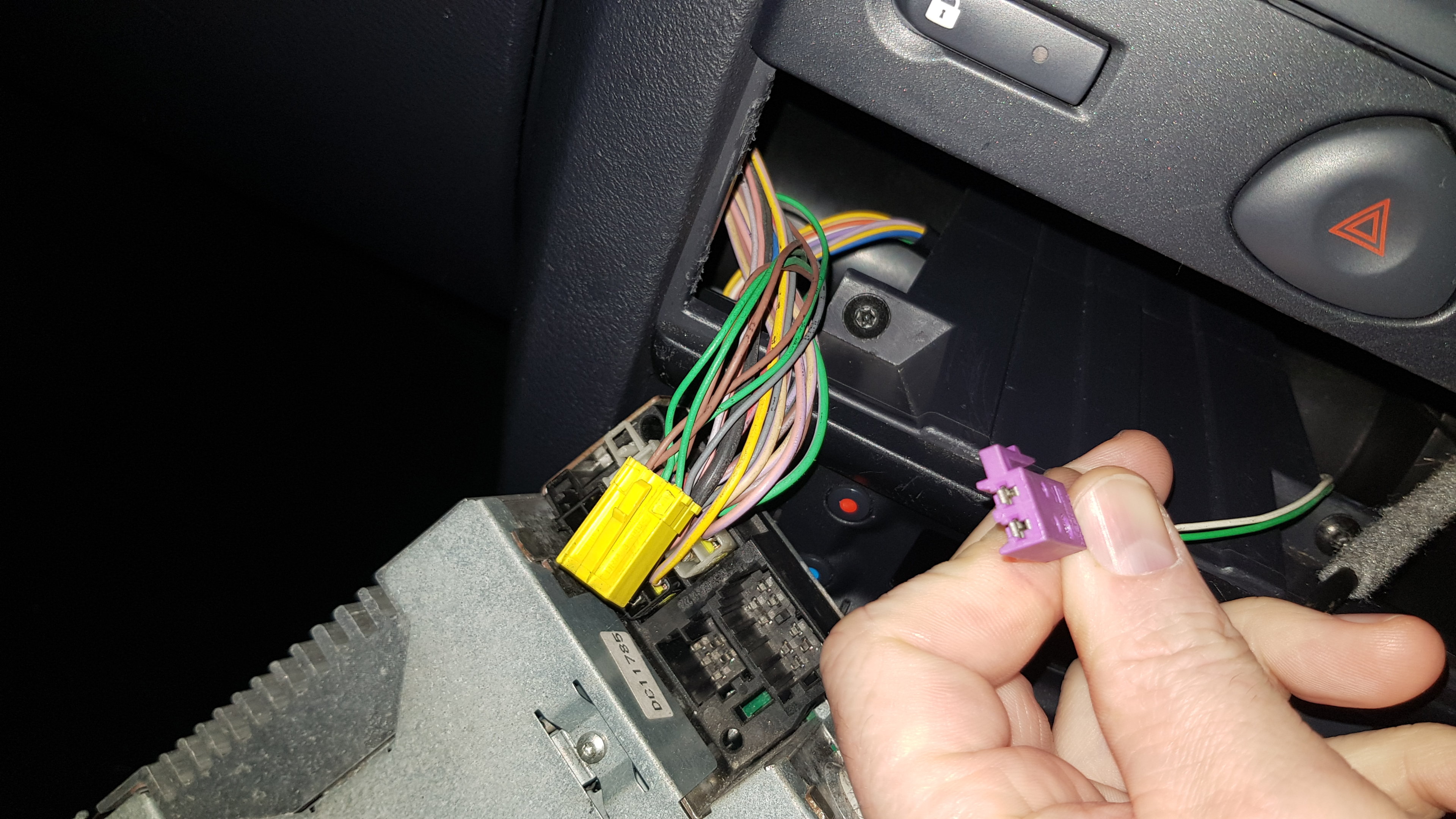

I've got an update list stereo in now with the display on the stereo not the dash board. The yellow block won't fit into the back even though there is a connection that looks like it should. Do you think I need an update list without an LCD display on the front?

If you have an update stereo with display on the stereo it doesn't sound like a Clio one and hence your issue (and the yellow block not fitting).

Any idea what the purple one does? I figured that was the LCD display, and the yellow is the stalk controls. Does that sound right?

No idea what the purple block is mate - does everything else work okay? Come from the hazard button area maybe?
The yellow block is for top lcd display and stalk controller.
