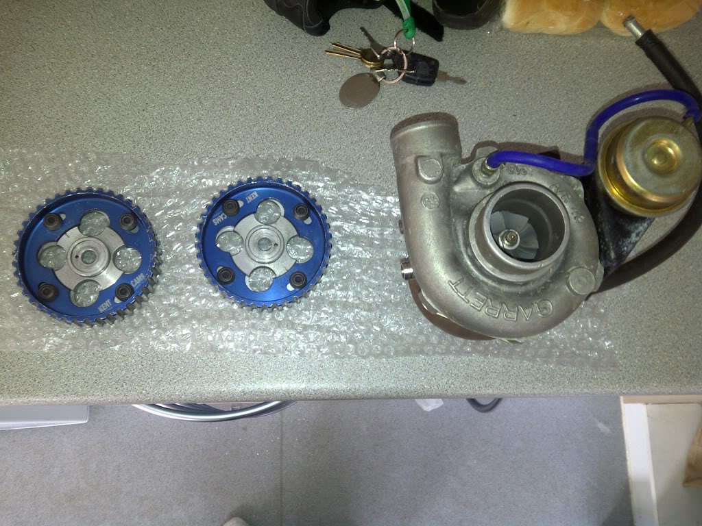

As long as the housing suits the correct inducer/exducer/trim of the exhaust wheel. Grab a picture of the turbo.
I've only got 2 poor ones...

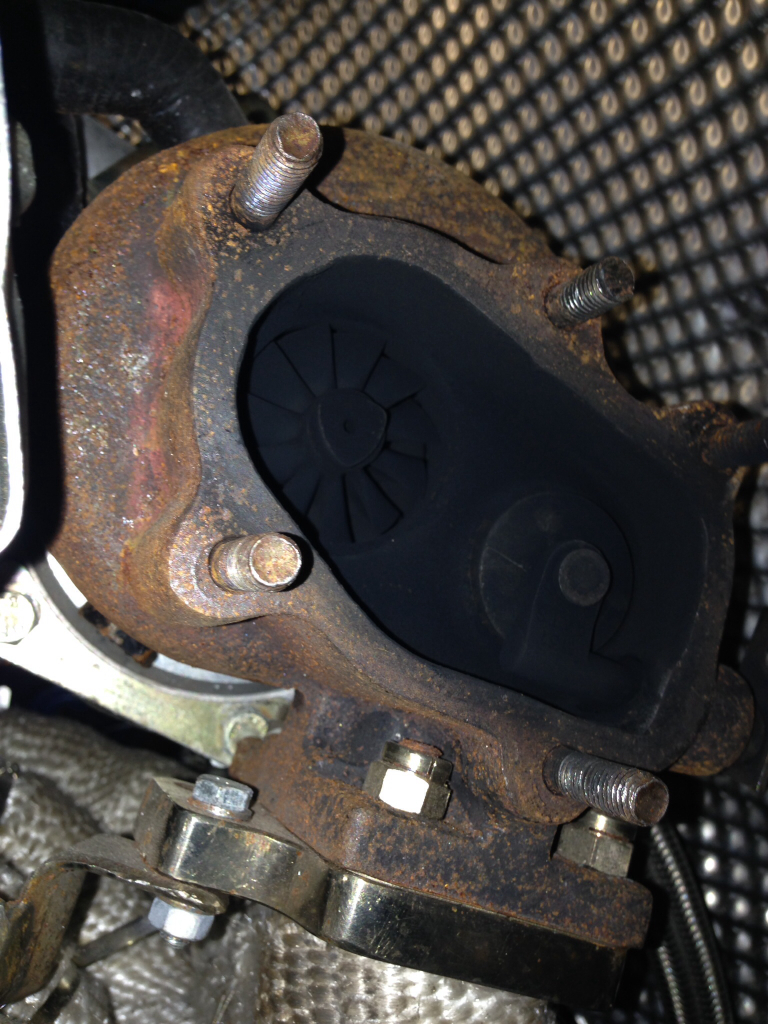

i wanna get rid of that stupid 5stud thing as it's making making a new down pipe a f**king pain!
What do you mean deeper? Like I said the 5 stud flange is making life really difficult for me so I'm hoping to come off a v-band straight into a bend rather than what I currently have to do.

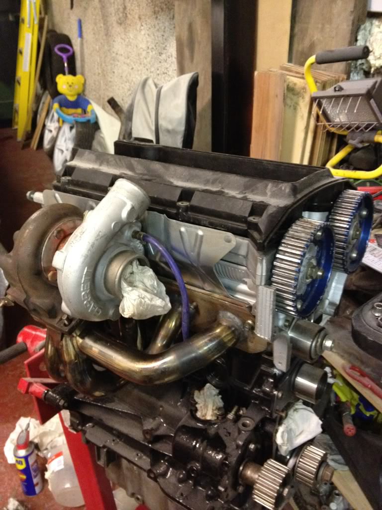

my main worry is its orientation on the manifold. I currently have about 2 inches behind and about 5 mm in front of what I have now so any movement forward is going to be no good for me.

I dont think your going to find an off the shelf Vband outlet housing for a T28, they make them for the popular models, 2860RS, 2871R, 3071/76 e.t.c but not really for the old T28's that have minor variations accross models.
