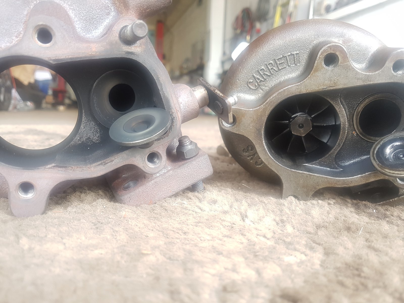

  dan's cast offs.
Genuine housing compared to Chinese one from a reputable UK supplier. Not ed.

  dan's cast offs.
But when you only want it to run 9psi and it's way higher that's when you're in trouble.
Think that one did actually hit over 20psi with wastegate fully open. Was fine once it had been ported.

I can imagine no control of the boost pressure at all when cranking it up with that pissy little hole behind the w/g penny. Still quite a way to go until the lower end ching stuff compares to garrett. The mamba stuff looks ok, but not cheap !
Their stuff looks good but a mate tried one and wish he hadn't ? In the end he just went out and bought a Holset HX35
