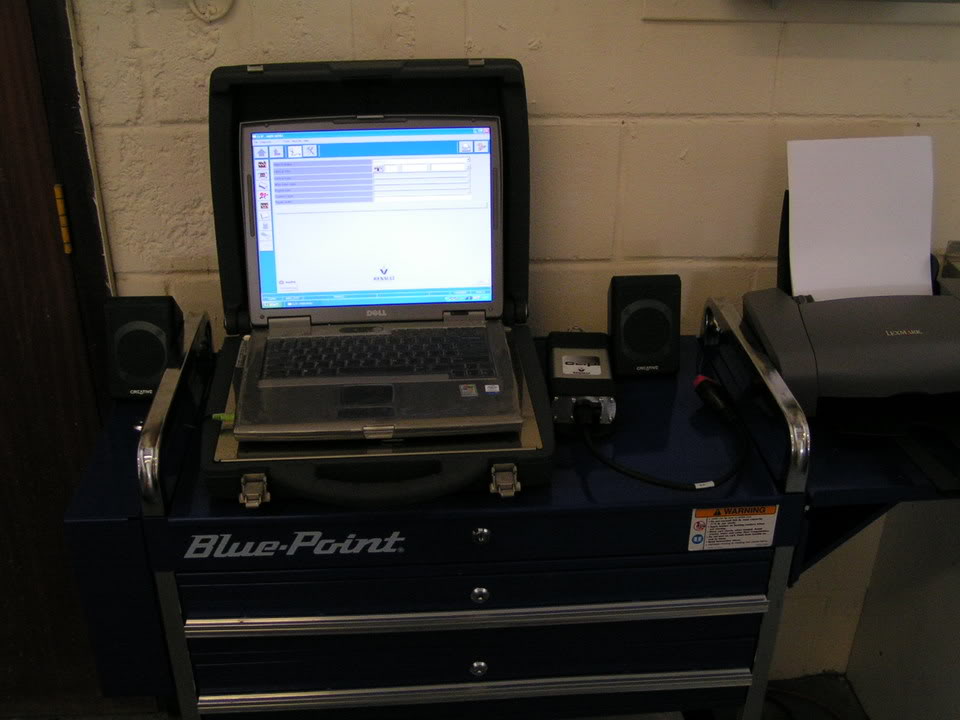

wots a renault clip system then
this...
what the dealers use.
