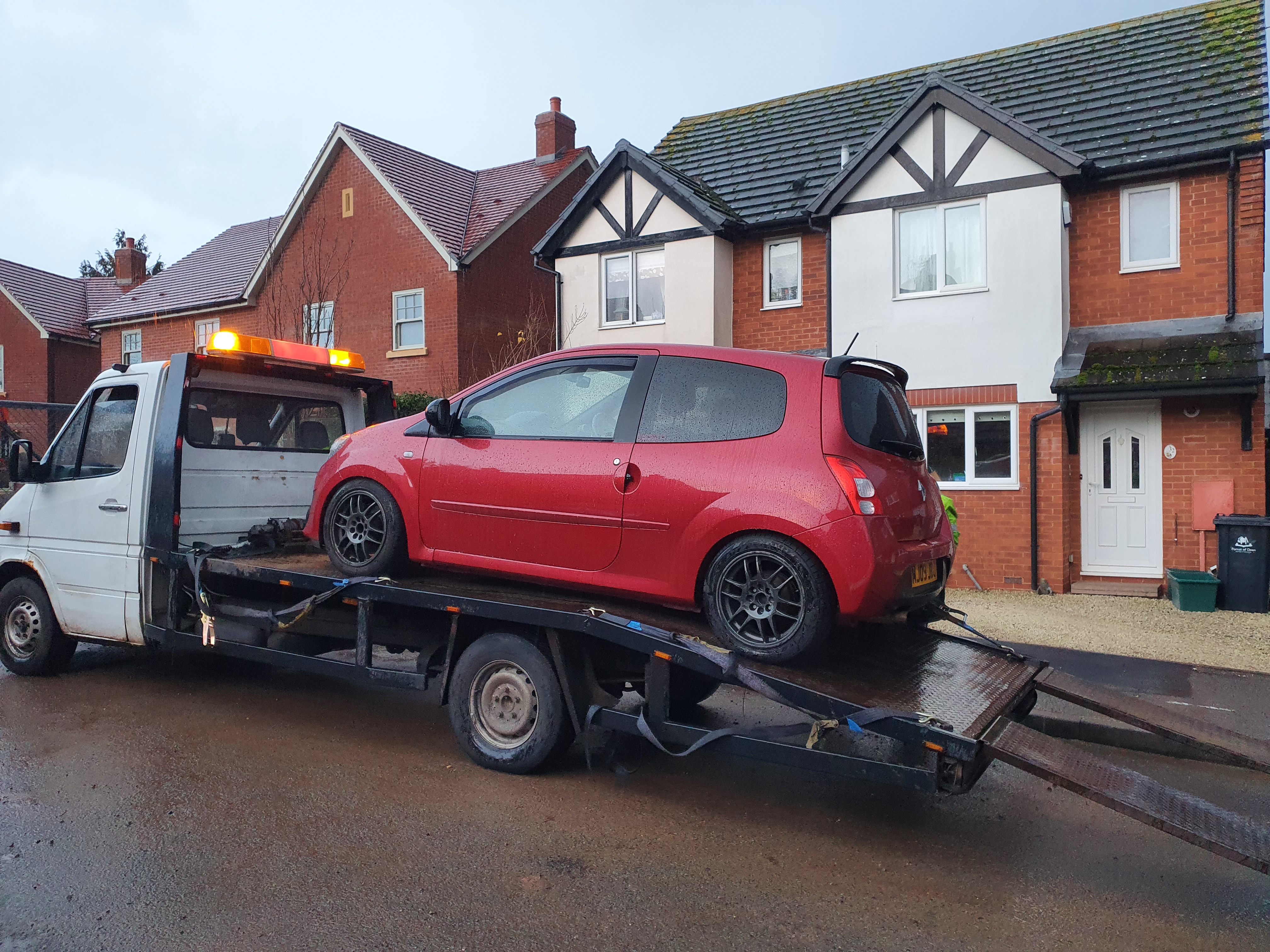

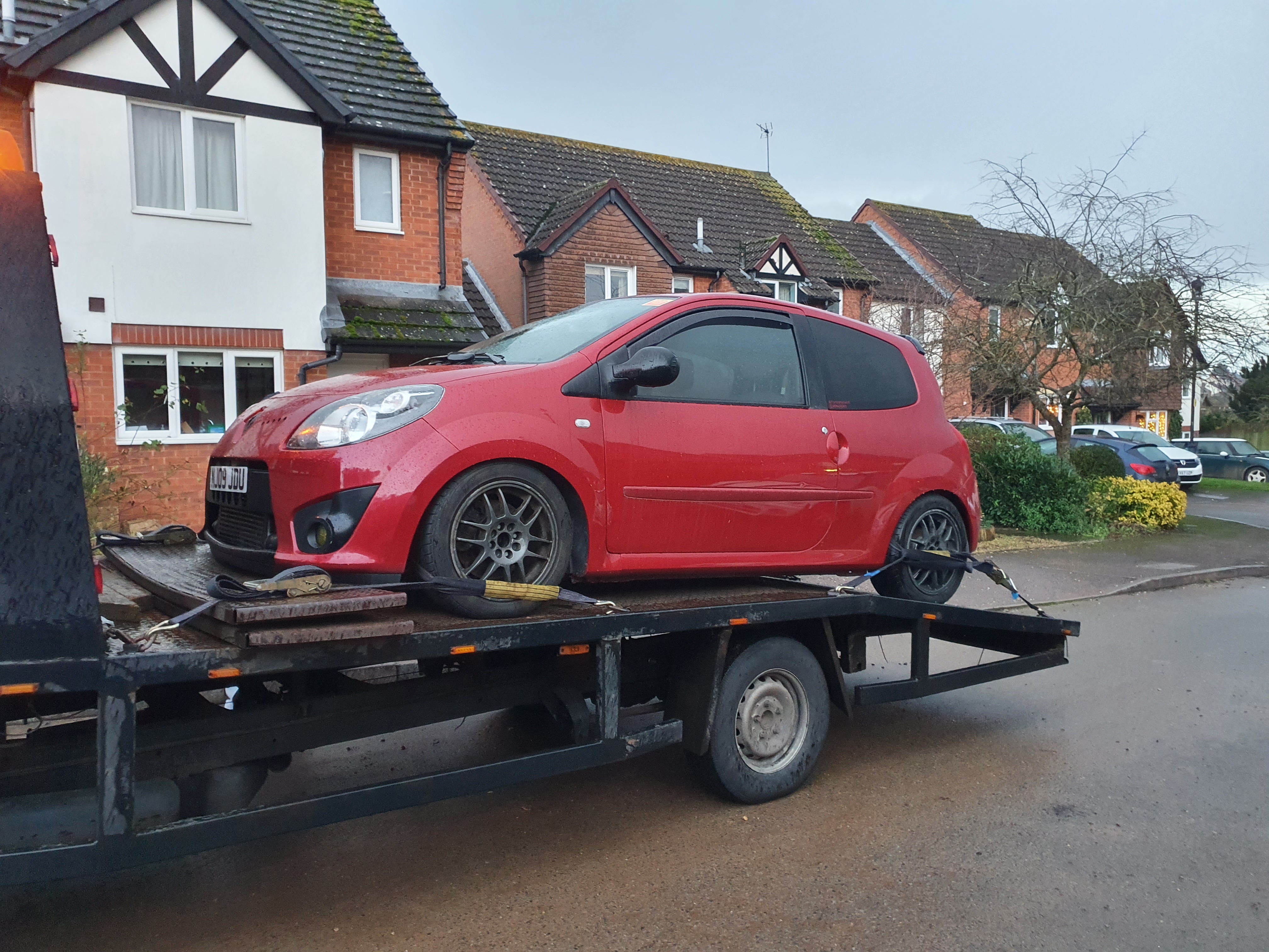

Picked up the 133 kit today, minus the front bumper. Offered up the rear arches and Errr yeah...the GT beam must be massively narrower lol
Dunno if I can be arsed with it now tbh will have to see

I did think a gt was quite a bit narrower than a 133. You should do it though definitely. Can you get spacers to go between the axle and the stubs?

I think swapping the beam is probably the better way to go about it really. Would need huuuuge spacers lol

There is quite a few 133's getting broken on ebay. You may also need to do the front end as the front end I don't know if it's just the bottom arms are different or subframe also.

GT and 172 are similar widths I think. rs133 is probably wider again. keep it as a gt or engine swap a blown up rs133. if you make the rear wider the front will be too narrow also and I think it was already on 20mm spacers all round?
Yeah think you're right mate.
Should of probably researched this before spending 6 hours collecting it and spending 150 quid lol
Oh well

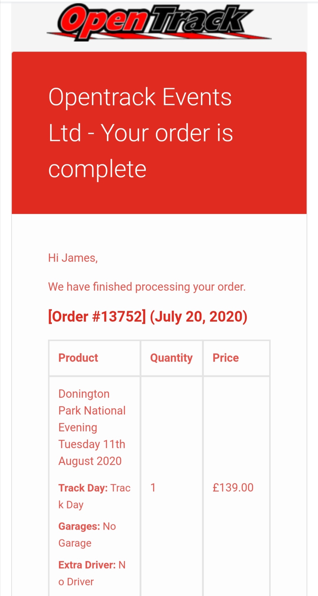

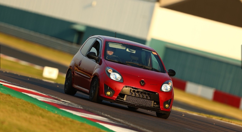

A very hot donington park evening session last night! Only picture I've got
Felt a bit slow on a track that size but was still good fun. Not driven on track for a long time and it was first time I'd used this. Never got chance to get fully into the swing of it due to red flags.
Got a slight issue I need look at though. Drove all the way there fine but whilst queuing up to get in I got a flashing engine light. Only happens on idle and seems to drive fine. Once at any speed it goes off.
I'm guessing I've got an injector on the way out. Will try and track down which one and stick another in

Just searched this out as i was missing it:ROFLMAO: and to see how you got on, never done donny is it a big power track? Hopefully the issue is just an injector (common 172 injectors in there), should be able to pull the fault codes and stuff to give you an idea though? Still looks mega on track (y)
