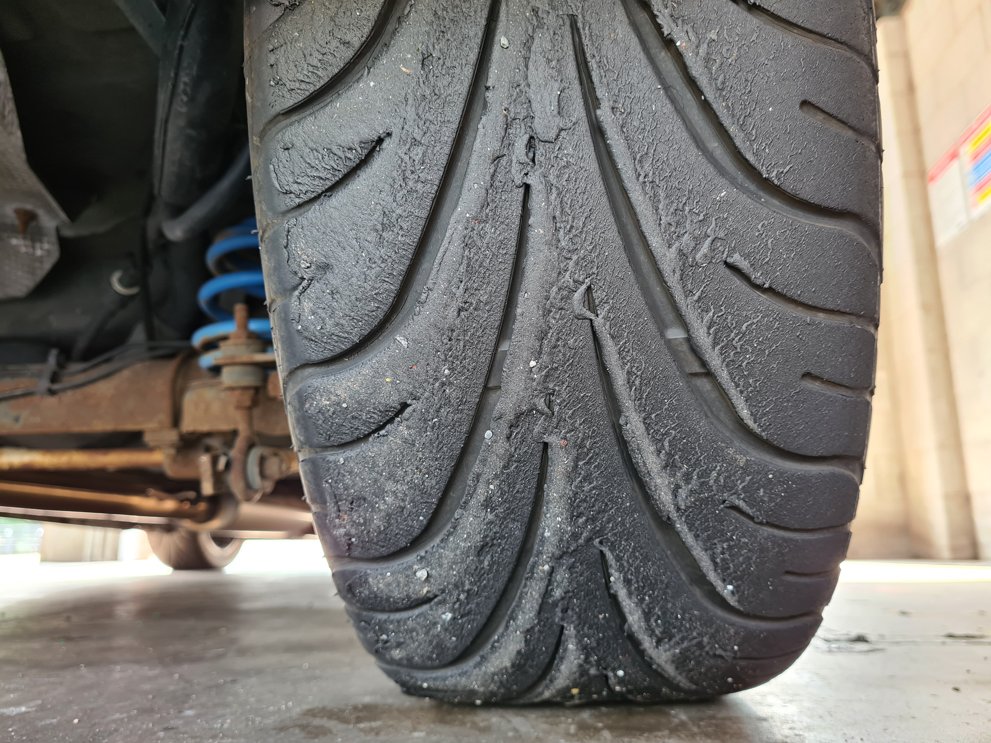

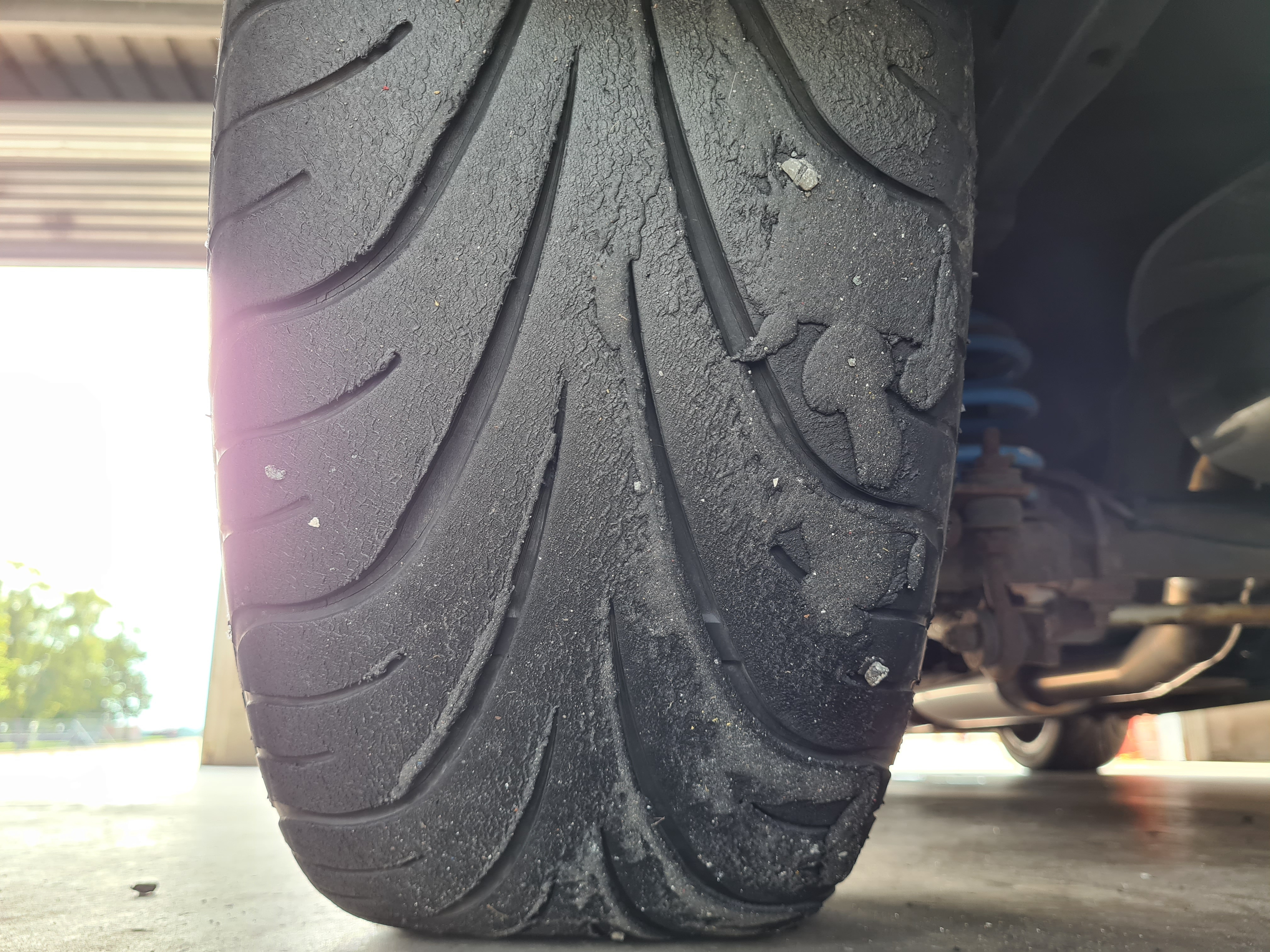

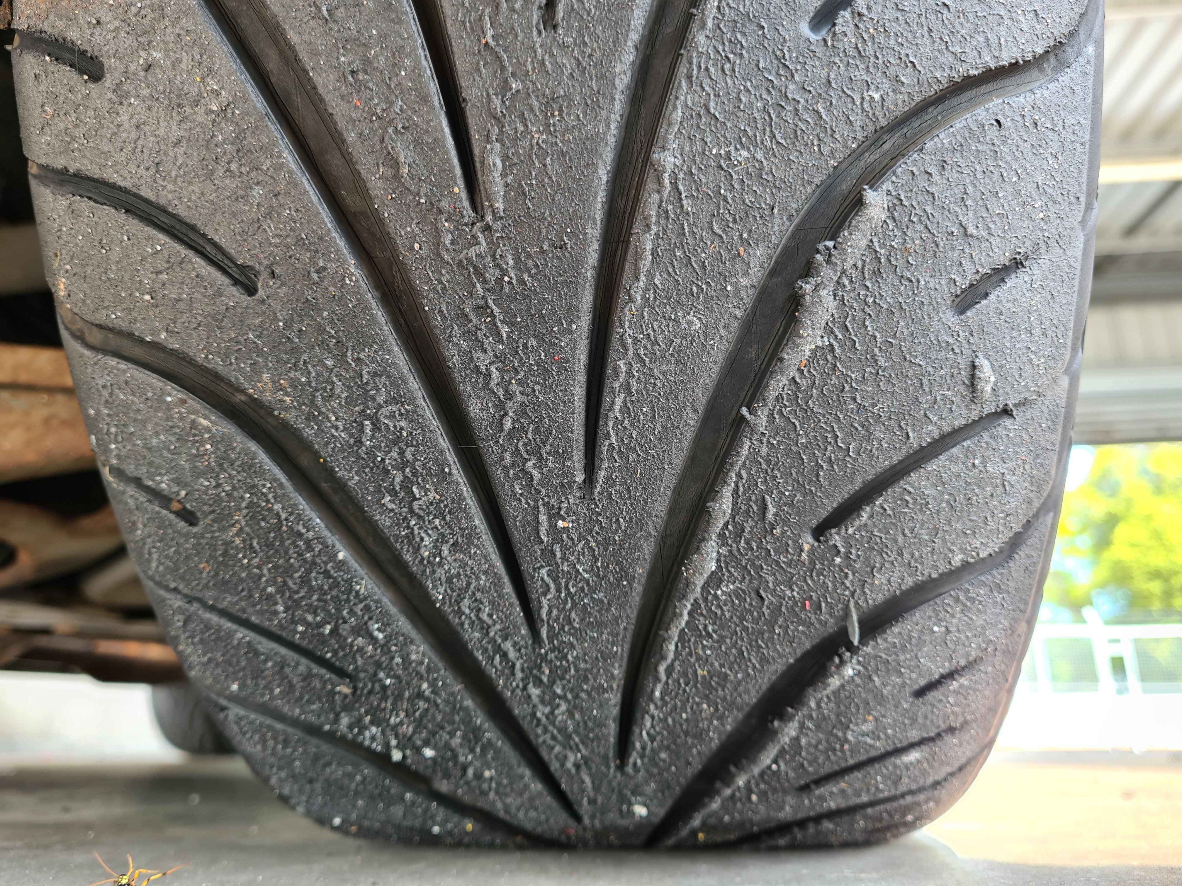

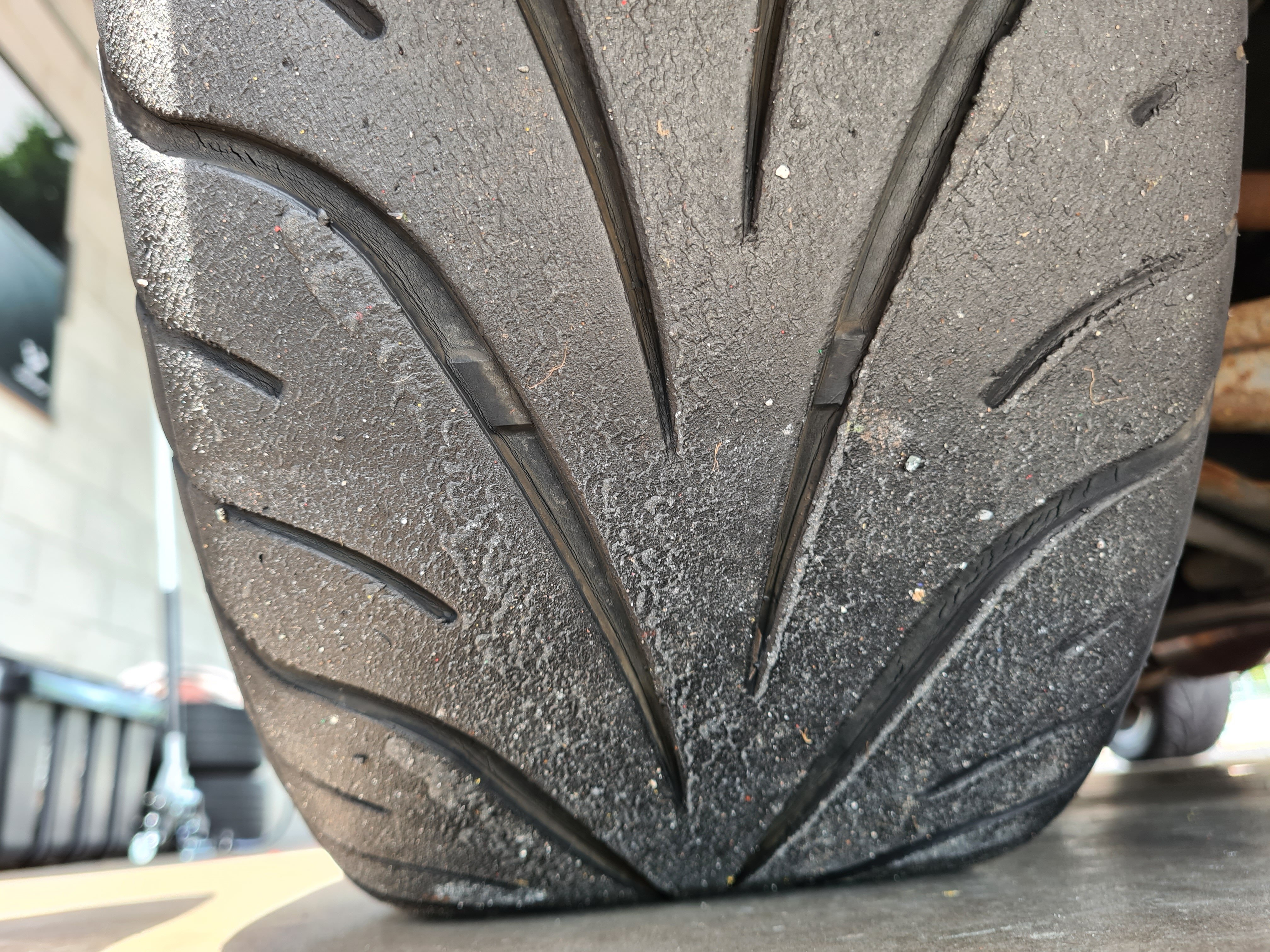

Had a track day at Oulton last Thursday, first dry track day I've had and it was brilliant!
Car felt great, but I noticed that after a couple of hard laps the rear started to get a bit loose/floaty.
They are old budget tyres (2016 Federal 595 RSR), car is running cup dampers with grams springs, PMS solid top mounts front, 20mm spacers front and PMS stub axle spacers in the rear. Also got a whiteline rear ARB set to hard.
Checked the tyres and the front seem to be wearing quite evenly, but the rears looked to overheat (?) on the inside.
Since fitting the stub axle spacers the rear camber is just over 2.
Worth bringing this back to 1.5 with shims or is this driving style related?
Fronts
Rears

Doesn't look too bad, rsr's aren't amazing tyres anyway, few laps and you'll find them dying off

What were the pressures doing ?
I tried keeping them around 30 psi hot for the front, 29 for the rear.
I have read that before, exactly my experience. Just like the shoulder wear on the front altough that might be due not running a lot of negative camber on the front (1 degree iirc).
Bluebeard
  Whichever has fuel
I run 30 hot in the front and 40 hot in the rear.
(My car weighs f**k all though?)
But my tyres wear the same way as yours, albeit I have MRF’s.
As Kyle said, just rotate them to get your money’s worth.

Just looks like rubber pickup to me on the rears. It usually pings off into the arches with a few road miles

And most of the rubber deposits did fly off driving back home so maybe it was just due to the tyres themselves rather than external factors.

As above those tyres look fine!
I think there must be as many different opinions and experiences of track tyres as there are track cars and race track combinations!
Personally I have found the car work best for me if the rears are higher pressure, harder compound or stiffer dampers, and the fronts are softer.
So completely the opposite to a previous post, but both could be right for the car, track and driver combo.
My experience is mainly at a tight track with an abrasive surface. The rears are a bit too skippy for the first couple of laps but then they heat up to a point where they have some bite, but still allows the car to rotate into the corners.
This has worked out quite well as I can use crappy old hard tyres on the rear, and adjust the dampers and pressures accordingly.
I've got some of my best lap times with Federal 595s that look worse than yours, and newish AR-1s on the front.
It is always the fronts that give up grip first as the day goes on.
With regard to 40psi at the rear there are 3 Saxos I race with that run 40psi at the rear. They are about as heavy as a bag of crisps but go really well!
It's all so confusing!:confused:
Rears look fine, the inner wear on the fronts looks toe out related or under inflated tyres, or a mixture of both. Not enough camber to cause that much wear really.

Thanks guys, most of it has worn off after about 200 miles on the motorway as was suggested.
@JB21 geo setup does need a bit of work, but that's doe the future, works well enough but ideally I'd like camber/caster adjustment and sort the rear out with shims.
