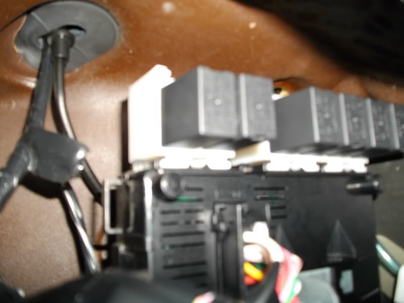

I know the problem this guy was having has been sorted, but i wouldn't mind know how to access the uch relays?, because my central locking is playing up a treat and this would seem a simple fix if it was something up with the relays?
Thanks
Chris
13mm bolt below left of glovebox then pull the fuse box cover off a couple of torx screws a torch is a big help relays are attached to the rear of the uch try n do it without removing uch some nice upside down on your back not good.
Have fun.
i did not have to remove the cover, the relays were at the back of the box on a white plastic strip. just pushed one fully home and problem was sorted, i dont no if the cover was missing or not lol.

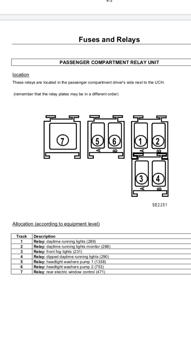

Handy thread- hopefully this could p0int me in the direction of resolving a windscreen wiper problem (Doesn't return to park at base of screen)
Looks like the relays can be got at and swapped?
^ ^ ^ Its front wipers I need, and that diagram shows DRL's which a phase 1 doesn't have
Will get to bottom of it, by removing the relays 1 by 1 until the wipers dont work at all
Says according to equipment levels. So regardless of DRL’s , you’ll not get specific info and diagrams .
