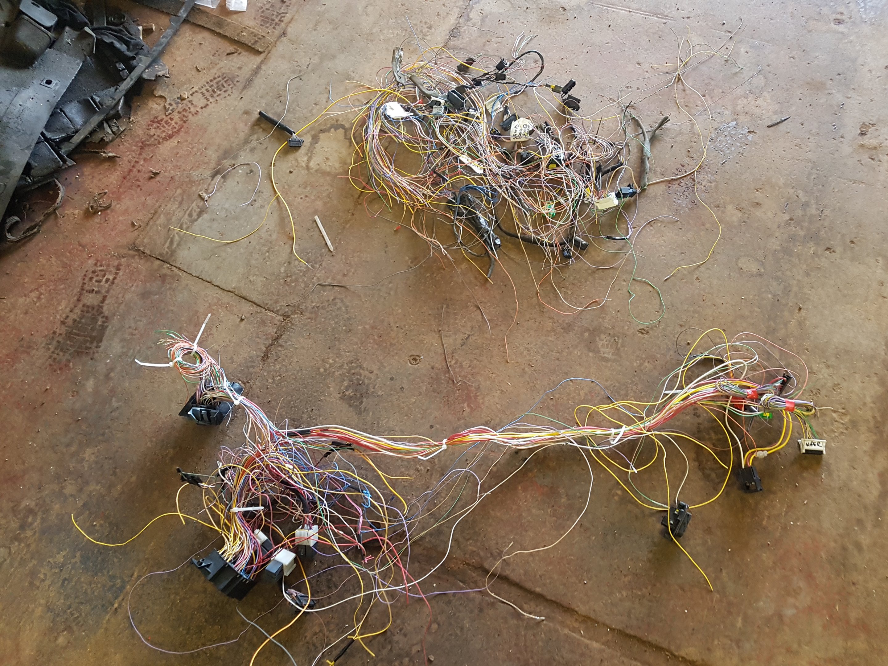

I'm goimg through s loom at the mo to try and do a guide to binning the much and how to build one up using as much of the existing loom as possible.

Not touched it for a while sorry. Ha e got a loom out and stripped but just need a couple of days to sit down with it and start sorting through what's what with it. Might bring it home over Christmas and faff with it then.

The small mound is what's been cut out so far, the other bit is the remainder of the original loom from drivers door pillar to bulkhead connector, fuse box and rear section connector on the passengers side.
The plan will be for the fuse box and relays to go and be replaced with a universal setup.

i knocked it on the head in the end, for the time involved in doing it and then dealing with the existing connectors and sorting them out it wouldn't be cost effective. got three cars to do and they are all going for cartek pdp, just managed to sort good prices out on them. cost of the unit will be offset in the time saved to wire a car up from scratch.
Don't blame you... Lol for the time it'd take it's not worth it like you say
