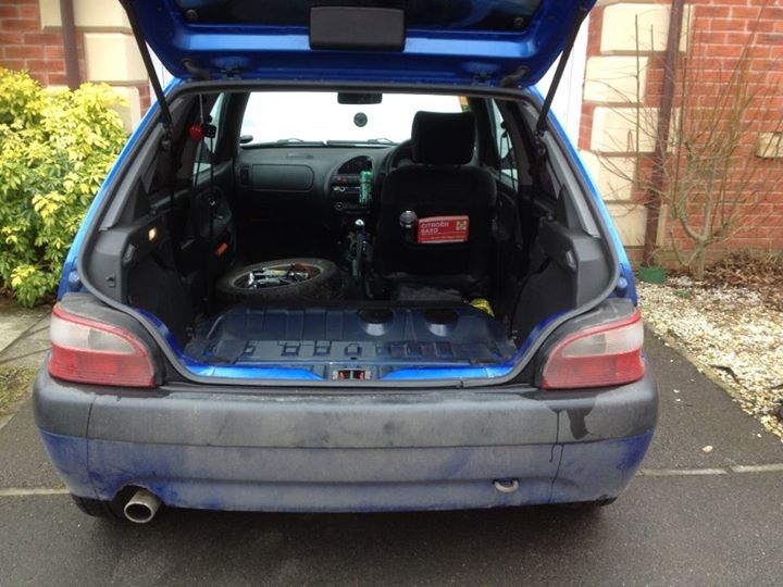

Here's my daily saxo (other car) when I took it to santa pod. There was a bucket seat fitted at the time though.. It snowed so there was no drag strip action :(
  Fiesta ST Stage 3
I had the Saxo in the pic for a bit but it was too harsh for me .

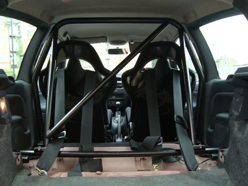

The seatbelt rear mounting points will not be able to withstand the excessive loads if there is a roll or side impact.
Besides that, even if we assume that these in one way or another could be safe you would need to weld metal plates to the mounting holes.
The cheapest 6 point bolt in (Msa/Fia) approved roll cage with the additional plates underneath welded to the shell to spread the loads would be million times safer and would add the shell a significan amount of stifness to have a nice base for your suspension set up.

Yup, im well aware of all of that, but you cant just unbolt a welded in cage & return your car to standard in 20 mins though can you ... It did the job i wanted. If the car somehow ended up on its roof, id still have my head (no ducking with fixed buckets/harnesses lol).
Any further questions, ask Caged and/or MSV.

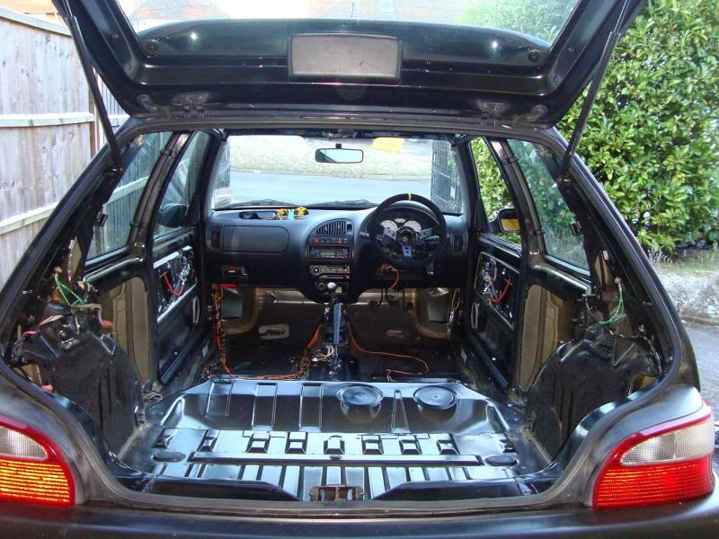

I managed to remove 55kg just in unwanted metal and underseal from the car i won't lie it was a pain in the arse to remove the and taken me about a month or a little bit more just on the underseal but it's completely worth it.
Other things i've stripped are carbon canister/air-con/heater matrix/radiator/power steering/complete interior inc dash/glass/fuel tank/battery and a few other bits i've probably missed.
Most of the above i've replaced with lighter-weigh versions but still haven't had it weighed untill it's up and running.

As Caged make FIA/MSA cages all the time to a very high standard , along with caterham chassis ,and the new titanium atom chassis they have just built, i would suggest that Phil@Caged knows more than a thing or to about designing, stress testing and building cages.
I know this having personally worked with him on a cage project for Westfield's when i got the first designs implemented and built.
Caged don't produce unsafe crap , the MSV cage would not have been designed to be a full weld in cage for their own reasons but certainly would have been perfectly safe, i am sure MSV were only 2 sure about the consequences of a public liability claim after an incident in one of their cars .
  172 rag
Fair points all that you raised and my intention was not to try and disrepute a company's work but I still wouldnt feel safe in one of those. I still consider the rear mounting system if not s**t as I said before not adequate for track use.
As I said if the driver feels safe its fine by me.
