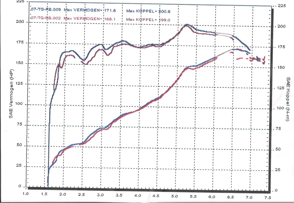

171,6 at the WHEELS , throw an equation of 15% transmission-loss on there and you'll get a very healthy power. More likely is 12% loss though

lol i was just Google-ing to find out how wheelpower measures up to flywheelpower and found this link; it's good for pub-talk haha, made me happy anyway..
http://www.pumaracing.co.uk/coastdwn.htm
it seems mine is making 201,7 with the above mentioned C&B cams, matched inlets, exhaust manifold+decat + modified airintake (made 171,6 wheelpower, Fastchip RR result)
So, if your engine is a good 'un , nice and loose, high power is possible with cams and mods to match these
