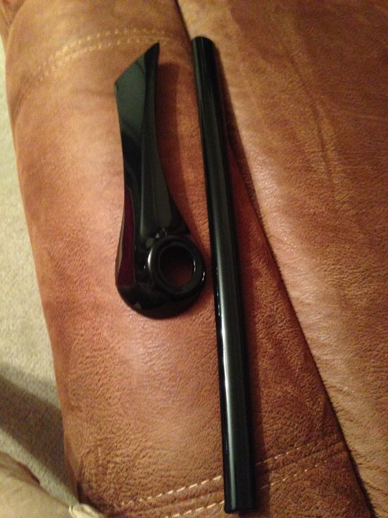

I'm away to try black on the handles in plasti dip and the diamonds and see how that looks on this thing as I don't want the expense of paint for side strips going UR.

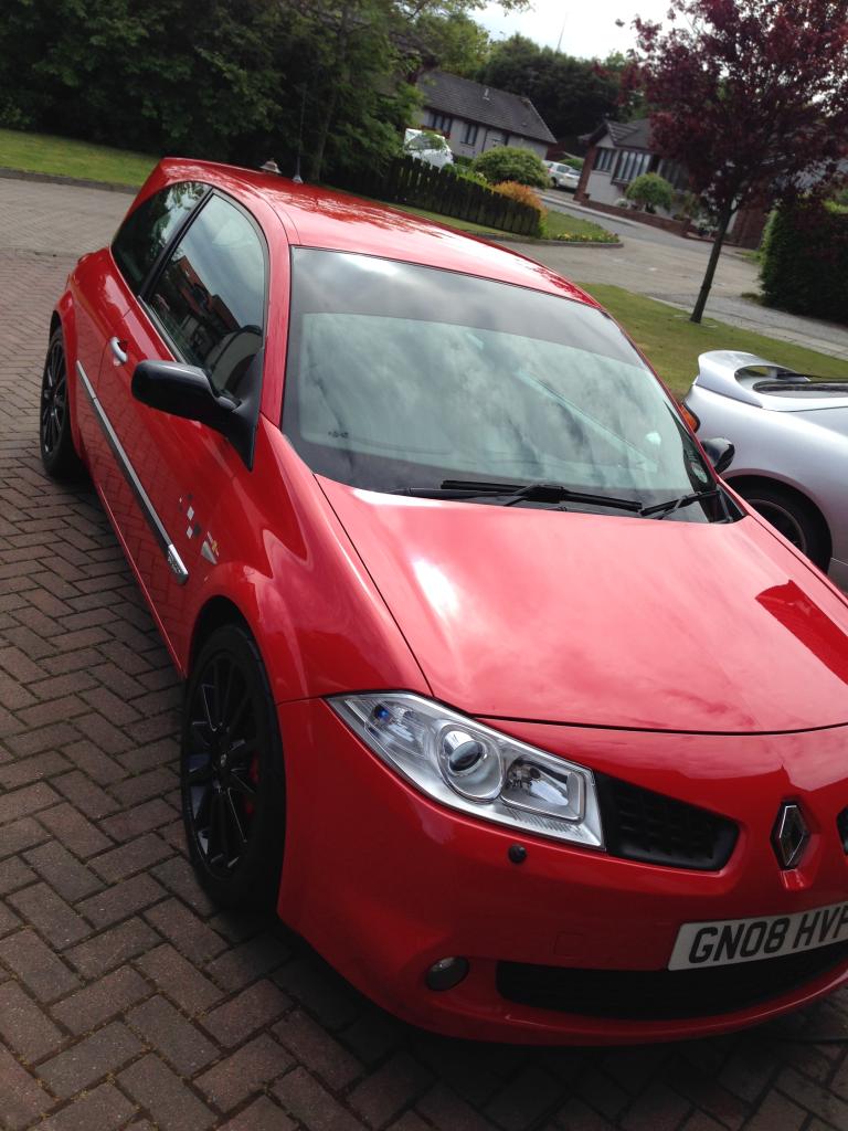

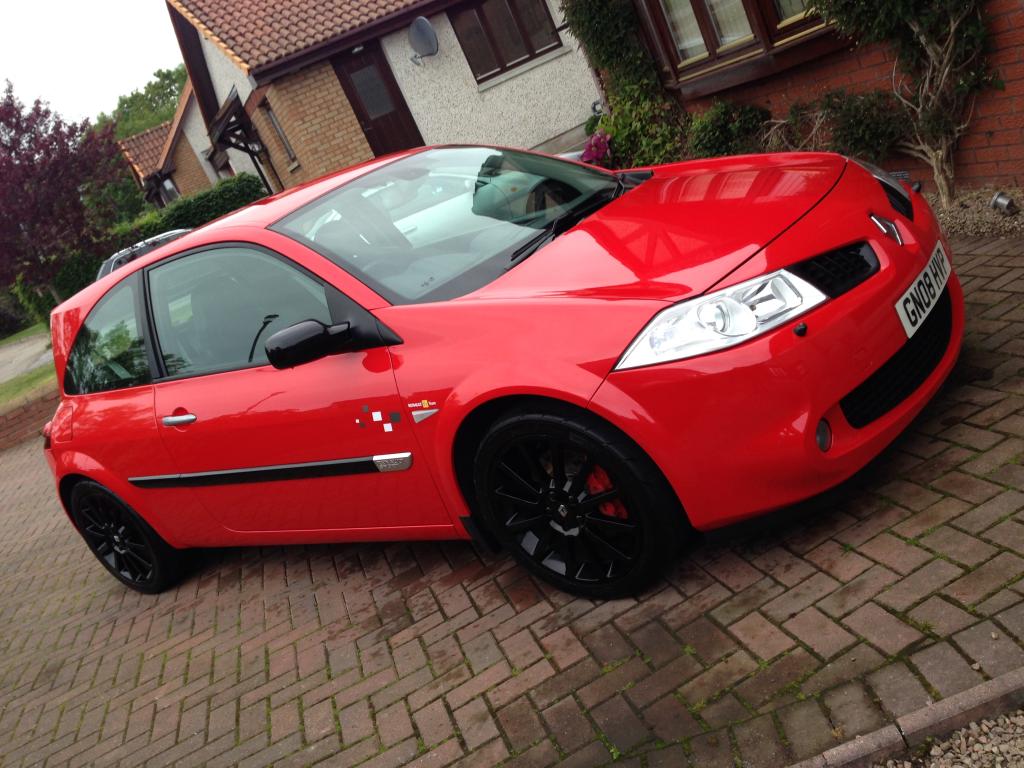

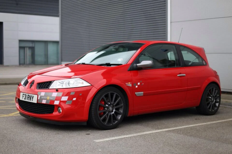

Here's mine as it stands, missing a front diamond, but a work in progress to make it mint. I'd like the darker headlights, but they can wait until everything else is sorted.

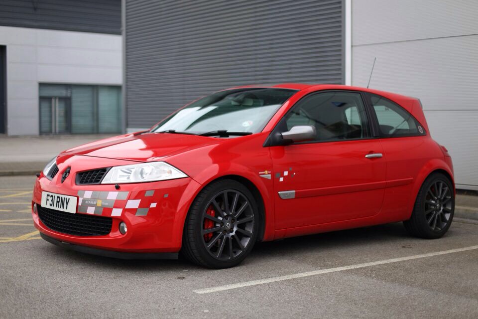

Very nice... Door handles red and that would be a perfect meg other than a white car with full decals and black pack.
Whats everyones thoughts on decals? With? Without? doors only? Bumpers only? If I keep this for any length of time i think I would be tempted to put on front and back bumper decals.

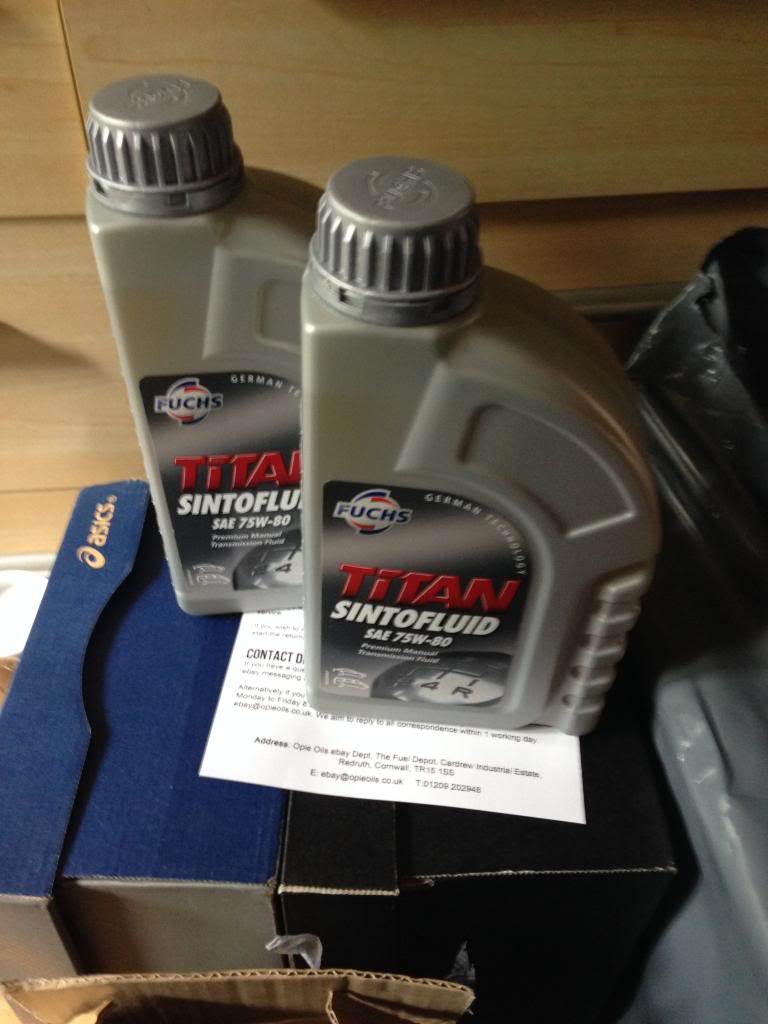

I went with Fuchs sintofluid for the g/box after hearing a few good reports.

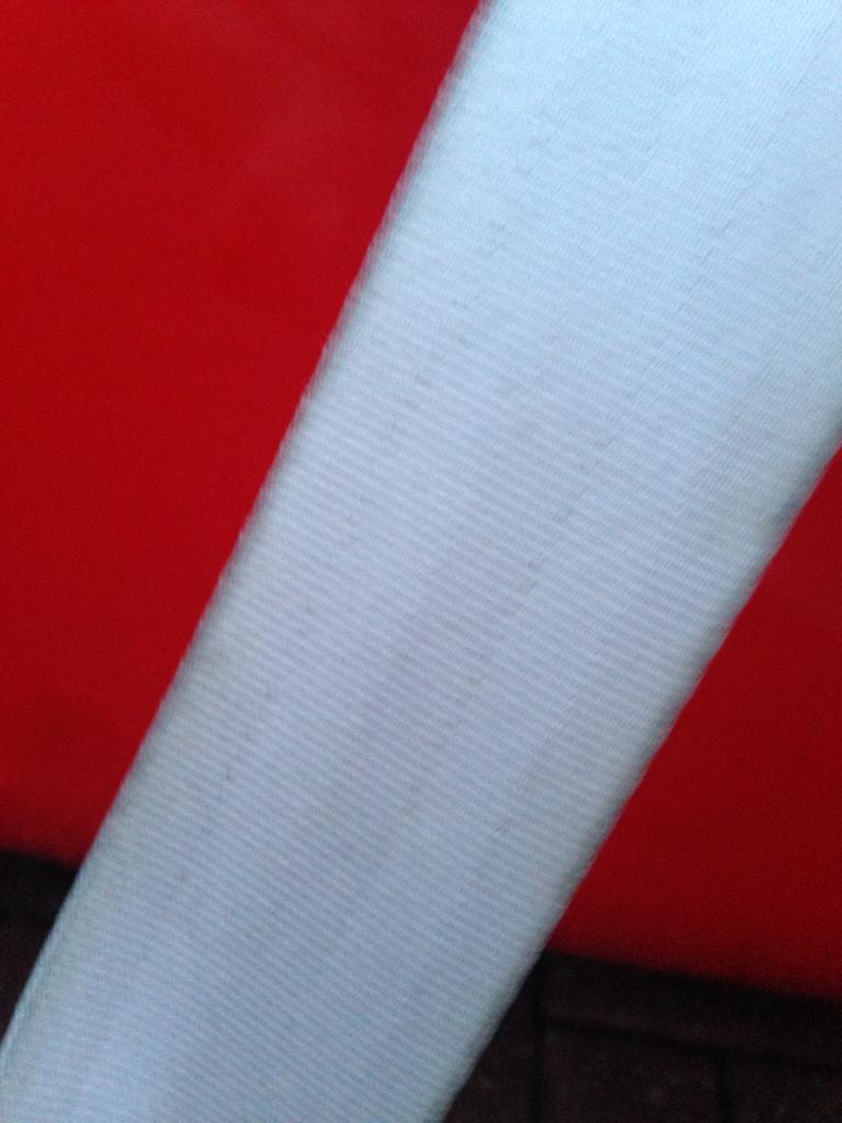

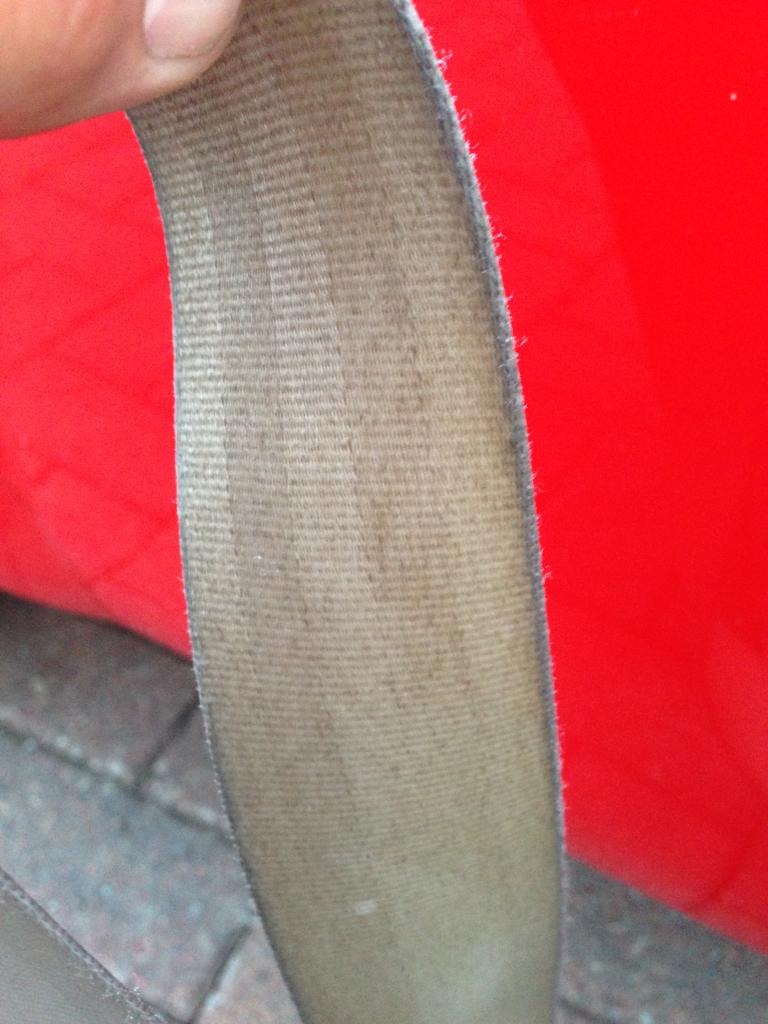

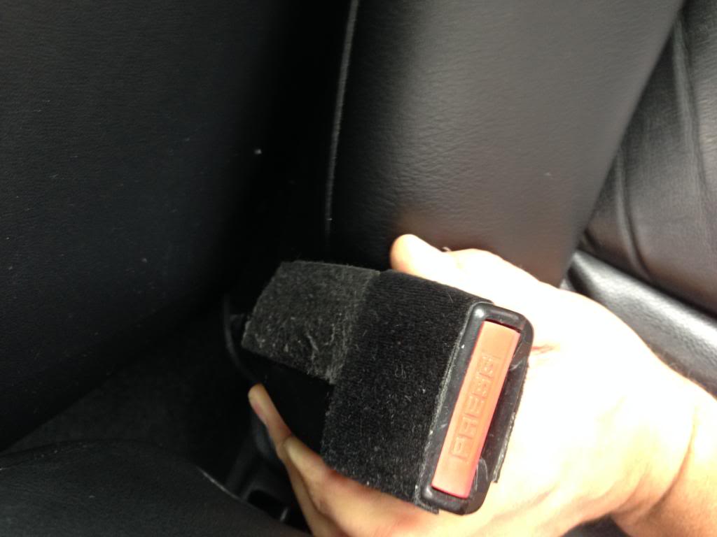

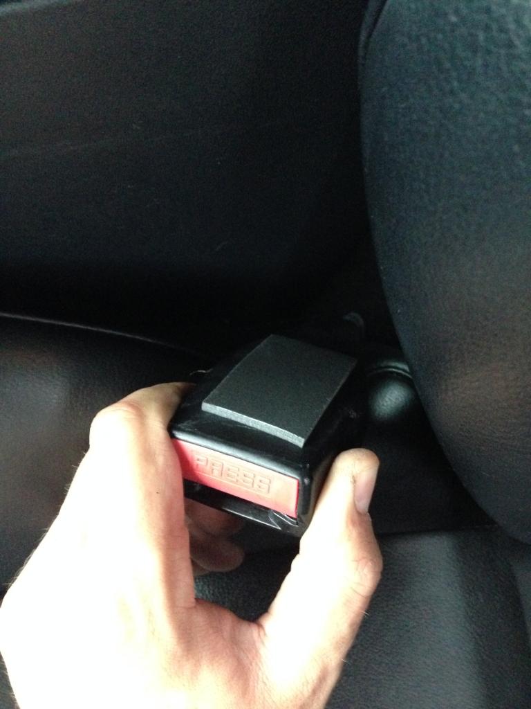

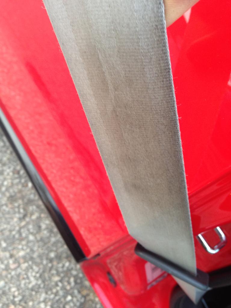

Im just away outside to tackle the minging seatbelts and a few marks on the headliner, pics to follow.

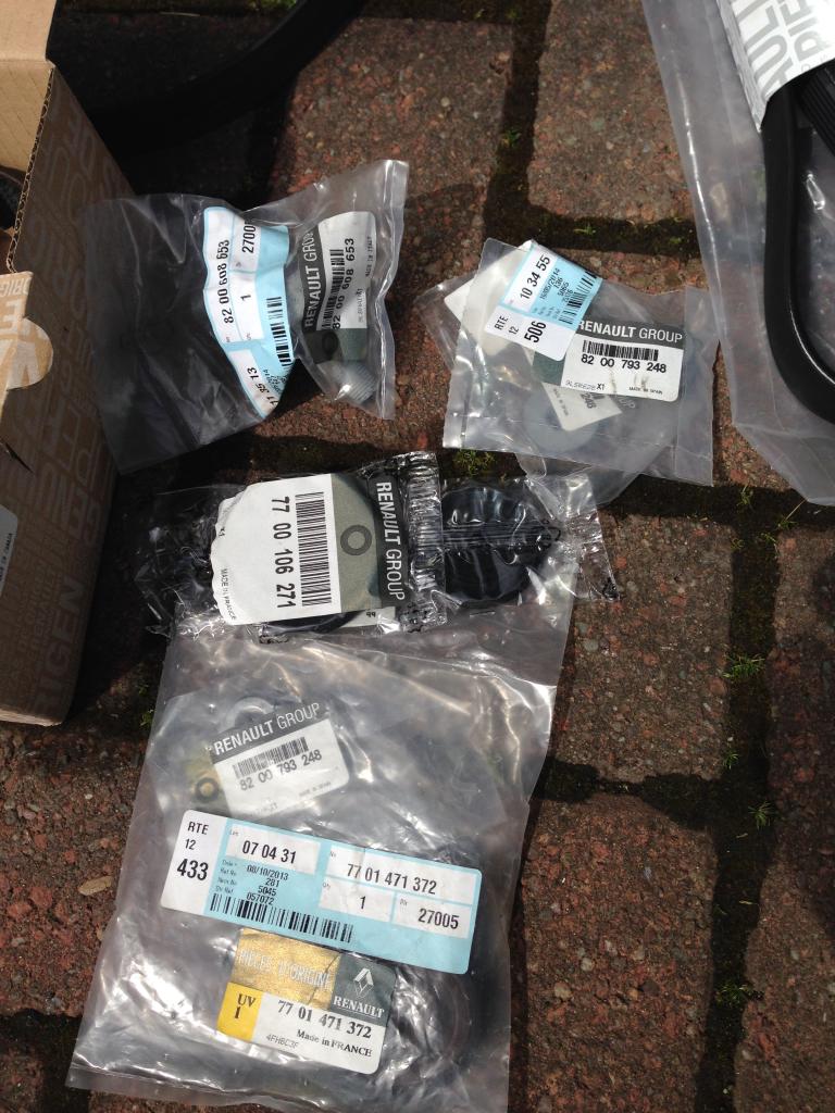

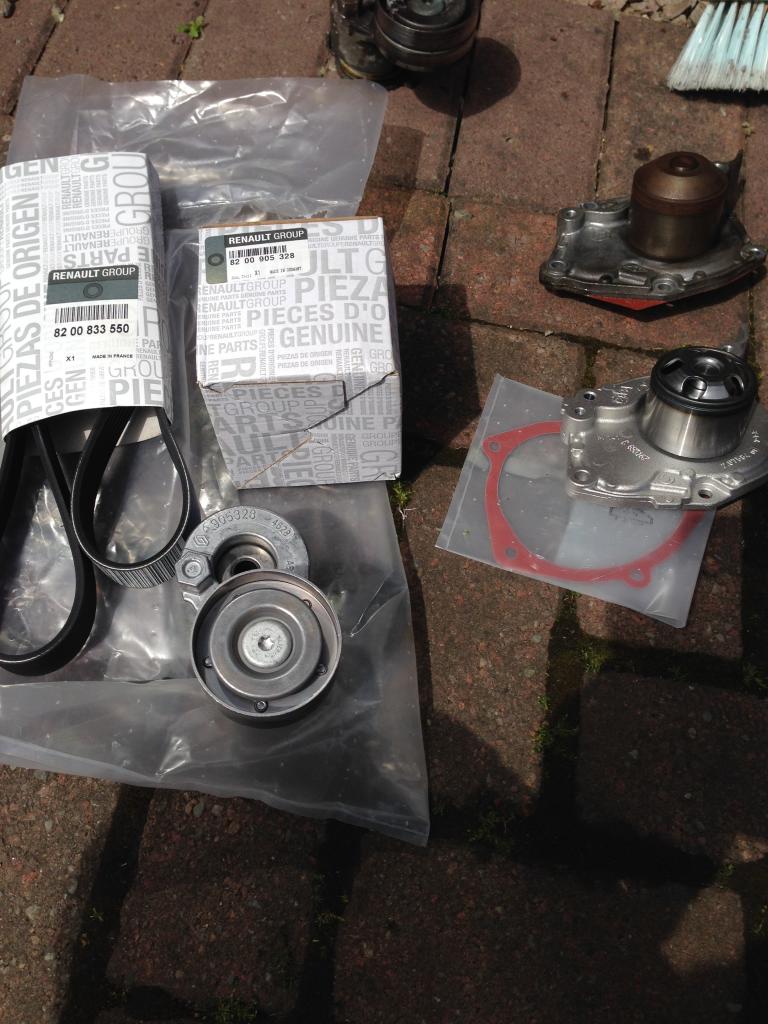

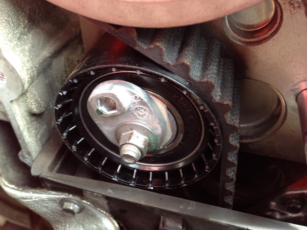

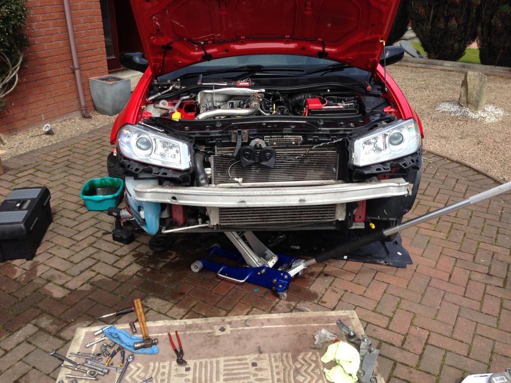

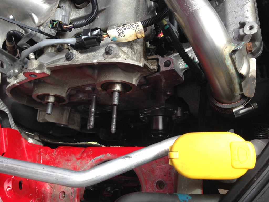

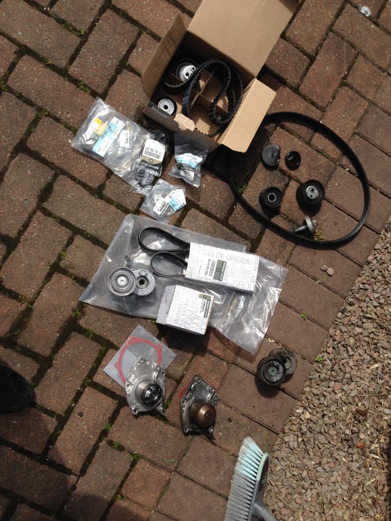

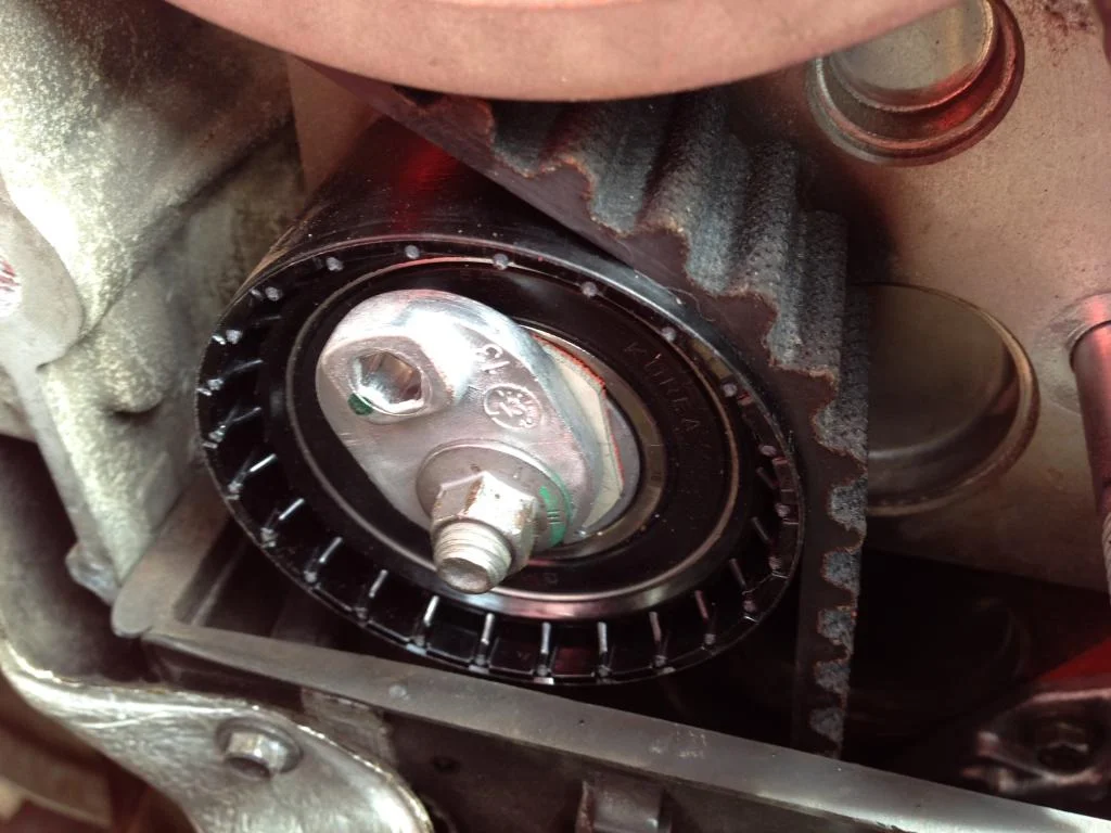

I received the parts to do the timing belt yesterday so I cracked on with that today.
Started by removing everything
Cleaned everything up
All genuine parts used. Timing belt/aux belt kits, water pump and all fixings.

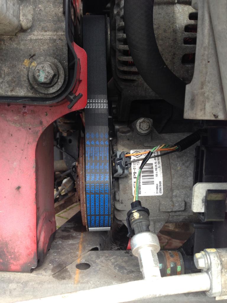

Refitted timing and aux setup using the property timing tools.

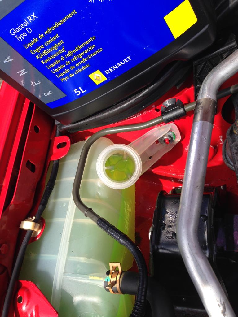

And finally topped up the coolant with some type d. I also changed out the box fluid that I received earlier in the week too.

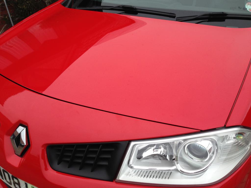

I managed to sort out the ridiculous bonnet gap too.

I had a spare hour tonight so I finally done the belts, they were proper minging in places.
Tada... G101 and a blast with the jet washer.

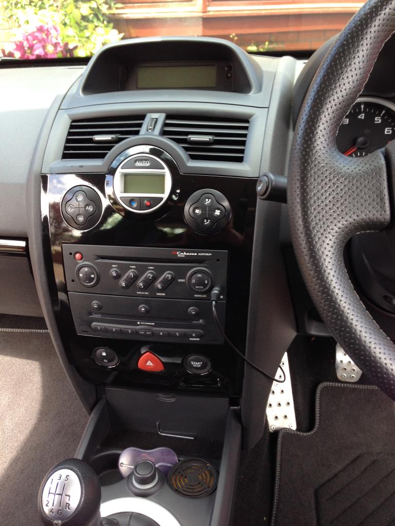

And I started to wrap the interior pieces. Just the centre console to do tomorrow and then fit my sun strip for the track night.
  Cup In bits

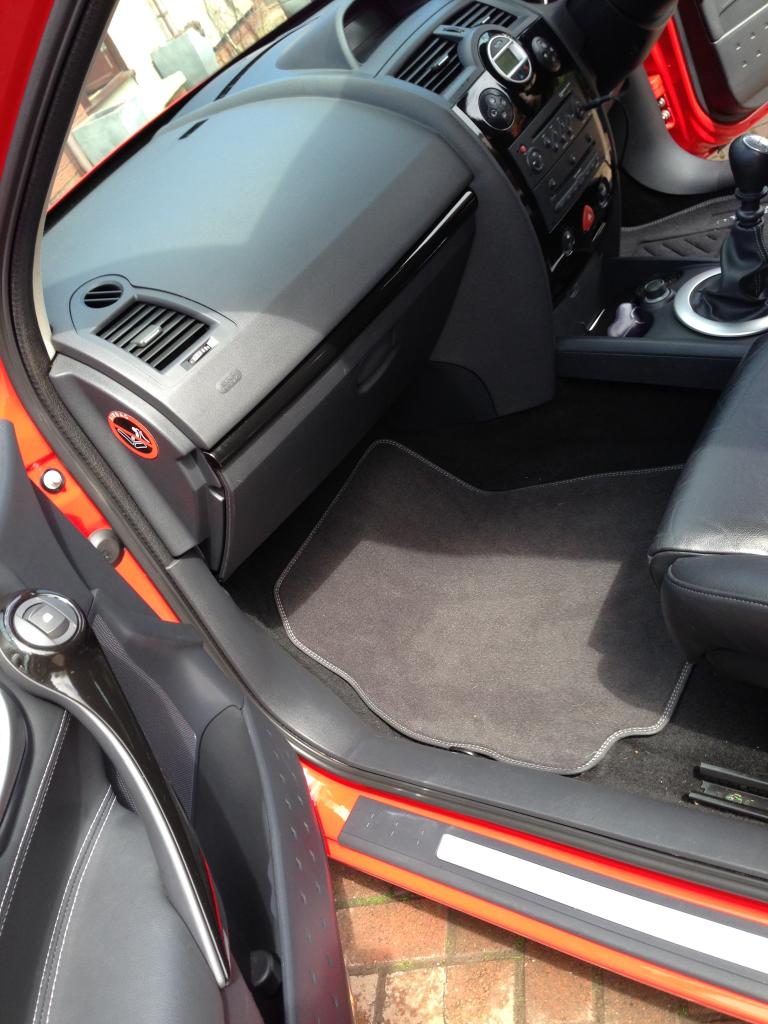

So I set about doing the remainder of the wrapping, namely the centre console and what an A hole that was. Turned out 'okay' in the end.
I fitted the others done last night too.

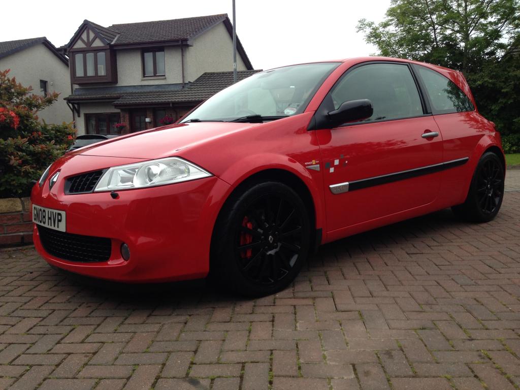

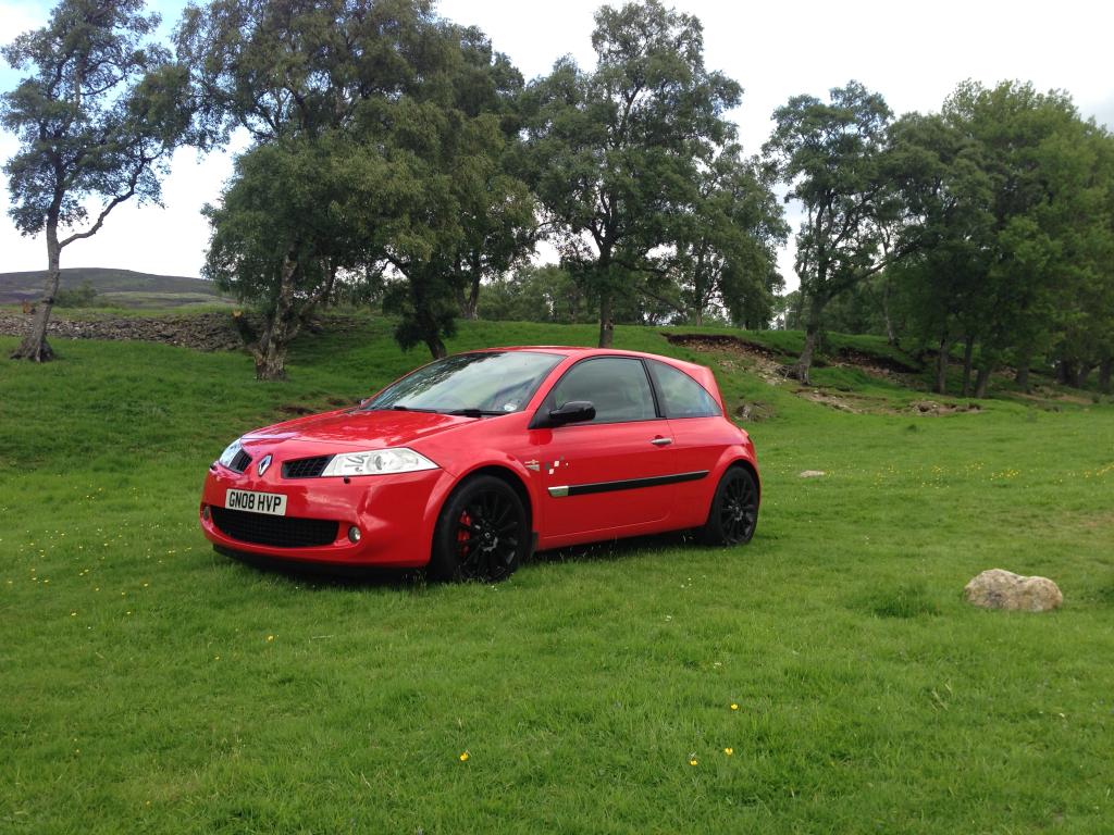

What's people's thoughts on the wheel colour? I'm going to have they refurbed as tbh they're annoying me and letting down a really good car.
Do I stay black being mindful that I'm not going to the expense if spraying the side strips and mirror covers?
OR??
In other news I have gathered everything to do the airbag repair for £66.48.
Simply because the other bits are black I'd just go black again. Would look a bit gash with anthracite wheels and black mirrors.

Yeah I think your right. I'm not even sure UR side strips, gun metal wheels and black mirrors would go if I was to paint. The black highlights are growing on me. Its what the general public think though.

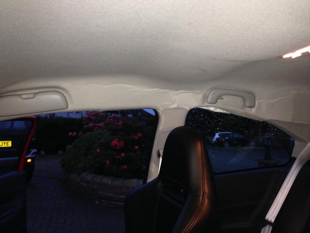

The roof lining is grand mate, its just the bag wrinkling it. Straightened most of it out tonight tucking away the airbag properly. On other cars I have used thinners on the backside which takes out creases if needed.

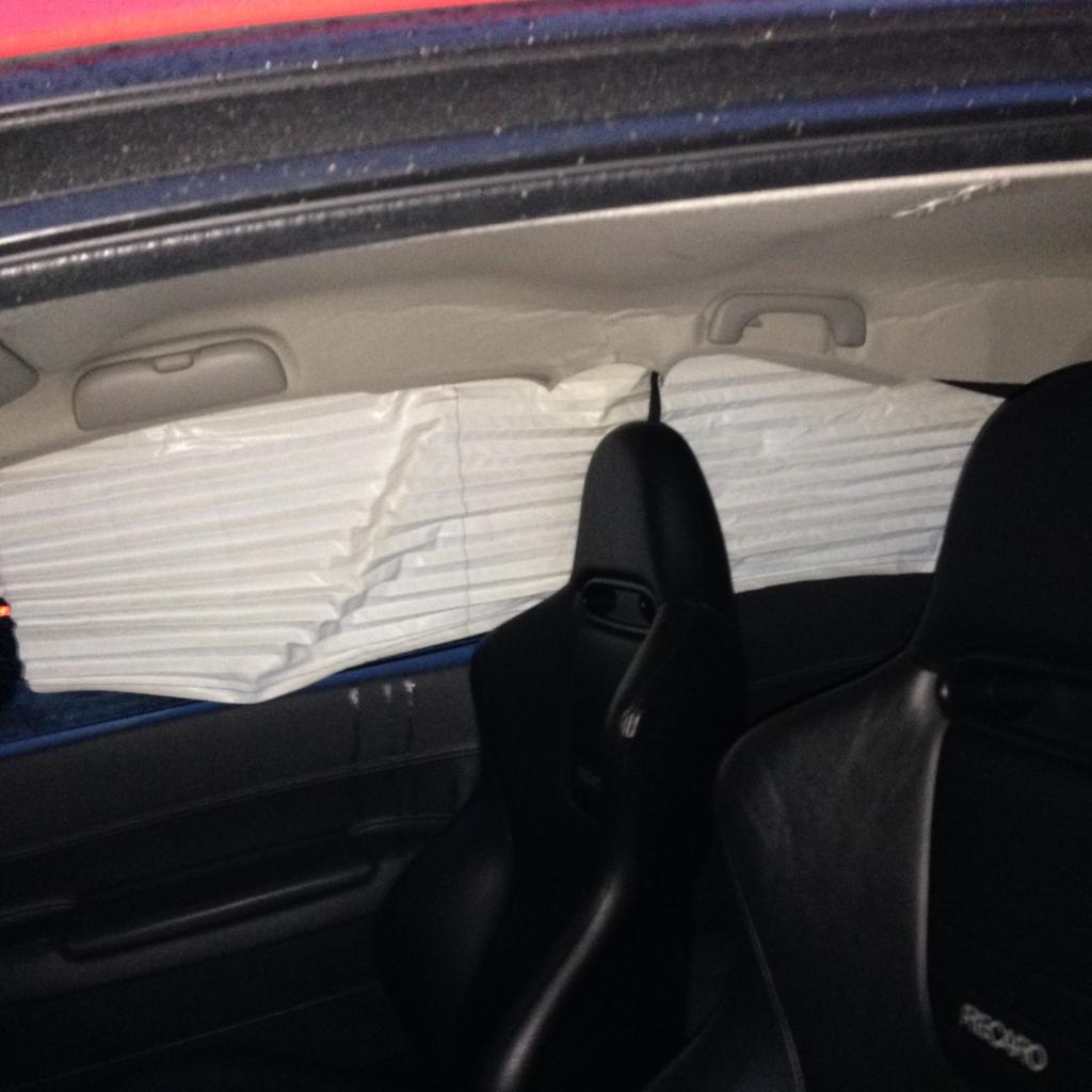

What on earth happened to make the airbags go off?
This
http://youtu.be/p1F35ZdpmFg

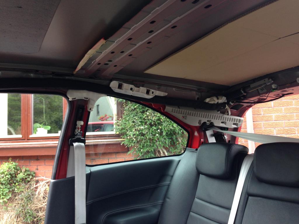

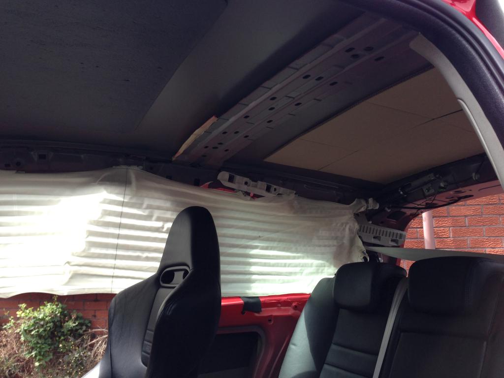

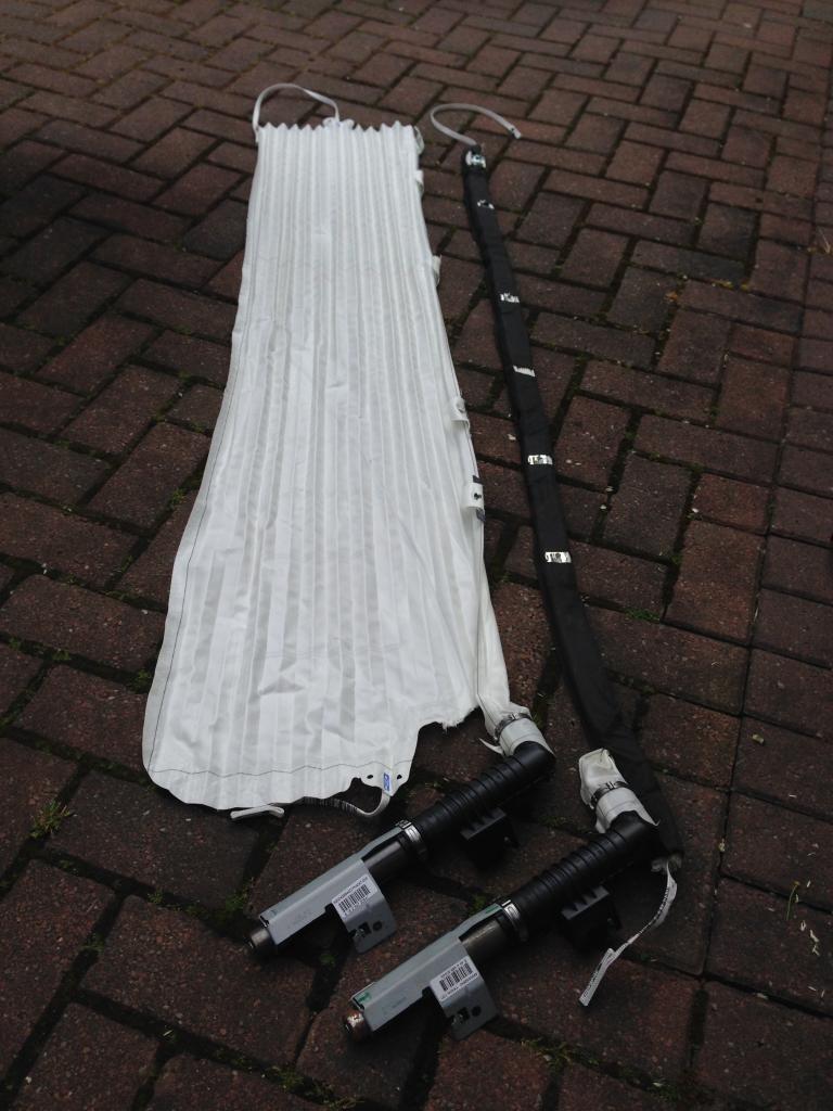

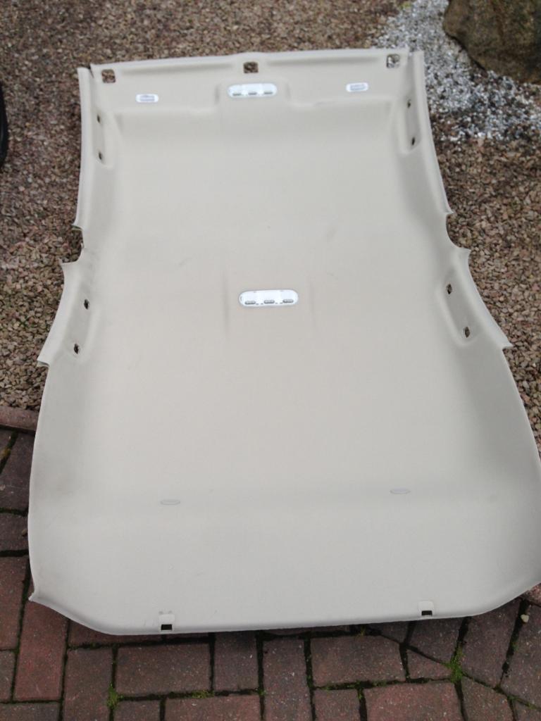

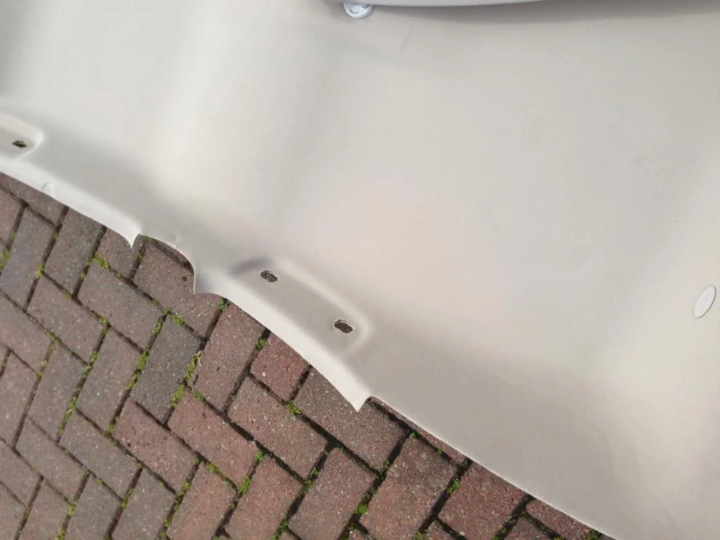

I made a start today on the airbag repair. First of all I pulled the head liner.

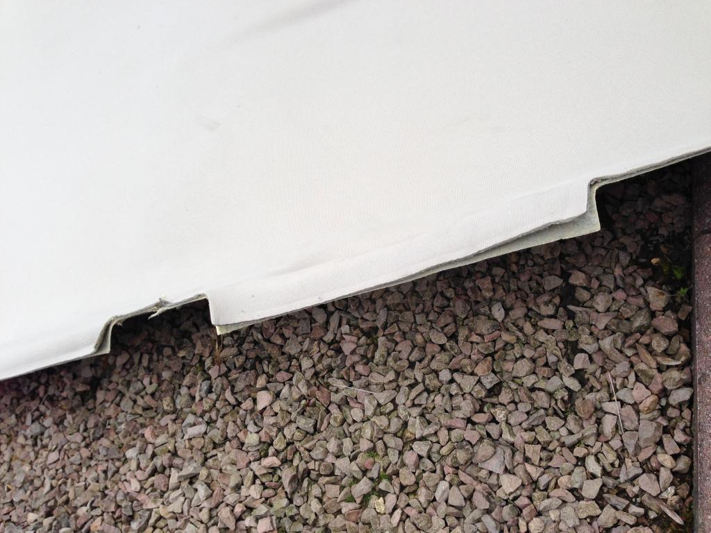

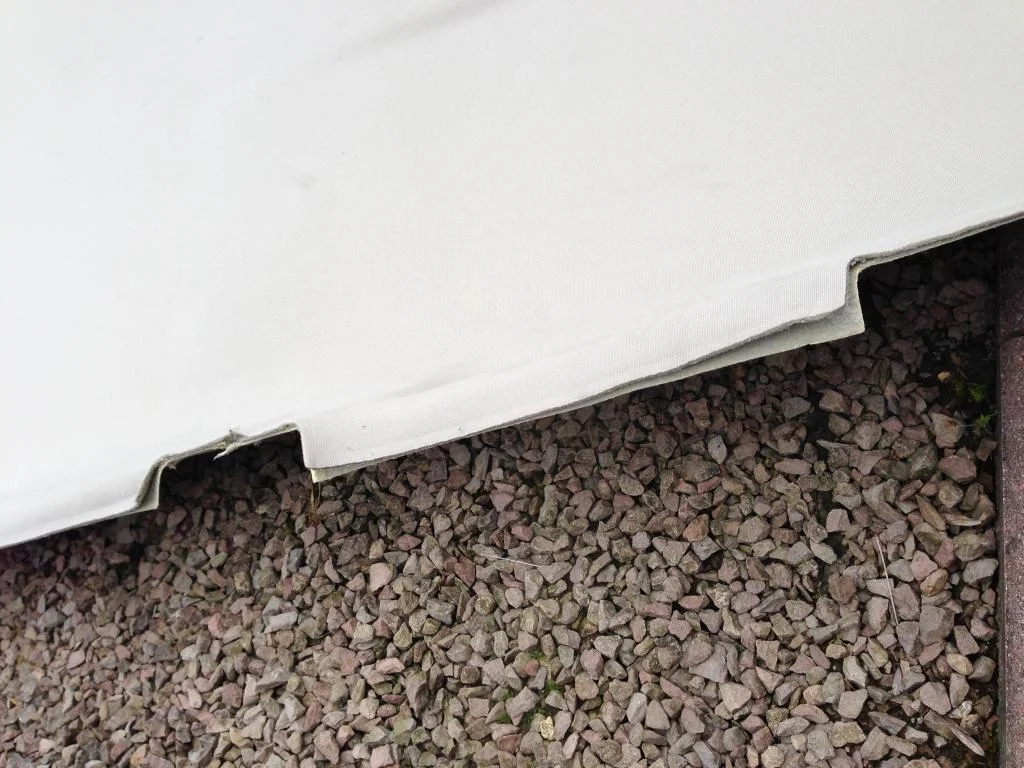

The damage caused to the headliner.
Repaired that.
Whipped out the airbag.
Replaced with like for like airbag.
Thoroughly cleaned the headliner and put everything back together. Looks brand new but I forgot to get a picture.

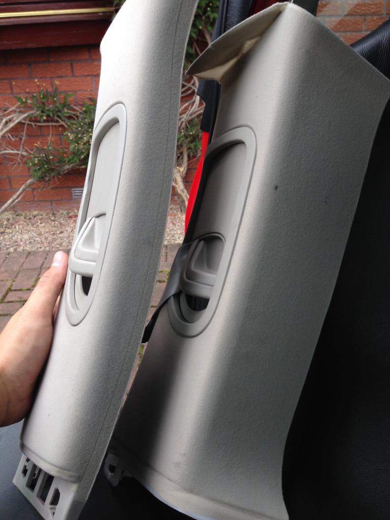

The wrong b pillar cover was sent to replace the damaged item, I will source another during the week. I also took the ECU out to be sent away for re programming.

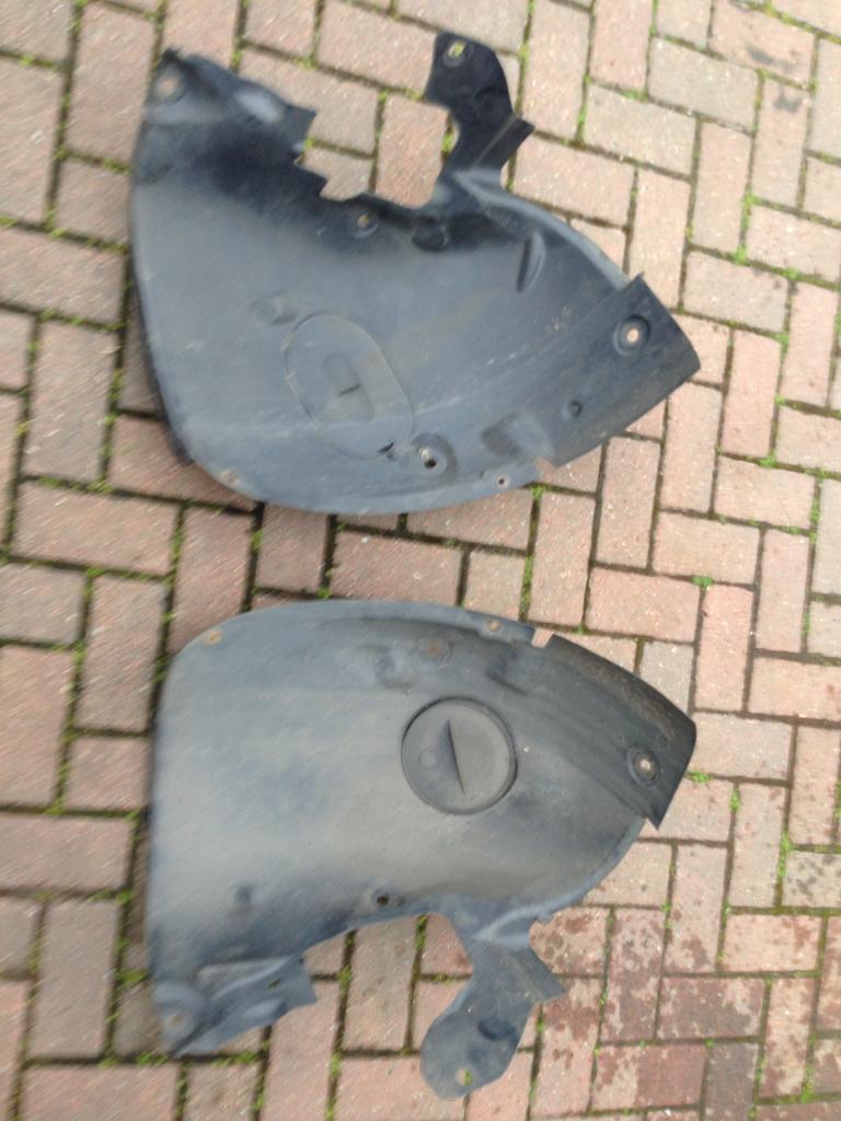

I bought some new arch liners tok as the tyres had rubbed on them while on track and lost the headlight access covers. Will get them done when the wheels go to be done.

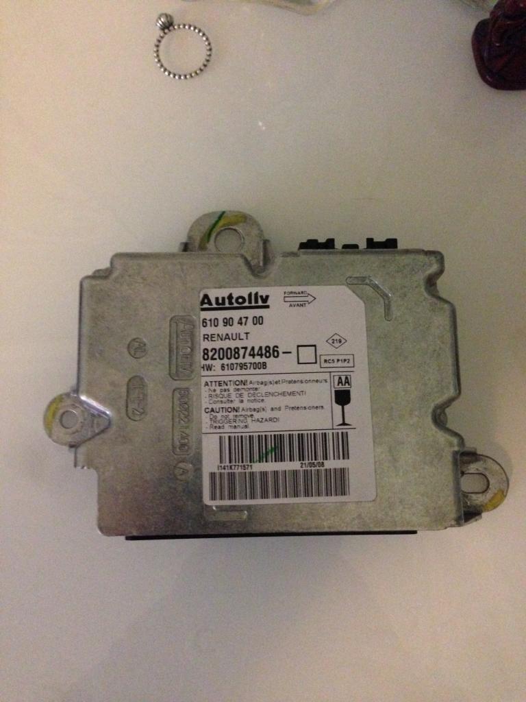

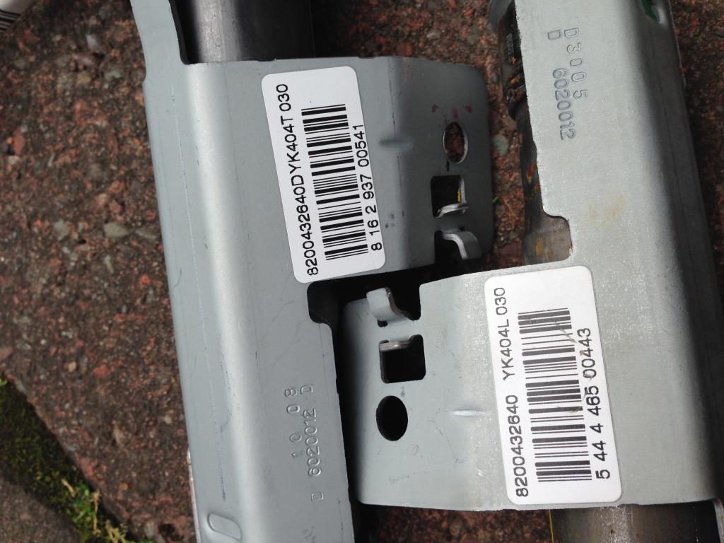

I got the Airbag ecu out to be sent away.

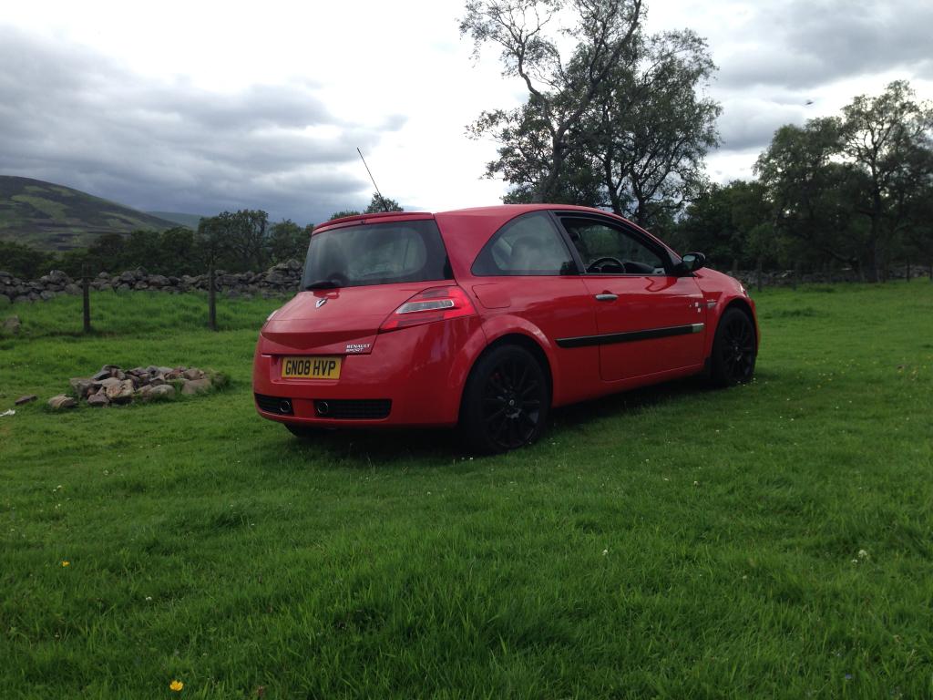

Me and a mate went scouting for a good camp spot the other night, took the chance to grab a couple of pics.
