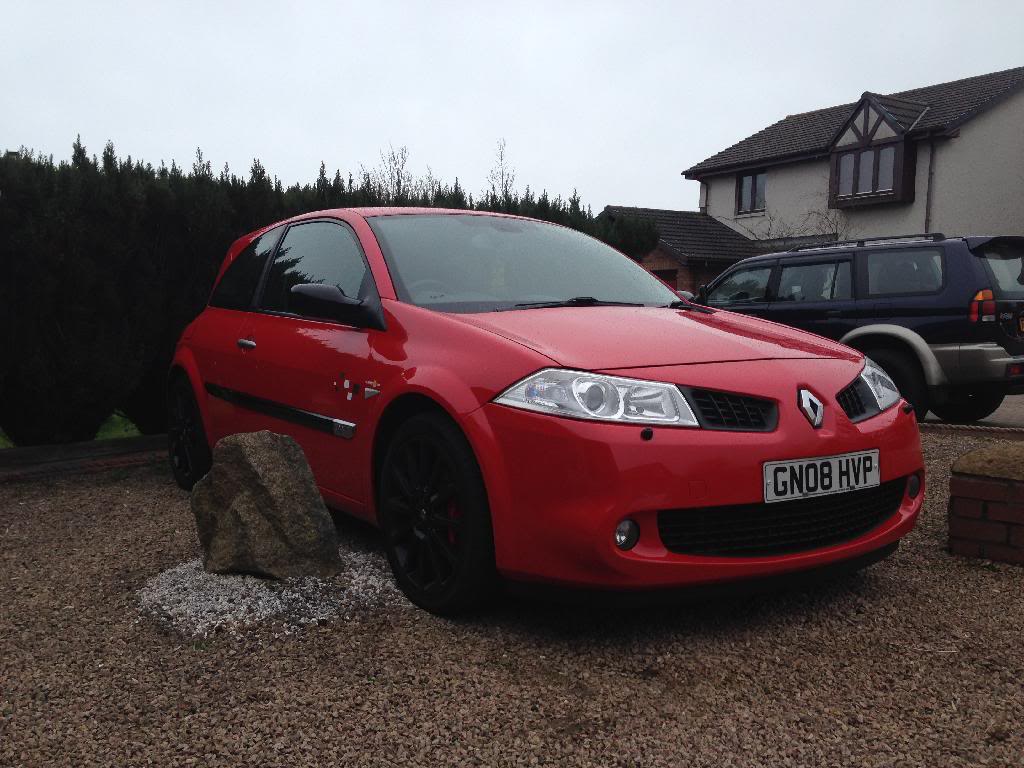

Well I thought I'd start a little progress thread to document the ongoings of my newly acquired R26 prior to its sale.
I got the car just over a month ago in a swap deal for my old ITB'd cup. I never/don't plan/ed to keep the car myself although I would like to bring the service history up to spec and give it a bit of TLC while in my ownership and get the use of it prior to sale.
The car has some history on here already and having spoke to the old owner I new it would need some work which doesn't bother me. It will be getting a full engine service including the all important timing belt, WP and aux kit. good quality tyres and new brakes all around plus the interior will be getting a tidy up.
The car is a nice example but it needs some TLC to make it a lovely car. The front and back bumpers need re hung which I'm told is a common on the Megs, then all the parts listed above and a set of new mats, reg plates and some of the silver interior highlights wrapped in piano black as I think its more suiting to the whole car.

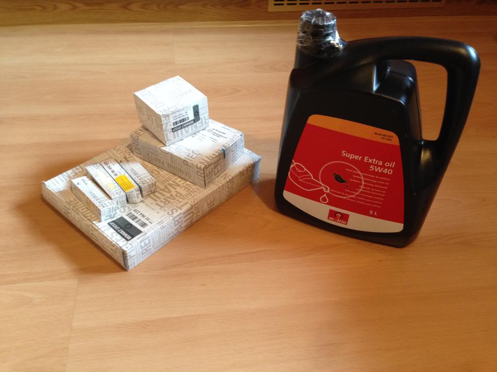

Genuine Renault service parts. Engine filter and oil, cabin filter and also spark plugs.

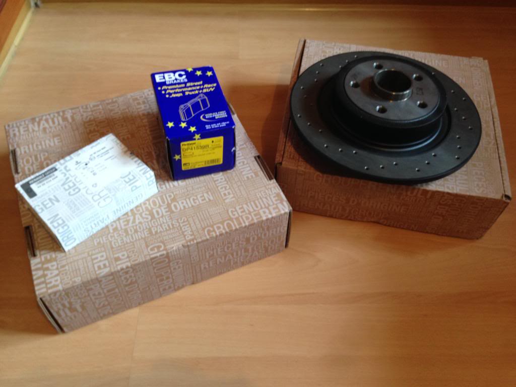

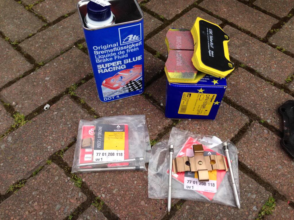

Genuine drilled rear discs and pads. The front discs are being sent for blasting/skimming and I'll get the yellow stuff pads fitted with a full fluid flush of ATE super blue.

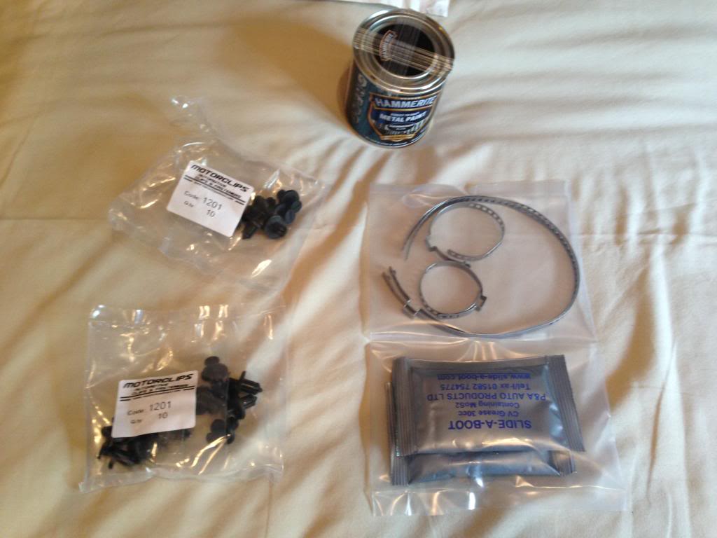

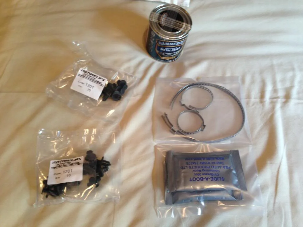

Some stainless steel CV boot clips to stop the common problem of the boots popping off. Bumper and engine cover clip's to remount/position everything as it should be. Also some hamerite to do all the mounting faces on the discs before fitting.

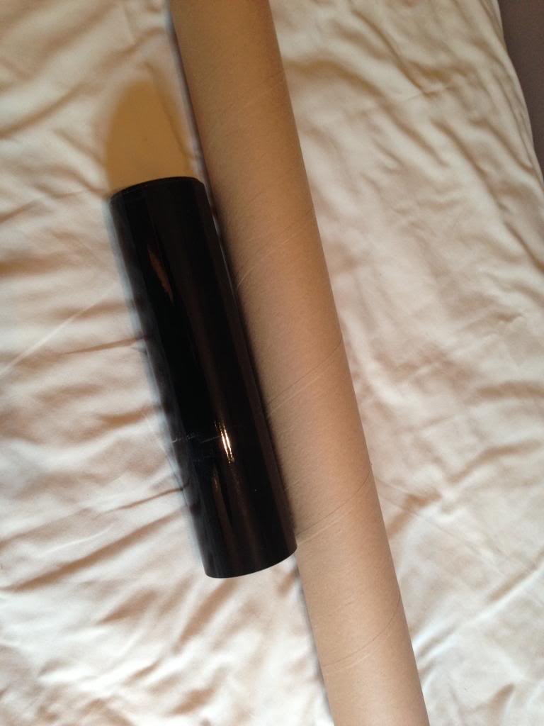

3m wrap for carrying the black highlight theme into the interior.

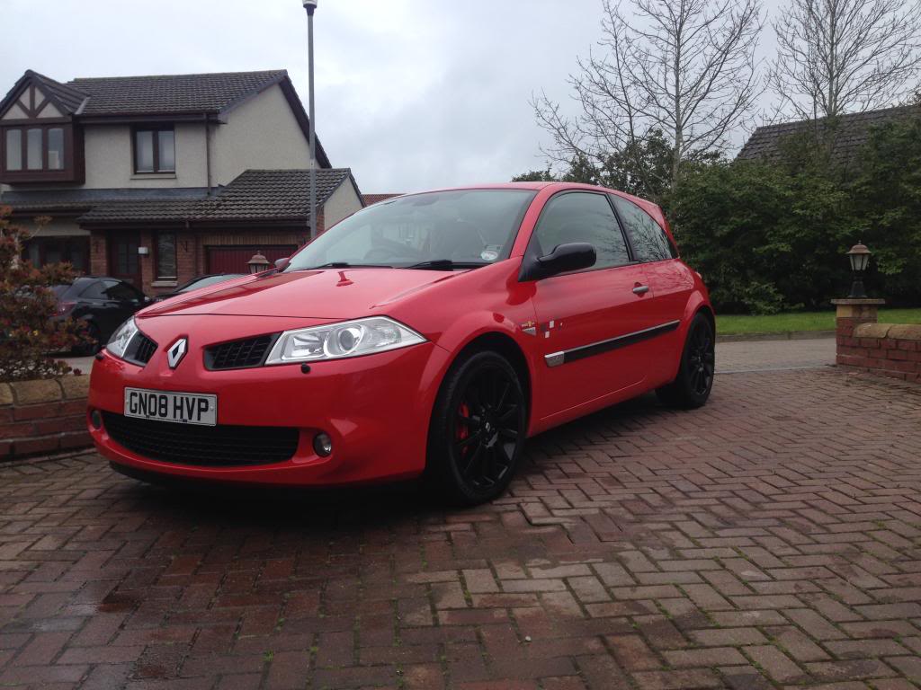

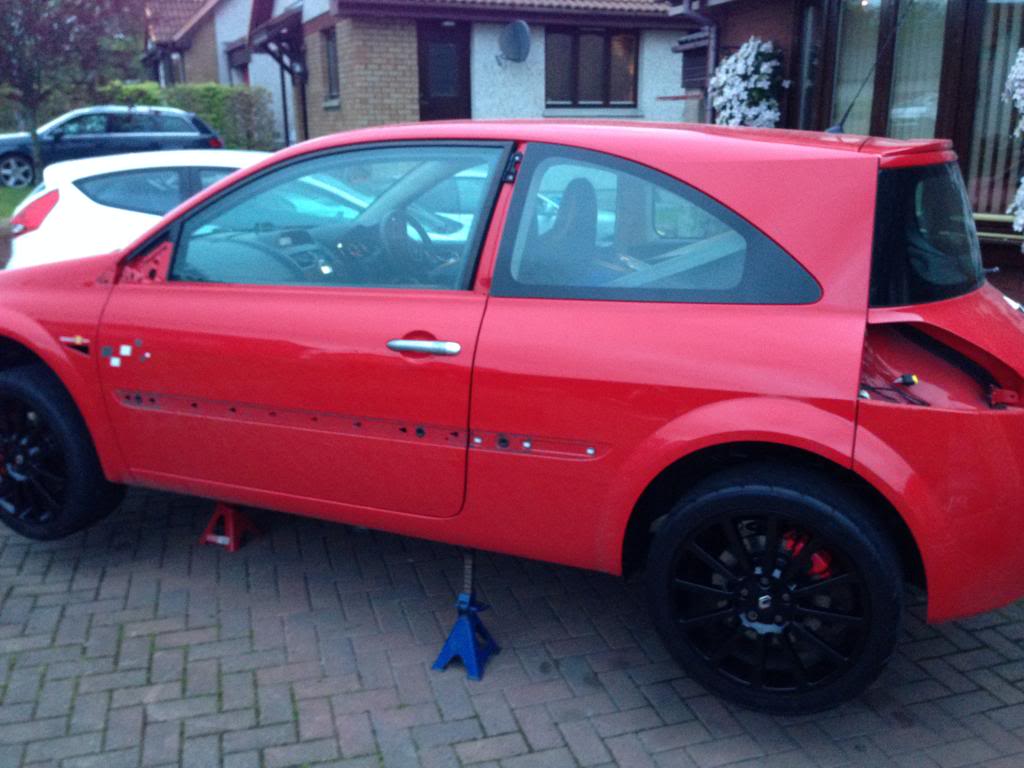

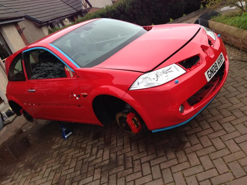

I started doing some of the jobs today with the parts I have.

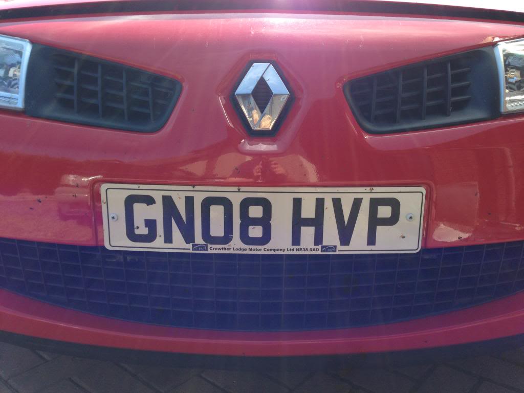

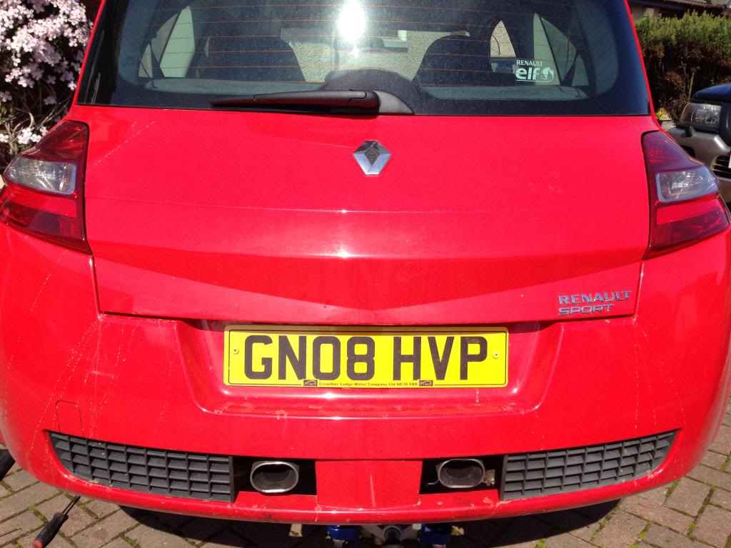

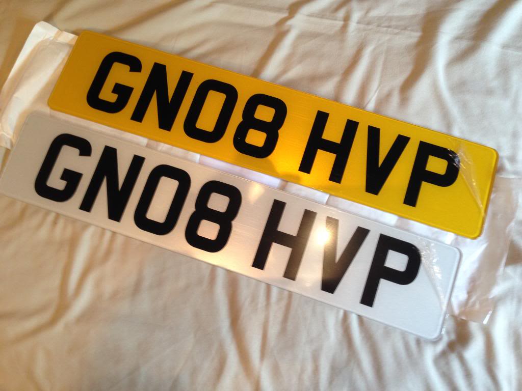

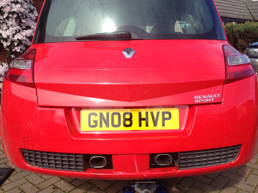

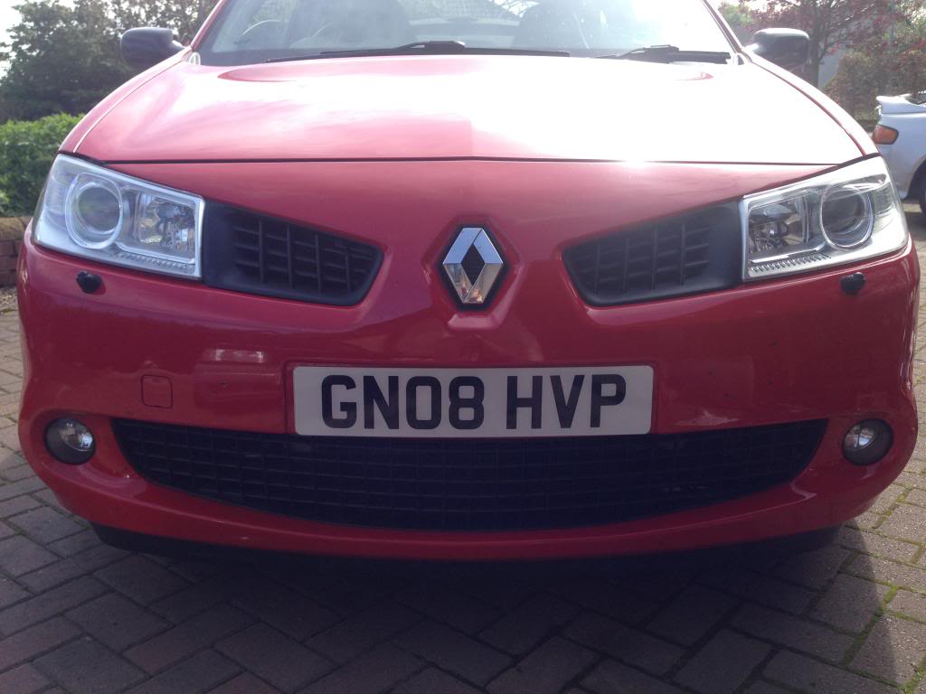

I removed the awful reg plates that were on and swapped them out for some custom fancy plates. I polished behind the recesses in preparation for its detail later in the week.

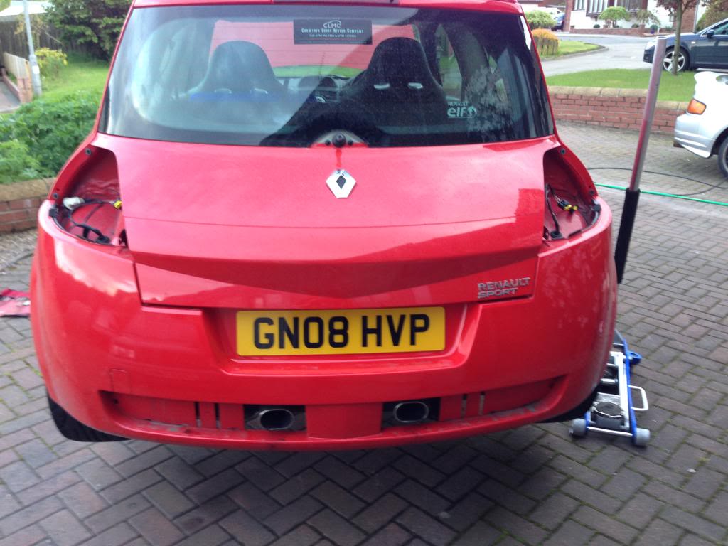

Rear
Front

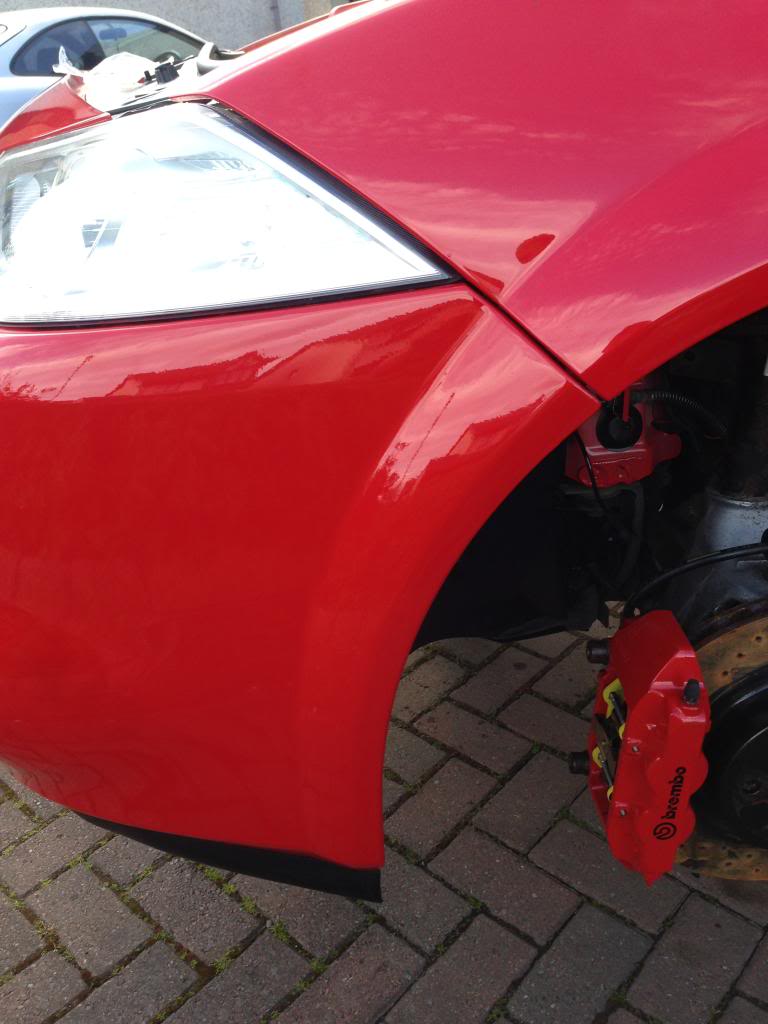

Looking much fresher already.

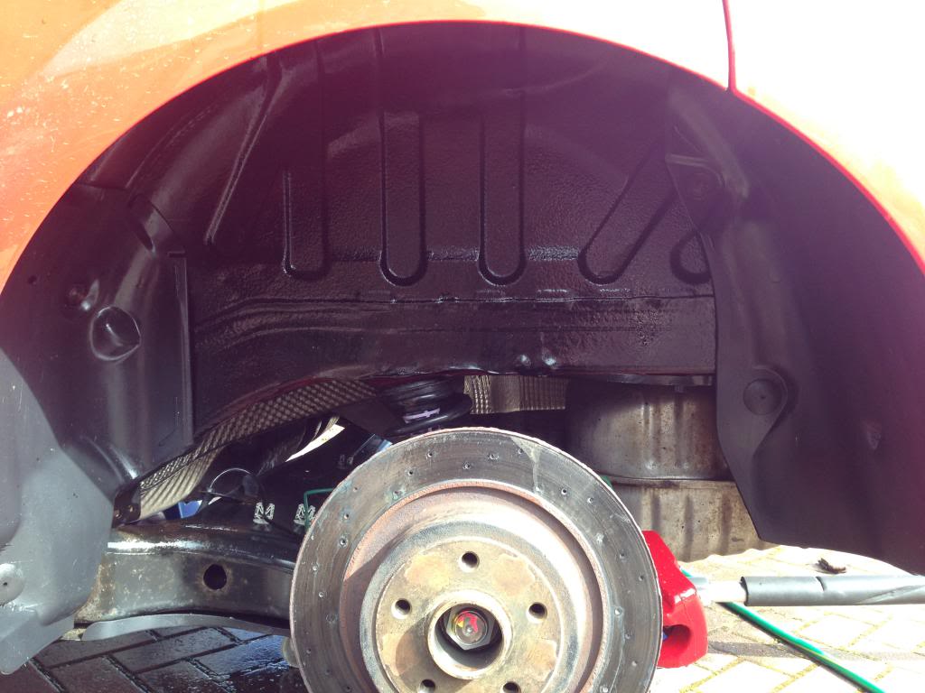

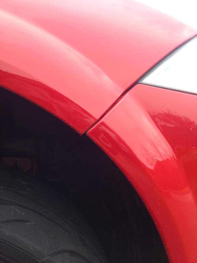

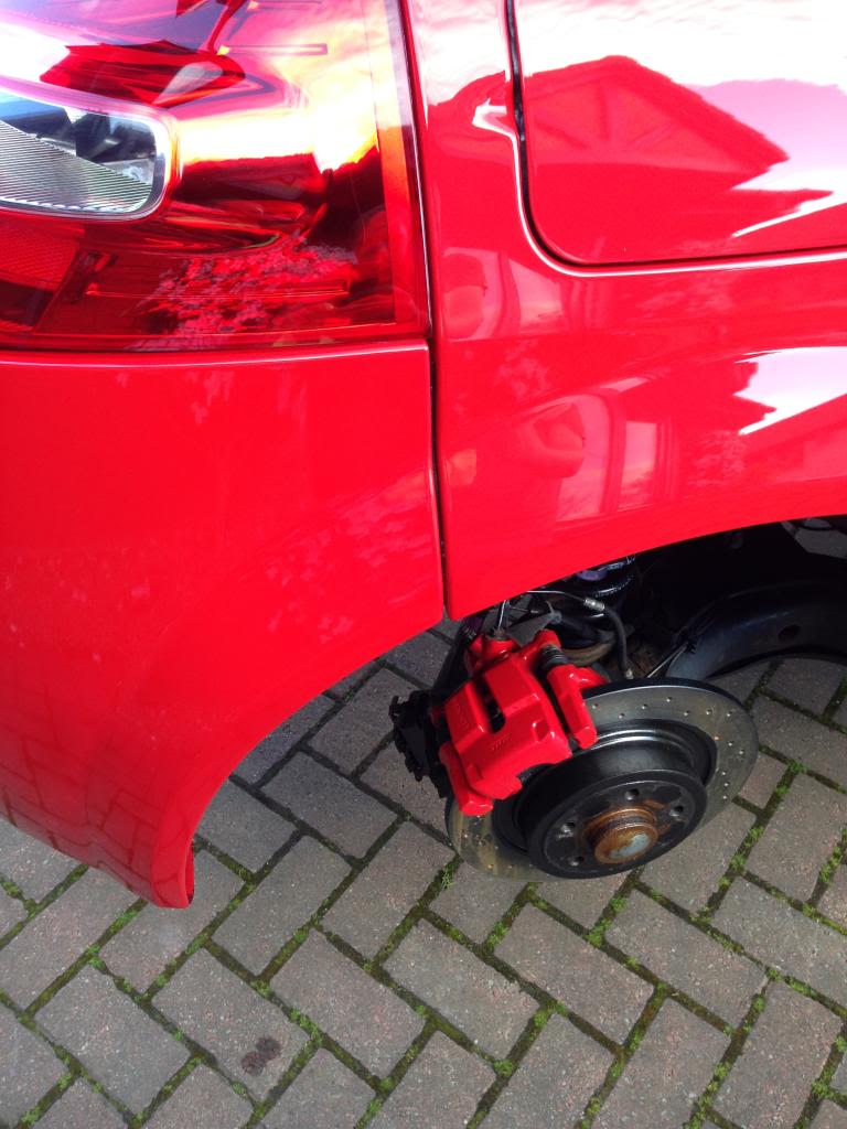

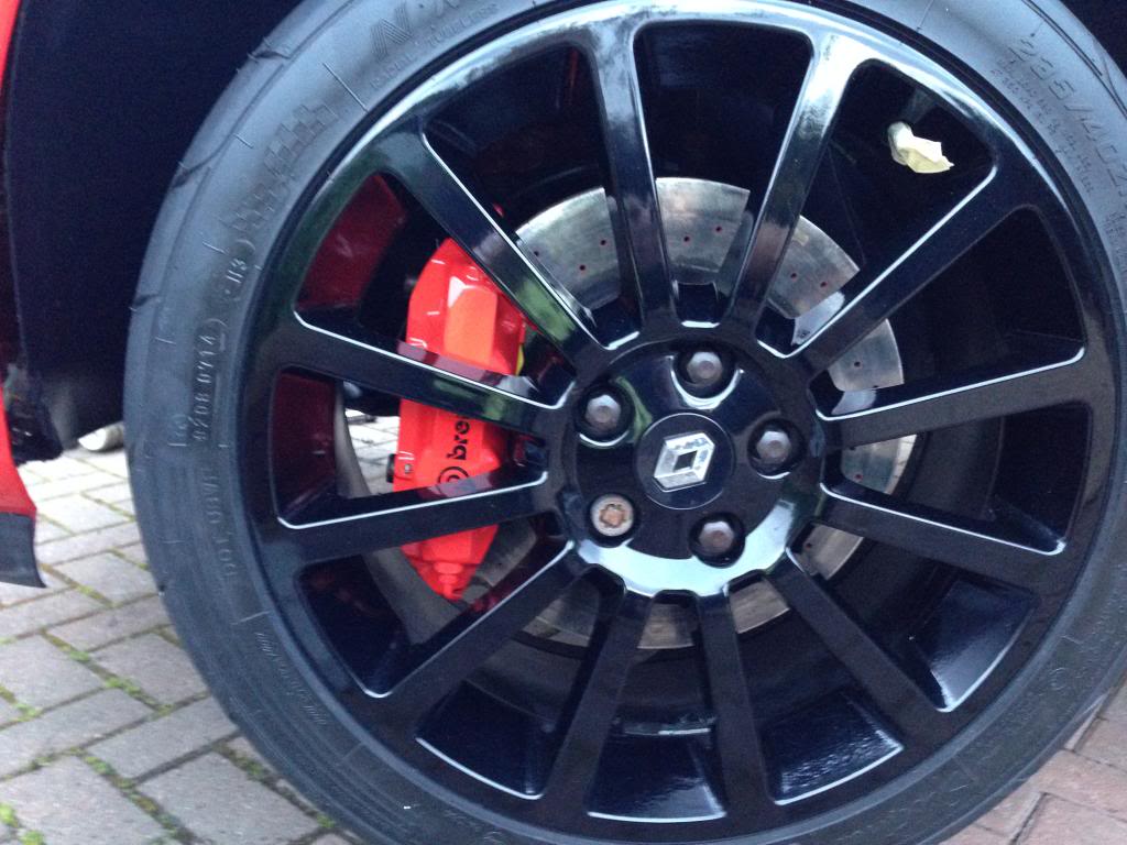

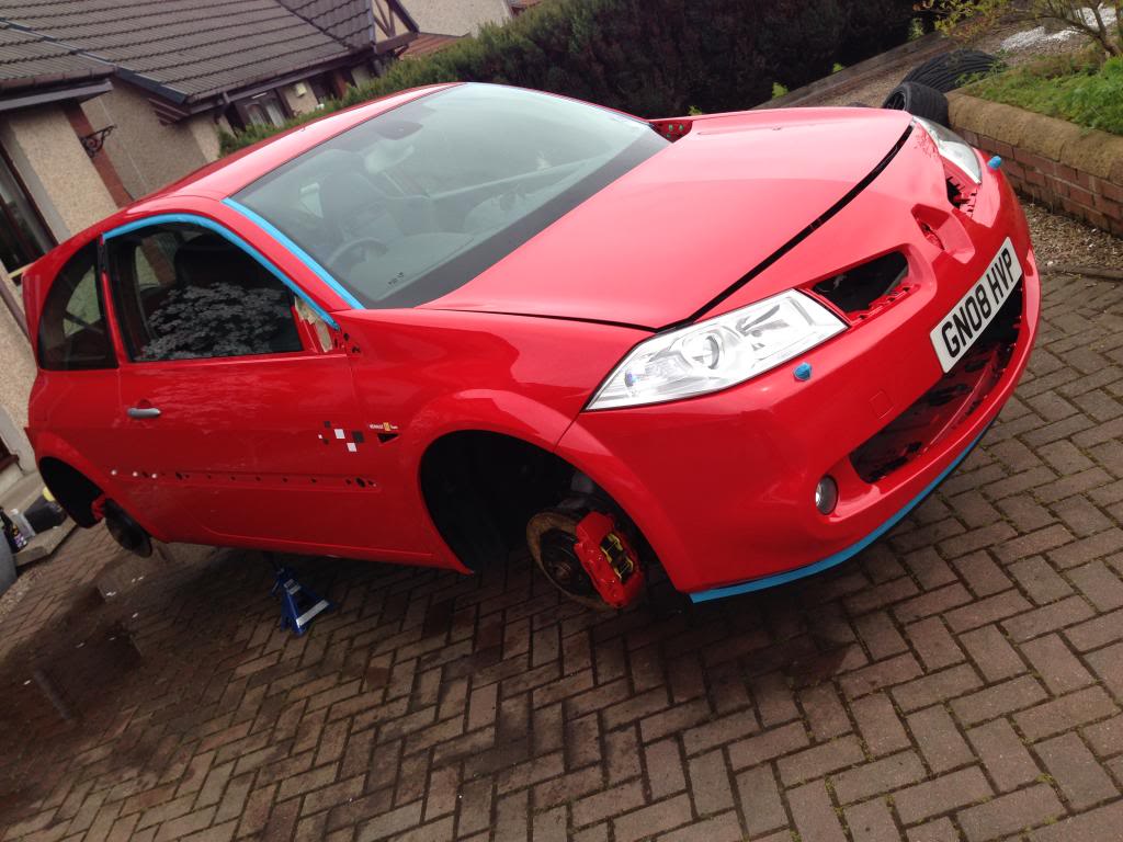

Before stripping the brakes I washed and detailed the arches.

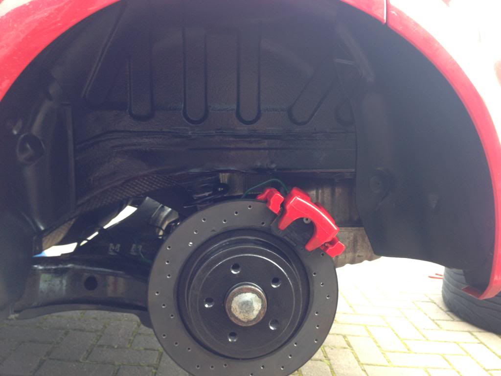

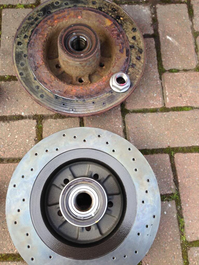

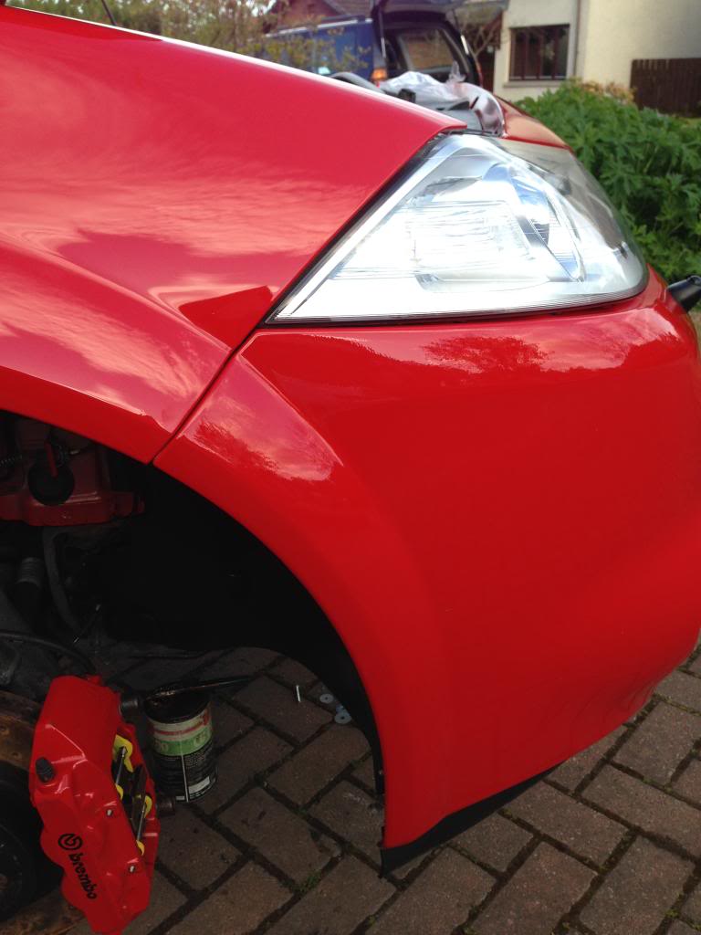

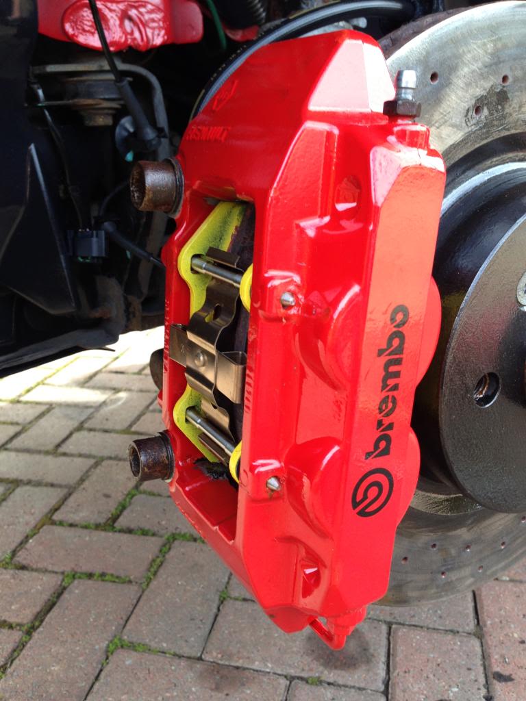

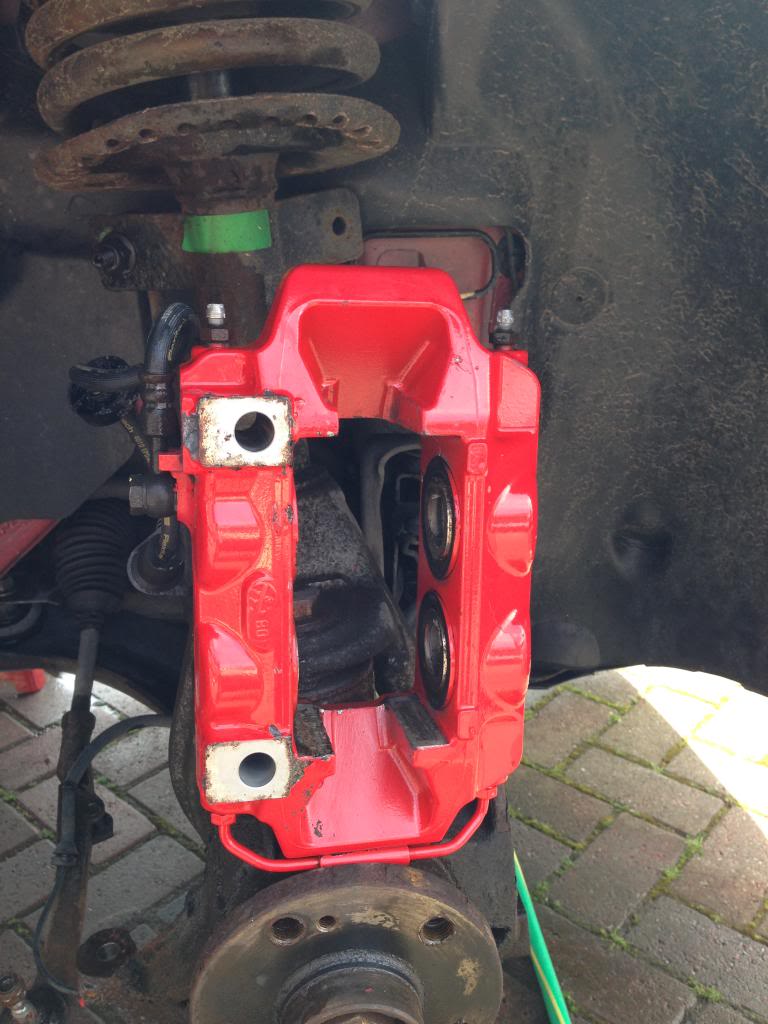

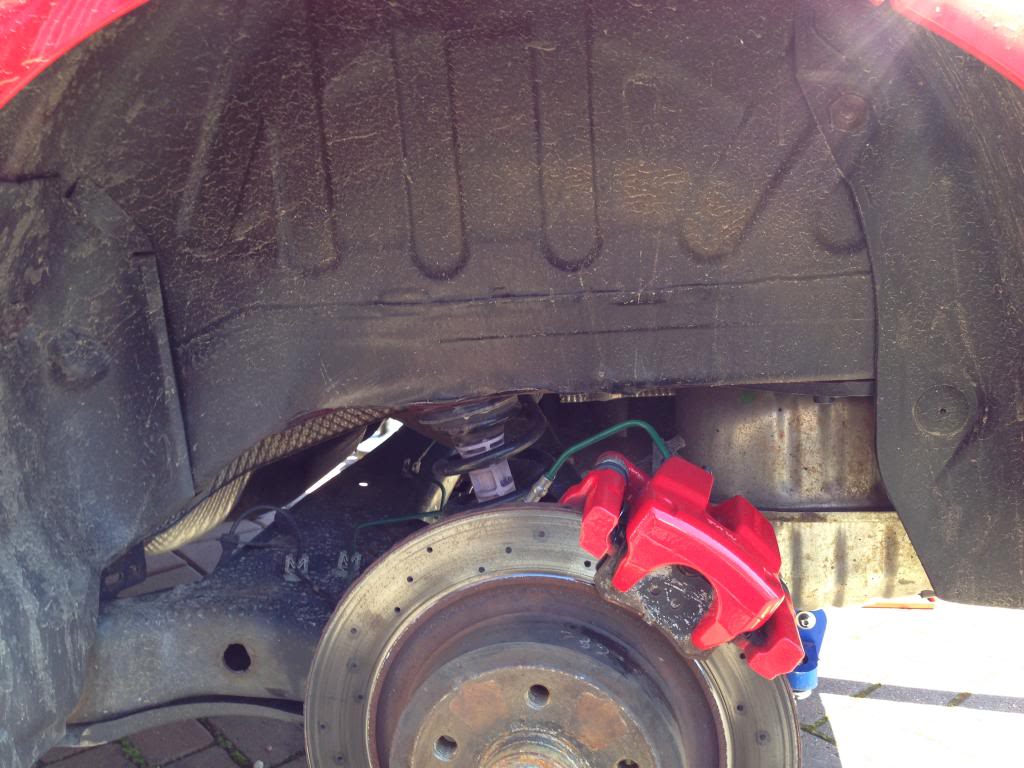

I got the rear calipers touched up and then re lacquered. Painted the new disc centres to stop rust and then bolted everything back together. I then flushed through the system with some ATE super blue.
new vs old, about due I would say, eh Liam ;);)

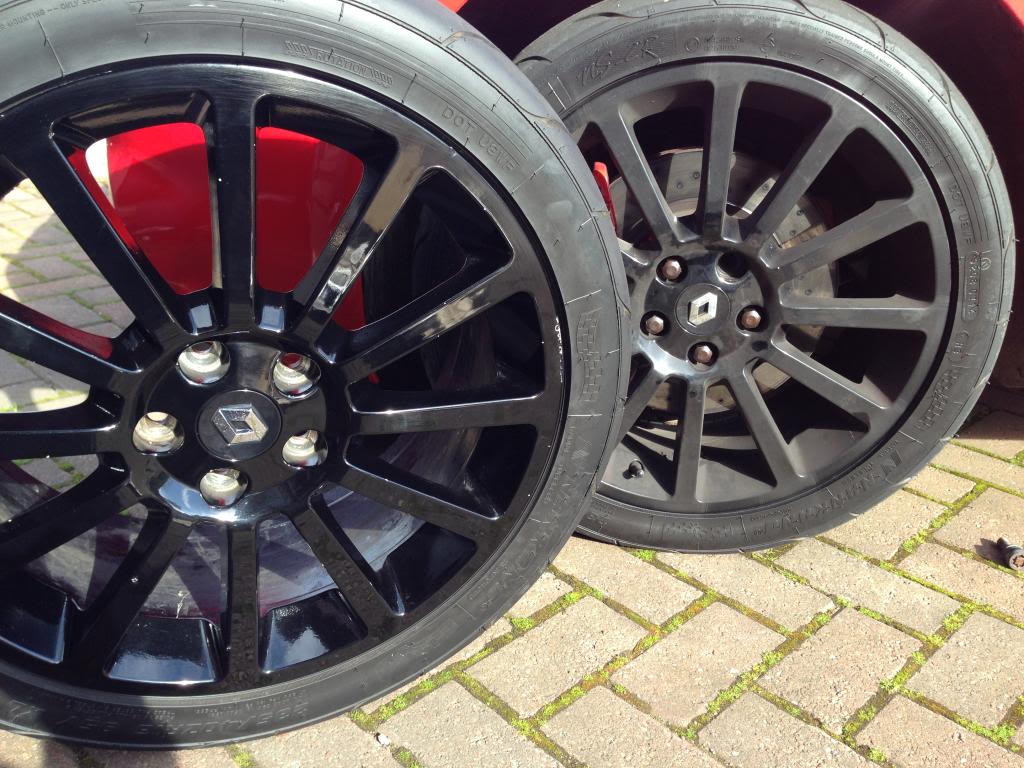

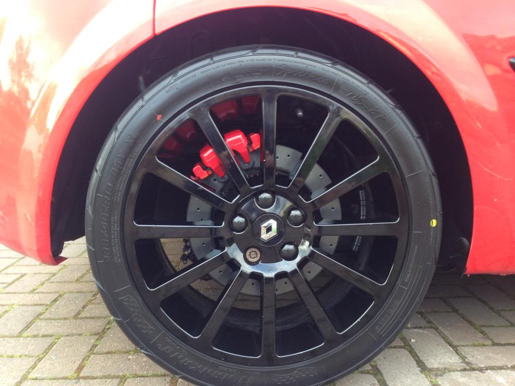

I washed and polished the wheels, came up okay although a refurb would better to suit my OCD.
Touched up any marks on the wheels and got some tyre slick on the new Nankang NS2-R's that were fitted yesterday. Looking good.
Tomorrow I'll be doing the same on the front and re hanging the front and back bumpers. The exhaust seems to sit on the piss too so I'll look into that.

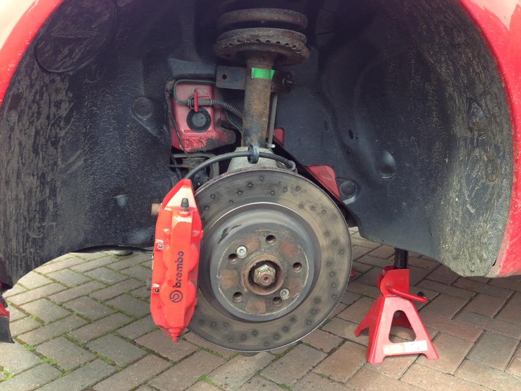

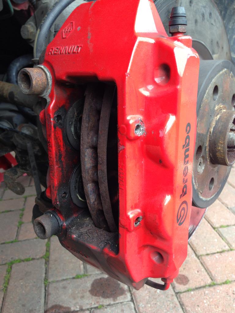

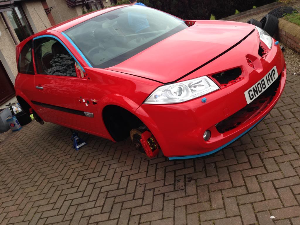

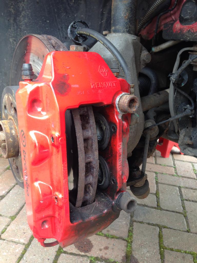

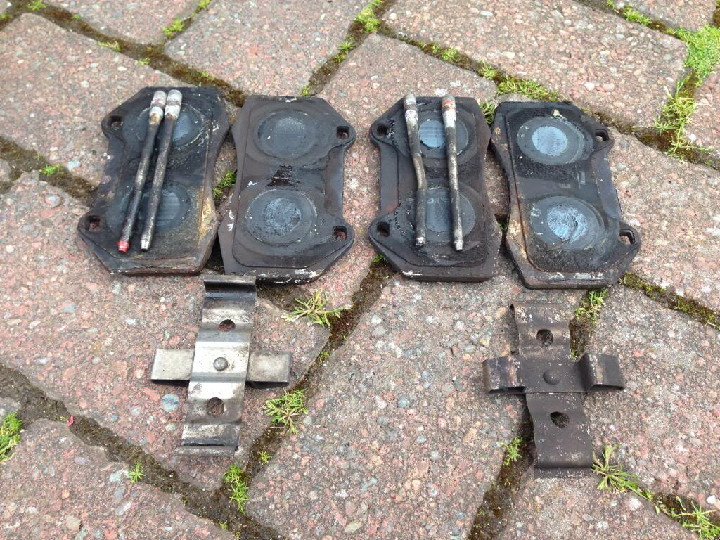

Started the day off like this, I checked all the ball joints, drop links, torque links, inner and outer track rods and everything seems to be good so that's a bonus.

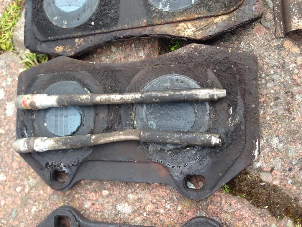

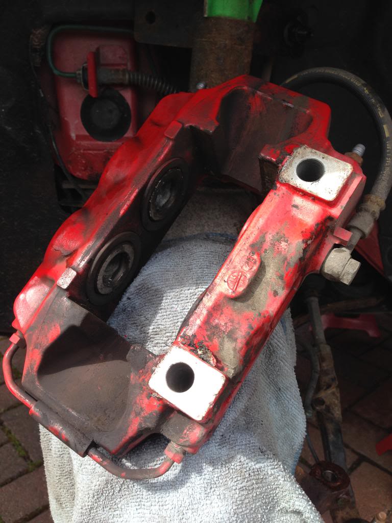

I then removed the pads finally after having some trouble with the pins.
The pins finally came out a bit worse for wear.
The calipers were in a bit of a mess.
After some elbow grease, g101 and a stuff brush they were looking better.

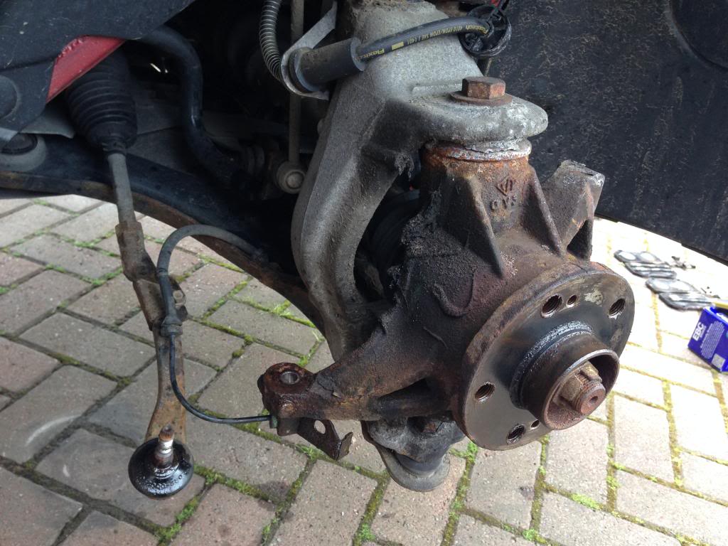

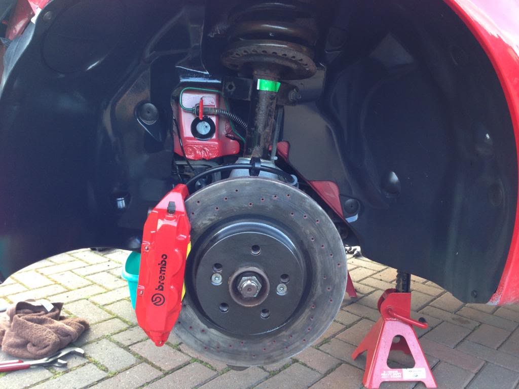

I removed the track rod ends to check the hub bearings, again in perfect condition :D. I nipped up the existing CV boot clamps and gave everything a quick jet wash as the grease seems to have been from another clamp failure.
I then built everything back up with this after cleaning up the discs and painting the centres with hamerite.
To be left with this after touching up the callipers and re lacquering. Looking pretty good if I don't say so myself.
I then cleaned and detailed the front arches.
Finally for the wheels I polished the remaining two and refitted to seal tomorrow.

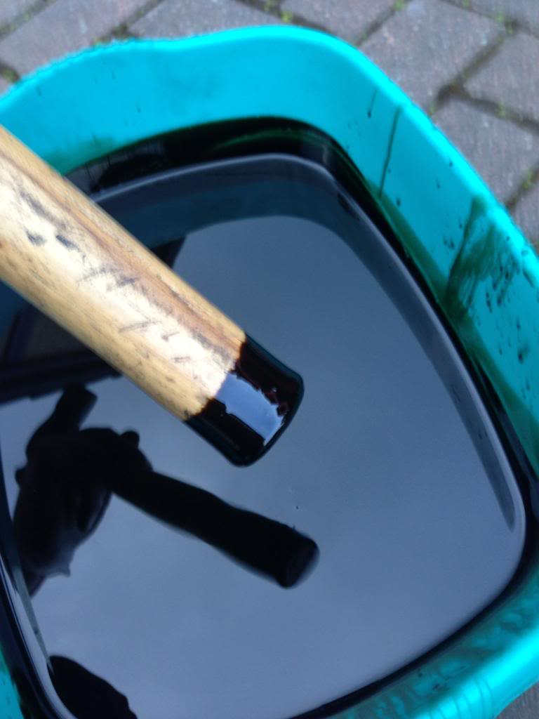

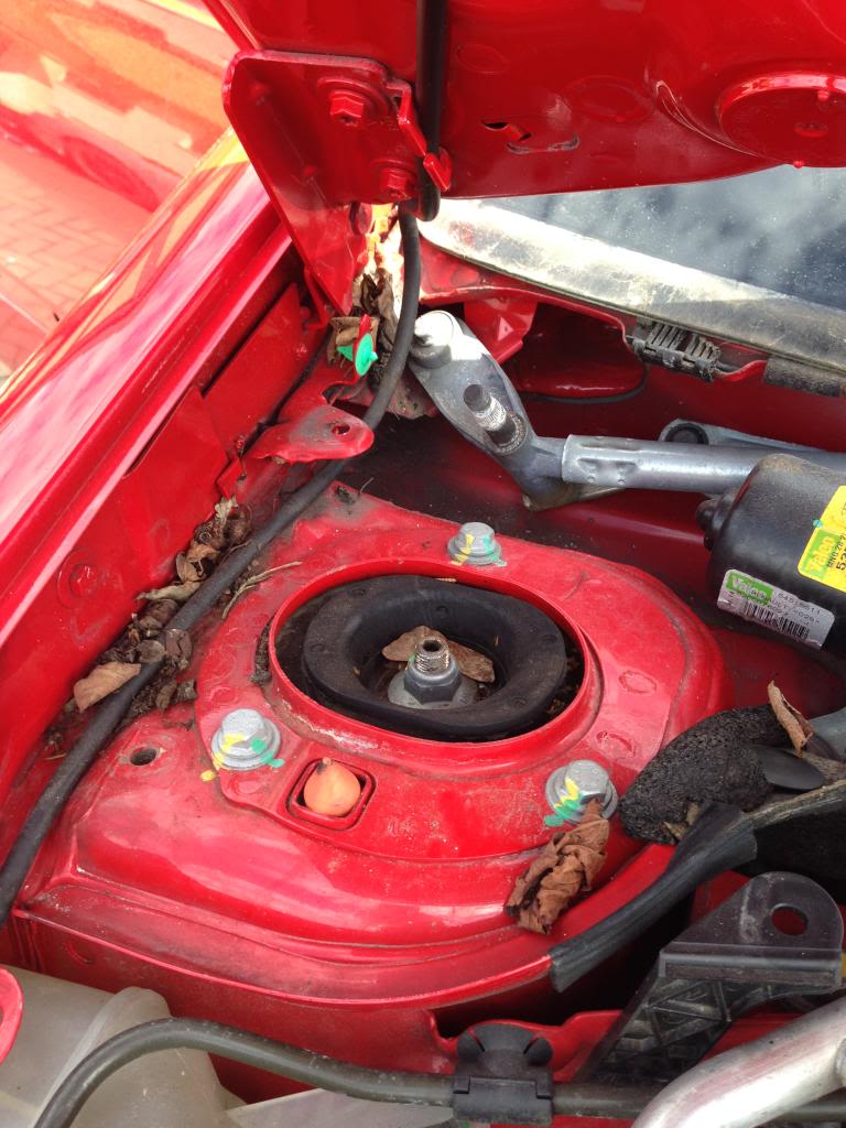

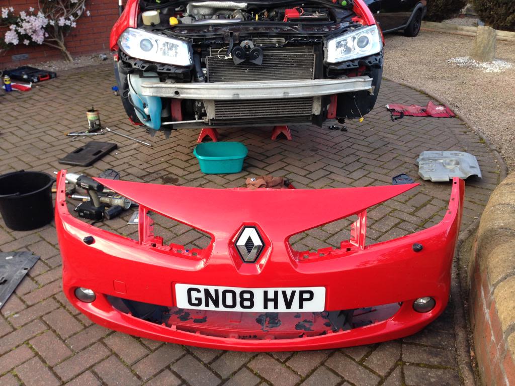

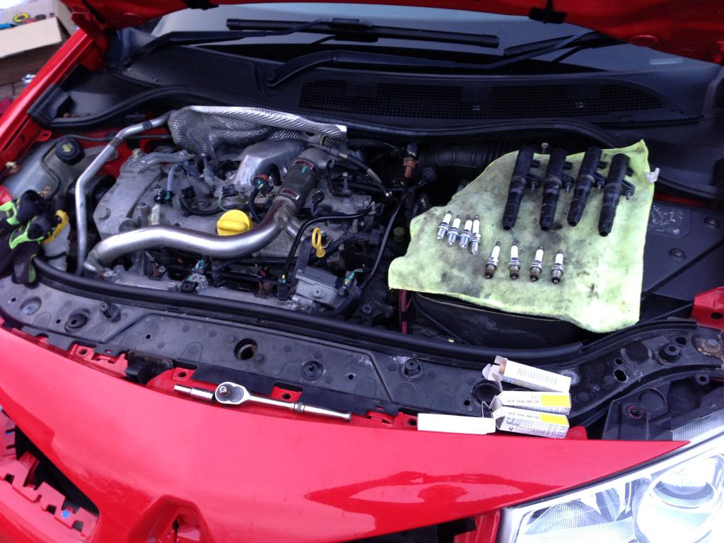

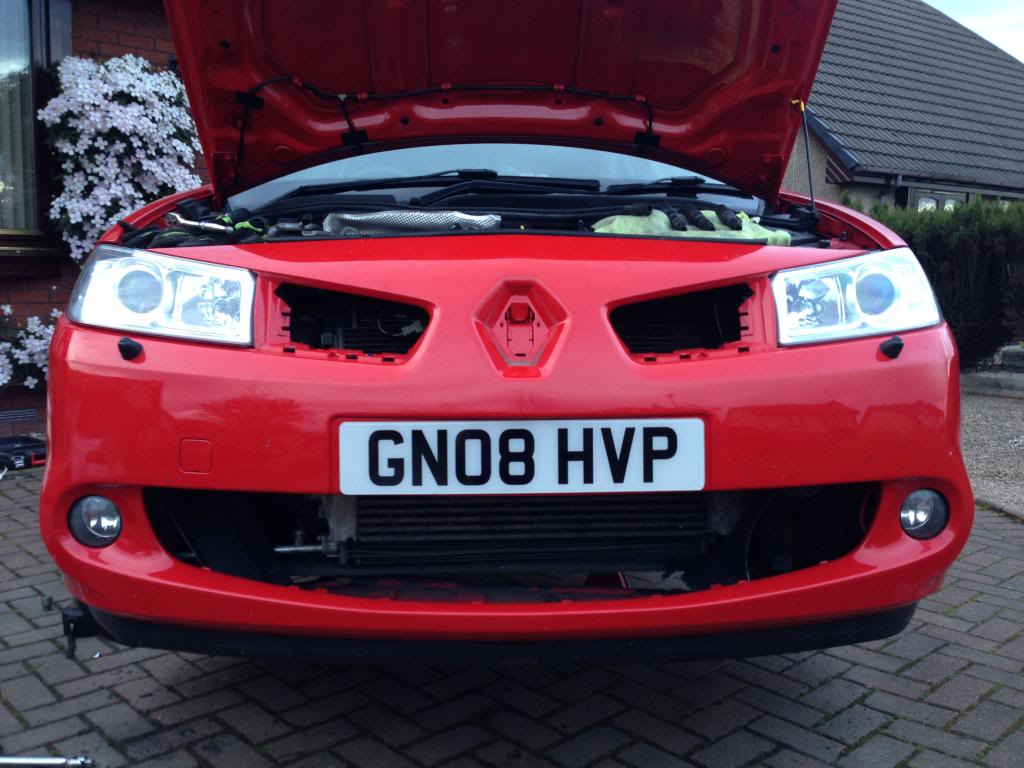

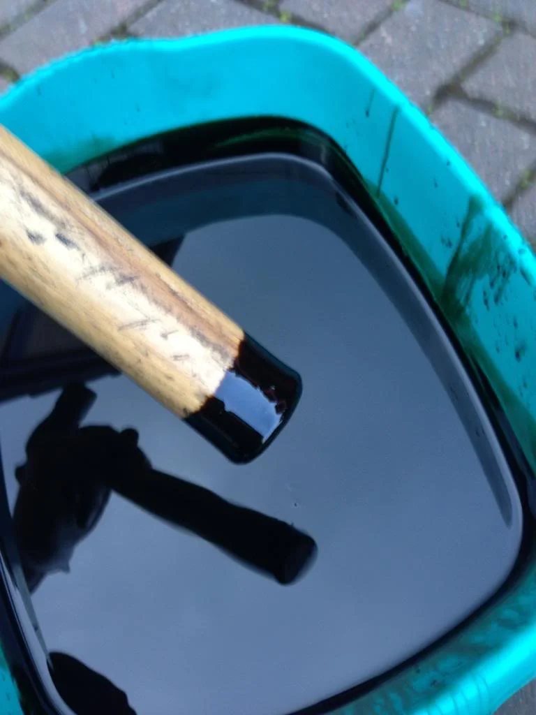

I then removed the front bumper to change the oil and filter and all the grilles so I can polish properly.
I think the oil was due.

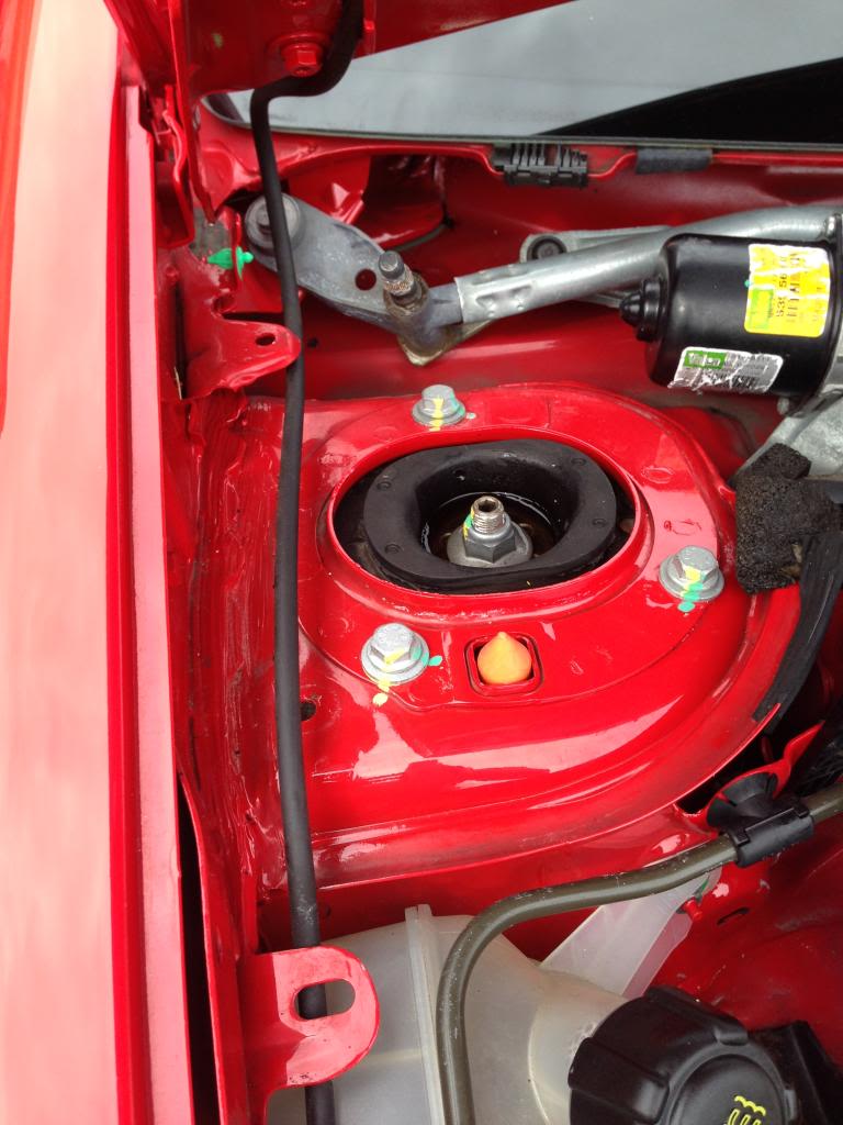

Changed the plugs and removed all the engine covers so they can be detailed tomorrow.

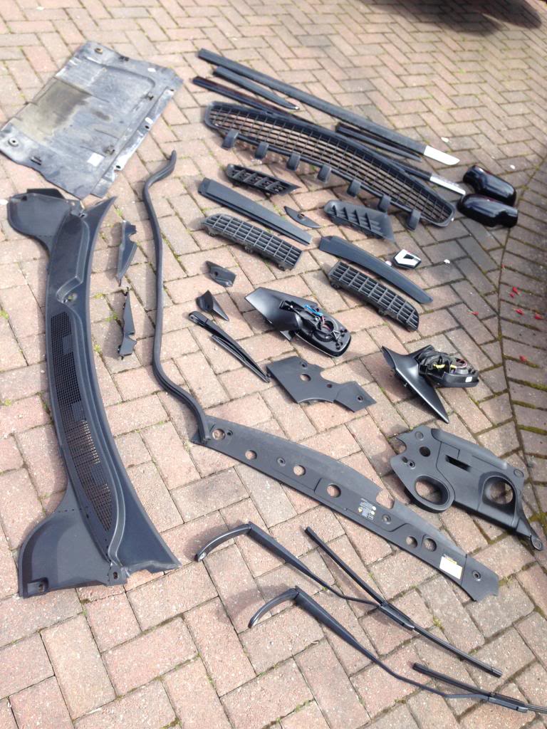

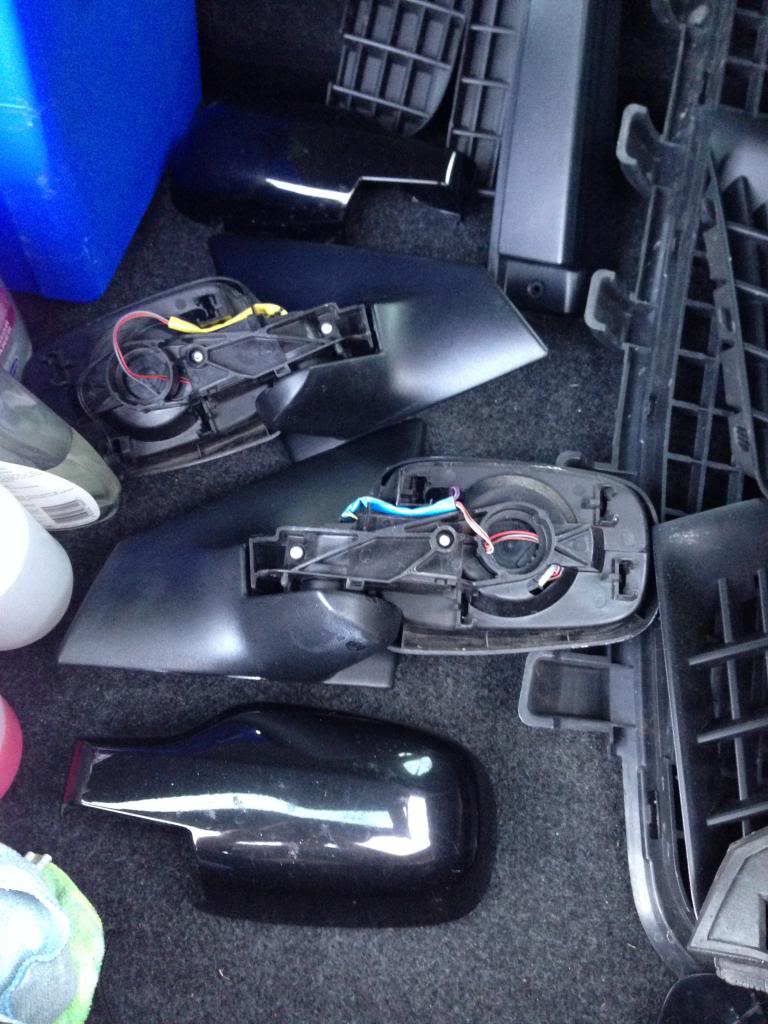

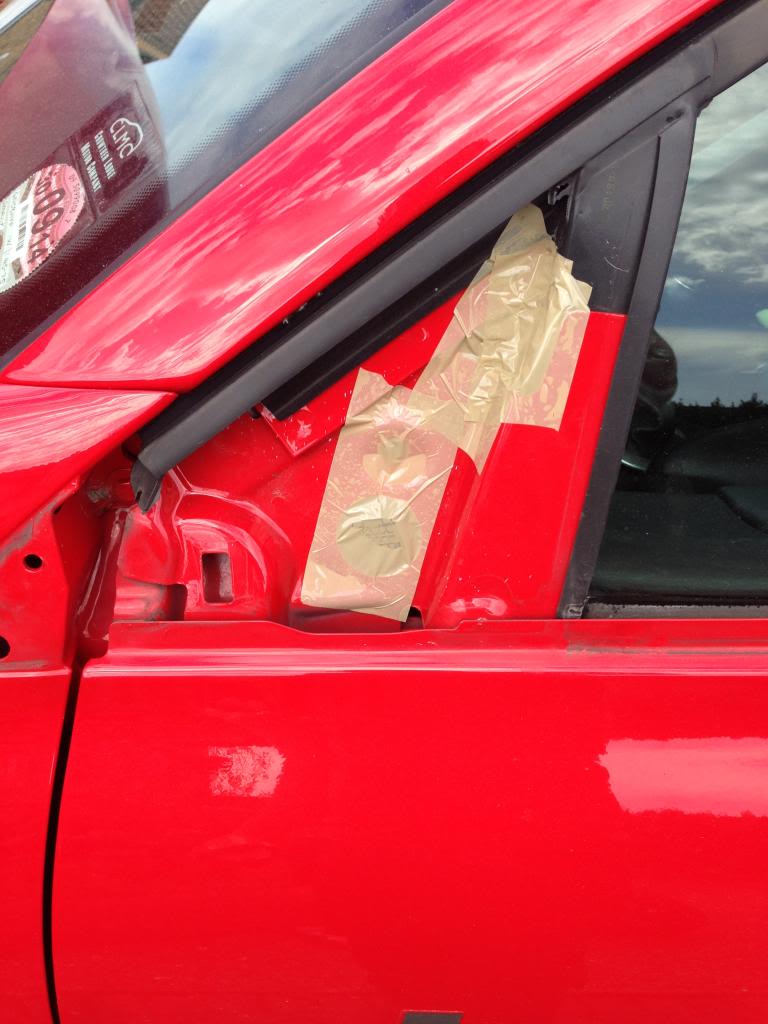

I removed the rear wiper and cover, lights, grilles, side strips, b pillar covers, mirrors, spats, indicators and window seals so everything can be polished properly and quickly tomorrow. The amount of old polish hanging about under everything is nuts.
Split the mirrors and that's it ready to get a polished up tomorrow, I might even get the front seats out and give the interior a once over too.

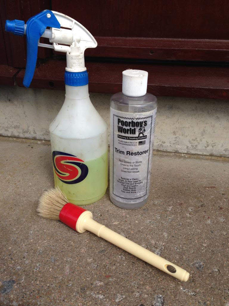

Can anyone suggest a good trim restorer that's readily available (not aerospace as it will take a few days to arrive) and that can be sprayed on and left for the most part.
  Cup In bits
Cheers Jamie, anywhere mainstream where I could pick that up tomorrow? Or is any of the meguires stuff good that I could pick up from halfrauds.
The mirror caps are fiddly, if you pop of the mirror glass with a screwdriver then use a pick to pop all the 5 clips beginning with the one closest to the car so you can get your finger in to pull.
Yeah any of the Megs stuff or autoglym stuff will do the trick and you can get that from halfords. I don't know of anywhere that you can buy AF apart from online i'm afraid.
  Cup In bits
I already have some Megs trim restore its just the time it takes to rub on all the cross hatch grilles and then buff off where as aerospace 303 is simply spray on then leave and its brilliant, I was hoping for something similar that's easily available.

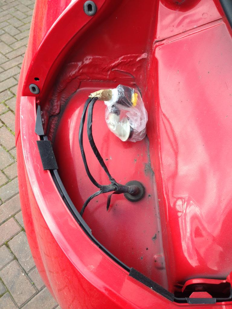

Got a new plug for the rear light so im going to get that wired up tomorrow, one of the connectors is dodgey.

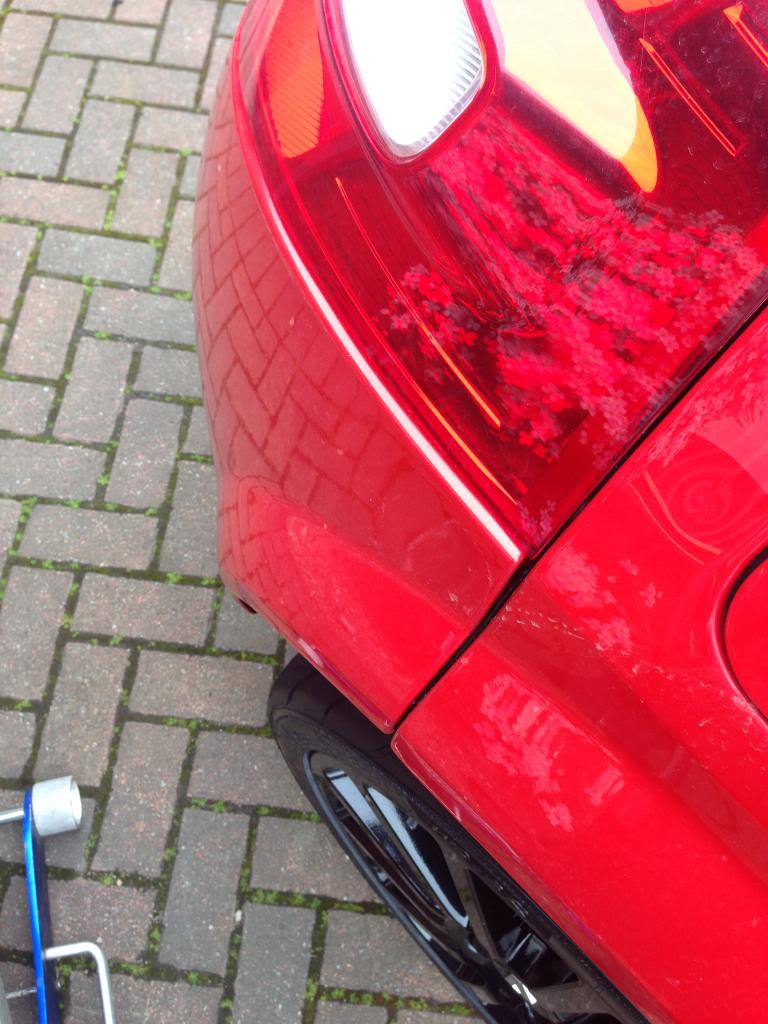

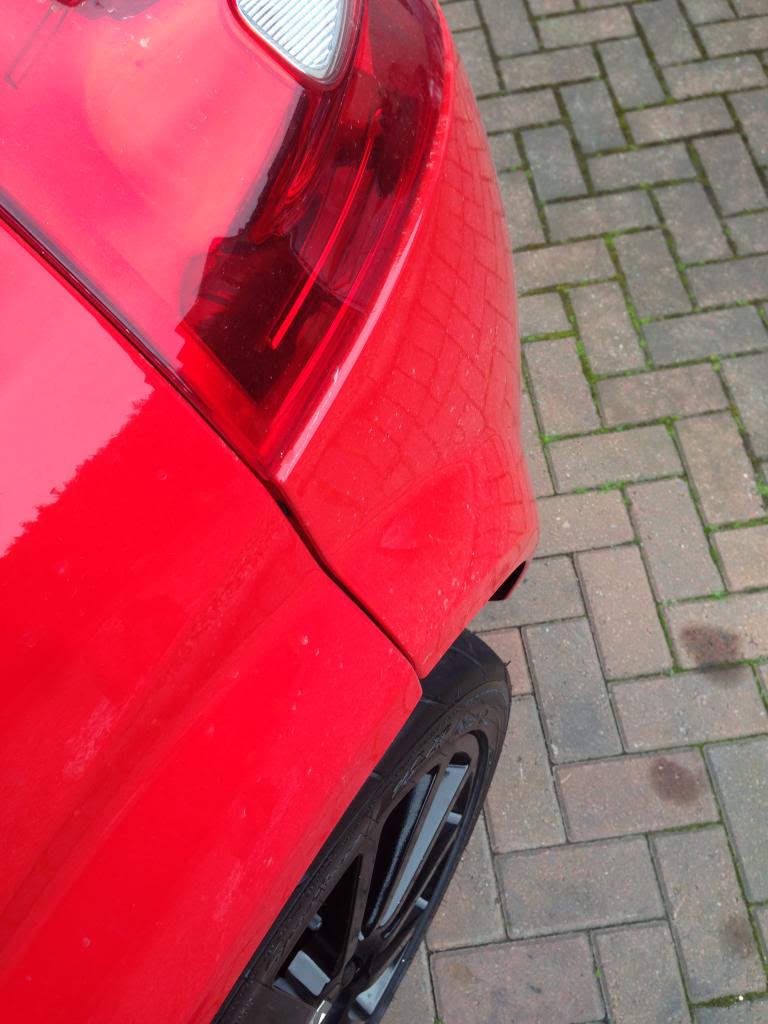

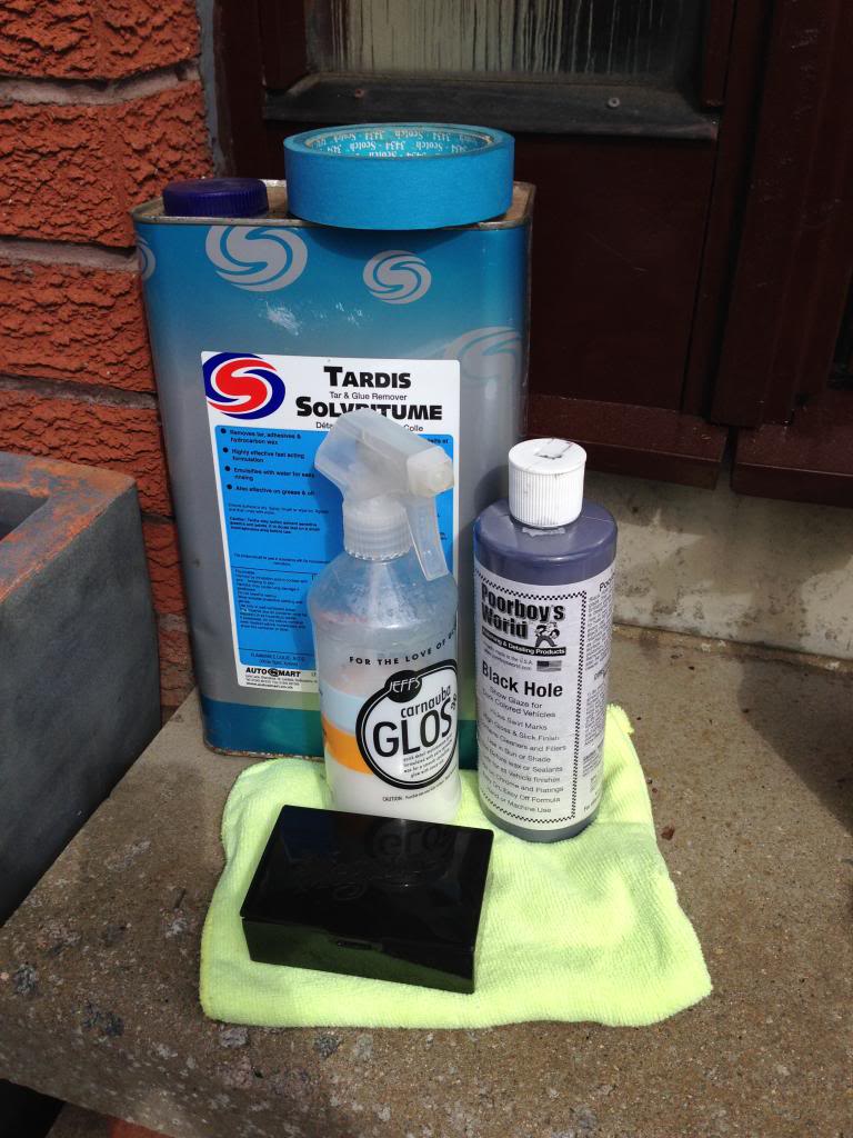

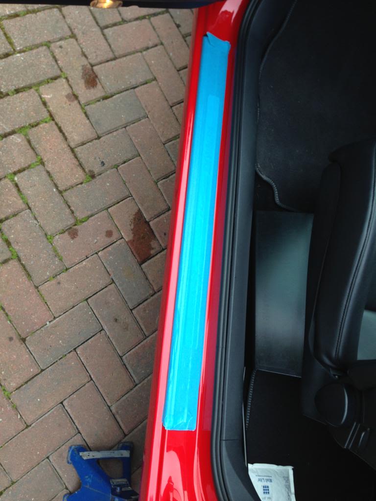

I started the day by nipping round to my mates who gave me free choice on his detailing gear and his buff . I then started taking off a few more bits of trim so they can be restored and make the polishing easier.
I tapped up and bagged any wiring or holes.

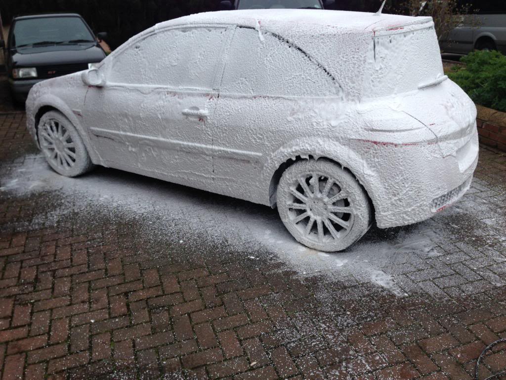

My wash steps were.
Rinse down, sprayed and agitated g101 around all the nooks and crannies, prewash of g101/acti mousse XL in the snow lance, rinse and then another hit, used lambs wool mitt to clean.
A wipe down with Tardis a panel at a time and washing behind it, I started to clay but there was nothing coming so I went straight to the enhancement. I decided on PB black hole as my mate suggested that it would have a better cut than the meguires stuff I planned to use by hand.
Next I concentrated on all the plastics while the car was drying.
G101 sprayed and agitated then left to dwell until almost dry and then washed down. I leftist all to air dry and then I started to apply Poorboys trim restorer. I'm well impressed with this stuff and I'll be buying some for my own kit, it smells awesome too. 50/50 shows just how good it is and you only need to give it a quick wipe to remove excess.

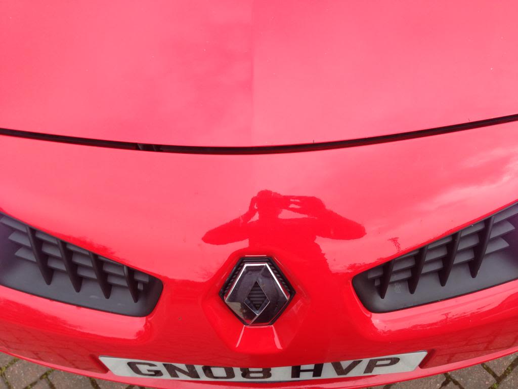

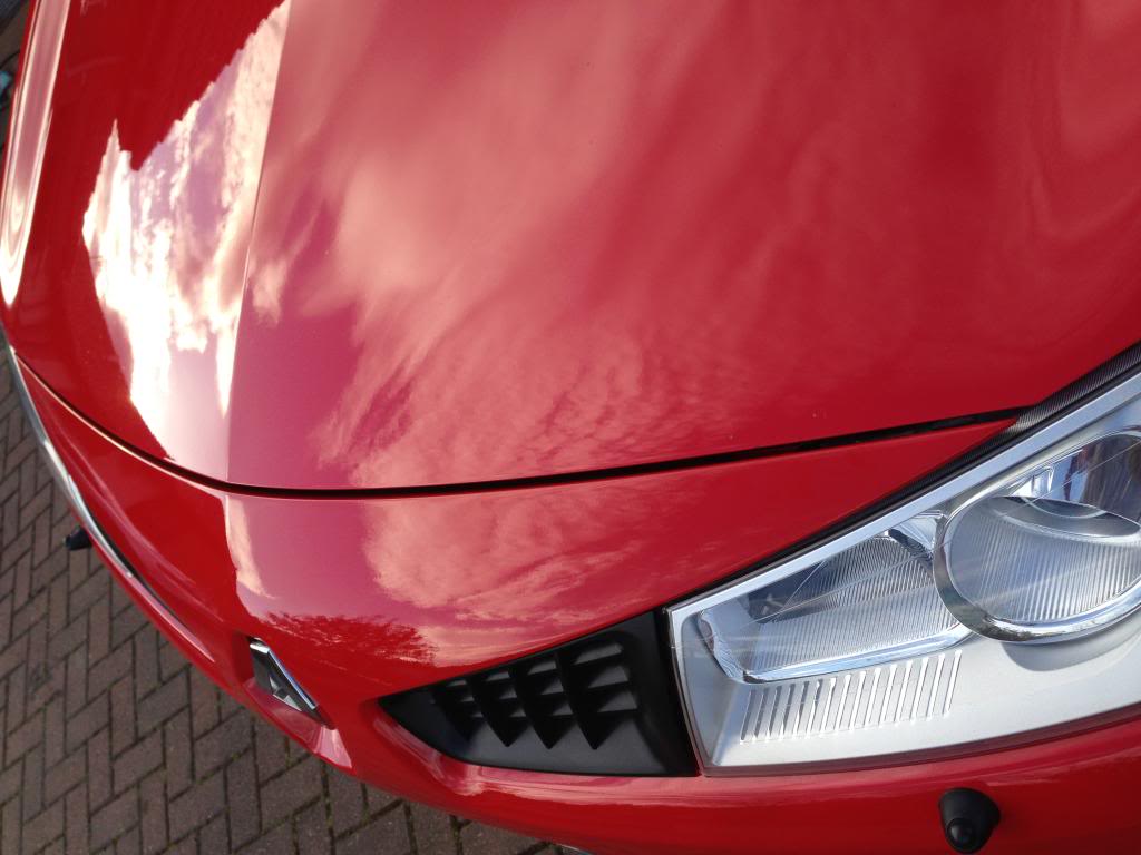

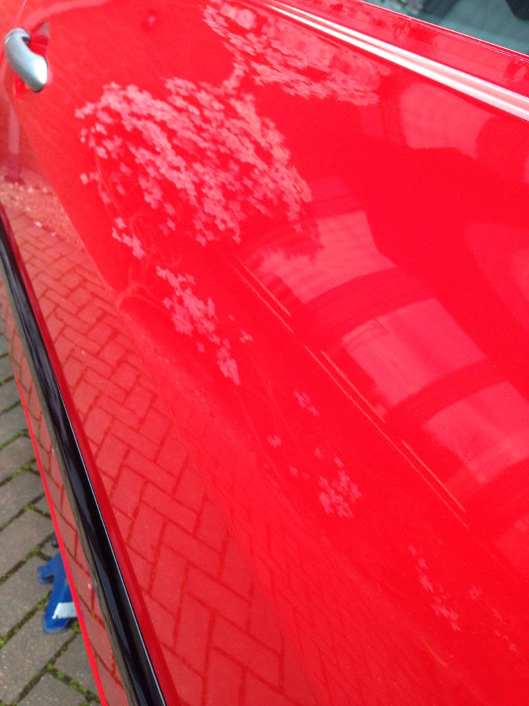

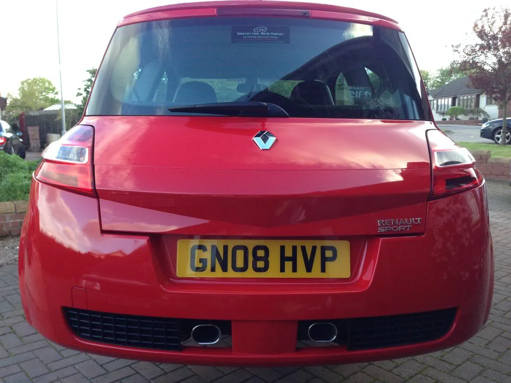

After the car had dried I applied some tape and then got cracking with the buff.
After some polishing and the side strips re fitted to get a buff up.
Some reflections. I never spent to long engraving as the paint had a nice glow after a few passes.
I applied two coats of Jeffs carnuba glos (nice and easy to apply) before refitting all the grilsl to the front and back bumper. I set about trying to get them both sitting better and they turned out okay although not perfect, o not have a bolt at where the bumpers meet the wings is stupid.

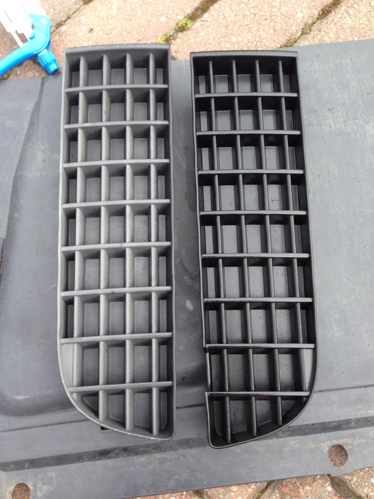

The bumper and all the covers were secured with all new clips, plastics dressed and now the only thing letting the bay down is the rubbed down engine cover.

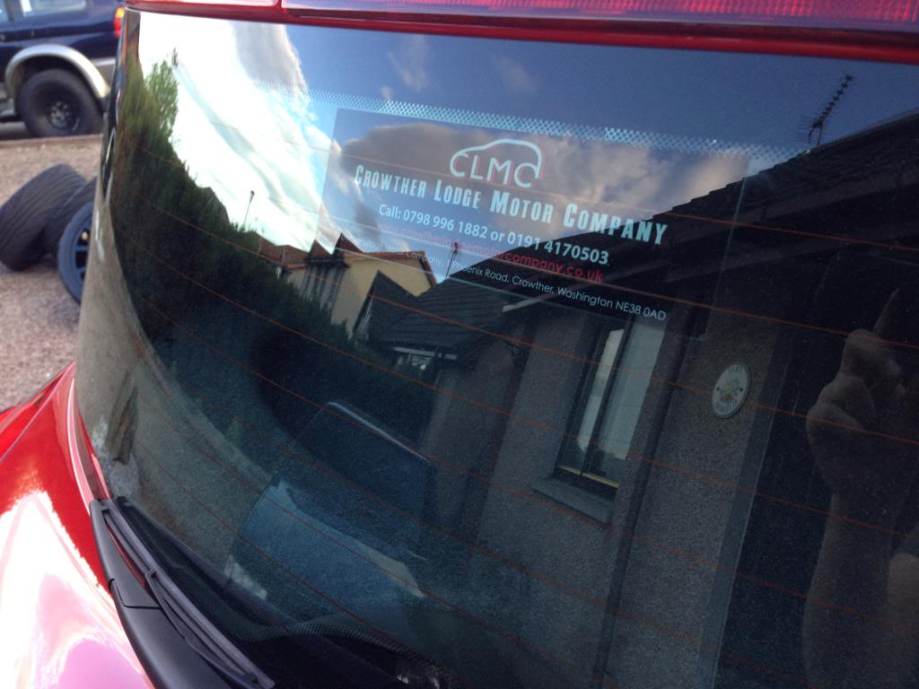

I then removed the sticker from where the car was bought. I think I'll remove the elf one tomorrow and add a small gtechniq badge.

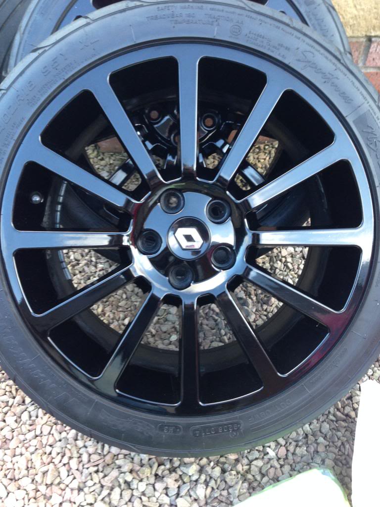

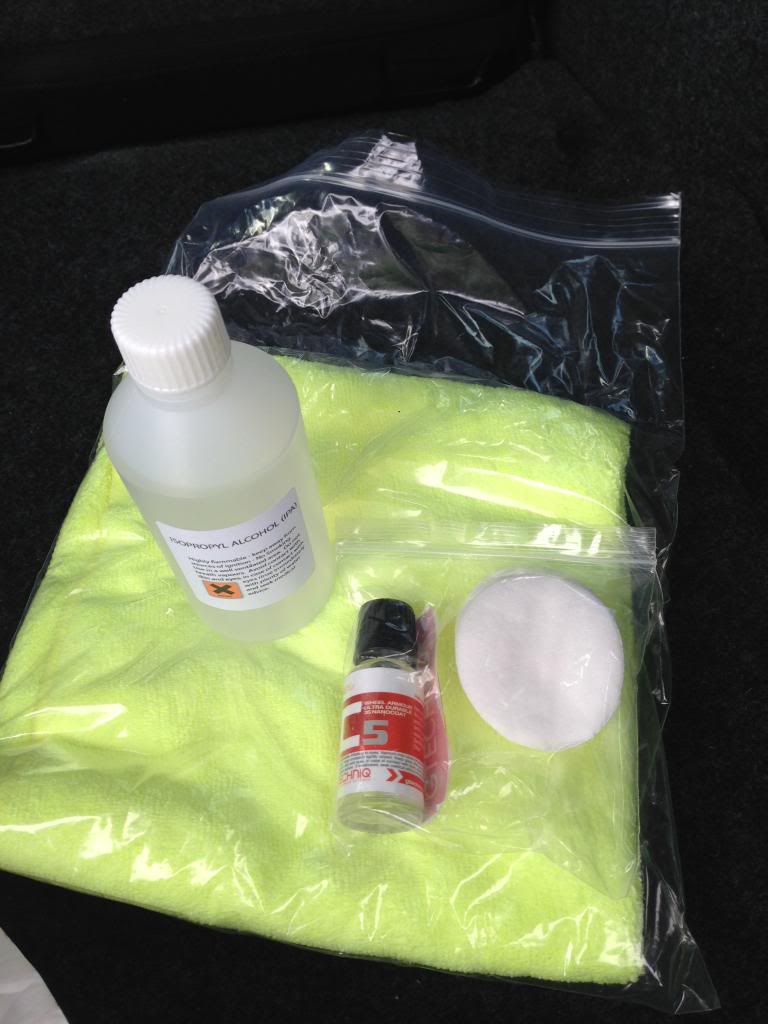

I then set about dealing the wheels, C5 is great and the instant gloss and depth it gives is brilliant considering you don't have to work the product in.
After one coat.
I refitted the wheels, slapped on some Megs tyre dressing and went to bed in the new brakes. I managed to get a poor pic before the sun went down when out.

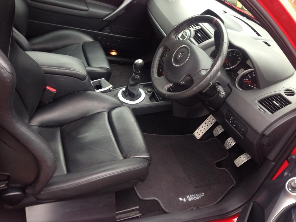

Tomorrow is the interiors turn, nothing major to be done other than a few marks on the head liner. Hen I get a chance I'll be wrapping a few bits in piano black.
Will do (not if its money)
Nice one, I didn't think it would be anything. As said, with the single silencer you will see more steam/vapour than usual.
Have you tried some electrical cleaner and some lithium grease in the plug, it would be a shame to chop up a perfectly good loom.
