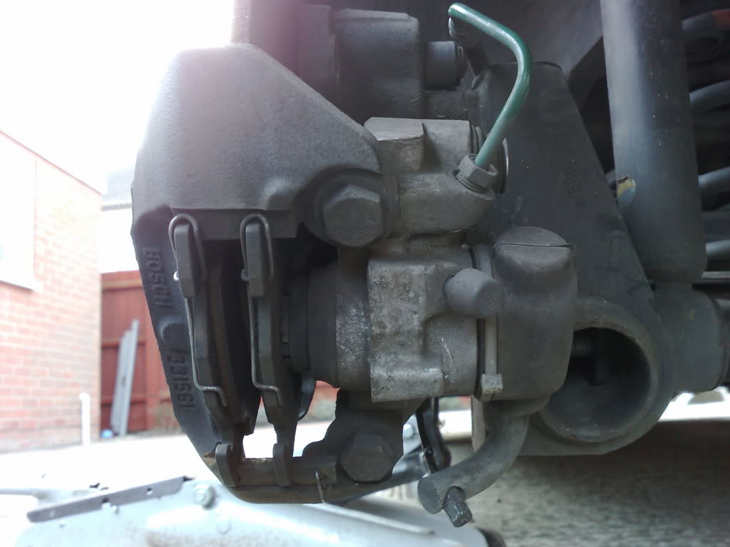

im in the middle of changing the rear pads on my 182
i cant get the caliper off help??
do i need ot take the hand brake cable off???

all you need to do is unbolt the two 17mm bolts at the back and persuade the caliper off then once pads are out wind the piston back in

surely you can change them with the caliper in situ like on the mk1's? take metal clips off, and the little one on the metal bar at the bottom, get a punch and knock the metal bar out, pads should slide out. wind piston back, new pads in, copper grease it up, refit bar and clips. that is unless the 182 are different (never worked on one, just going off the pics and experience with other brakes :eek: )
  F4R'd ITB'd '92 cup racer
ive just taken a look at the pic again, i think i can see what you've done, you have taken the 2 main caliper bolts out and tried getting the whole caliper off (hence why the pads are hanging over the edge of the disc)
you wont do it that way with brake pipe and handbrake still on
do it as i said before, loads easier :D
(LeeP86 is talking about taking the carrier off, not the whole caliper as you have done)

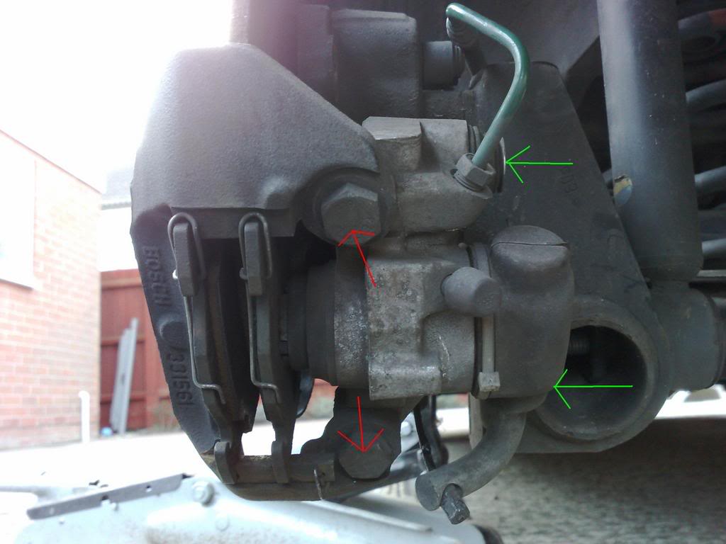

sorry i think i got it wrong.
i need to remove the two red bolts not the to green ones??

edit - yes 2 red bolts, or leave them in and do it as it is (in situ), up to you :D

yea i no what you mean mate but i was thinking if you undid the red ones there alot less fiddling and less is under stress a tension.

i was trying to take the green ones out and take the whole calier off the disc like you do on the front.

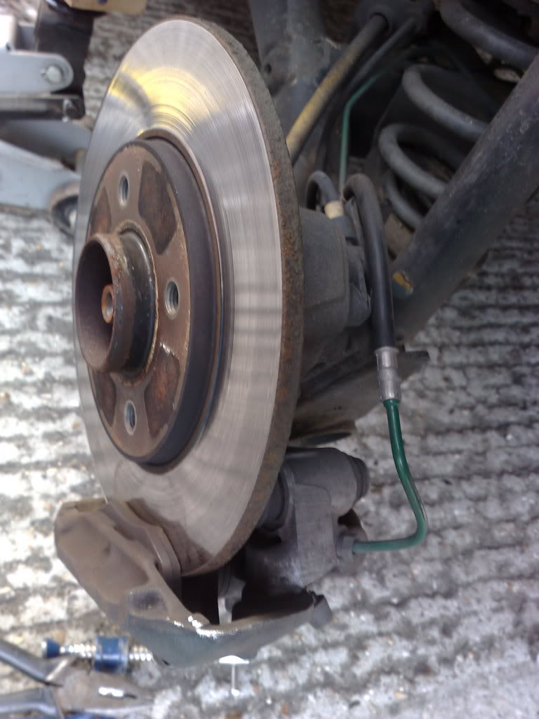

ive been trying to 2 solid hour to get the piston back in so i can screw the pads in. how the f**k do i get the piston in, it wasnt this hard on the front pads

this is all you need to do
there should be a groove cut in the rim of the piston which you can lay a screw driver across and wind the piston back in to the caliper
