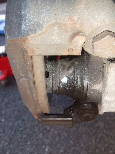

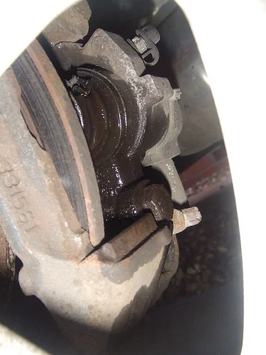

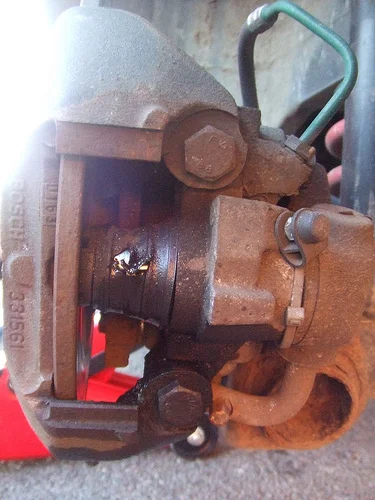

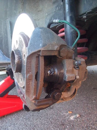

I fitted a new set of front pads on Fri afternoon, very happy with them except for a little binding which I sorted by a good caliper clean/service this afternoon.
After having sorted the issue, pulled the car off the drive ready to take her for a test drive to make sure everything was ok.......when I noticed a small puddle from where the n/s rear wheel had been sitting. Checking to see what it was found it to be greasy. Investigate further to find the offending leak etc to find the image in the photos below.
Basically the pads have totally fallen out of the caliper sometime in the last week and a half are are beside a road somewhere. The rubber cover around the piston has been nicked somehow (fast moving brake pads possibly) I fitted the pads myself over 15 months ago and never had any problems from them. The only recent work on them was done by Kwik-fit, who 'adjusted' them to pass its MOT mid Feb. I've spent just over a week abroad with work so have only been driving the car for a couple of weeks since. There is scoring on the disc from where the caliper and piston have been acting as 'pads'. Yesterday (Sat) I drove down to see a friend in London (150 miles of driving at least) so have most likely been driving a dangerous car.
Lets just say I have not been for a test drive this afternoon and will not be driving anywhere till it is fixed. I am furious. I intend to call Kwik-fit in the morning and see what they will do. I am certain they are to blame. I have been going there for the last 2 years and never had any reason to fault their work.

Thats what I was worried about. I know I havent messed with it but that wouldnt stand in court.....
If I do end up having to sort it myself, obviously a new set of discs and pads are needed, but can the rubber sleeve around the piston be replaced so a new caliper is not required? Serviceable part? Where could I get a new pad shim from too?
You can get a caliper refurb kit from http://www.biggred.co.uk/ or you may be able to get the seal from Renault but I'm not sure.
Believe it or not, Kwik-fit have not specifically accepted blame but have agreed that as they were the last people to touch them and they may have been the cause of the problem they intend to replace the caliper, are fitting a new set of discs and pads all at their expense.
