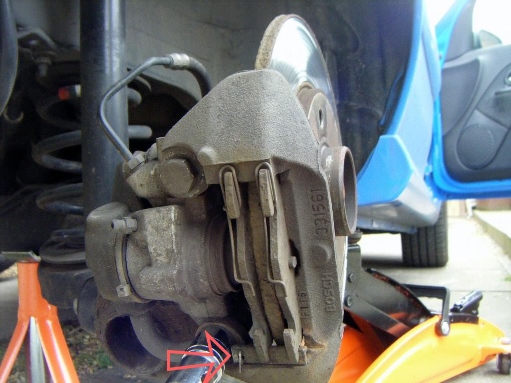

I just fitted new rear discs and pads to my 172. Took it for a test drive and the pads fell out!
Nnow there were no pins on the old pads, are there meant to be pins or clips.
If not what did I do wrong? Is there a certain way of holding them in place?
  Clio 172mk2
see this pic

You could probably make some. There isn't much to them. Dealers would be the other option (although I'll be surprised if they are sold separately), or put up a wanted thread on here.
see this pic
Pic stealer ;)
  Clio 172mk2
lol first one that came up on google :)
ye think ppls asked before and it only comes part of the clip set, halfords also do the set.
mines just got some wire bent through it

Well halfords said the don't stock the pads. I have seen some clips for the saxi vts which I believe have the same rear brakes?
  53 Clio's & counting
Most french cars use that style, I have used the slider and pin from a 205 before - just pop to any motor factors and buy a split pin to put through

Just a couple of questions. Firstly my rear caliper looks different to the one pictured. My bolts are at the back of the caliper when you take it off. Are they different from the 172 and 182? Secondly, a bit random but I know only have three pads. Does anyone have a spare pad they want to sell?

106 GTi, Saxo VTS and 306 GTi-6 all use the same rear brake setup as the Clio, so if you need to pick anything up from a breaker, there's a few more options.

Just got the kit ang it's half complete great! Renault want over £30 for it!
Luckily my local motor shop is getting it tomorrow for £7. There is still hope I will make beaulieu Sunday :)

ok, from top to bottom:
-lock pins to stop the bar falling out, updated design in the picture
-anti rattle springs, hold the pads still
-bar that is pushed in to stop the pads falling straight out (holes are for the lock pins)
