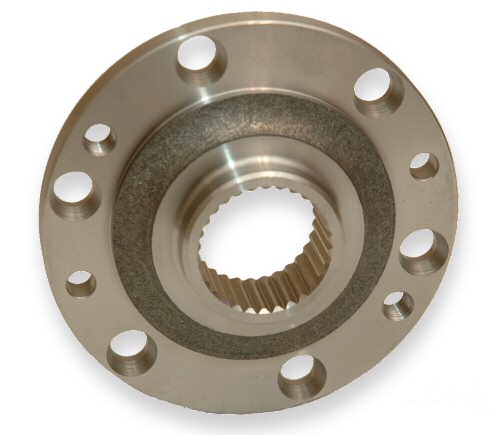

The drive flange is basically what the wheel bearing sits around and what the drive shaft feeds through. basically its a 3d t shape. Hard to decribe.
Look at the pic - its a tad generic, but youll get the idea. The drive shaft feeds through the centre. Wheel bearing on the outside.
