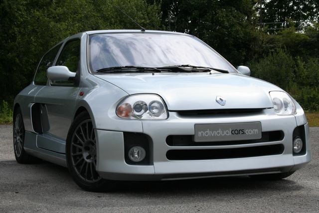

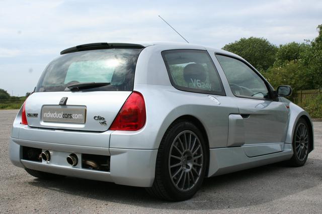

Here are some of the pictures of the car from when it was for sale:
It was largely standard except for having a Janspeed back box and BMC CDA fitted, the wheels had also been re-sprayed anthracite, the brake calipers were painted red and the mesh had been removed from the front and rear bumpers and the side pod mesh had been replaced with an expanded metal mesh I really wasn’t keen on.

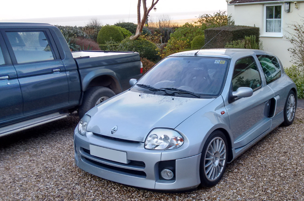

I kept the car as it was until early 2012 when I decided to return it’s exterior appearance to that of a factory standard example. I had the wheels refurbished in the correct silver, I painted the brake calipers black and then I also found the correct mesh to replace what was either missing or wrong. By the spring of 2012 the car looked like this:
Over the next few years I just enjoyed using the car and kept it good mechanical and cosmetic condition whilst attending various events and also using it as my everyday car after I sold my 172 Cup, but as time went on and I became more and more of the opinion this is a car I want to hold onto indefinitely I decided I wanted to make some changes to the car that I felt could help to improve it or just help me enjoy using the car more.

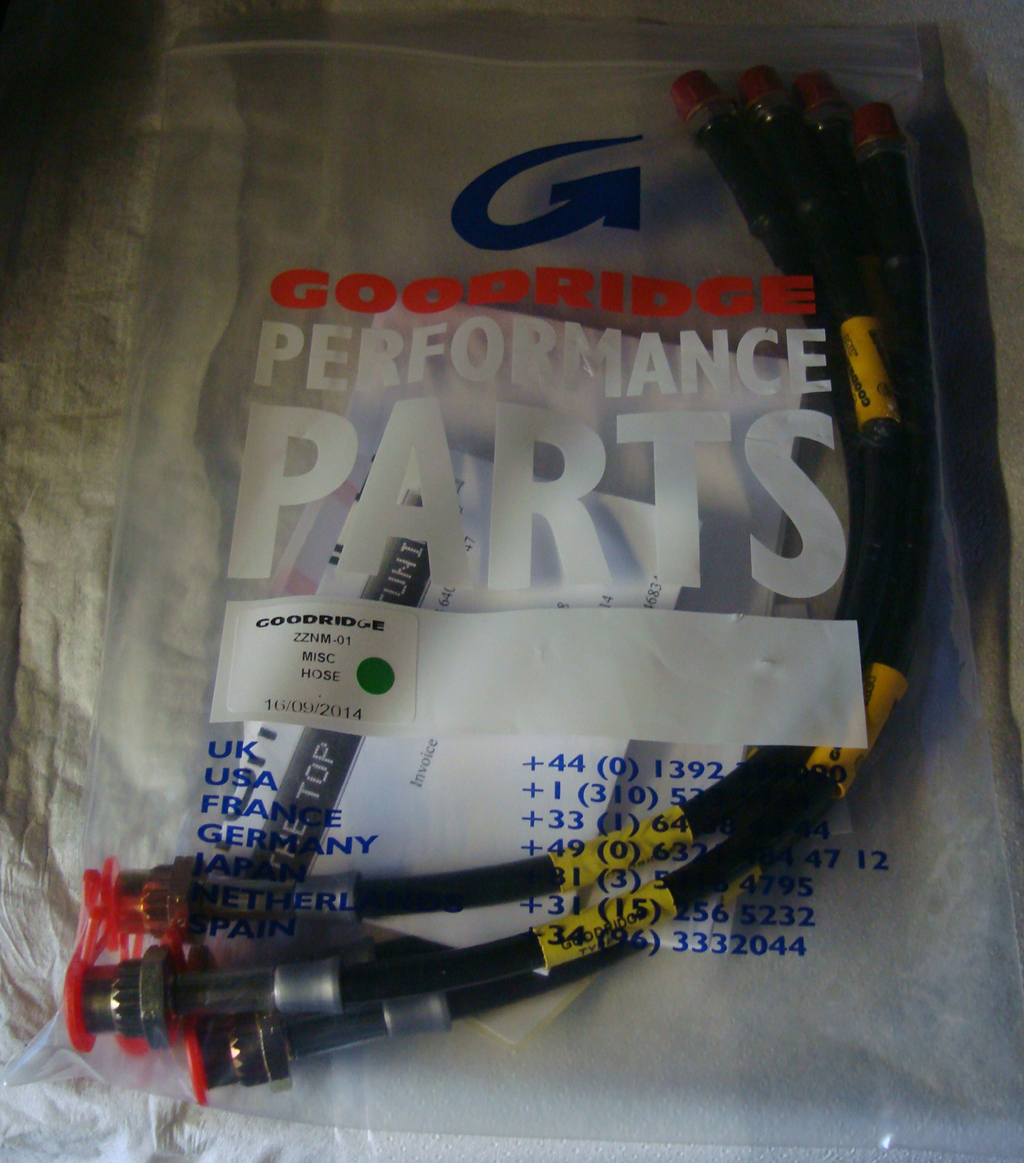

So In September 2014 I had the standard brake lines replaced with Goodridge Braided brake lines:

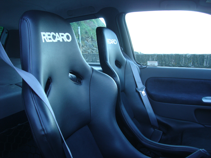

Following that in May 2015 I purchased a set of barely used Recaro Pole Position seats with custom lower sub frames from an owner of a Phase 2 v6 in Northern Ireland who was looking to return his car to standard before selling it.
One of the biggest issues I had with my car was the factory seating position, I just felt like I was sitting too high but this modification certainly changed that. I now sit nice and low and the seats offer great lateral support when cornering.
The seats are currently finished in Recaro Ambla Leather Black/Dinamica Suede Black but the long term plan is to have them re-trimmed in the dark blue leather and Alcantara of the Phase 1 Renault Sport seats complete with the embroidered Renault Sport Logo so that they better match the rest of the interior.
A picture from when I had just fitted them:

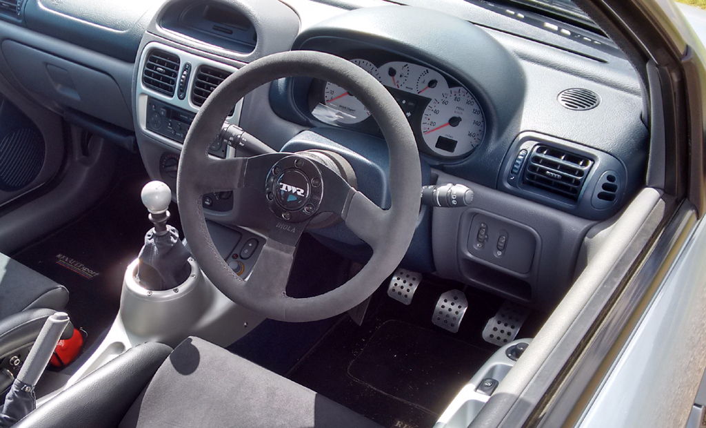

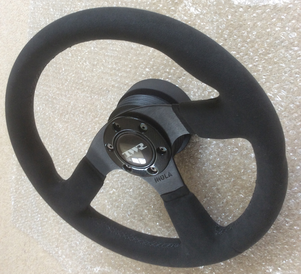

The next modification was replacing the standard steering wheel with a slightly smaller one in August 2015, I could have gone down the route of fitting the Sabelt RenaultSport wheel but I fancied something different that I could be fairly certain nobody else was likely to have fitted. As some of you may already know the Phase 1 V6 were built by Tom Walkinshaw Racing, so I looked to their previous road car creations for inspiration and settled upon choosing the same wheel as that fitted to one of my all time favourite cars, the Jaguar XJ220-S of which just 6 were produced, here is a picture of an XJ220-S interior showing the wheel:

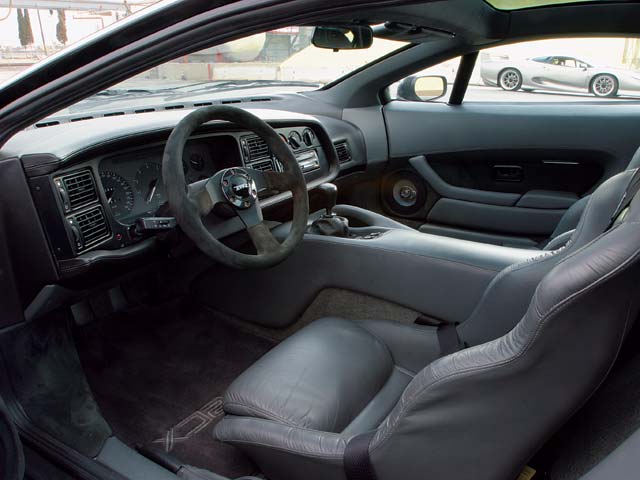

A little bit of research revealed that the steering wheels fitted to these cars were 345mm Italvolanti Imola finished in dark grey/black Alcantara with a carbon fibre effect horn push surround. A short search on eBay yielded a lucky result, a genuine 1993 Italvolanti Imola wheel (the correct year) finished in black leather with a starting bid of just £10.00, I was the only bidder and felt quite pleased as similar examples listed previously were all starting in excess of £90. I sent the wheel off to Jack at Royal Steering Wheels and a week or so later the wheel was back with me finished in the correct Alcantara.
The wheel was missing the correct horn push and surround but I managed to find a plain black one which I then hydro-dipped myself to give the carbon fibre effect before finally creating a quick design for the centre badge in Photoshop which I then sent off to be turned into a domed sticker to match the original.
Overall I was very pleased with the final result:
I much prefer the feel of the slightly smaller steering wheel to that of the original.

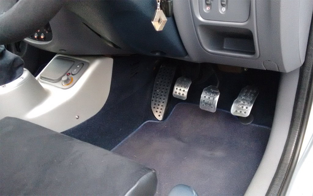

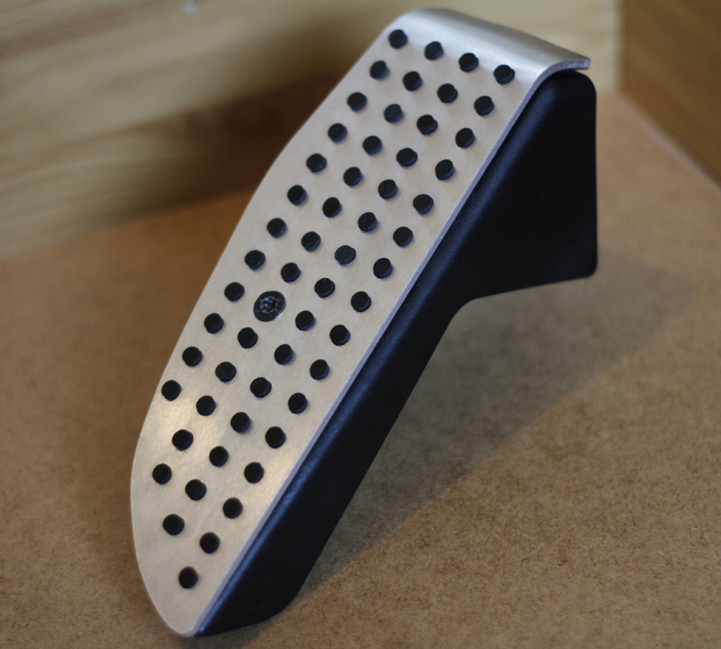

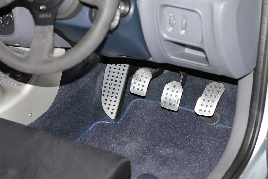

So as above, November 2015 saw my next (very minor) modification. I saw the metal foot rest covers available for the Mk.2 Clio and liked them but what put me off fitting one was that the Clio v6’s pedals are unique in the Clio range and they don’t really match the design of the foot rest covers currently available on the market, I decided therefore to create something unique again that would match the v6’s pedal design.
I took measurements from the original pedals and drew up a design that would match them before sending it off to be laser cut from 3mm thick aluminium.
The design features over 50 small holes which I then inserted individual rubber ‘bobbles’ into so they match the original pedals and also offer extra grip, the finished result can be seen below:
You might also notice I had finally got around to replacing the old black floor mats by this point with a set of dark navy blue mats that match the cars carpet. I have also subsequently gone on to polish both the new foot rest and the pedals to a high shine and I will try to get a picture showing this shortly.

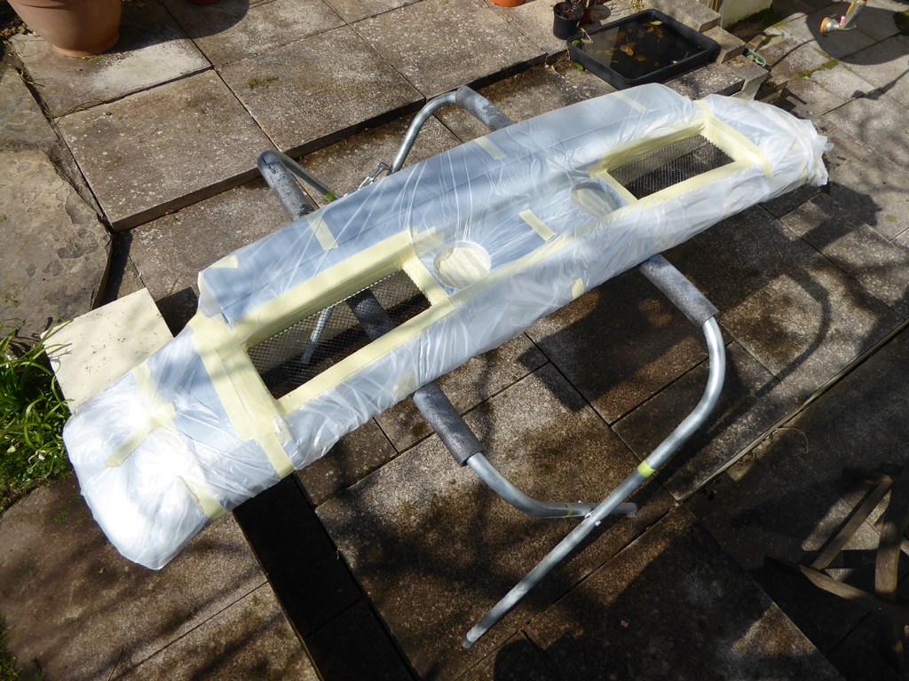

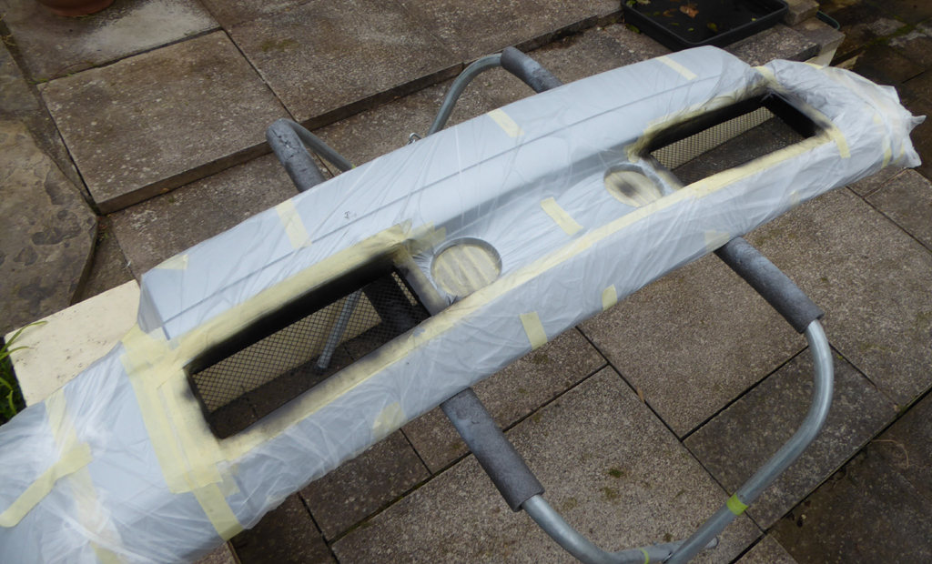

Not a modification but yesterday I removed the rear bumper and polished the exhaust, I also took the oppurtunity to mask up the rear bumper whilst it was off the car and give the mesh a fresh coat of gloss black as it had started to fade.
Some pictures for you:
^ Before.
^ Bumper removed and masked up, ready for the mesh to be painted.
^ During painting.
^ Mesh painted and masking tape removed.
^ Bumper refitted to the car, with the polished exhuast.

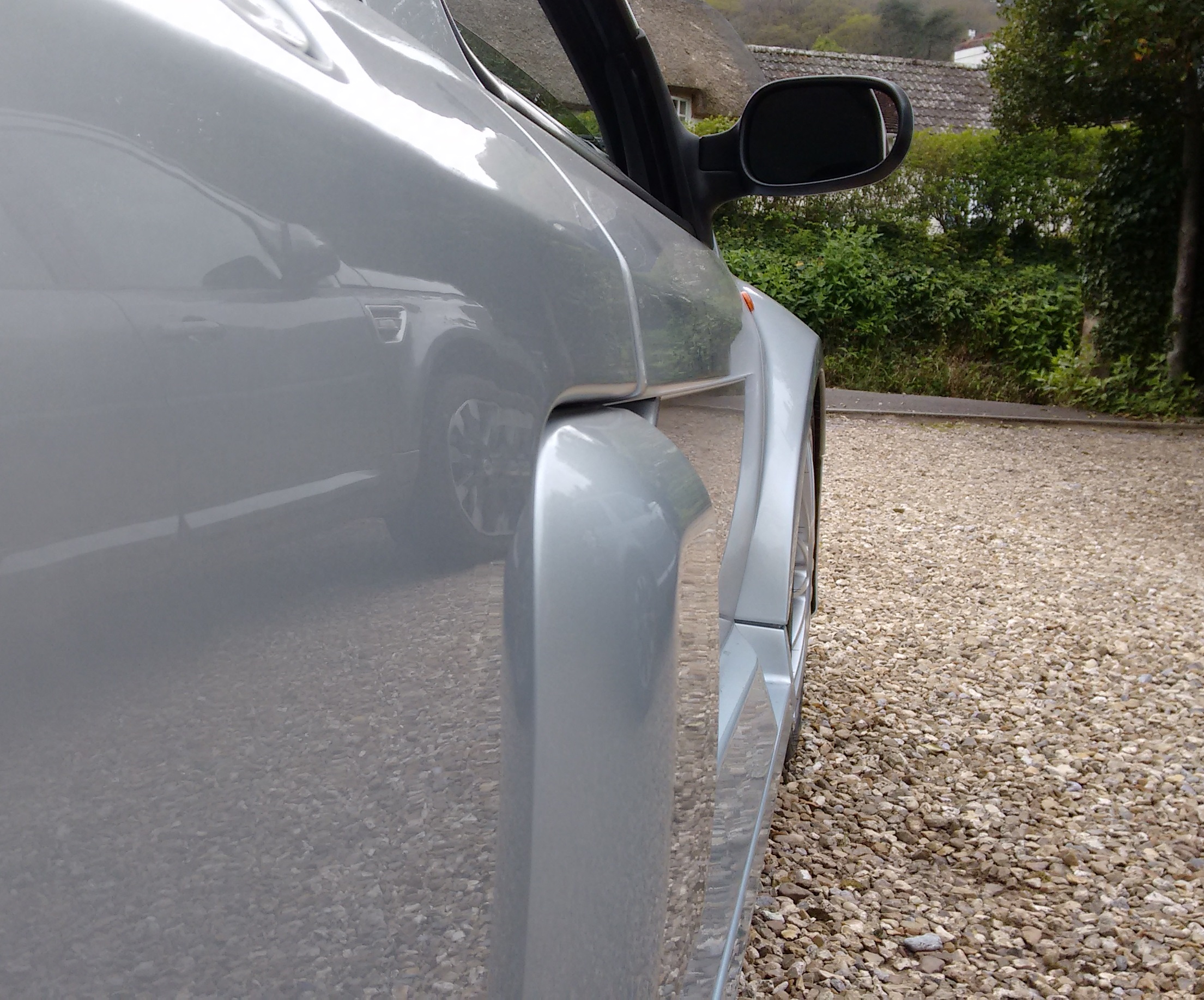

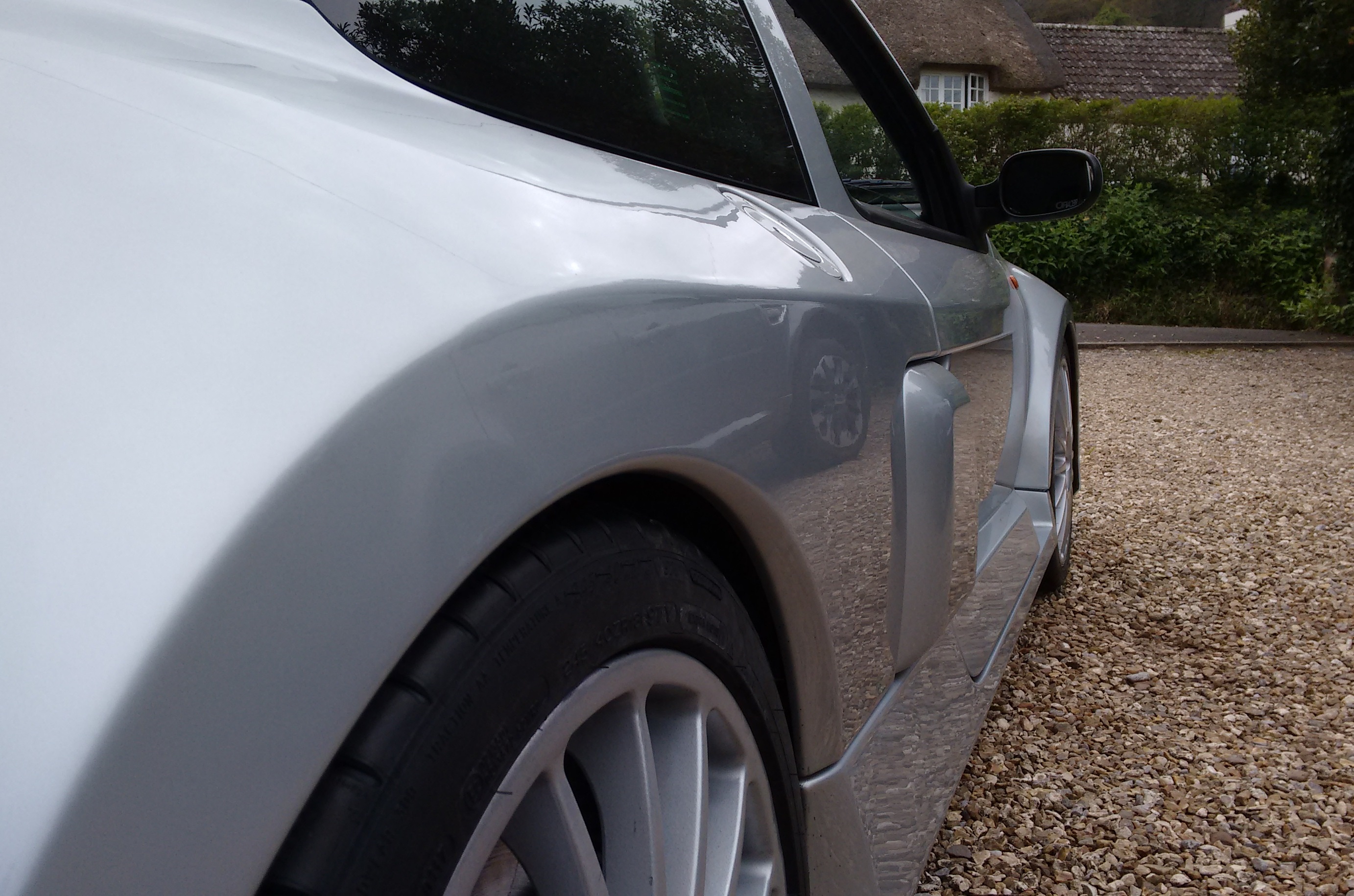

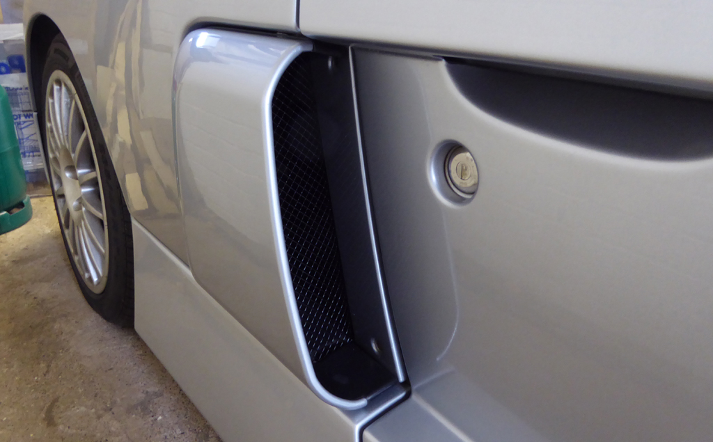

At the same time I was doing this I also removed the Side pods and cleaned behind them, and as the mesh in them had also begun to fade I took them off the car and gave them a quick coat of gloss black too before finally refitting both sides:

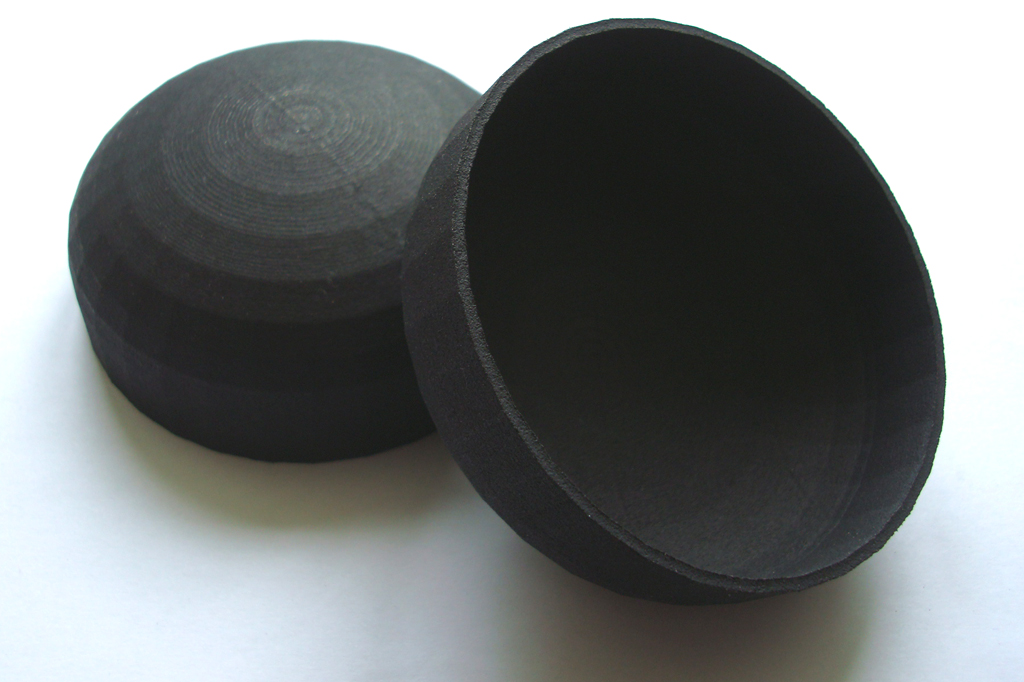

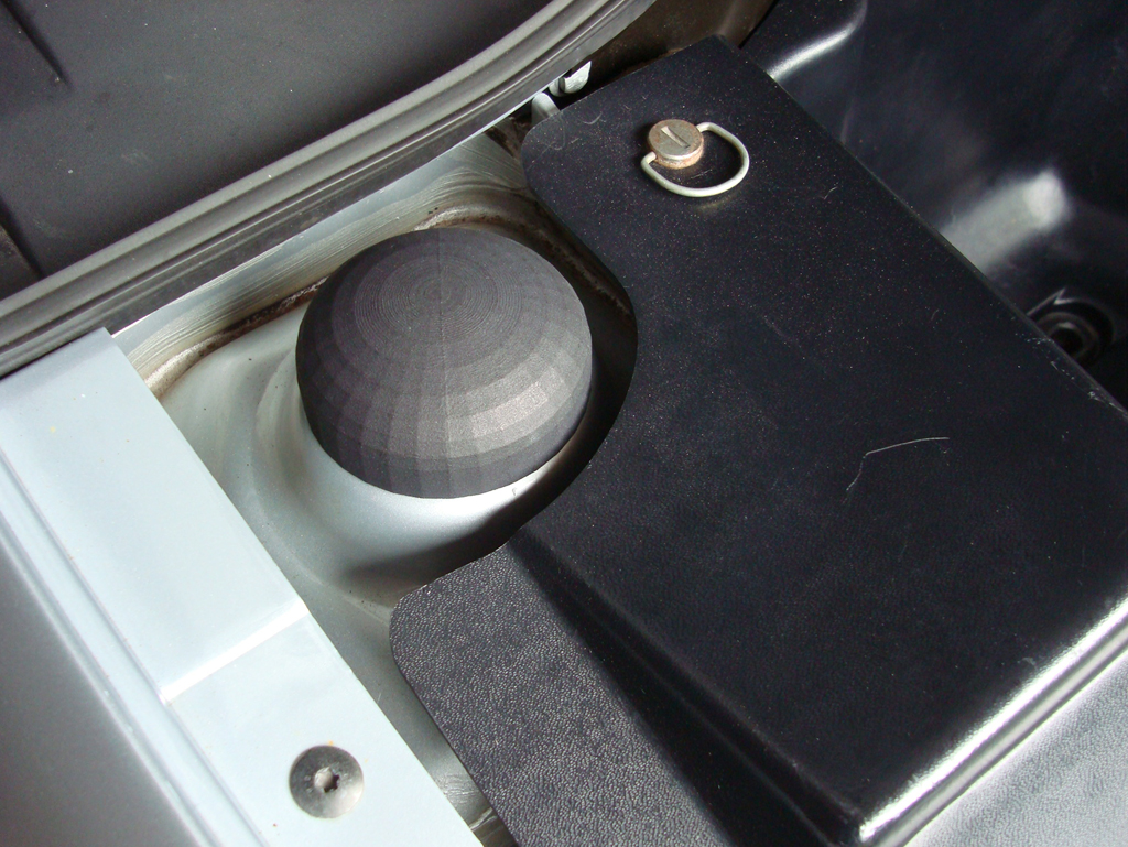

As I said, I can’t promise regular updates to this thread but today I have a small one. In an effort to ensure the solid top mounts remain in good condition I decided to design a set of covers for them using a free online CAD program I found, as existing covers suitable for the OEM top mounts don’t fit.
I had a couple of different ideas but this was the more successful design of the two, I sent the CAD file off to a 3D Printing company and this morning received the finished product:
The covers fit very securely over the top mounts without the need for any additional adhesive tape, but can also be removed easily to allow for quick inspection of the top mounts or if I want to make any adjustment to the damper settings on the coilovers. They also don't interfere with either the underside of the bonnet or the top of the coilovers.
A couple more pictures showing the covers fitted:
I’m pleased with the result as they don't stand out too much and all being well they should protect the top mounts and keep them in good working order for a long time to come.

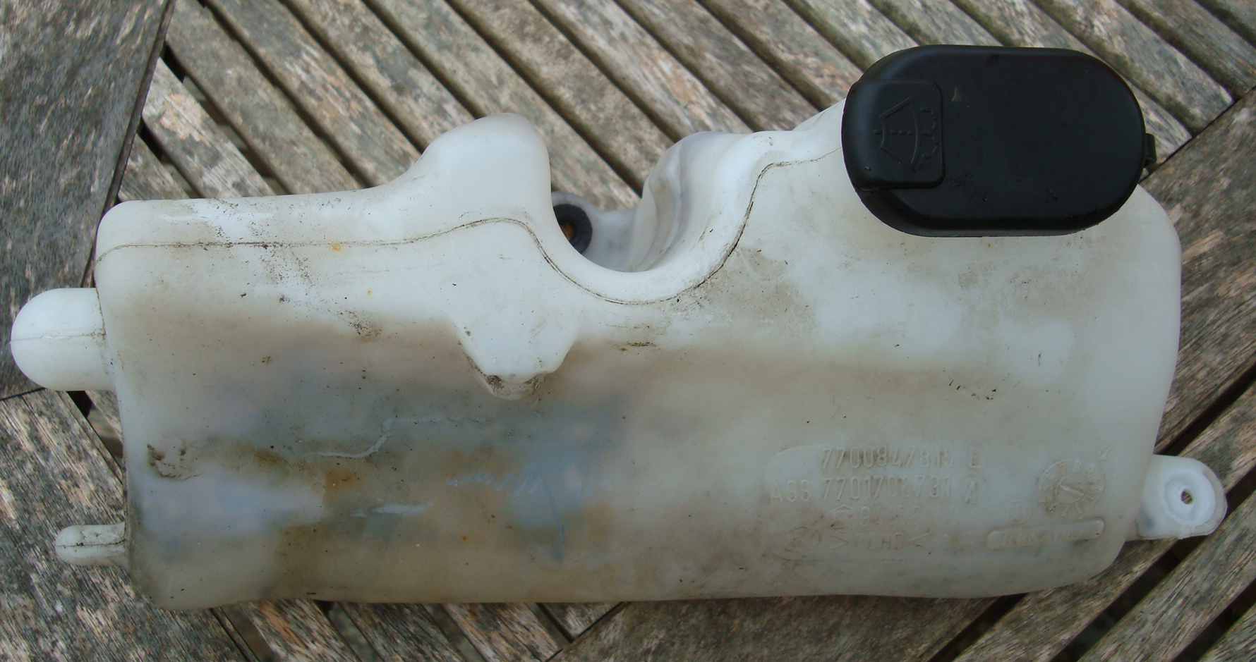

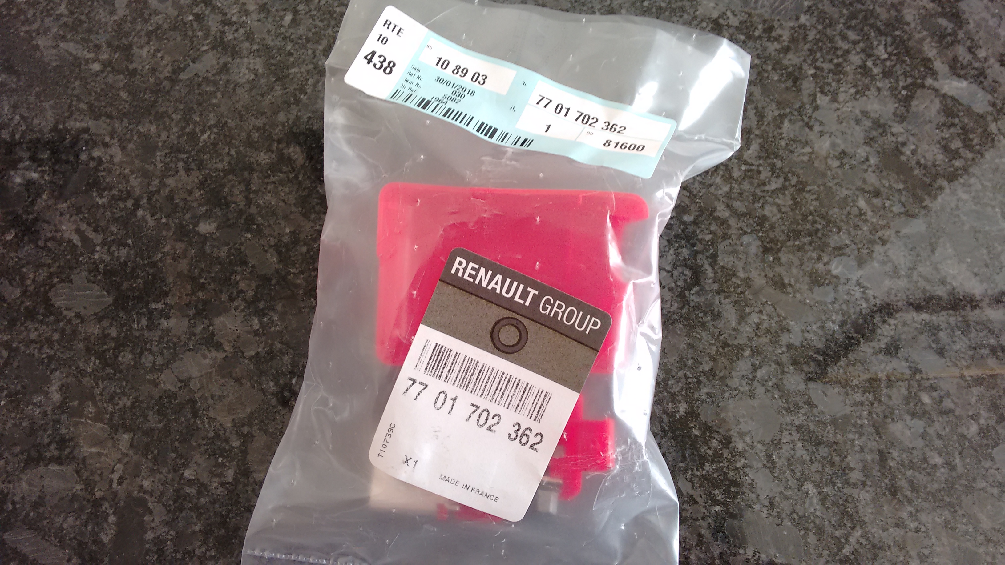

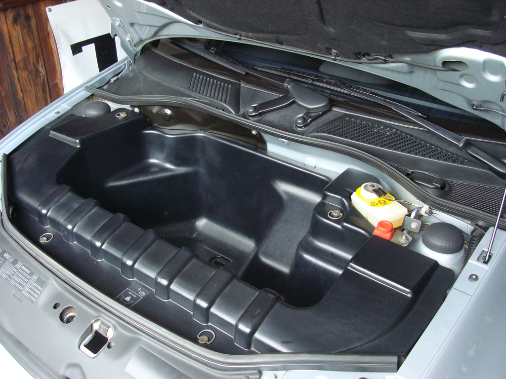

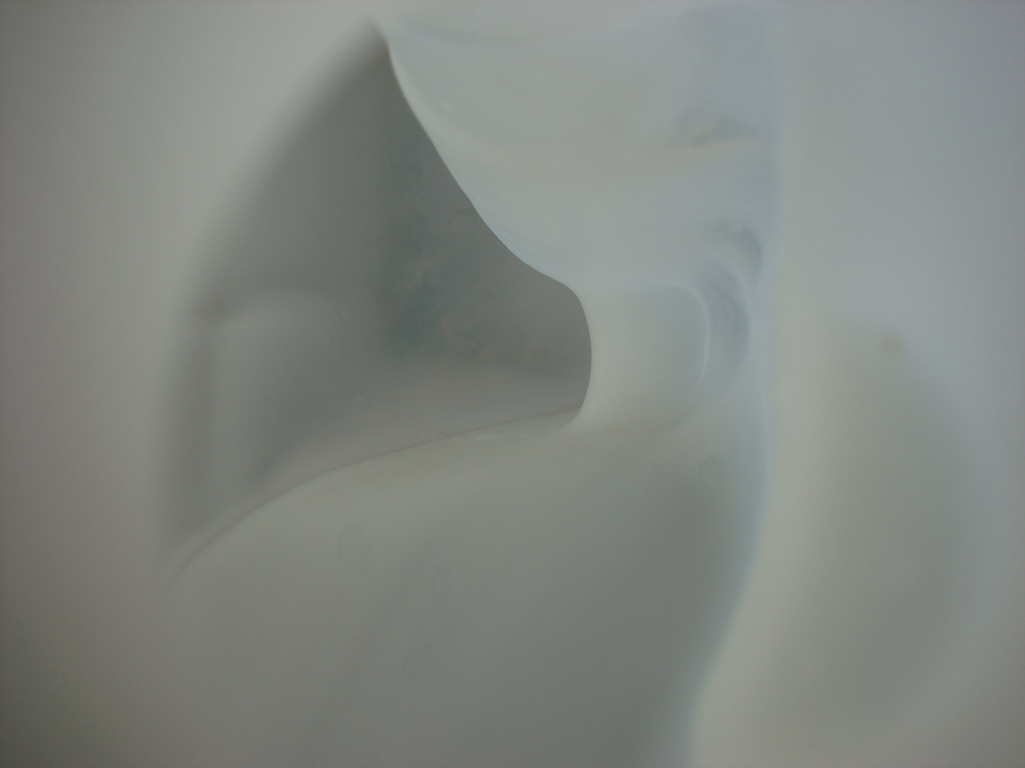

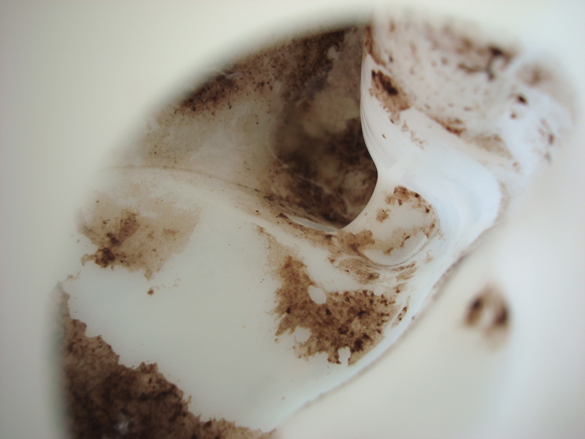

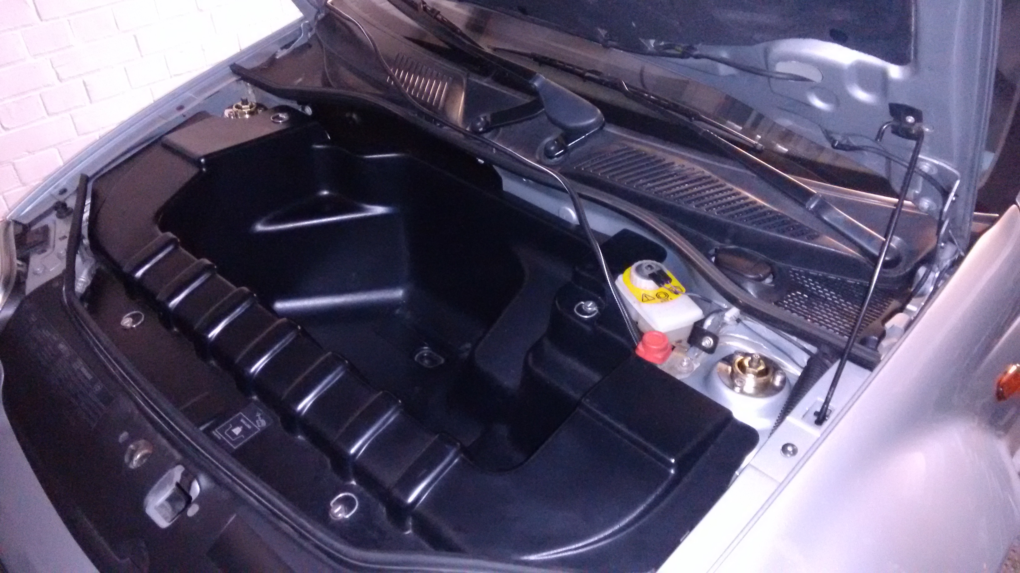

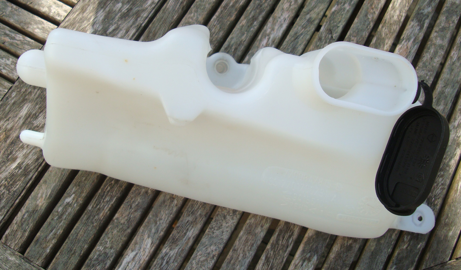

At the beginning of September 2016 the windscreen washer pump stopped working so I had to replace that, I also noticed that the bottom of washer bottle itself on the inside was quite dirty/stained so I decided to remove it and thoroughly clean it to make sure that the new pump was in a clean environment.
Before:
After:

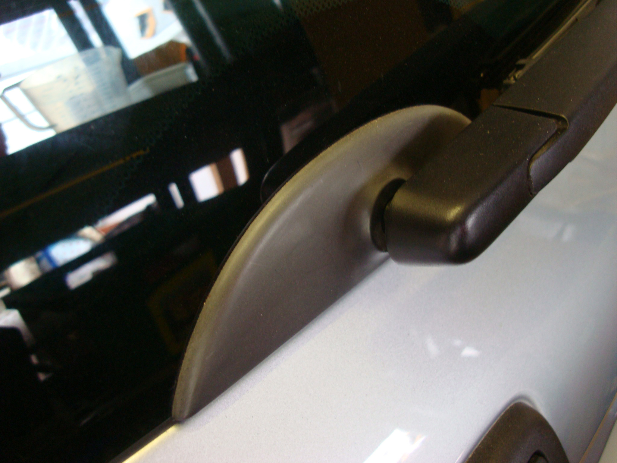

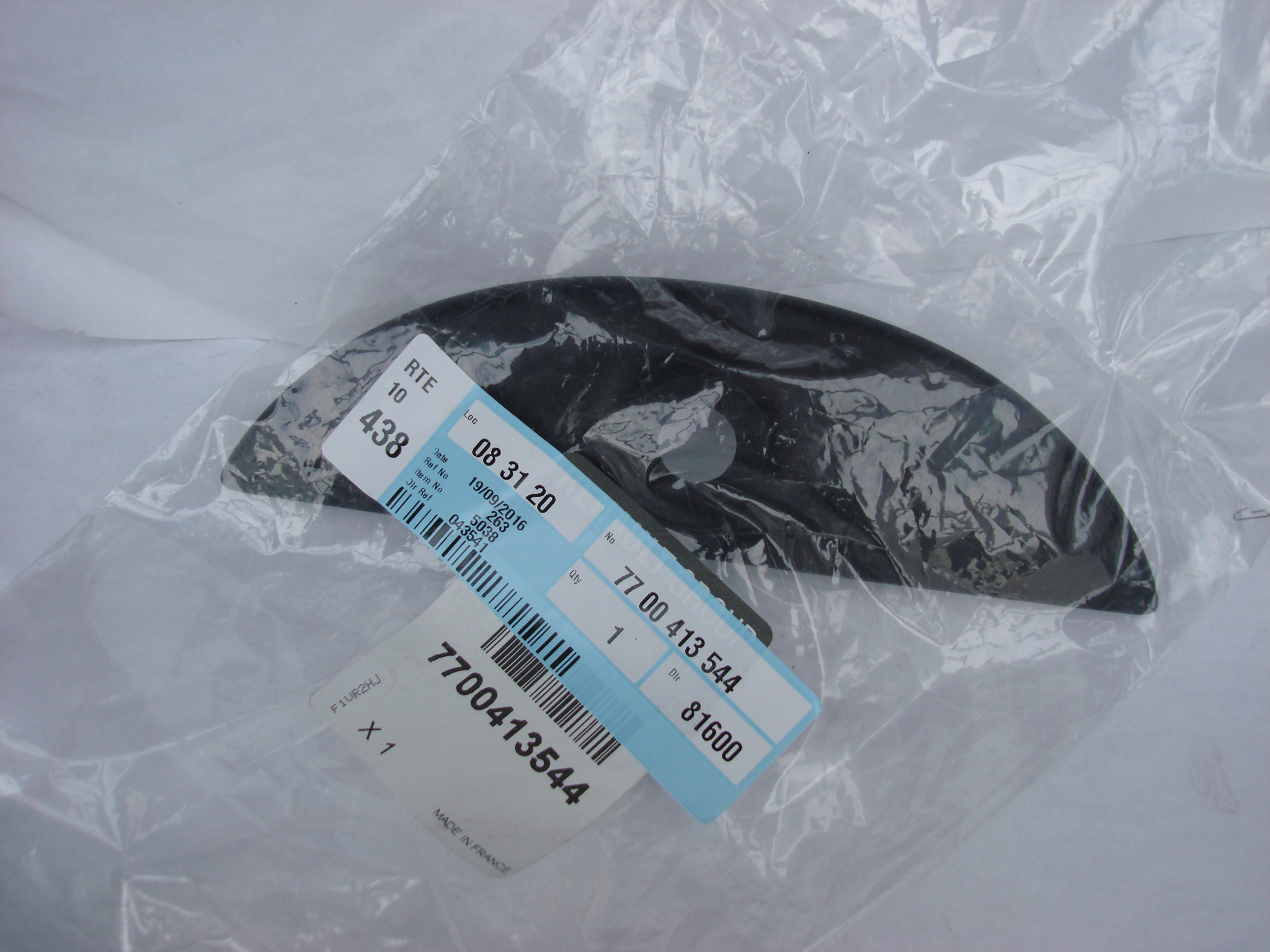

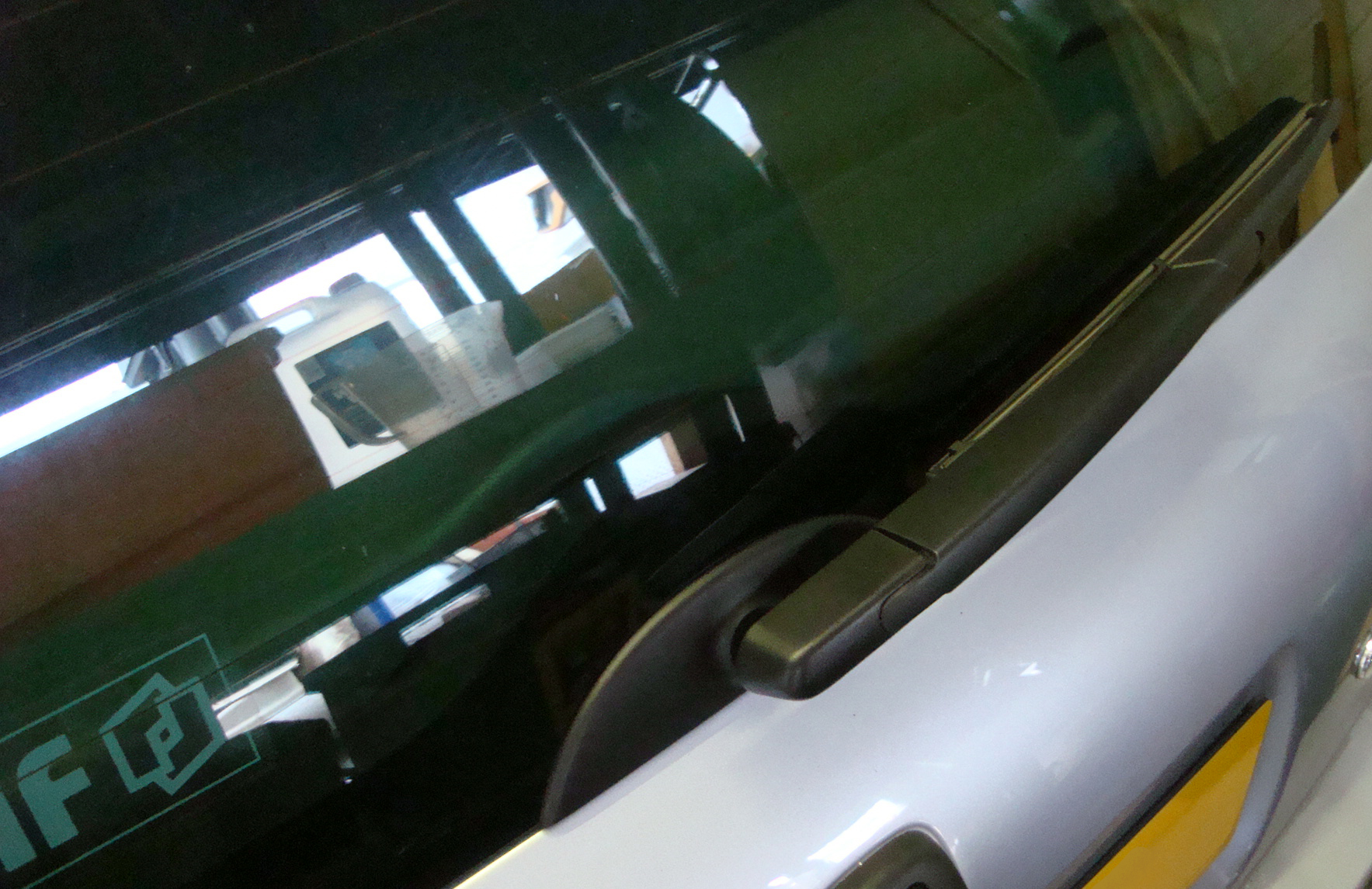

Then in mid-September 2016 I purchased a new rear wiper arm window trim piece as the original was quite faded and trim restorer made little difference, so at just £4.00 it seemed like the thing to do.
Before:
After:

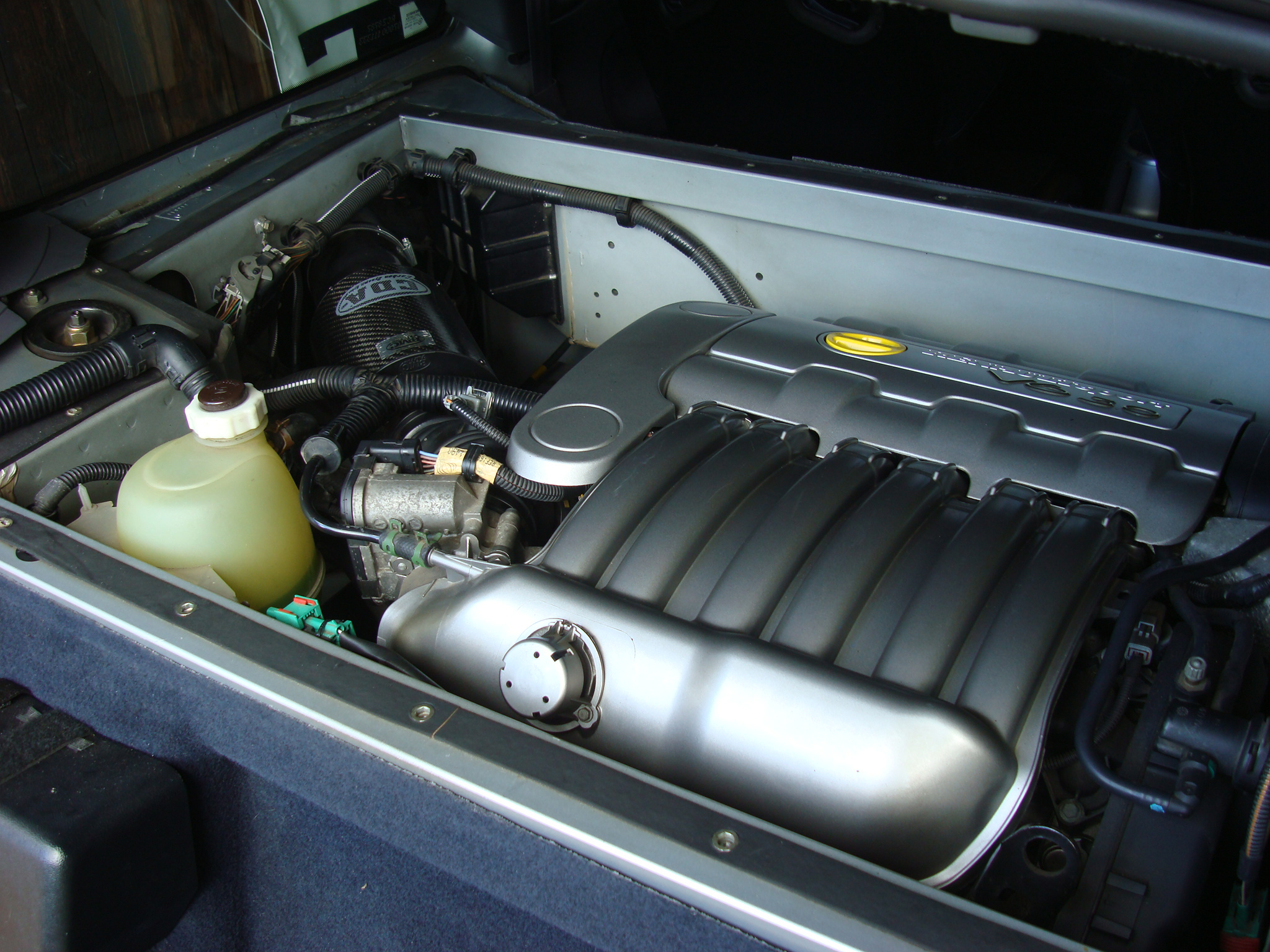

Around the same time I also changed the oil, oil filter, sump washer and removed and cleaned the BMC airbox before reinstalling it so here’s a picture of the engine bay without the covers from whilst I was doing that:

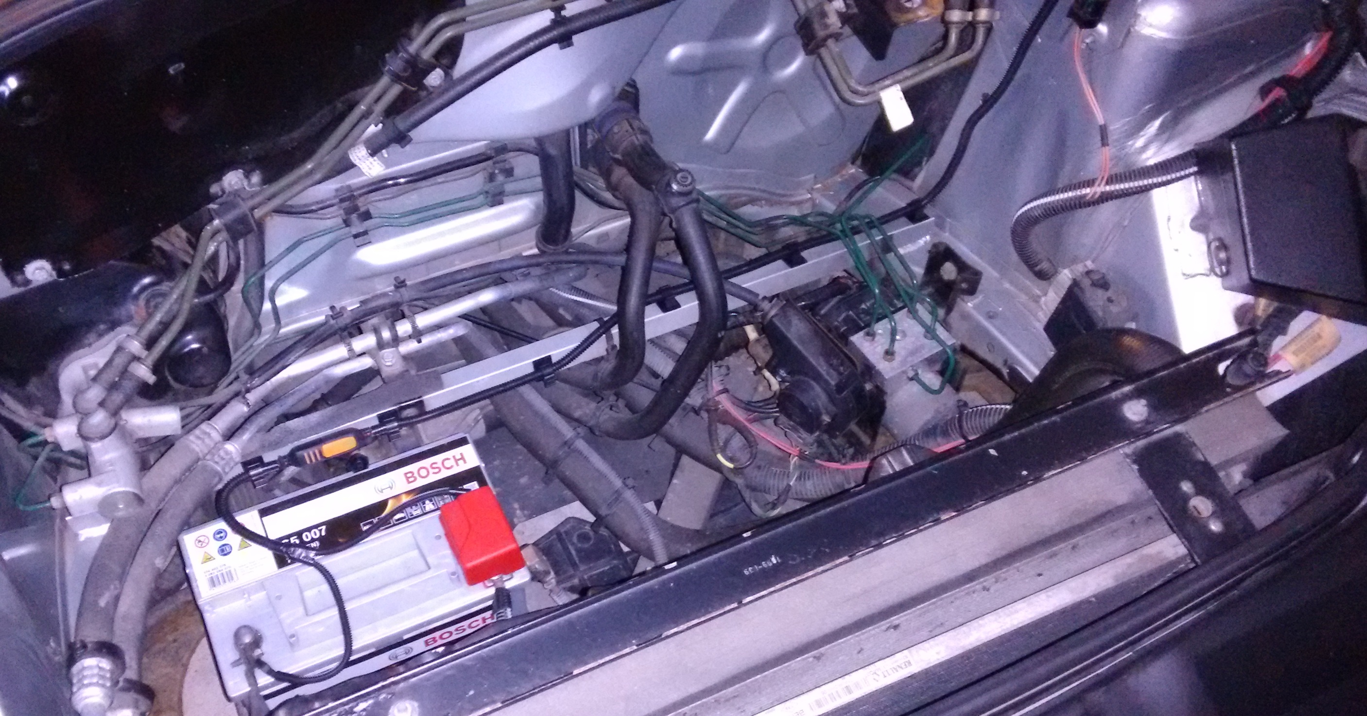

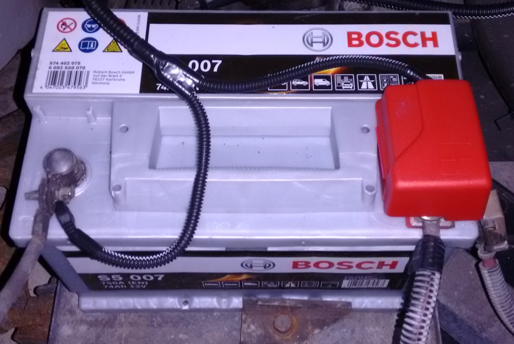

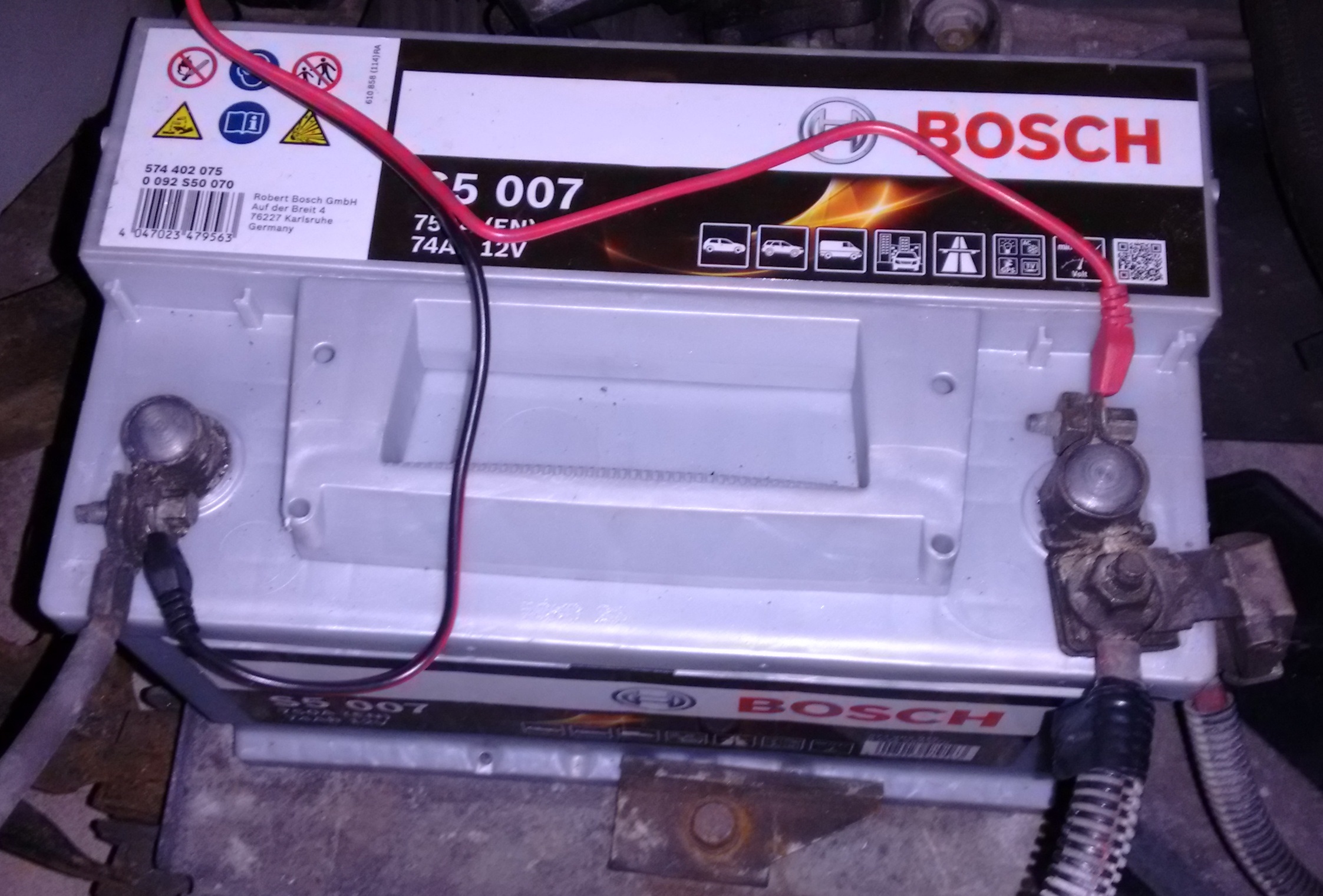

I’ve also found the Michelin Pilot Super Sport tyres to be very good in both the dry and wet. I carried out another oil and filter change in October last year and fitted new wiper blades all round (exciting stuff haha! :wink:). Then most recently in December I bought a new battery for the car as the one in there was now quite old and in need of replacement. I opted for a Bosch S5 007 (74Ah) battery and to ensure it stays it good condition I also invested in a Ctek trickle charger. I also bought a new positive terminal cover as the original had long since disappeared.

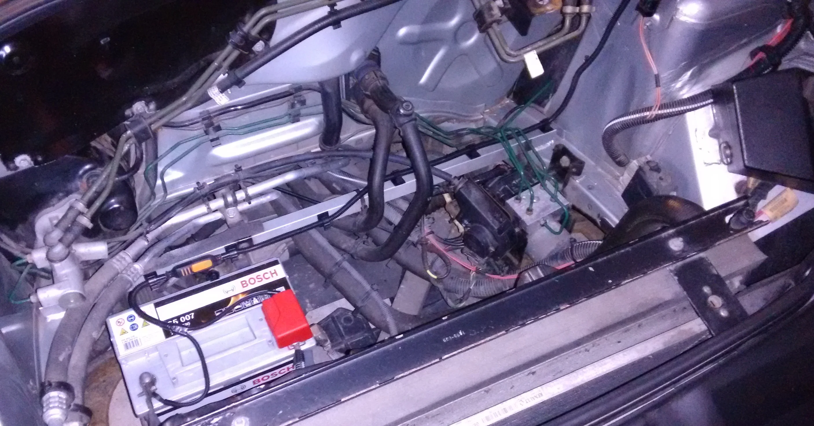

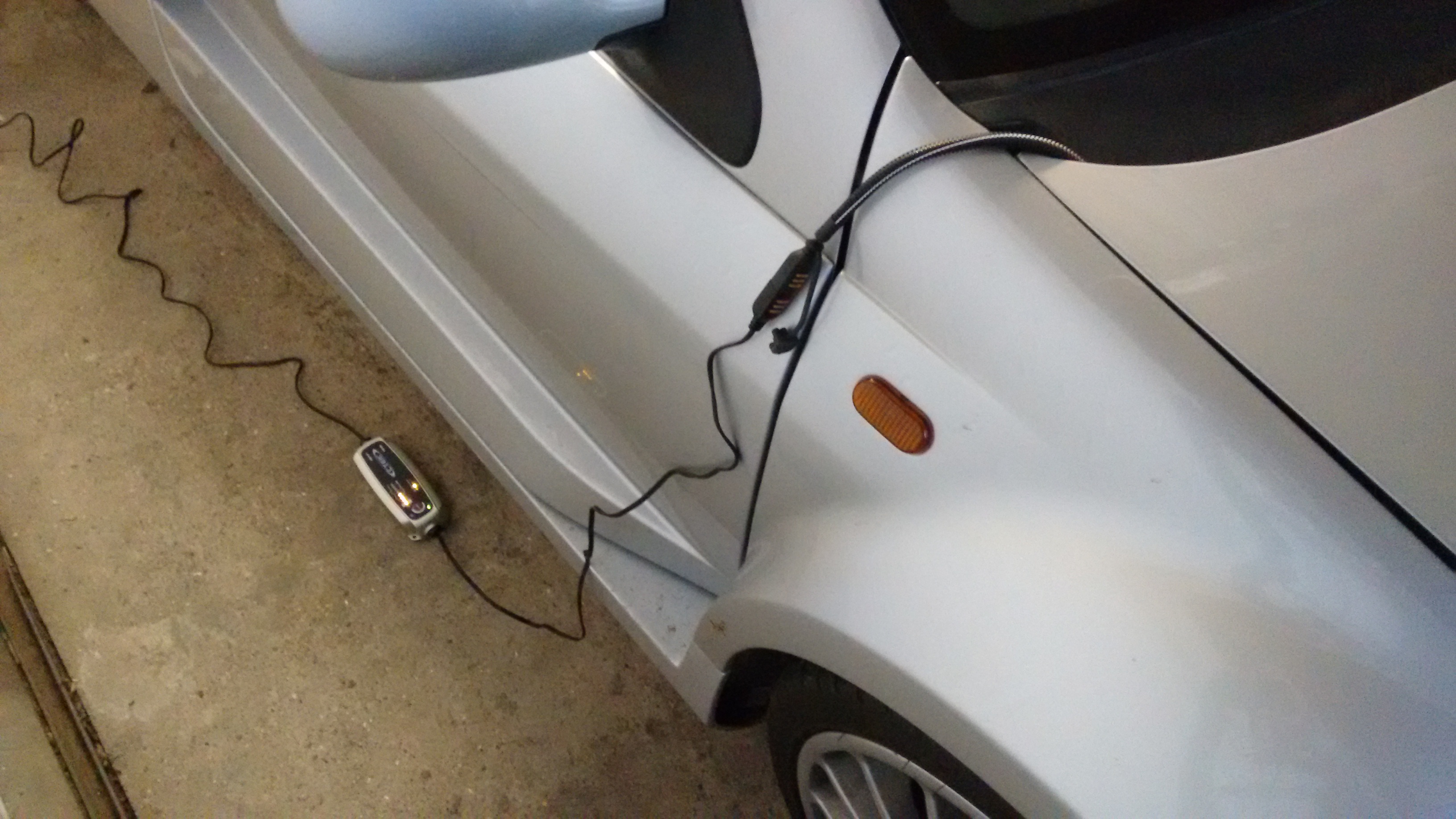

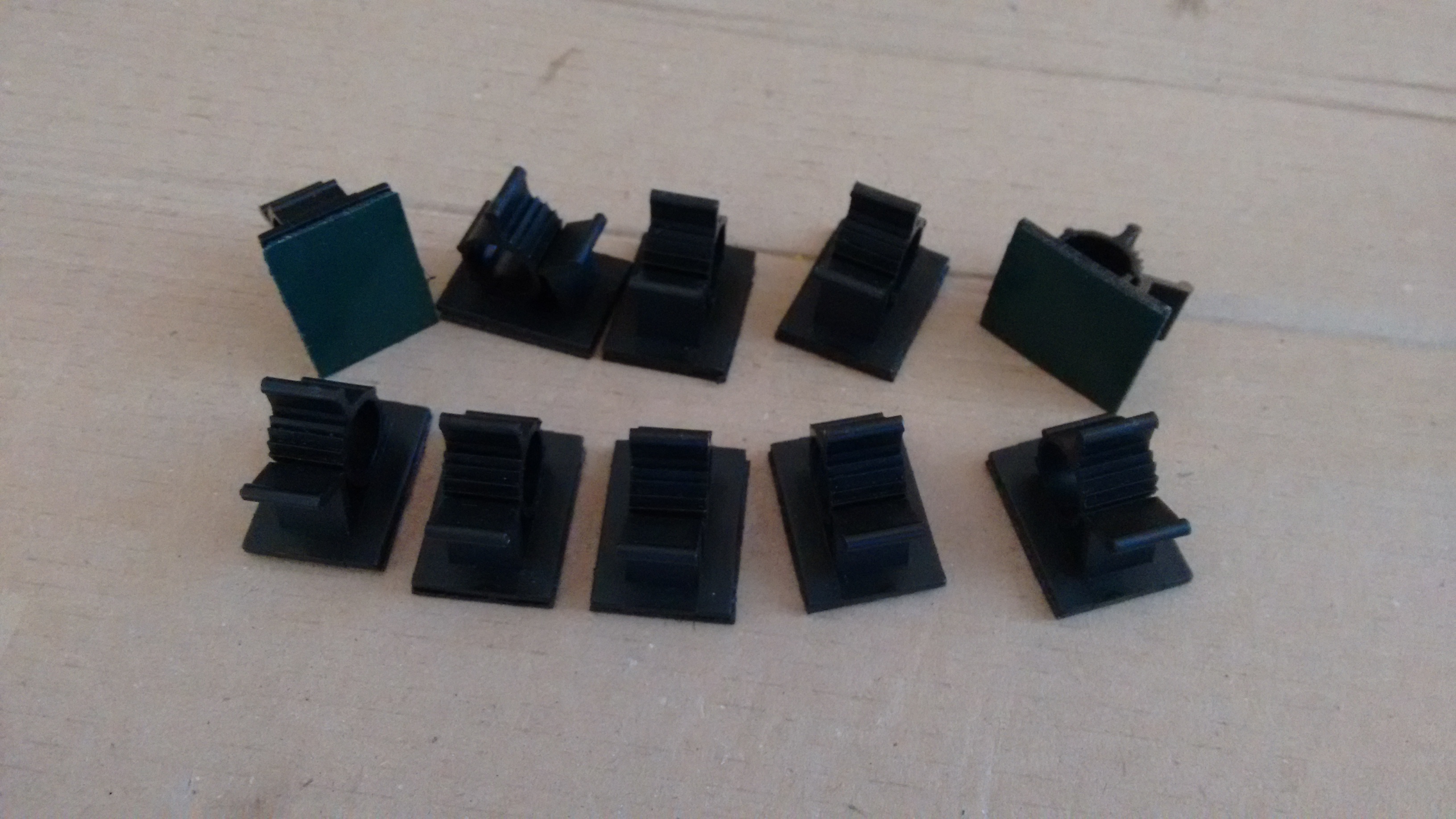

Because the battery in the Clio v6 is located underneath the front storage compartment tray it makes accessing the battery to attach the charger a pain so I bought a Ctek extension cable and decided to see if I could make a neat solution that meant attaching the charger would take only a matter of seconds. I bought some automotive grade split plastic conduit which matches what was used elsewhere on the vehicle by the factory to protect the wiring and some cable clips which are designed to be attached with double sided foam as I didn’t want to be drilling into the car to attach anything to hold the cable in place. The double sided foam the cable clips came with was ordinary white double sided foam but I removed that and replaced it with heavy duty black double side foam so that it blends in and also more importantly so that it is strong enough to remain in place.
The charging cable is now simply rolled up when not in use and stored in the front storage compartment with a waterproof cap on the end of it. You may also notice I have removed the 3d printed front suspension top mount covers I had fitted in a previous update, they did the job I had intended them to but I went off how they looked and ultimately it doesn’t get very dirty underneath the bonnet so I decided to keep them off.
And that brings everything up to date, sorry for the long post. I’ll try to keep things updated more regularly. Thanks for reading.

I did the same with the Ctek, routed mine so the plug sits next to the nearside strut top, makes it much easier to use.

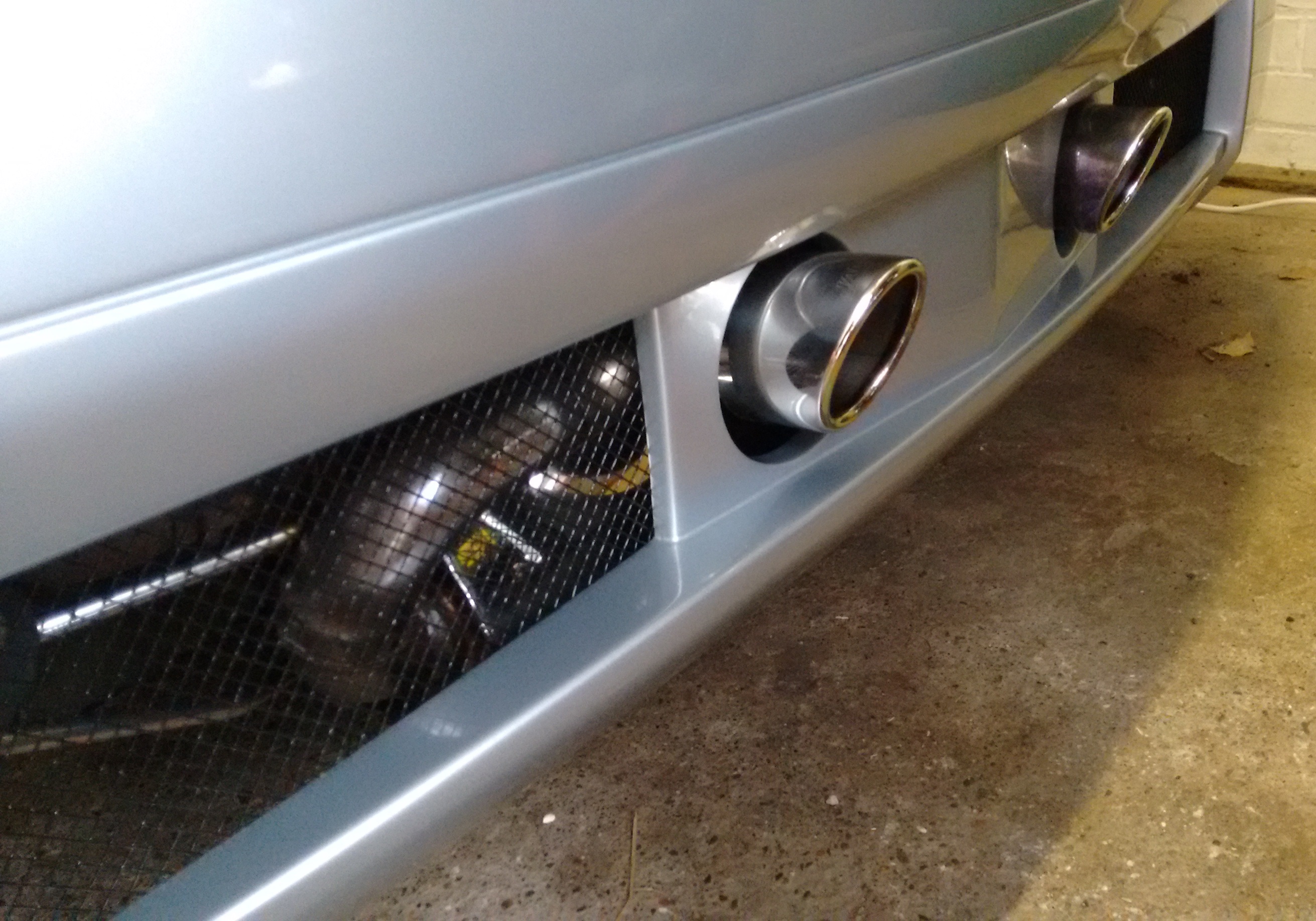

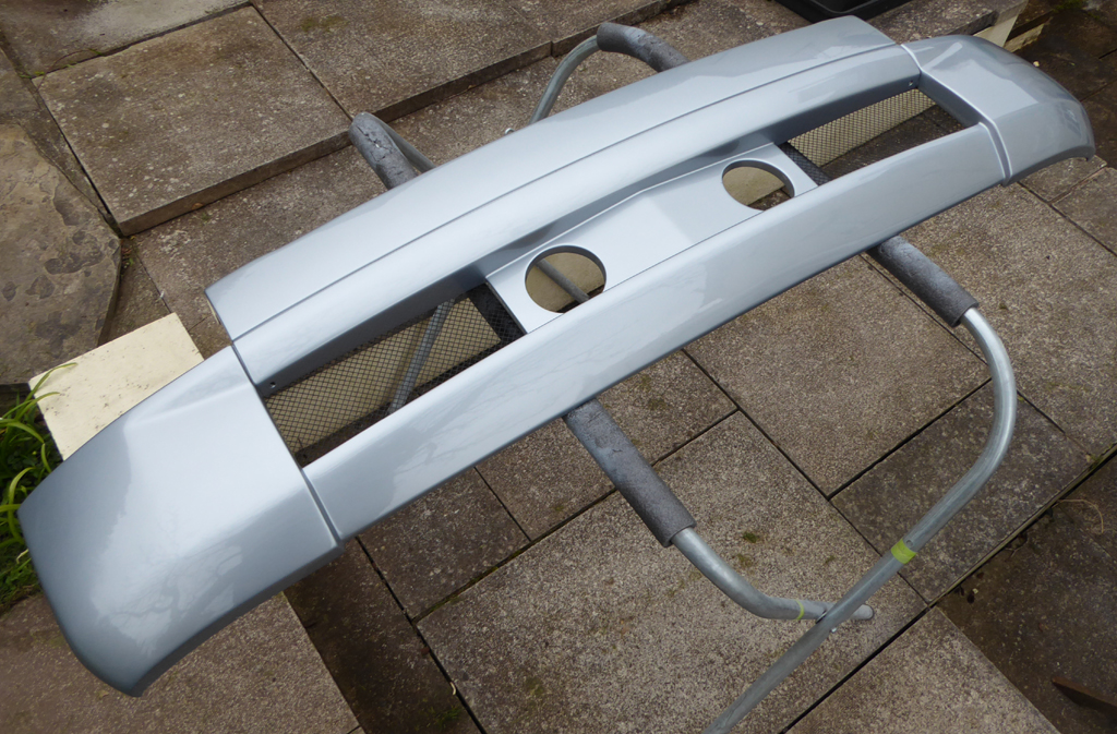

Thanks for the nice comments :up:, since my last update I removed the rear bumper again to polish the exhaust and give the mesh a fresh coat of gloss black paint as it's been two years since I last did it in my first post of this thread. The process was the same as before so I won't bother uploading any pictures of the process but here is the finished result again:
(Sorry the picture quality isn't great it was taken on a phone).

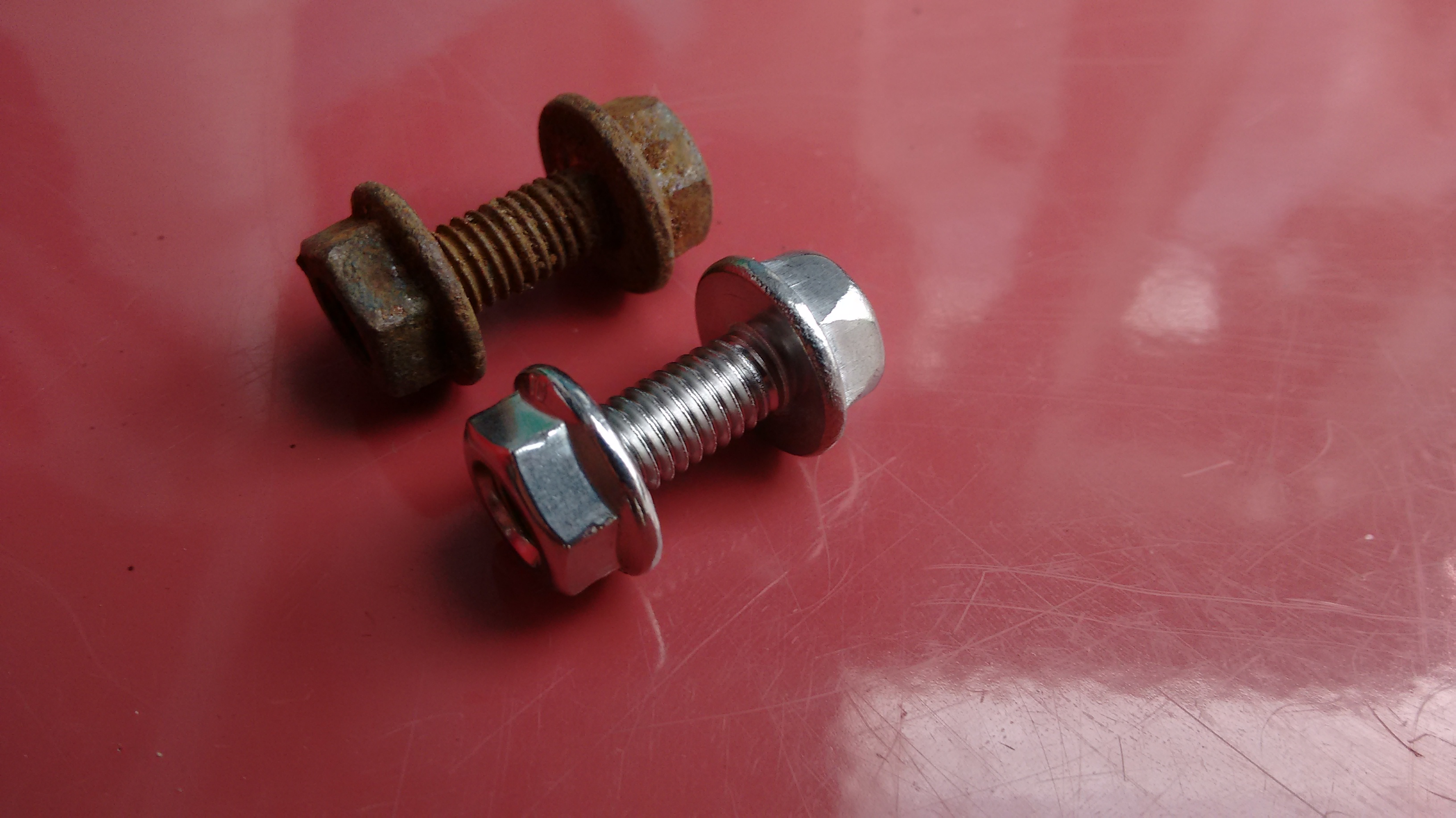

I also decided to replace all the nuts and bolts that hold the rear bumper on with stainless steel items whilst I was at it as the originals were becoming quite rusty and making the already slightly fiddly job of removing the rear bumper more of a pain:

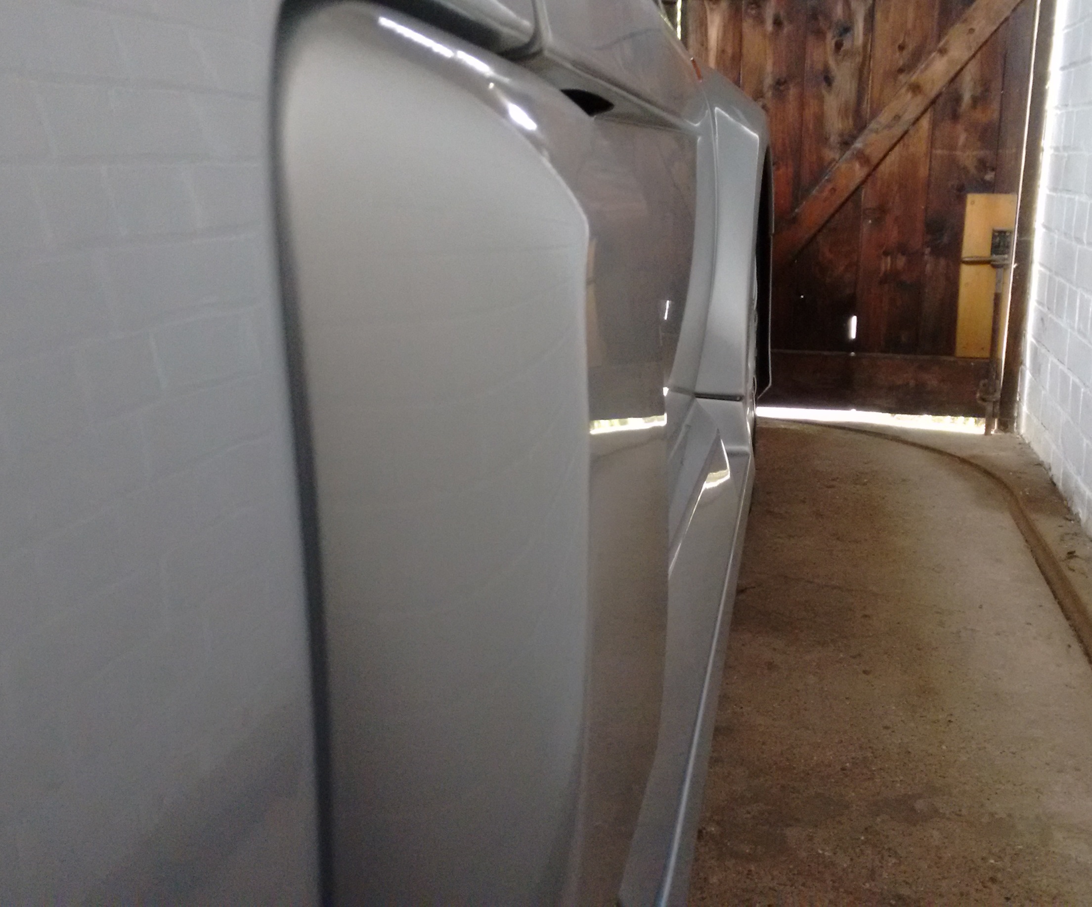

At the same time I also removed the side pod mesh again and gave them a fresh coat of paint, I haven't taken any pictures of that but the results are very similar to that of two years ago and pictured in my first post.
I might remove the front bumper next and repaint the mesh in that but that's a much bigger job than the rear so I might leave it for a while.
