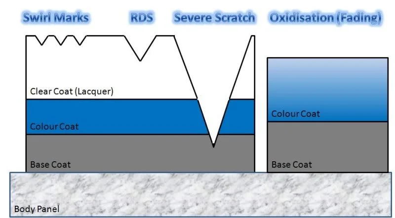

Providing it hasnt gone down to paint it and is just the lacquer it could be removed via a correction then.
Nicked that from over on Detailing world.
If it is like the last one then it cant be done via correction...if its any of the others then it can be done.
