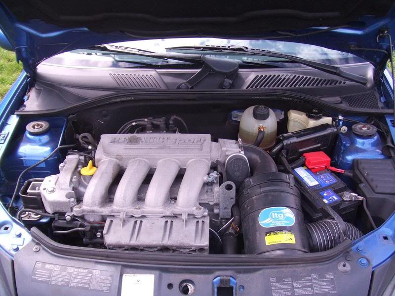

its very big n round
see pic

no you do'nt . Helps to choose a more easy route for your caf though with the space created .
The TB-elbow will probably need to be shortened or else the box will be wedged up against the rad; very tight fit. I got a aftermarket bend one and cut quite a bit off

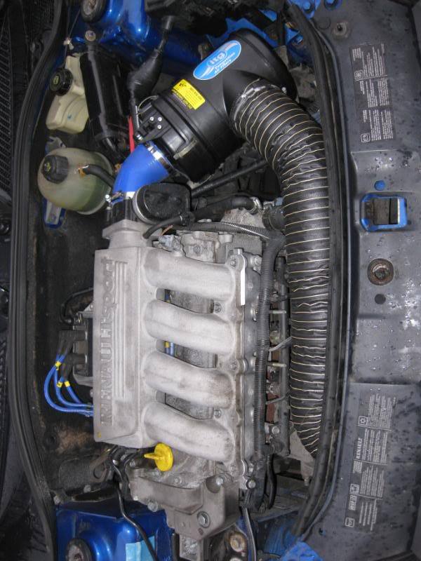

Right, just ordered a new V6 Airbox through the stealers, got a few questions, wheres the best place to buy CAF ducting from? Also where shall i run it, ive got a 182 Cup, if that helps..

Route to the edge of the lower grill, remove acoustic valve! Don't cut into grill. No need and it looks pisch!

just seen you have a cup after replying to your PM stu, run the caf across the front of the car like markcup has done.

Cant run it across the front, theres no room. Mines a 182 cup remember :)
Think im best off taking this route :
Just need some ducting now...

it will fit if you remove the fuel rail guard.
but you will burn if you crash...
edit: of course it wont fit, still got AC crap in the way hasnt it

Not sure if that sounds a good idea, is it easy to remove like, im no mechanic :) Im taking the car round to my dads mate on the weekend to get my oils changed (he works for renault) so i could get him to do it, going to ask him to take my acoustic valve off for me while hes at it..
edit : just seen your edit, i was thinking that... :D

it's 2 nuts to take it off, so easy as pie. the a/c is the only concern, cant remember what it looks like

I’ve read on the trophy forums that I may need the Ph1 bracket that runs from just behind the battery to the front of the car in order to hold the box in place. Is this true? I can’t see anyone here doing this. Just looks as though it’s bolted to the elbow. Has anyone had problems with it being dislodged from hard accelerating?

if using a samco hose, this is by far strong enough to hold it in place so long as you use jubilee clips
