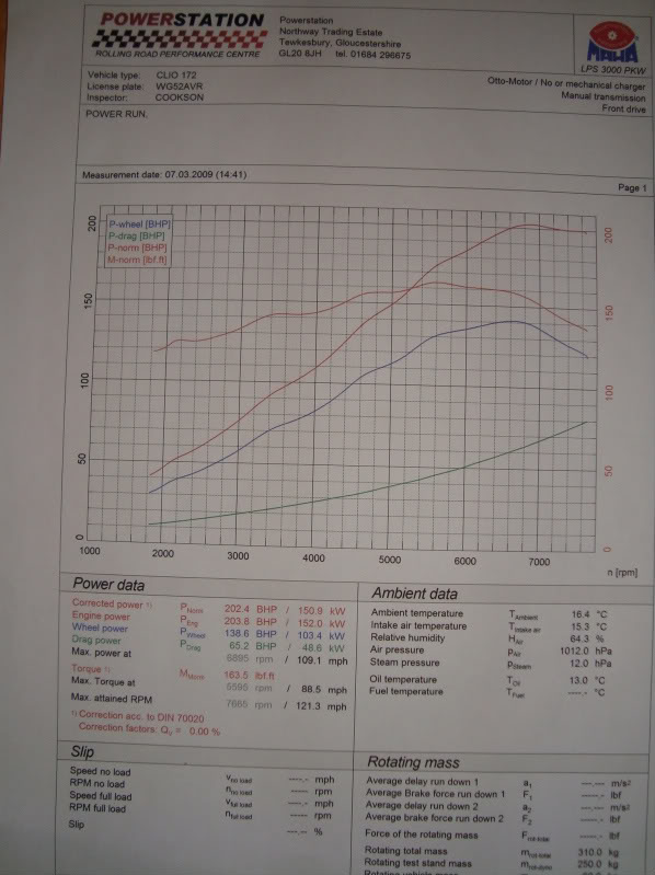

regardless of air temp if you are looking at the corrected figure it will take that into account.
Post up your graph :)

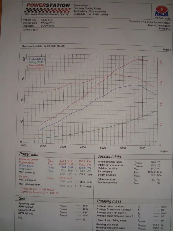

I dont think there is anything wrong with bombers rolling road result. Heres mine from the same rolling road. 202.4bhp 163.5 ft/lb. The same day bombers was rolling roaded adeyspecs throttle bodied ph1 172 made 205 bhp. With catcam 428's fiited with his itb's adeyspecs car made 214.9 bhp and 170ish ft/lb. DanR's 182 with throttle bodies and catcam 428's on the same rolling road made 218.9 bhp and 170ish ft/lb. Not so unrealistic in my view. If anyone is interested burp is running a rolling road day on may 30th at powerstation.
